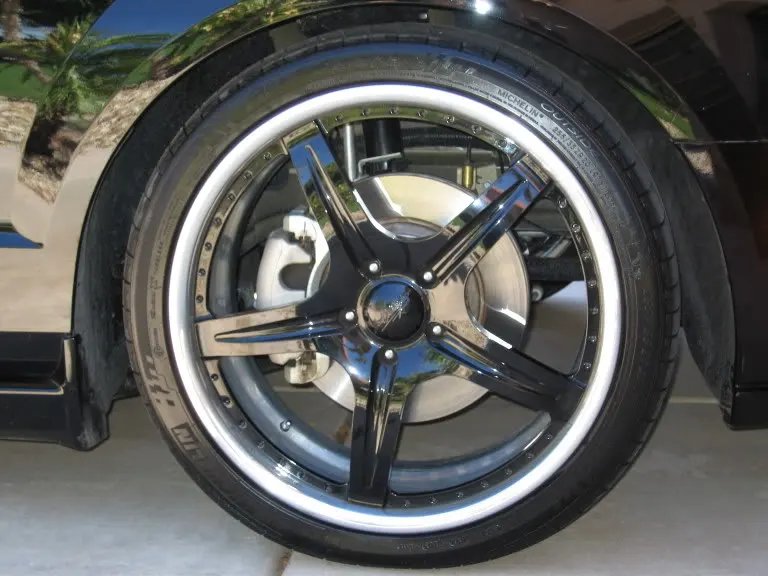

Jenns05Stang said:
Hey Tony,
Do you have any pics of those Coddington's you have on your Stang? :shrug:
I would love to see them.
Jenn
Sure :)
