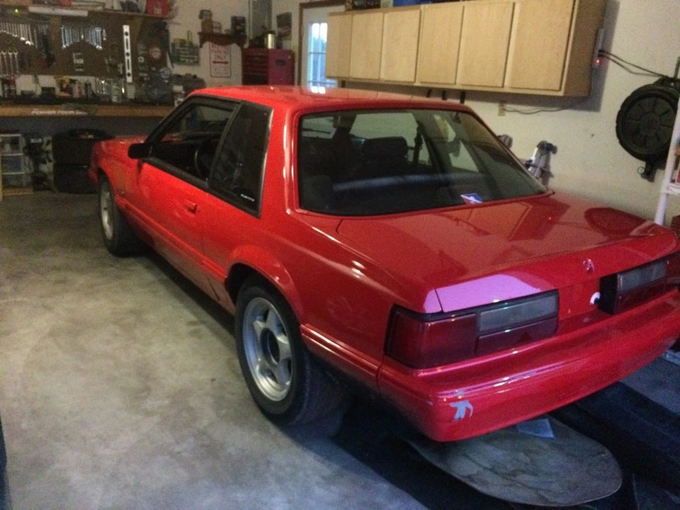

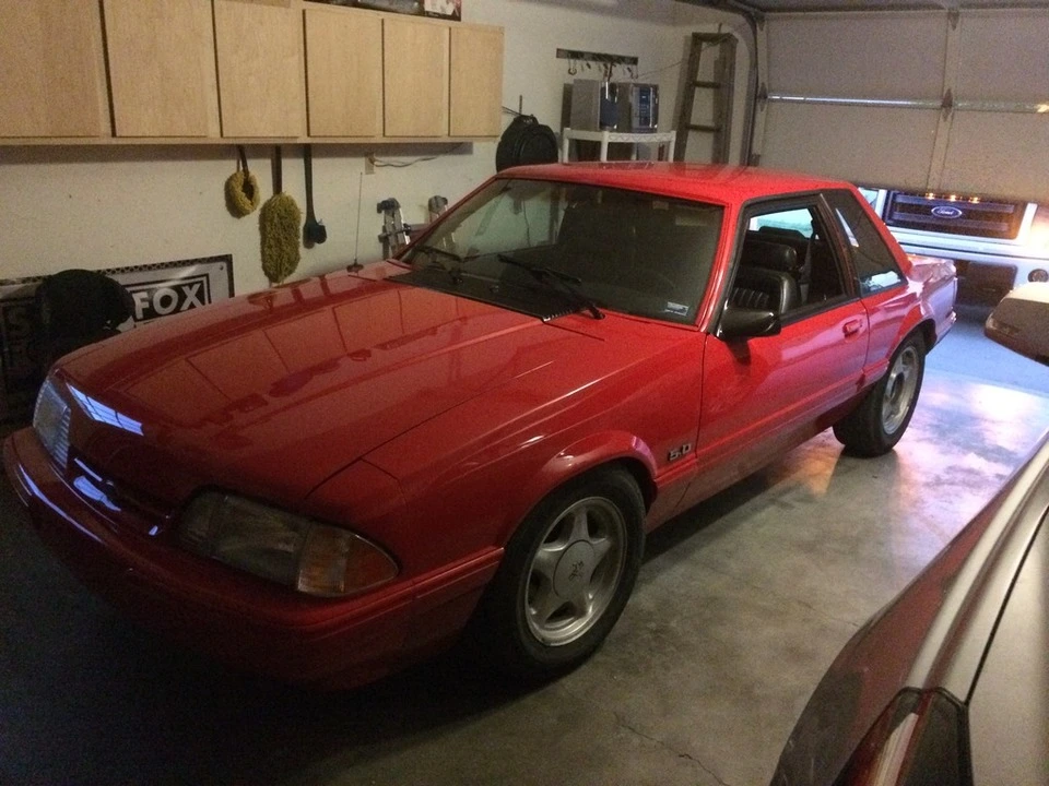

So to start this thread off. Less than a year ago this car had a 6.0 LSX with a massive turbo and was notorious on hillbilly videos (or what ever that is) as well as some 1320 videos in street racing action. A friend of mine had it and it was nasty. He parted out the combo and sold the car as a roller to a family friend of his. It was put back together using a 92 lx convertible (5.0 aod car) as a donor.
The car as it sits in my garage now (picked it up last night).
It goes to a paint guy in less than two weeks to have a few minor boo boo's addressed (rear bumper, front bumper, side moldings, and LX front bumper extension need sprayed or fixed).
It's painted 2012 Race Red. Was jammed out correctly and overall is very clean.
It is an udder turd being a 5.0 aod car but has nice black interior with decent black leather front seats. It still has the factor black rear cloth seat so I'll likely pick up a black vinyl seat cover/material to make it match more.
The plan for now is to pay attention to all of the small details (there are 3 interior pieces that are broke that I have red replacements for that need dyed). Locks don't work (do any of them? lol) and pass window motor isn't working properly.
I will keep the drive train stock (but clean it up as it is dirty under the hood). I plan to start collecting parts for a 5 lug/brake swap then coyote swap parts. (I would settle for a termi swap lol).
My goal is to have an excellent cruiser (but slow) and cruise in car for my wife and little girls to share in the fun on while collecting the parts for the big expensive build. Once we do swap in the coyote/mod motor we will take it and have the engine bay filled/smoothed and painted to match the nice outside paint (its red, but not the right color).
Overall I'm excited to be in a CLEAN fox and a coupe at that. I was really wanting a 93 cobra but was not willing to fork over that amount of cash.
I'll get some more pics once I have the minor paint work done and it clean.

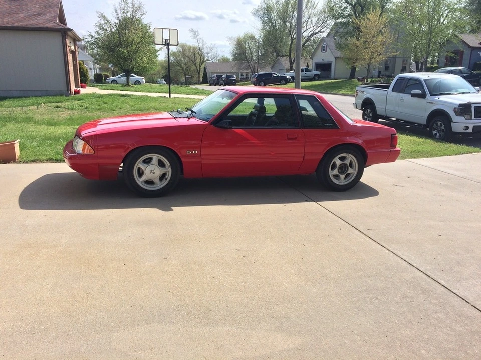

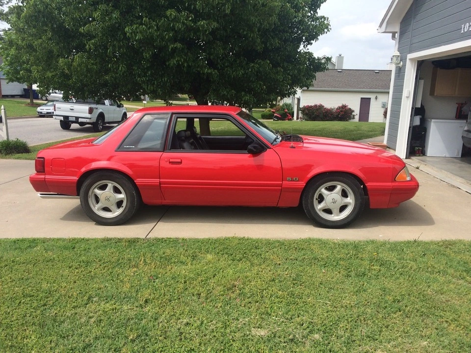

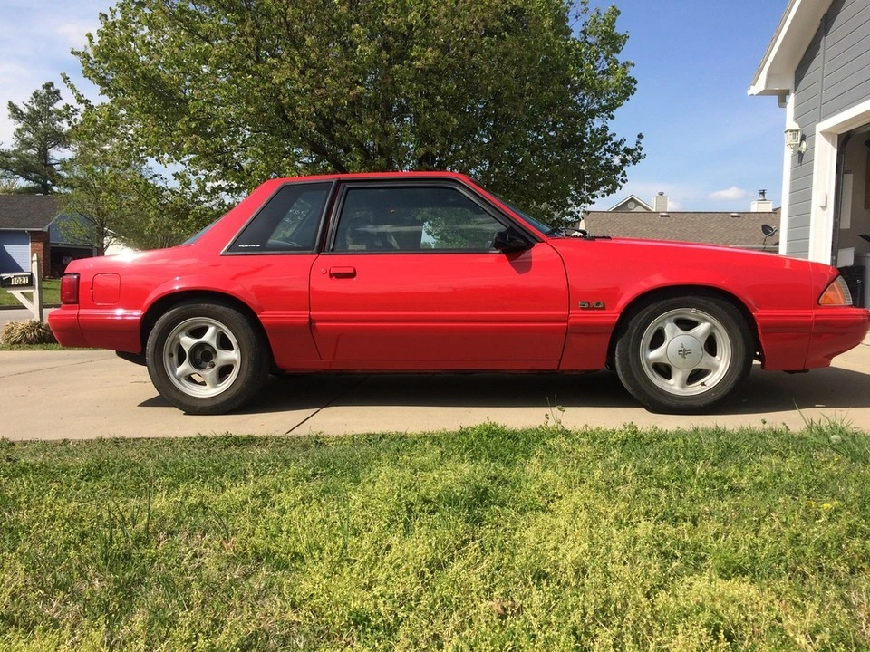

Here are some outside shots. I'm not sure why the img's above didn't all work.
It cleaned up pretty decent. Once the minor paint work is done I'll clay bar and buff the entire car to get the Race Red to shine nicely.
I have located some new center caps (new used) and will refinish the wheels for the time being to keep it respectable. The goal is a 94/95 spindle/5 lug swap w/PBR brakes up front and disc rear 5 lug swap with 18 inch chrome saleens.
Not that anyone really cares but the Interior is coming along nicely. Since this pic I've added new black floor mats from LRS as well as done some more cleaning. I've got the new rear seat material to rid it of the faded/cigaret burned factory cloth. The front seats are survivor leather seats that came out of someones attic. They are in decent shape and are incredibly comfortable.

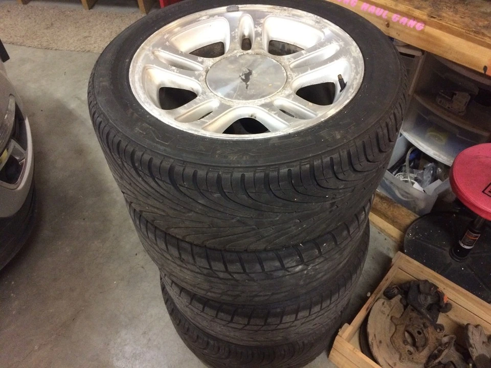

I still have not made up my mind on wheels. I cannot decide between 10th anniversary cobras or a 18 inch chrome saleen.

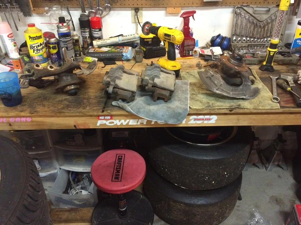

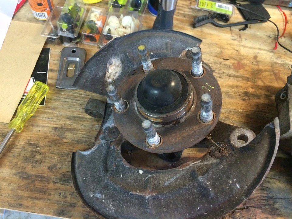

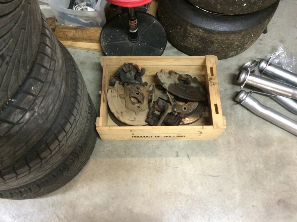

Well the parts are starting to pile up.
PBR Front's

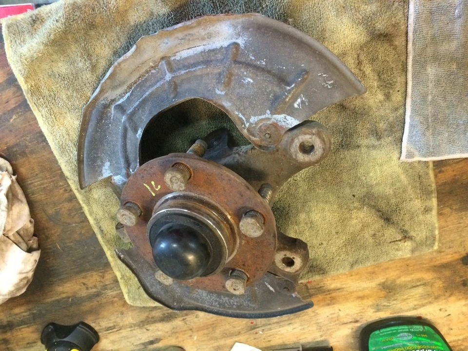

95 Spindles (I'll flatten out the dust shields)

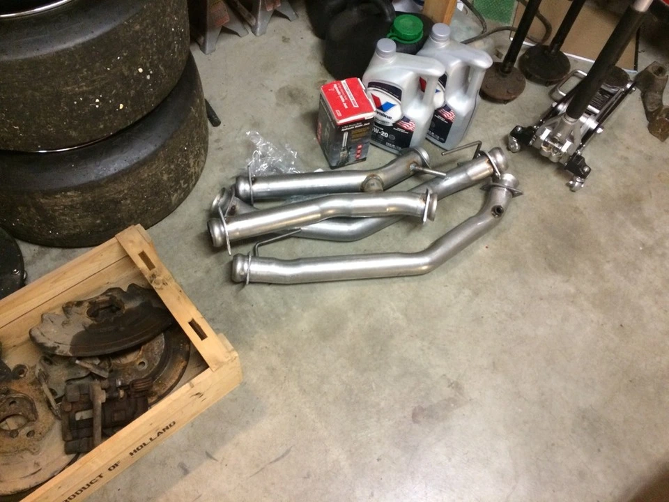

H Pipe

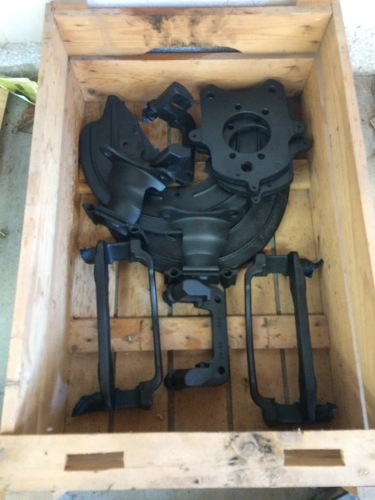

Rear brake assemblies
Wheels (yes, they will get painted and two new tires)

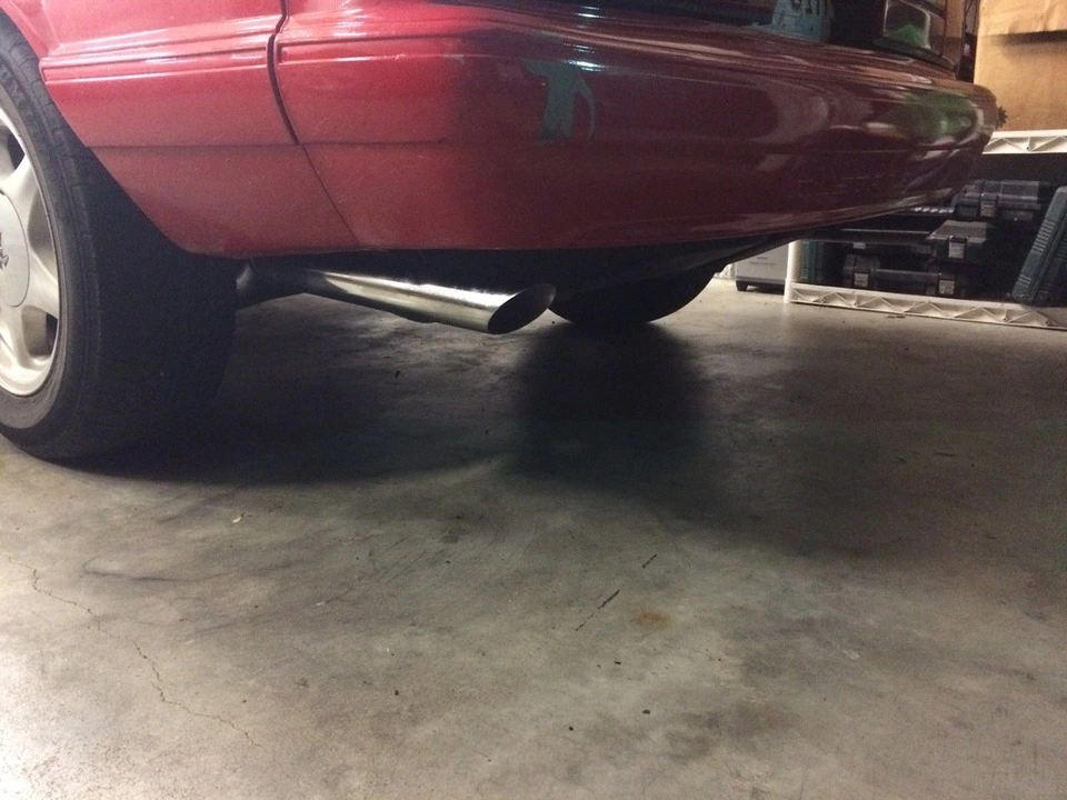

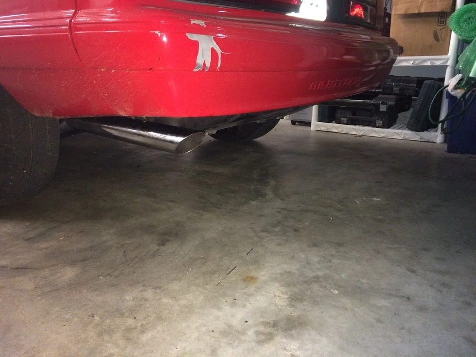

Cat back and tail pipes finally installed (Flow master forgot to expand one of the muffler outlets, not the most fun I've ever had)
The plan is to CLEAN everything up. Paint the calipers all red. Brackets/spindles flat black. And not pictured are new stock replacement rotors and ceramic pads. The rotors will be painted silver in the center and edges as not to rust (hate rusty rotors).
I'll get more pics as I make progress. I wire wheeled the pbr calipers a bit and they will clean off nicely.
I also have sitting in a box: 93 cobra master cylinder, booster, frpp prop valve, mm master cylinder line adapters, stainless front brake lines, as well as some other odds and ends to finish up the trim etc on the car.

Your brake parts look very familiar. I am leaving shields off mine. Note you will need to grind the spindles in two spots so the PBR pistons clear. You will note the interference when you try to bolt them on.

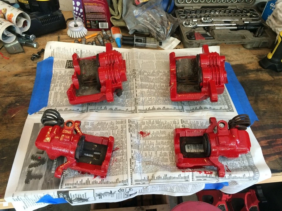

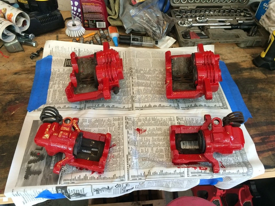

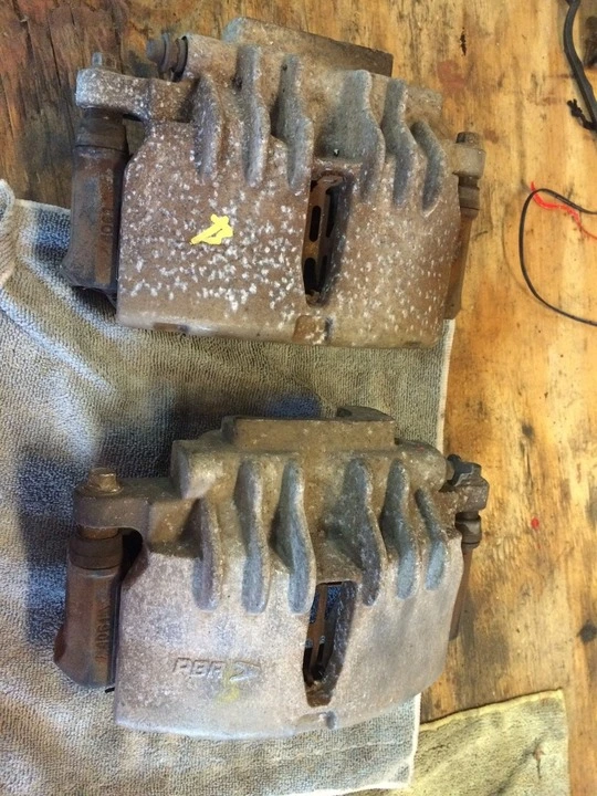

I did a bit of work over the weekend.
All brackets/dust shields are cleaned up and painted
The calipers are 1/2 way painted (they need flipped and the other side done)
The front spindles are cleaned up a bit
I still have to paint the booster and rotors along with the rest of the calipers. I should be ready in a few weeks to start the swap. The car goes off to paint today to fix the bumpers etc.

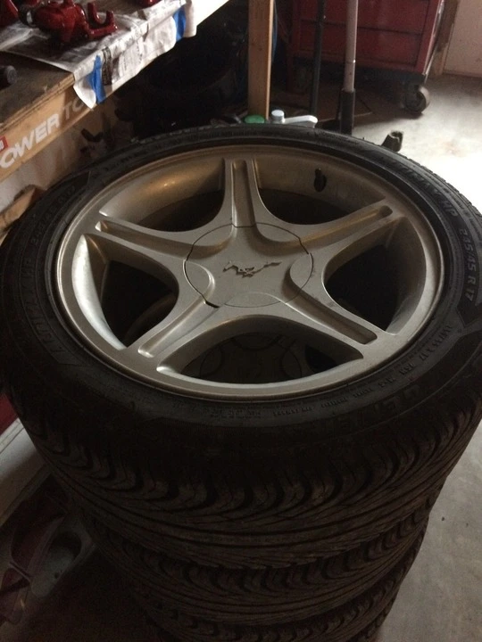

I also picked up a clean set of starfish wheels and tires. I decided I didn't want to put the refinish work into the split spokes (and they needed two tires).

I got the Calipers finished off last night.
Here are the starfish wheels that will go on until I can make up my mind on what combo I want to run.

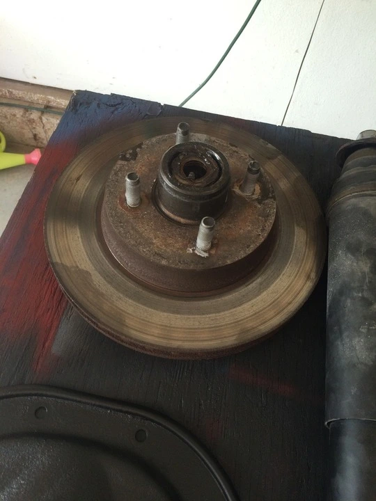

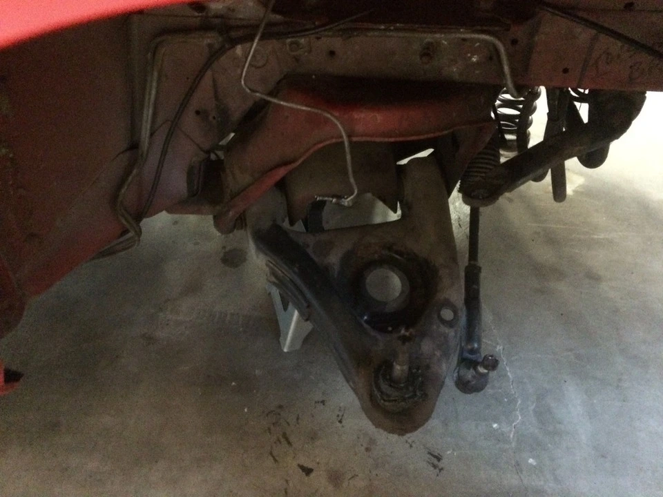

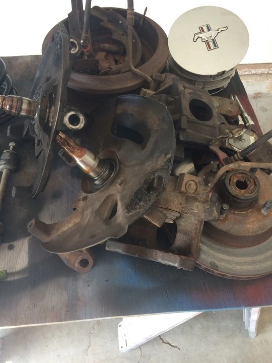

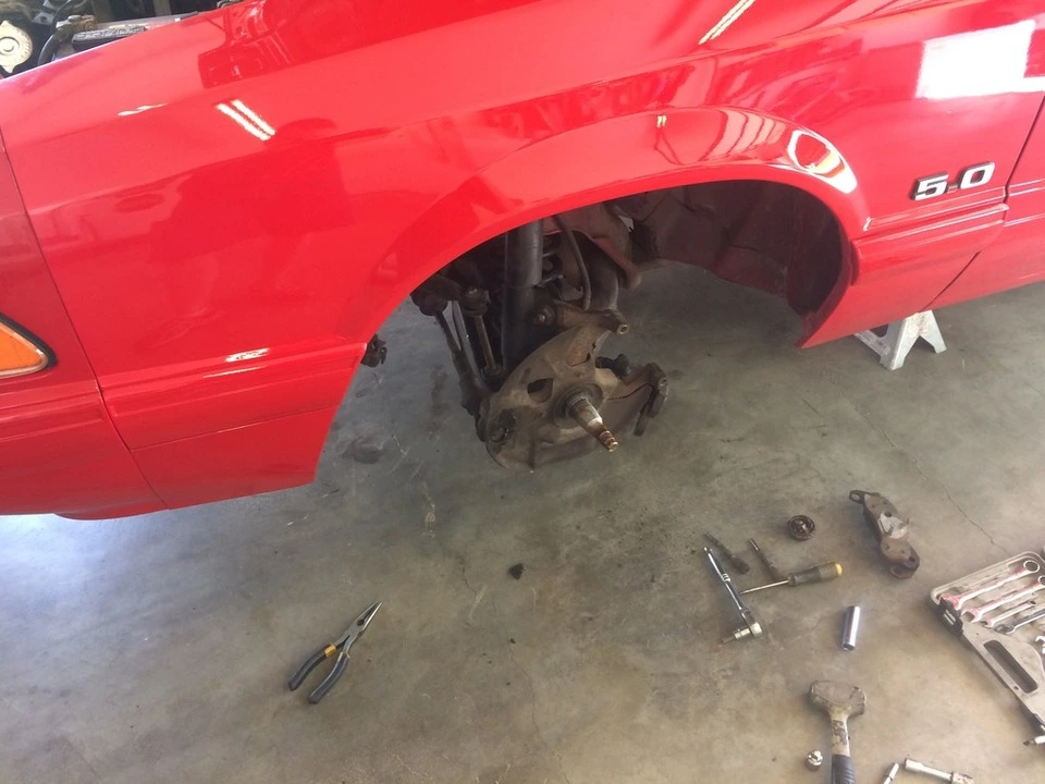

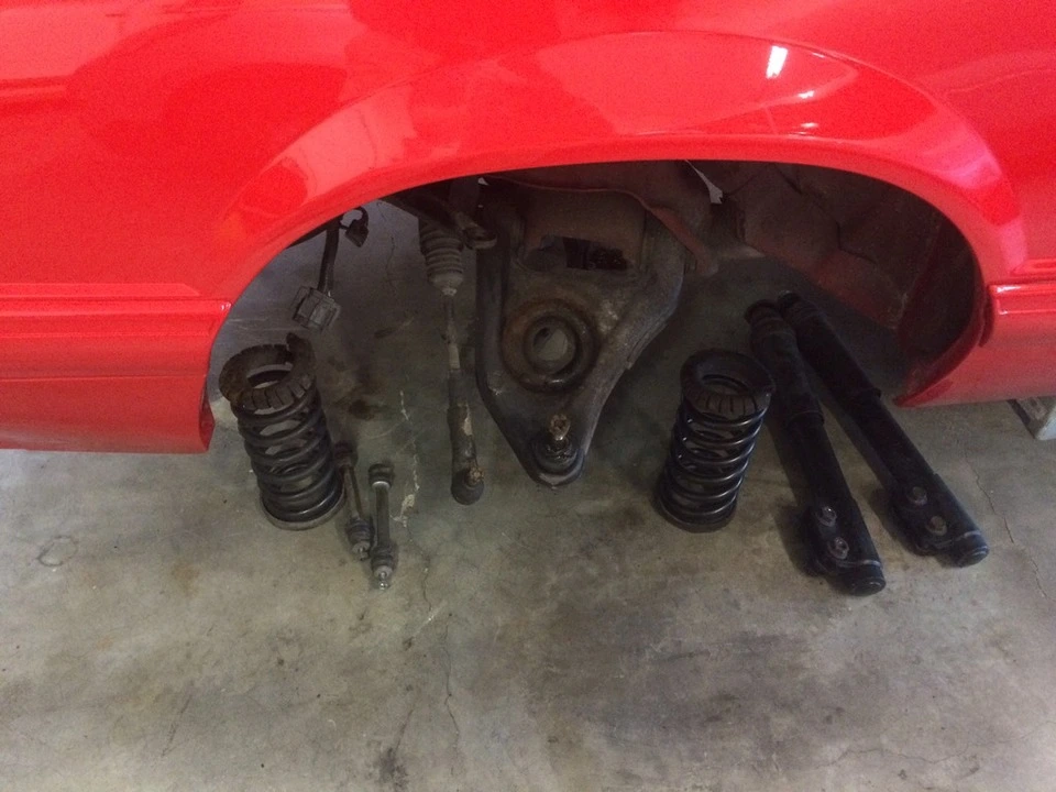

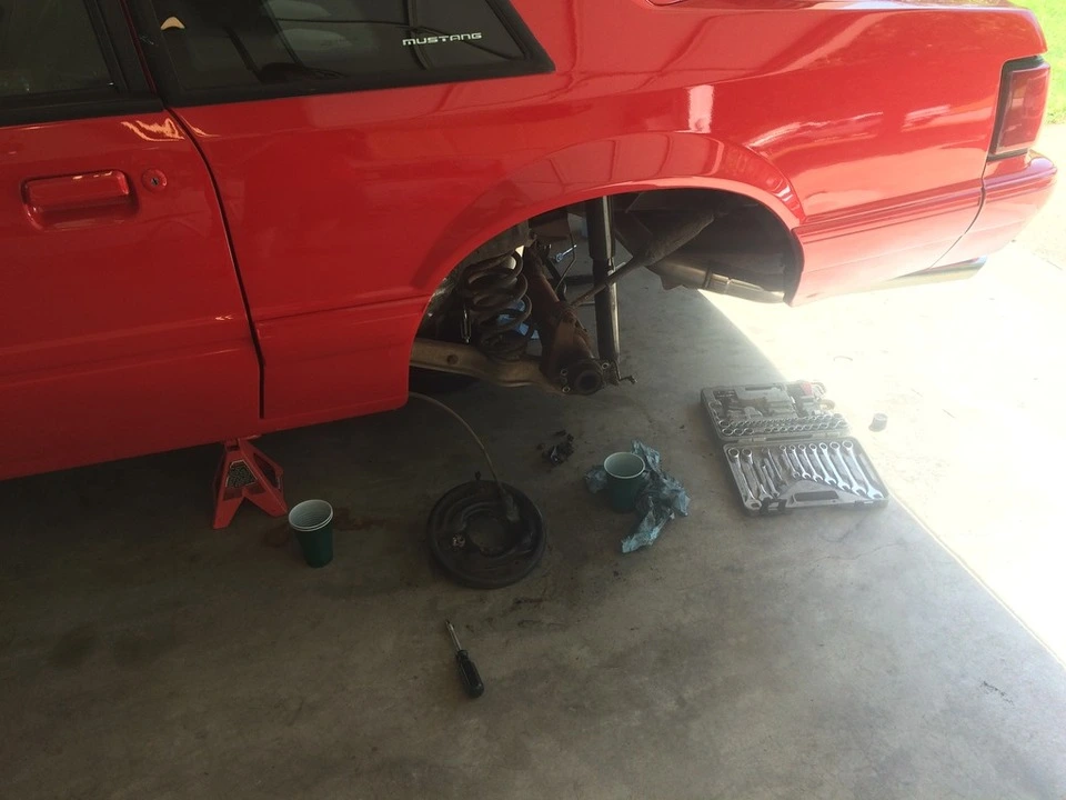

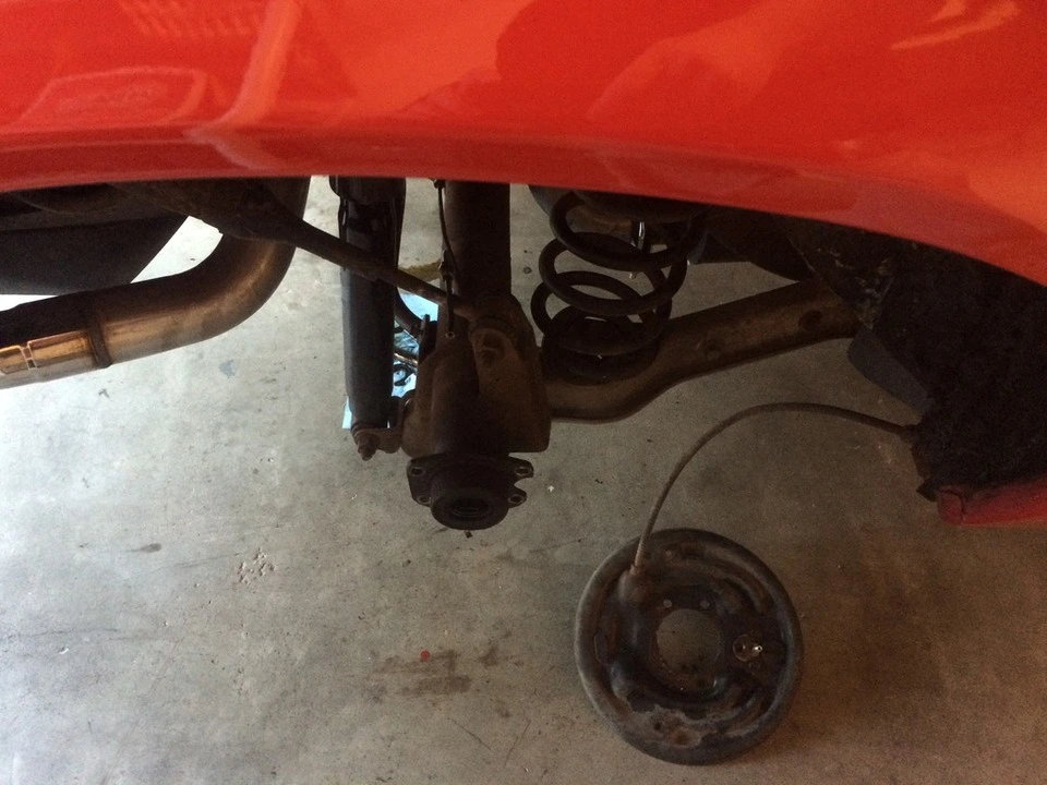

I have the 4 lug stuff mostly torn off. I still have to get the rear parking brake cables and brake lines off of the housing. Plus the master cylinder and booster are still in the car (was not wanting to do that all covered in grime).
Last shot on Pony's
Rear mostly torn down
Other side

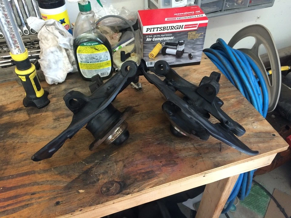

Fronts:
I will order up 94/95 ball joints and put on new outer tie rod ends just to ensure the car drives out nicely. No need in trusting this stuff with all the other new parts going on (just not a fan of pressing in/out ball joints).
Stack o left over parts

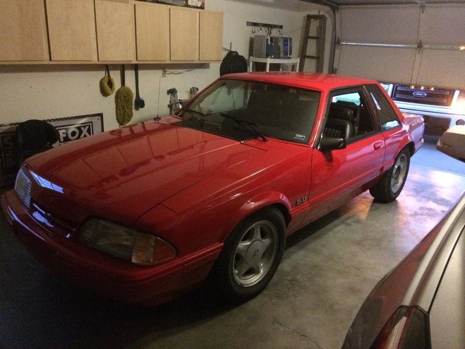

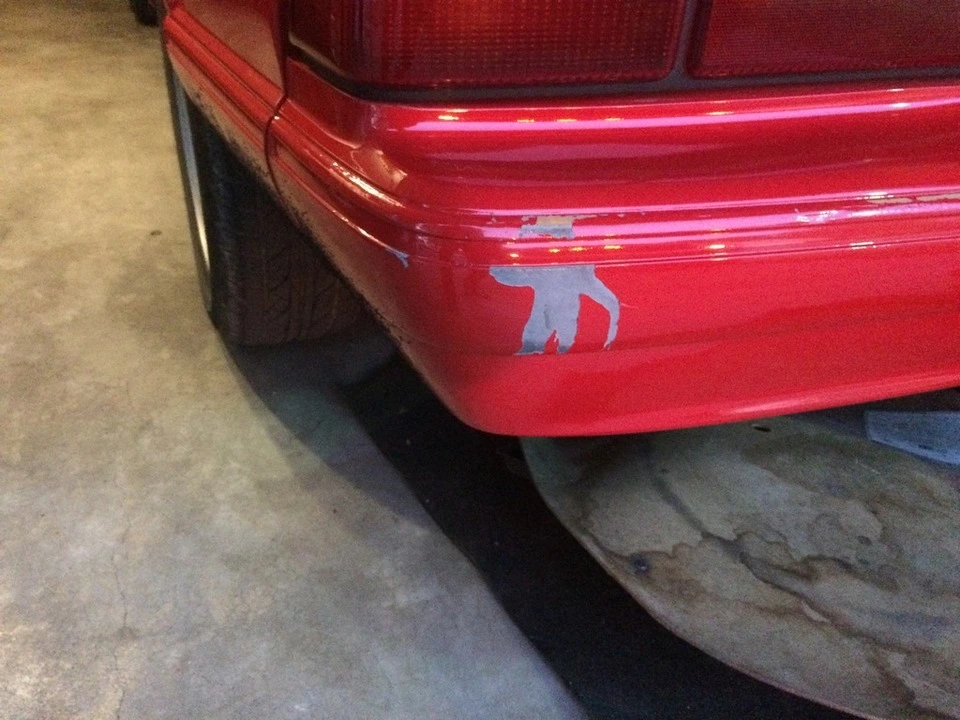

Now to talk about the paint: I got it back friday. Under bright light (like a painter would use) or direct sunlight it matches great. Under anything but bright lights it looks like this
