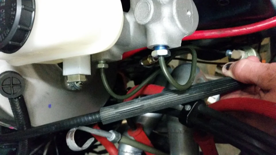

Well I got the car all but done. As we were bleeding brakes I realized the fittings I bought to eliminate the factory pro portioning valve won't stop leaking. I don't think I can tighten them any more than they are. It's a bit frustrating as noe the system is full of fluid and I've got to disassemble again. Otherwise it appears to be good. Even with the seepage he pedal felt like it should. I have to fix it as obviously it will let air in and cause issues.

So Orielly's hosed me. I didn't realize it at the time but they sold me the correct 1/4 union but a metric adapter instead of the correct 1/4 to 3/16. It screwed in just fine but leaked once you applied pressure. Makes sence now.
So to call LRS tomorrow and see where my plug is and go back with the factory prop valve.

Here is mine, I found you can buy bubble flare at auto zone with the correct fittings for the MC then I just rented the tool to do the double flare on the other end. Mine had a line lock installed so may be different. She's full of fluid and bleed.

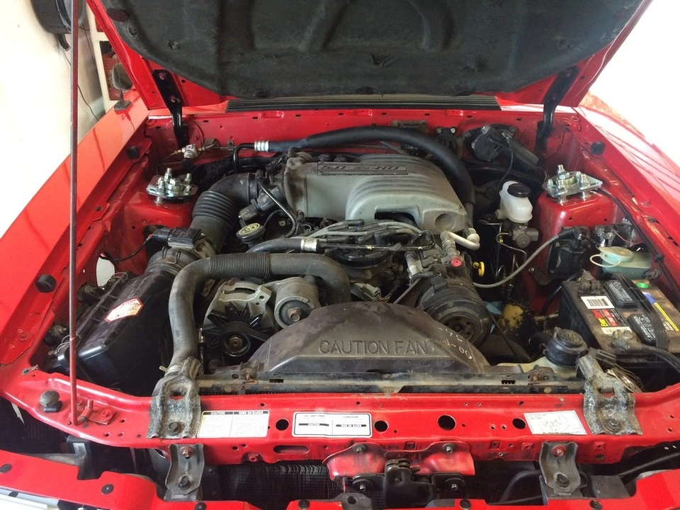

Here is some dirty engine bay ****. Wire tuck is mostly done. I'm aware the rest if filthy (that will be addressed soon enough).

So are you putting the prop valve back on? Or did u get the right fittings?

I will be putting the prop valve back on unless I can find the right fittings locally (I had no luck at oriellys or autozone) Those are about our only choices other than two odd NAPA stores that really don't have good selections.

Well no dice. It won't be here until Friday. I finally got someone at late model that gave a crap and they were willing to over night another one but it won't go out until tomorrow. Unfortunately I won't be attending the mustang mother road events this weekend as I simply can't get it finished in time.
Over all I appreciate this last guys willingness to help but am completely disappointed with the lack of follow up and let down of the last two weeks. I've called every other day and was promised it was going out that day. But it it what it is and I can't fix it now. I'll be lucky to get the car on the ground to attend the show sat but the car will be filthy. I'll have to cancel my alignment appt fri afternoon and get it done after its back from the painter again.

Dang, squeak. Can't you buy a pipe tap, drill it out and pipe plug it?

I just went digging around in the garage to find my old prop valve to measure it and get you a tap size, but I can't find it. Must have chunked it. I'm sorry man. Look at the cap that you remove to pull the guts out. Looking at prints online I'm almost certain you can drill it out and install a small pipe plug like maybe an 1/8"..

I have a tap set and suppose I could put a plug in it this eve. I really am not a fan of that even though I know others have had luck with it (My luck isn't near as good normally).
Latemodel is attempting to get the part sent out this morning in an attempt to get it to me tomorrow morning. That will give me a bit of time (with assistance from my awesome wife) to install and at least bleed the brakes. Then I can do the hillbilly alignment on it so it can be driven to the local show, then to paint on Monday, then once out of paint take it for a real alignment.

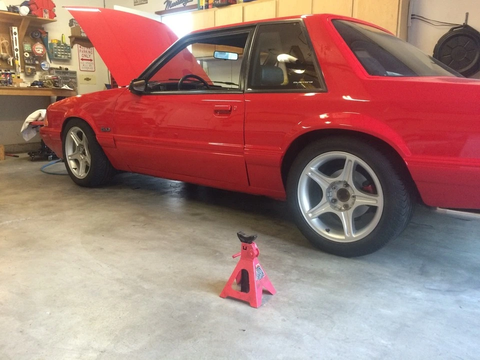

Well I was able to get it on all 4's last night in order to do a garage alignment on the Toe up front.
So the curse strikes again. Late model overnighted the part. Sent it yesterday, I got confirmation from UPS for 10:15 today (yesterday afternoon is when the conf was sent). Then last night I got another notice that they did not receive the part in time and it will be delayed another day (I assume that means Monday since it's not a sat del item). So oddly enough Snail mail is going to beat an overnighted package.
To add to my awesome adventure I stripped out threads in the factory prop valve (Not so sure they weren't previously stripped) and have to locate another one today. I'll miss my alignment and a HUGE Mustang only (once a year) Event this weekend due to the debacle. Sucks but is part of the Red car curse (the other red fox I owned fought me every step of the way too).
In the grand scheme it's just a car but man I'd like for it to go right for once.

Those are probably my favorite factory wheels.
Reactions: Boosted92LX and squeak93
Even with the centercaps off that car looks fantastic, doesn't it? That red paint is something else, man. Great car. Simple, clean, sexy.
Reactions: TOOLOW91, squeak93 and hoopty5.0
