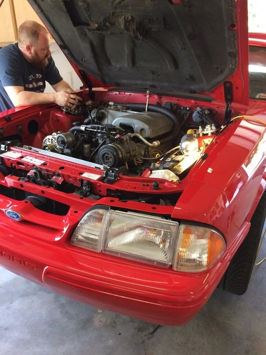

The bearded wonder is my buddy from Dallas. He was up (brought me a lot of parts, he is thinning out his collection). He also picked up a VERY nice t-top car freshly painted to take back home for a coyote swap.

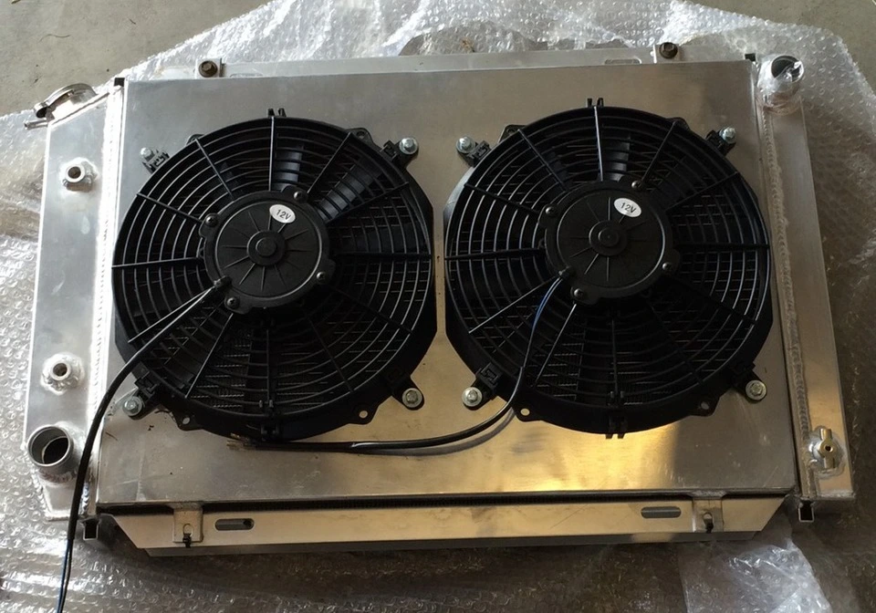

Here is a shot of the fans/rad before we installed them.

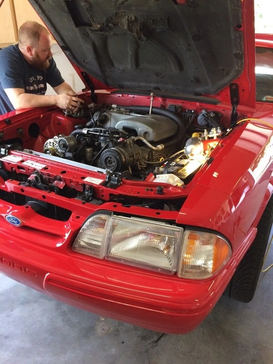

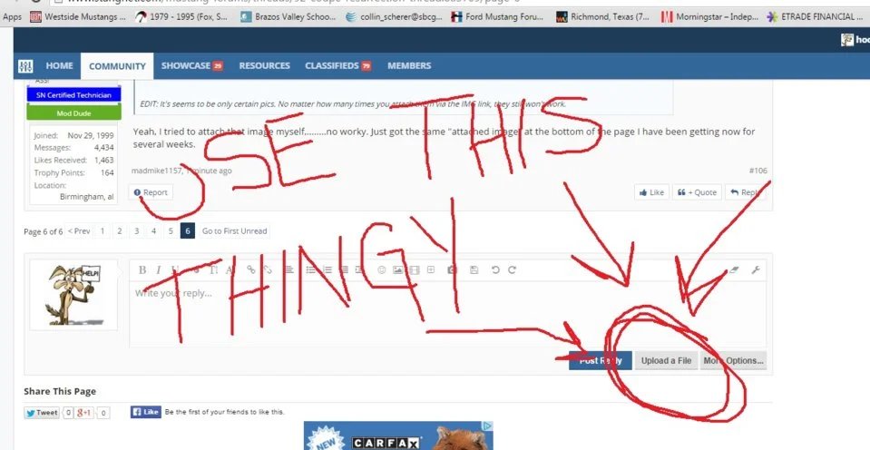

Yeah, I tried to attach that image myself,........no worky. Just got the same "attached image" at the bottom of the page I have been getting now for several weeks.
