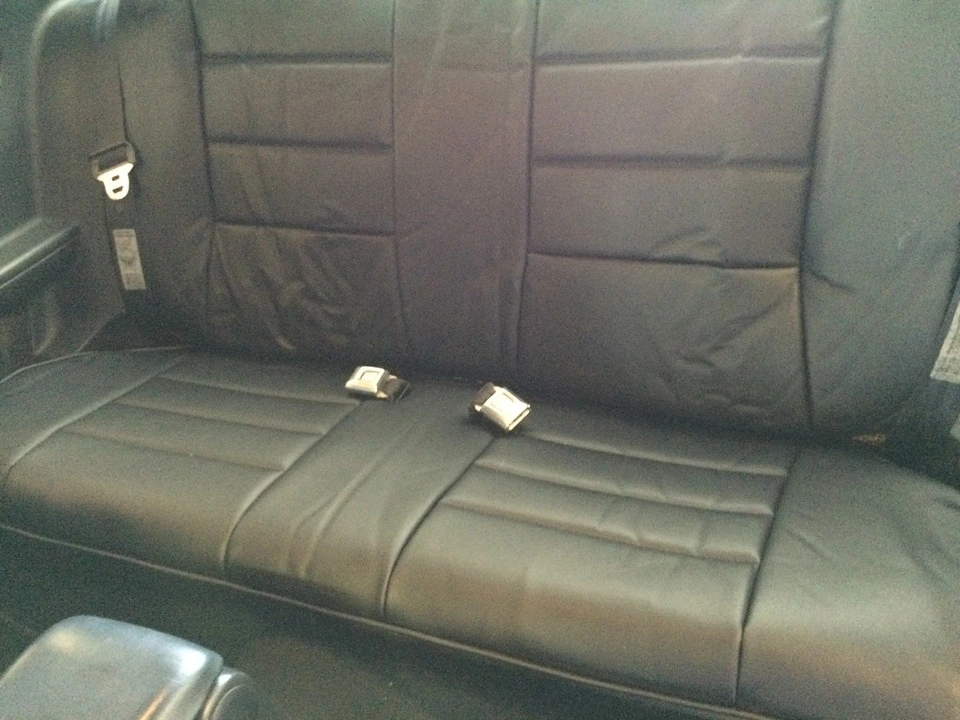

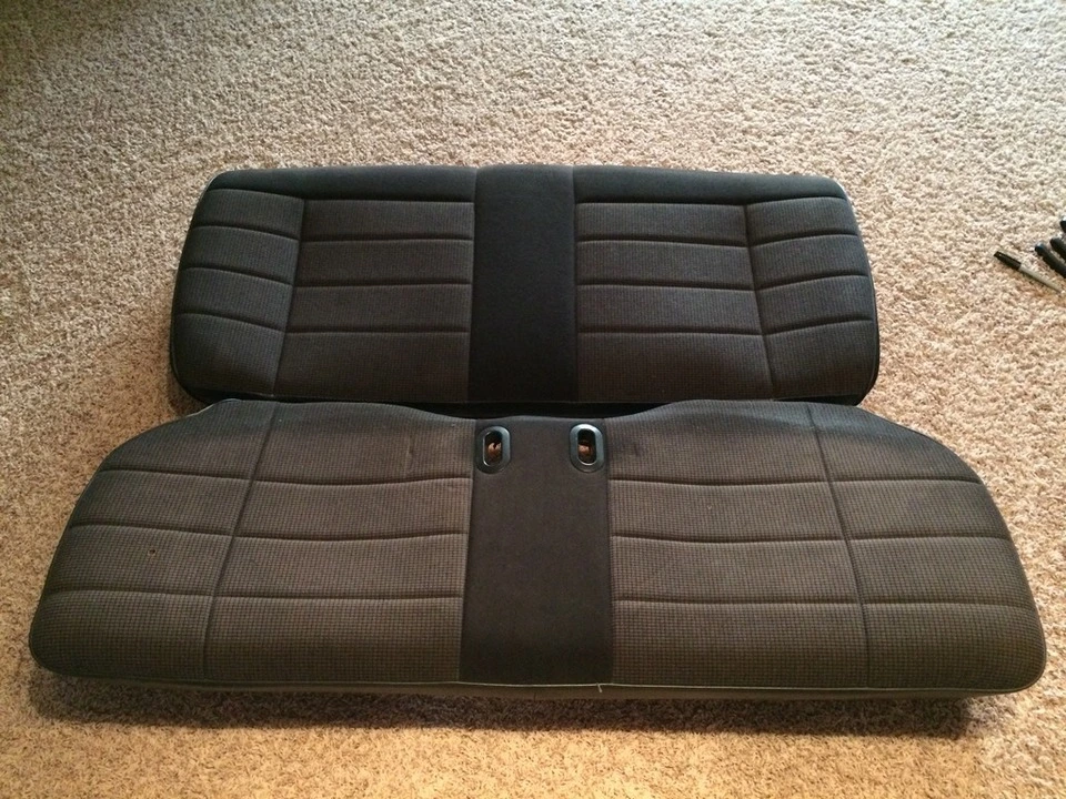

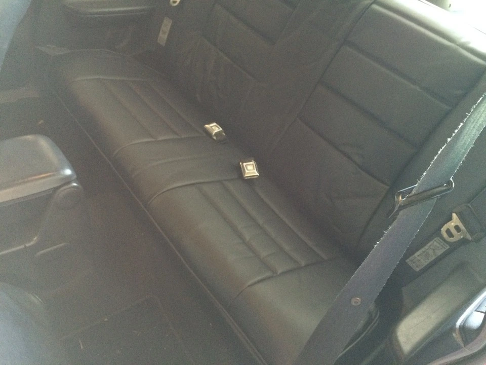

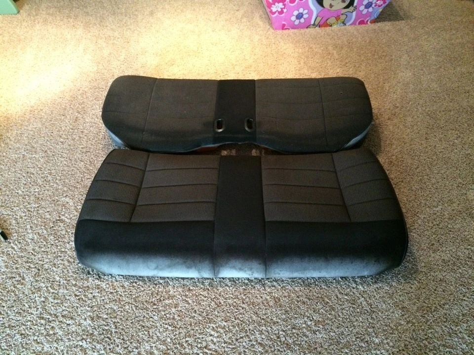

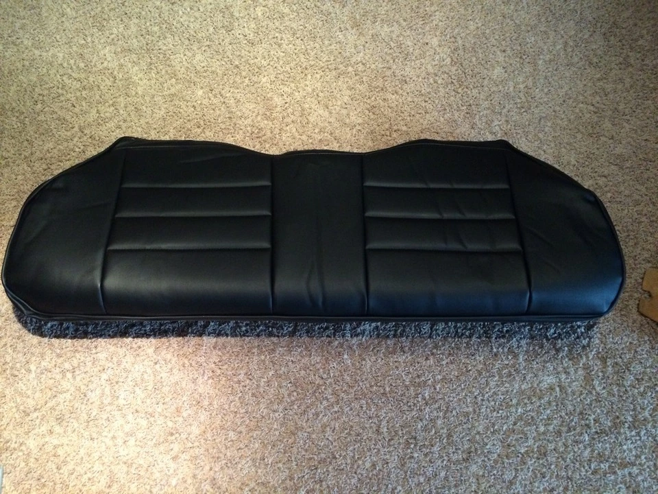

I've been busy. I finally got the rear seat material installed. It still has some "out of the box" wrinkles on it. They have mostly worked out since this pic. I'm not overly thrilled with the fitment of the material. It seems corners that are round on the factory seat seem to be made more "square" with the material. No worries. It looks a million times better than a cigarette burned and faded black cloth (my fronts are leather).
Old seats removed.
Notice the top of back portion is faded horribly.
New lower material installed (PITA)

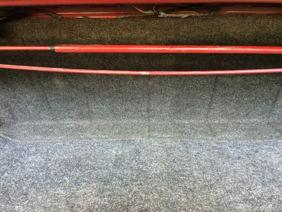

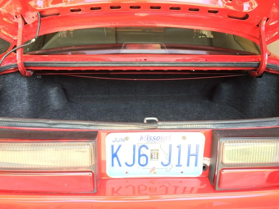

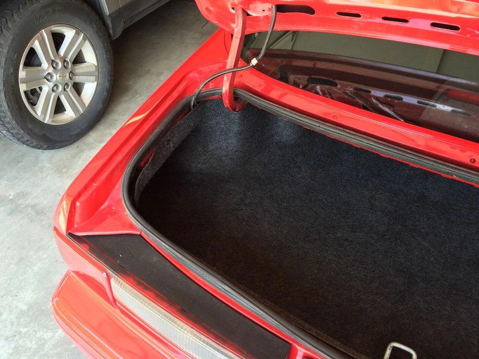

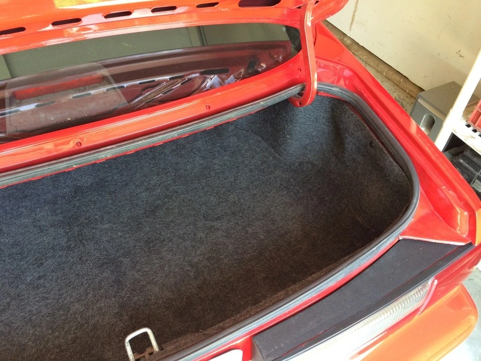

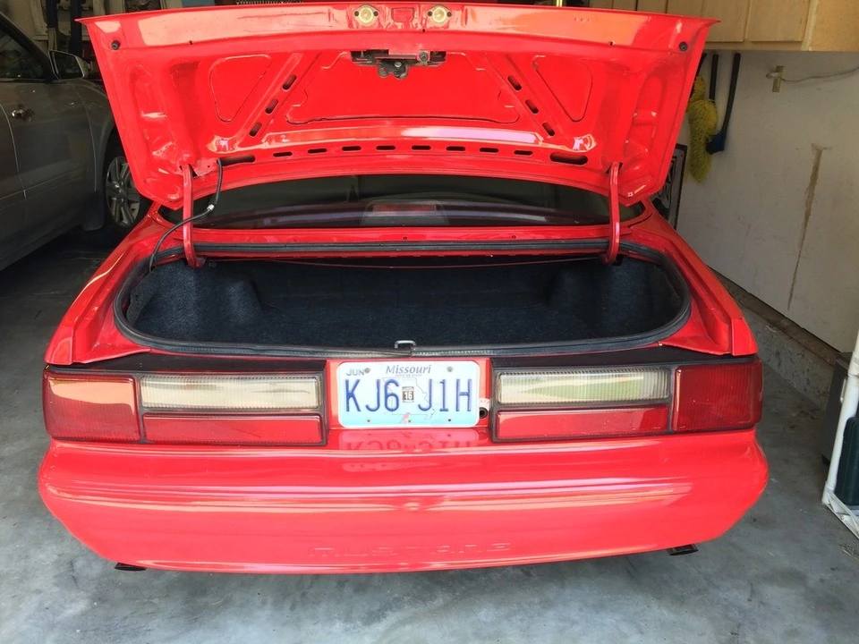

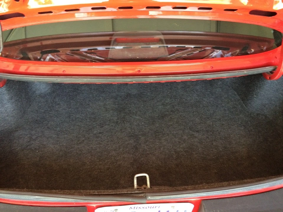

I also rehabbed some truck panels as my car had nothing in there before.
Notice the vert piece hiding the unsightly rear seat backing brace/etc.
Very nice.... take a hair dryer and you can try and massage the wrinkles out

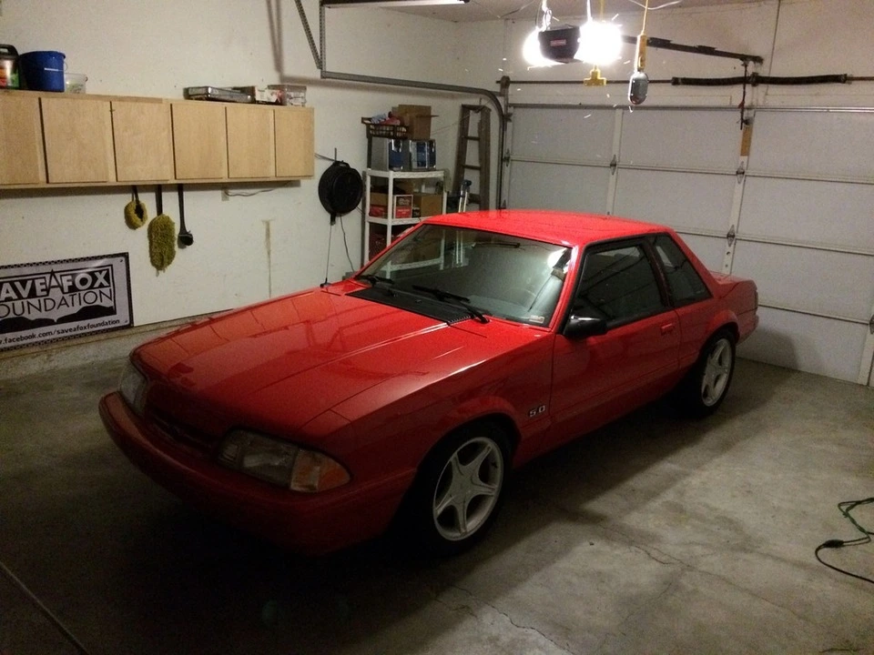

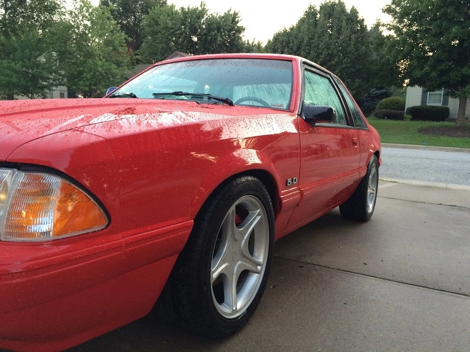

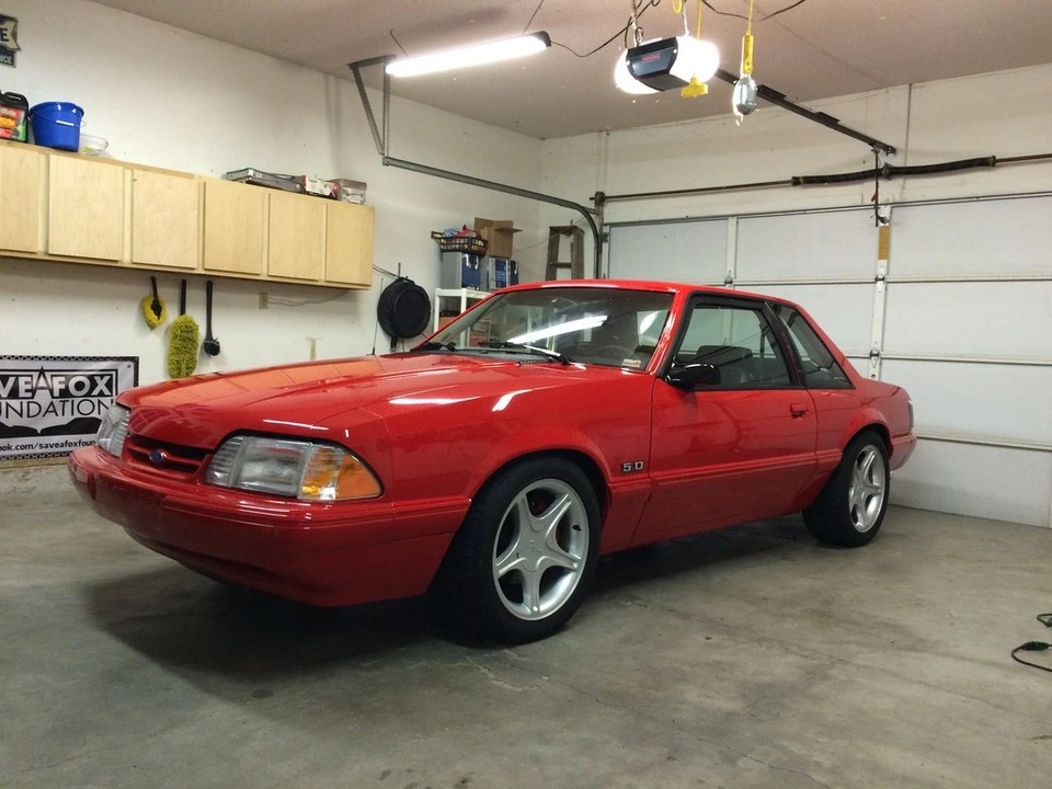

I finally got around to a full clay bar, meguires ultimate compound buff job and finished it off with Meguires Hi-Tech 26 yellow wax. The paint is so much smoother now and is finally free of all the black rubber dot/specs from the PO's burn outs.
Garage shot for reflections
Outside shot. It doesn't even begin to show how much better looking the car is now. The red is a lot deeper in person.

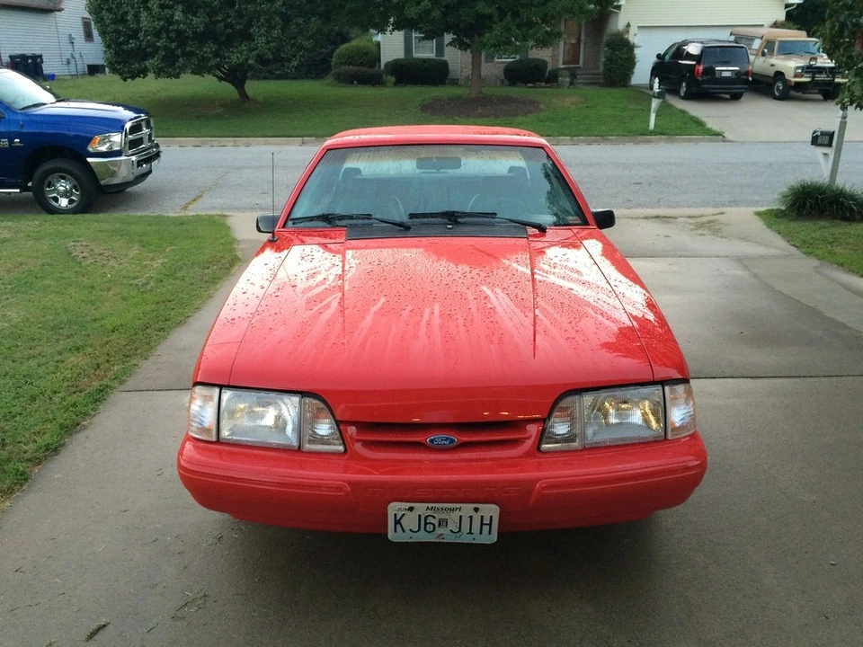

Well I hit a bit of a snag. Driving around Sunday the steering got a bit tighter and tighter. About 5 blocks from home I made a turn and lost all power steering.
I put a new pump in a few months ago and flushed the system (or so I thought). Upon inspection the pump didn't loose any seals and is making a bit louder whine than normal (whined from day one of install yay). My fluid was FILTHY and almost boiling (smoking once I opened the cap). I guess there is debris in the system that is running through as when I checked everything the power steering was back but caused the wheels to be "jumpy" when turning the wheel. So I'll disassemble the lines again this evening and do another flush until I get clean fluid (maybe I rushed it last time, I honestly don't remember). I also ordered an inline filter for the return line that I'll splice in once it arrives.
How about some water beading up on the awesome wax job pics to make me like the car again lol.....

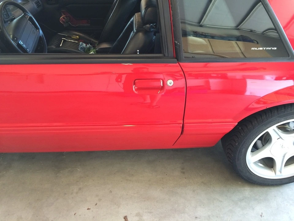

Anyway, it lite a fire under my rear and I worked on it a bit this weekend (after attending a car show).

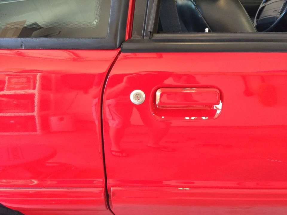

I pulled the lock cylinders and remove the red paint from them.
I also pulled the front/rear window trim and will be blacking it out vs it being red like the rest of the car is (why oh why). I spent a good deal of time getting the locks to work correctly again. I just need to run down a new pass side switch as it is not working correctly (locks and window both work from driver side but the pass side is sketchy).
