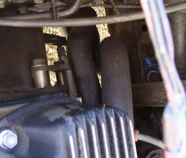

2.) Yup, he'll also need one of these:
It's that little bracket hanging off the scattershield where the stoc z-bar pivot used to be. 5.0s blocks don't have that provision on the block itself like the earlier engines.

thanks so much for the input guys, it helped us out a lot as far as pointing us in the right direction. It is very appreciated, especially to the guy that attached the pics. thanks again! -Matt
