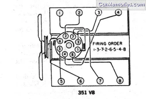

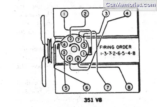

2 o'clock would have it firing on 8 would it not?
I was saying turn it so number 1 is now where the 8 is. I have just found that this gives you the most clearance for adjusting timing when the vacuum point is straight out. I know it will work where it is, I just find it easier this way.
I always referred to this, but that's just me. Different applications may apply.

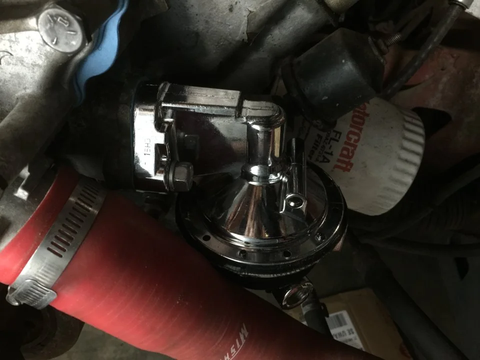

the front of the motor is all back together. plus i got the mechanical fuel pump installed. it has been slow moving but i am being carefull and trying to not make any mistakes. I haven't put coolant back in the car yet, i am not to confident the timing cover will seal. it was alot of sliding and moving around to get it on there and bolted down. I also bought a 85 mustang throttle cable and got that bolted up.

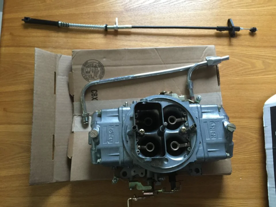

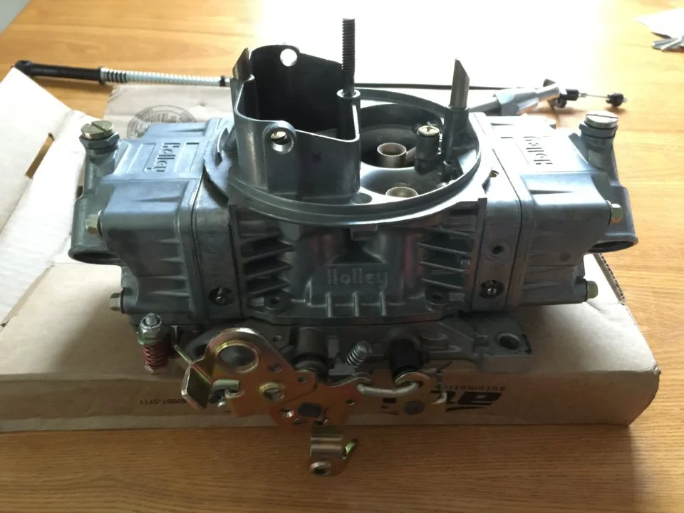

i ended up buying a holley 4150 carb. 750 double pumper with manual choke. I didn't want to go used but a speed shop near me had one they tried on a motor two months ago for the dyno and didn't like it. so it is in great shape. i got it for 285. plus i was able to get a dual feed line off of the guy for another 5 bucks. I was pretty pumped about that because the dual feed line stuff is like 65 bucks on summit.

So then, you went from asking if a 750 vacuum sec carb was gonna be too much ( which it was) to buying a used mech secondary 750 anyway?
Firstly, why do you spose they had a " used" 750?............Two guesses.
It was either too big, or too small for the previous application. And given that the norm is to over carburet the engine, it's already been too big once. That one has already gotten 1 strike against it.
Do you know what you have to do to try and make a carb that is too big less of a pig?
It gets opened up, and rejetted. Squirters get changed, power valves get changed, and it was probably still too big. You'll be able to tell that by looking at the four screws that hold the bowl on, there may be evidence of tool marks like are on the float height adjustment screws.
Don't take my word for it, take it from the manufacturer of your carburetor.
http://documents.holley.com/techlibrary_selecting_a_carburetor.pdf
They've already got an example of your C.I. and VE ratio ( 85%) for you to see.
Even if you use the top chart and figure your engine at 100% VE, ( which it ain't. Most used engines are only capable of 85%, and that's being generous).if you redline the engine at 6000 RPM, the recommendation is for a carb rated to 600 CFM, and if you increase the redline to 7000 RPM, the recommendation only goes up to 700 CFM. When you take the 15% differential back out of that, you get a real world recommendation for a 600 CFM carb.
Then, for a real taste of a reality sandwich, look at the next chart rated for a double pumper where they recommend going even smaller than rated CFM. recommendation because of how much extra fuel gets added when you mat the gas pedal .
Even if it hasn't been opened up, it will be. You're probably gonna to drop jet sizes significantly to get it lean enough ( if you even can) where you won't have black smoke coming out the tail pipe, and burning your eyeballs out while idling. And what does black smoke mean besides the obvious boys and girls?...,.......less power.
Let's talk about jets. Know what's involved changing jets in a 4150?
Gas. Gas all over the place. You have to remove the float bowl to get to the jets ( which last time I checked were like 15.00 a set, and you're probably gonna have to do it more than once.) the float bowl is full of gas. And when you remove the bottom screw, it all drains out on your intake. Now that's not the end of the world, you can get things to catch the fuel, or even use an old rag to drain into or You can also remove the carb entirely to do that, but the fact remains, that you'll have to.
Additionally, there are float bowl, and metering block gaskets that typically stick, and tear when you remove the bowl, so make sure you buy those too. After all of that, it may still be too big.
( if you could make a 750 run as lean as a 650, there wouldn't need to even be a 650)
Secondly, a used carb may have been some bodies gremlin. Unless I knew the guy selling the carb, and knew why he was selling it, I wouldn't buy it. When they work properly, they still need to be fiddled with every now and then. When they don't, you go out and buy a Taurus .38, turn it 180*, stick it in your mouth, and pull the trigger.
There's always an exception. A 750 DP on a 351 drag raced exclusively may run great, it may need even more. But a drag raced engine is ran WOT 95% of the time. It doesn't have to idle that well, it doesn't have to cruise, and gas mileage is of zero concern. Do yourself a favor, spend the money, and get the right thing. Take that one back before you fill it with gas, and bite the bullet, and either buy that Summit 600 CFM vacuum secondary unit that one guy offered that only costs 259.00, or one of 650 CFM pieces that I posted,
Summit bought the design from Holley, and it's theirs exclusively. That carb comes in both 600, and 750 sizes, the top comes off entirely, so there's no need to drain the fuel out for jet, and power valve changes. It uses standard Holley tuning junk, and Summit stands behind the thing w/a dedicated tech department specifically for getting the carb dialed in. I had the 600 on my 4.6 in the last car. I had to drop the jets in the thing significantly to get it to run lean enough on that tiny assed engine, but after that, it ran perfect.
you can thank me later.
Madmike1157,
I appreciate your concern, but from what I have read and formulas I have seen this motor comes at just below 650 and that is the minimum recommendation.
the carb is only two months old. He bought is brand new from summit and even had the receipt. this isn't some old carb that has been kicking around for 6 years with people fiddling with it forever.
The guy I bought this from owns ones of the biggest speed shops I have seen and is only a little over an hour away. He Is well respected in the drag racing community. The motor his customer wanted to try it on was a pretty much bone stock Chevy 350 with even a stock cam and intake. He even stated that once I get it on i could go down there and he would me tune it if i needed help
I do understand what is needed to tune a carb. it will be messy but no matter which one i bought i was probably going to open it up and fiddle with it to get it better. I am not an expert and i haven't seen people more divided than i have on carb choice for a car. I may have bought the wrong one. If that is the case than i will sell it and probably lose a couple bucks then buy a different carb. I might buy a 650 anyways just so i can see the difference for myself. that will be the real test.
like i said before the guy I bought this from wasn't some random craigslist person that I am never going to see again.
some of the detective work you talked about in the begining of your post is some of the exact same stuff I asked about and researched. I can't stress enough how much I am not an expert and just learning. With all the information I had this seems like a good idea at the moment. Maybe in a month or so when i get the car going I will be back here laughing at how right you are.
i read that document you posted. on the second page they are even saying it is a toss up between the 650 and 750 for a light car with quick gearing. Also by looking at the line on the drawing it is looking at about 685.
