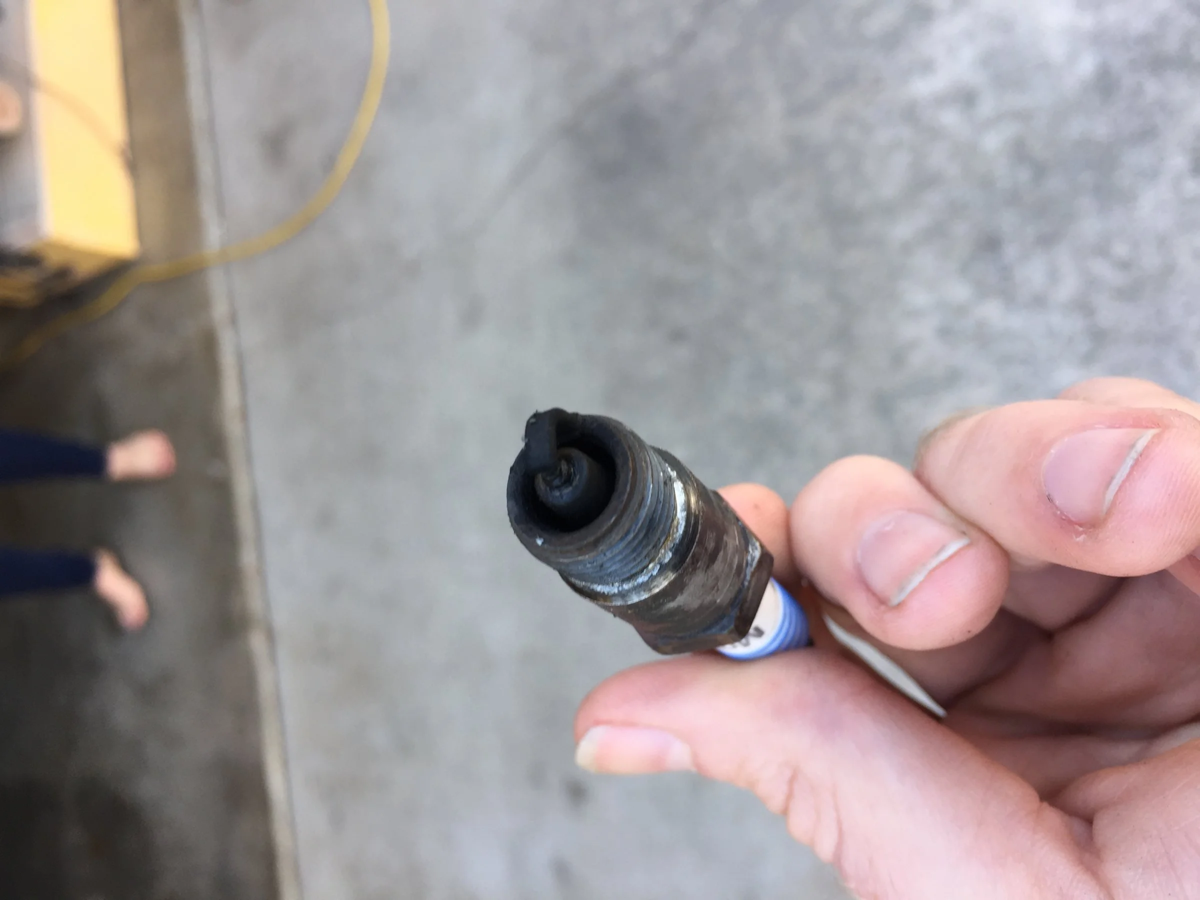

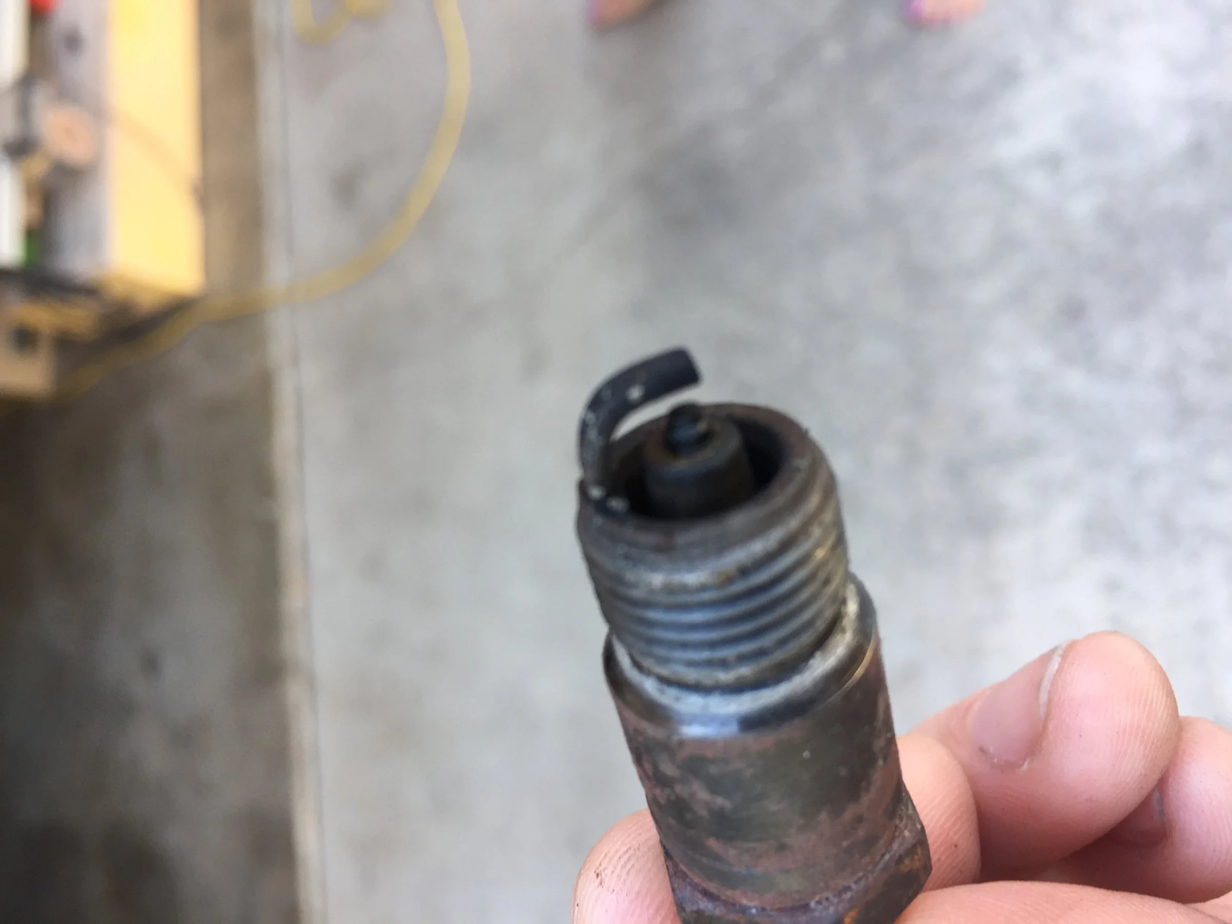

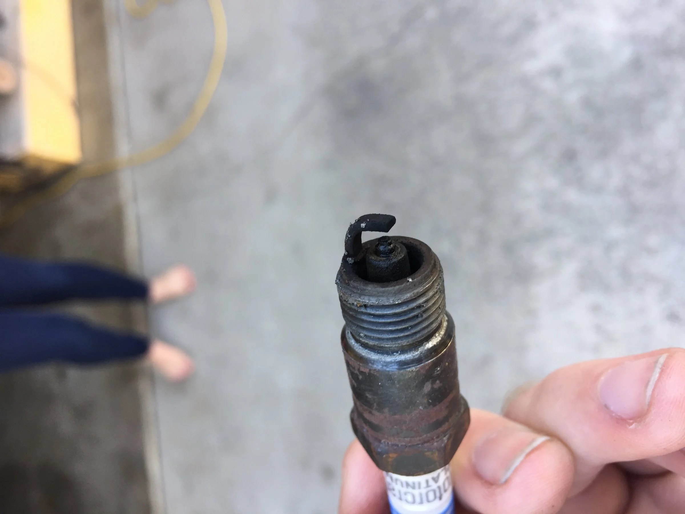

Engine 93 5.0 Car Won't Start, Oil On All Spark Plugs!!
This is the old plug from cylinder 1. It's definitely gas and not oil
