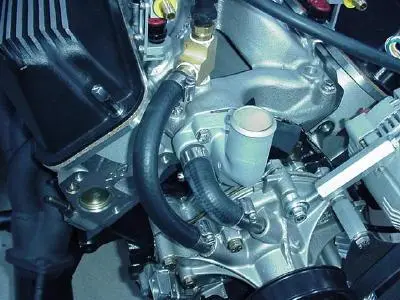

Or you could completely remove the hard black heater tube assembly together with the heater hoses and do this:
It's an ECT sensor elbow and it allows you to reinsert the ECT sensor in its stock location while still having a hose going from the intake manifold to the water pump. Removing that heater tube assembly also makes it much easier to remove the passenger side valve cover.
