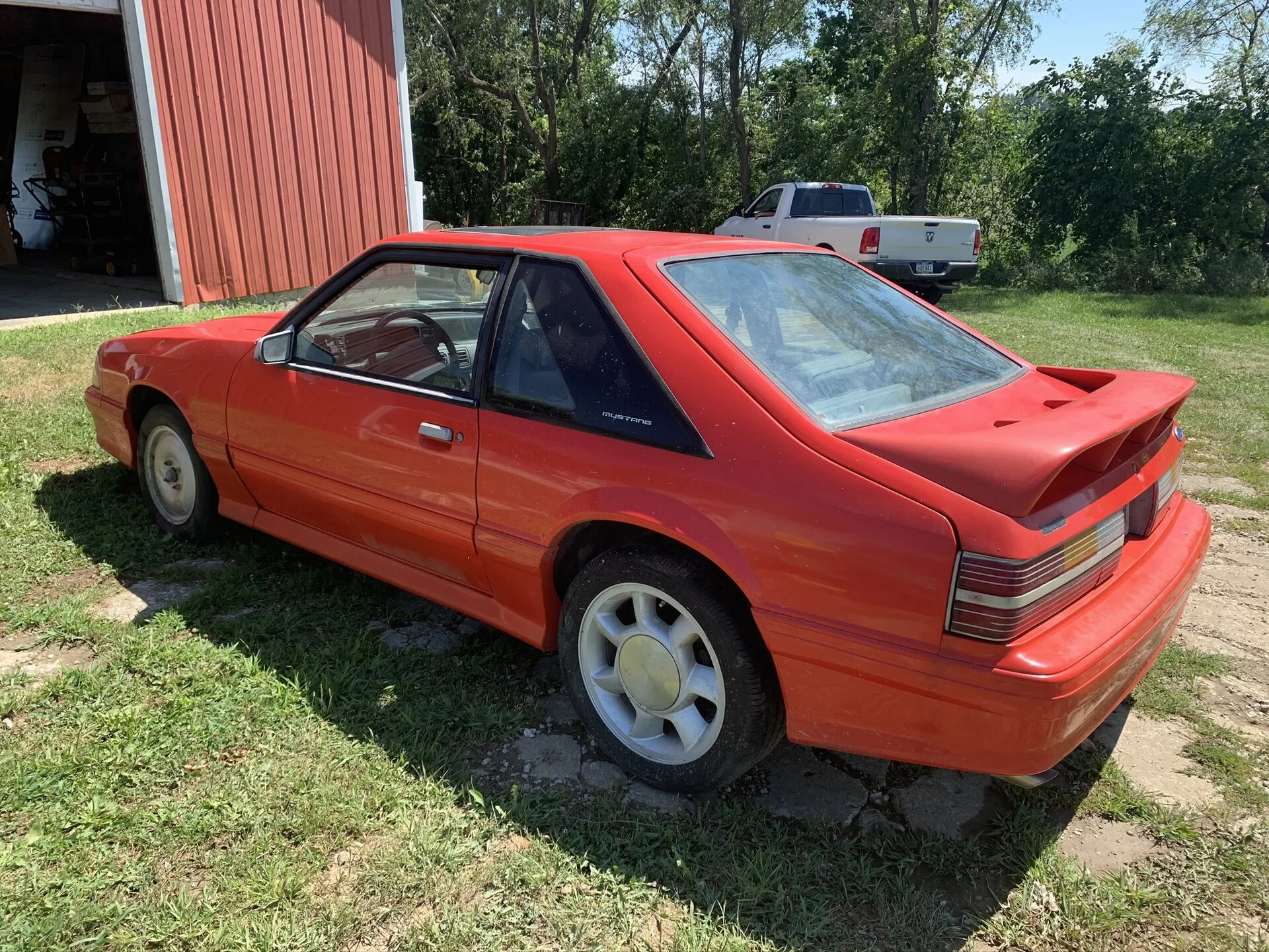

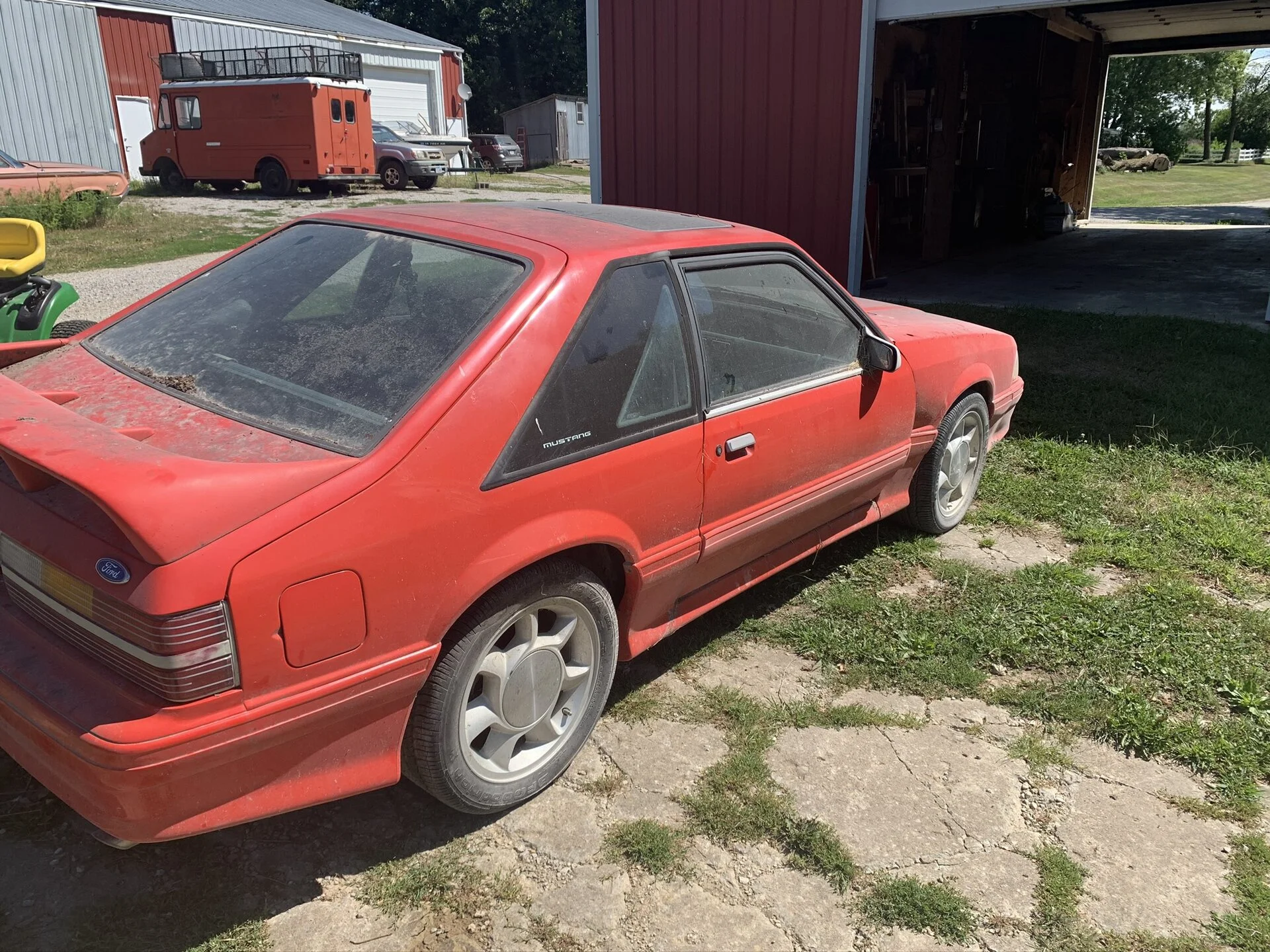

I got my hands on a 93 cobra that’s been sitting g under some trees for over 15 years. It ran when it was parked and has under 37,000 miles on it. It definitely needs some work both things known and unknown I’m sure. When it was parked he said it needed struts and there was a vibration in the clutch pedal. The good news is that there’s no rust on it and it doesn’t appear any mice got inside it and it cleaned up pretty good with a pressure washer.

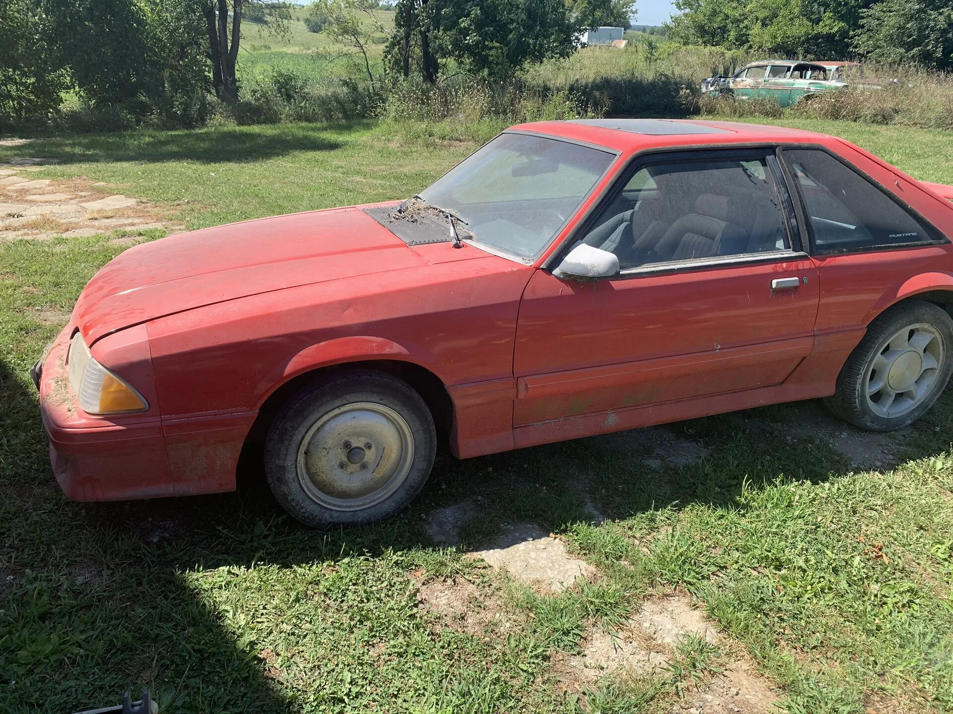

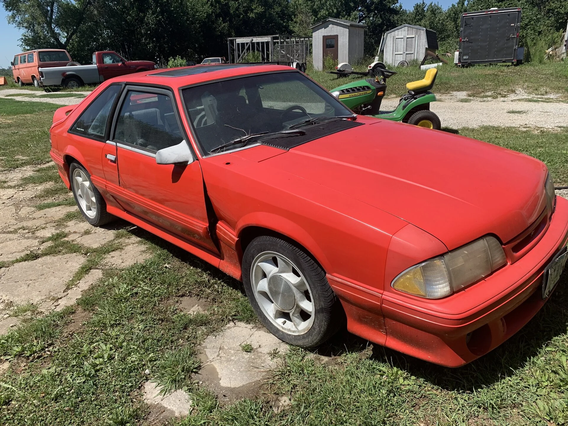

this is how it looked when I got it home. I do have the rim for where the spare tire is.

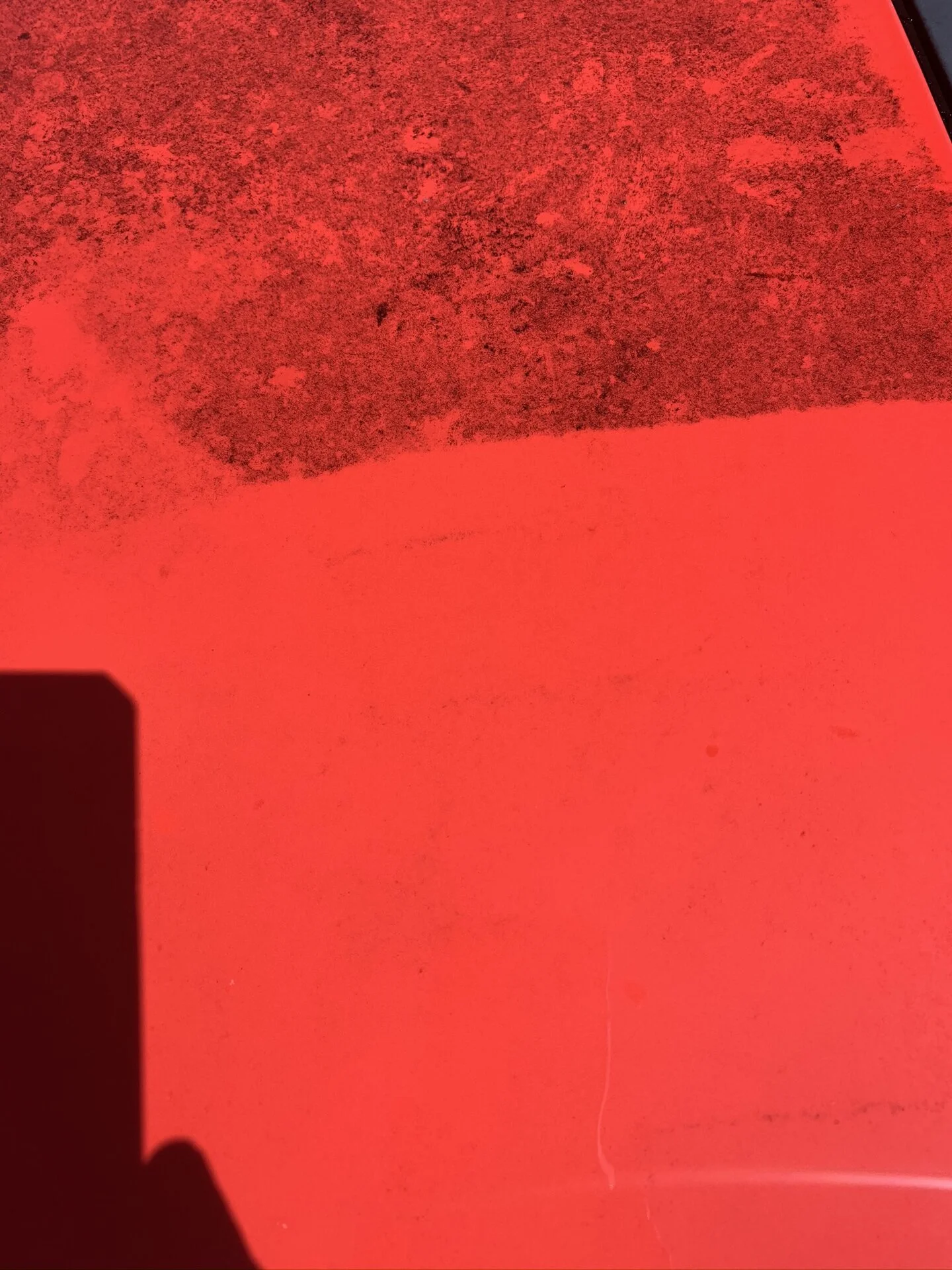

A quick clean up and it looks better.

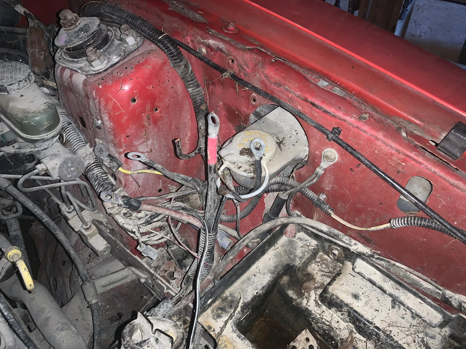

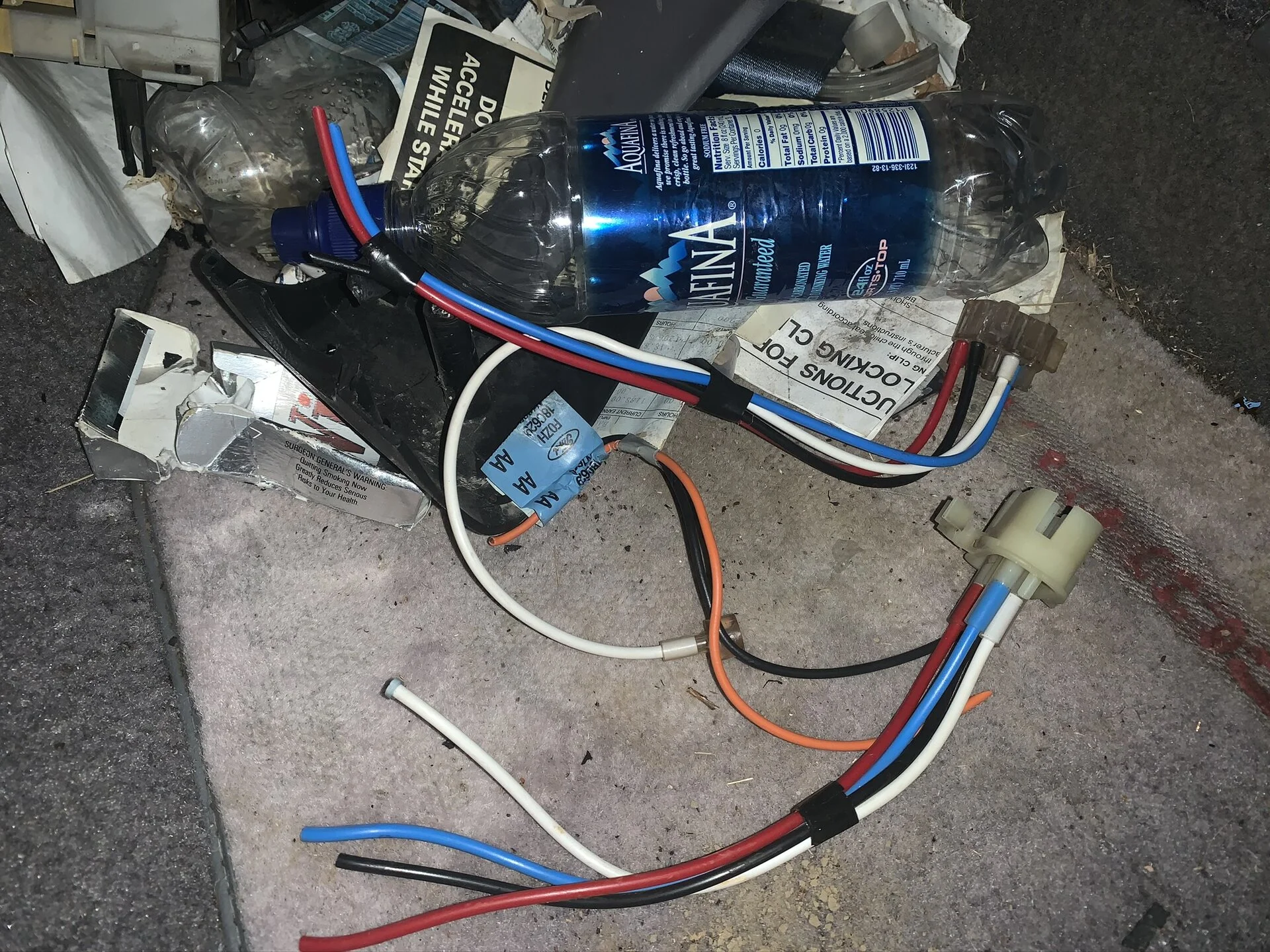

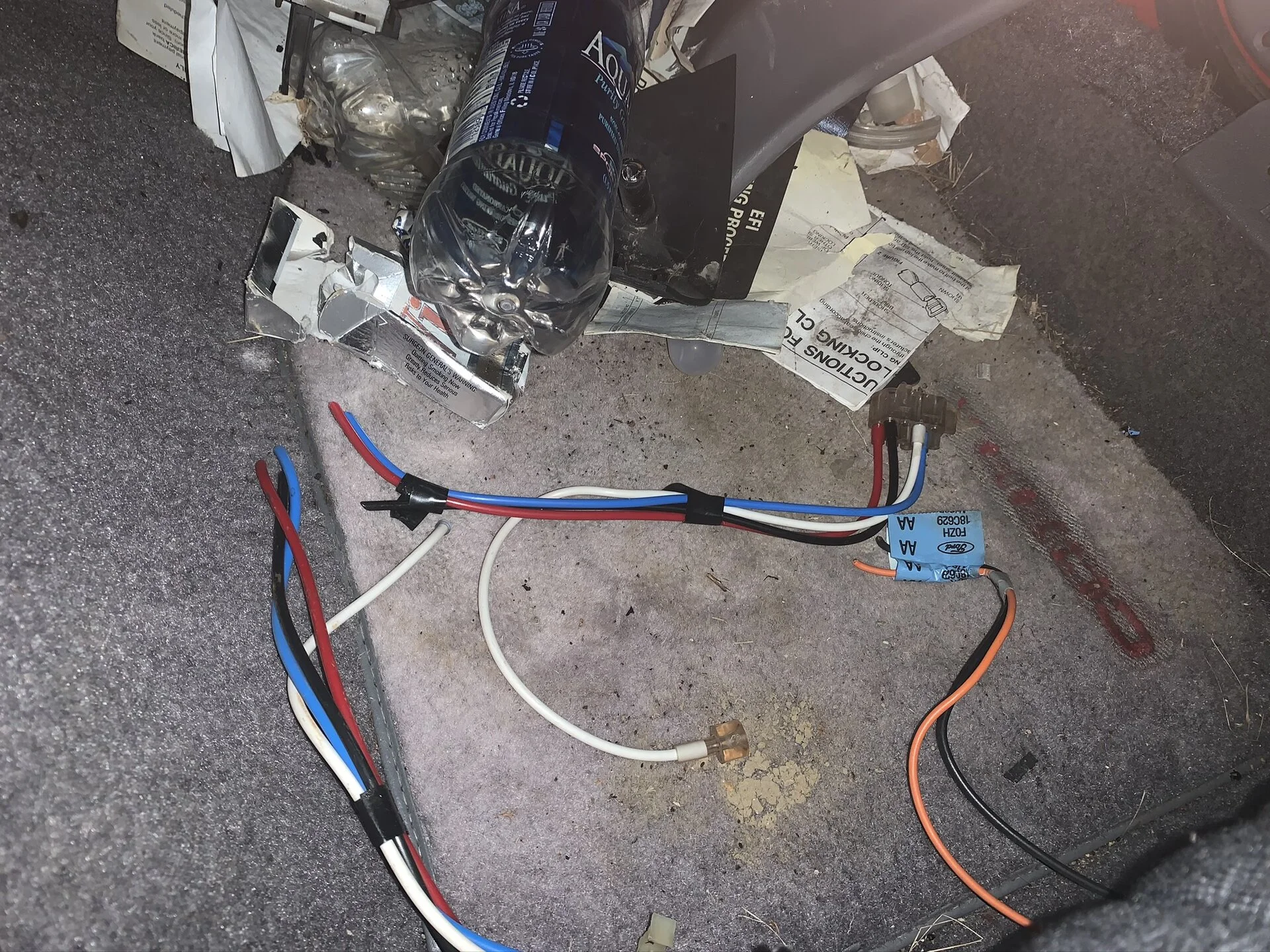

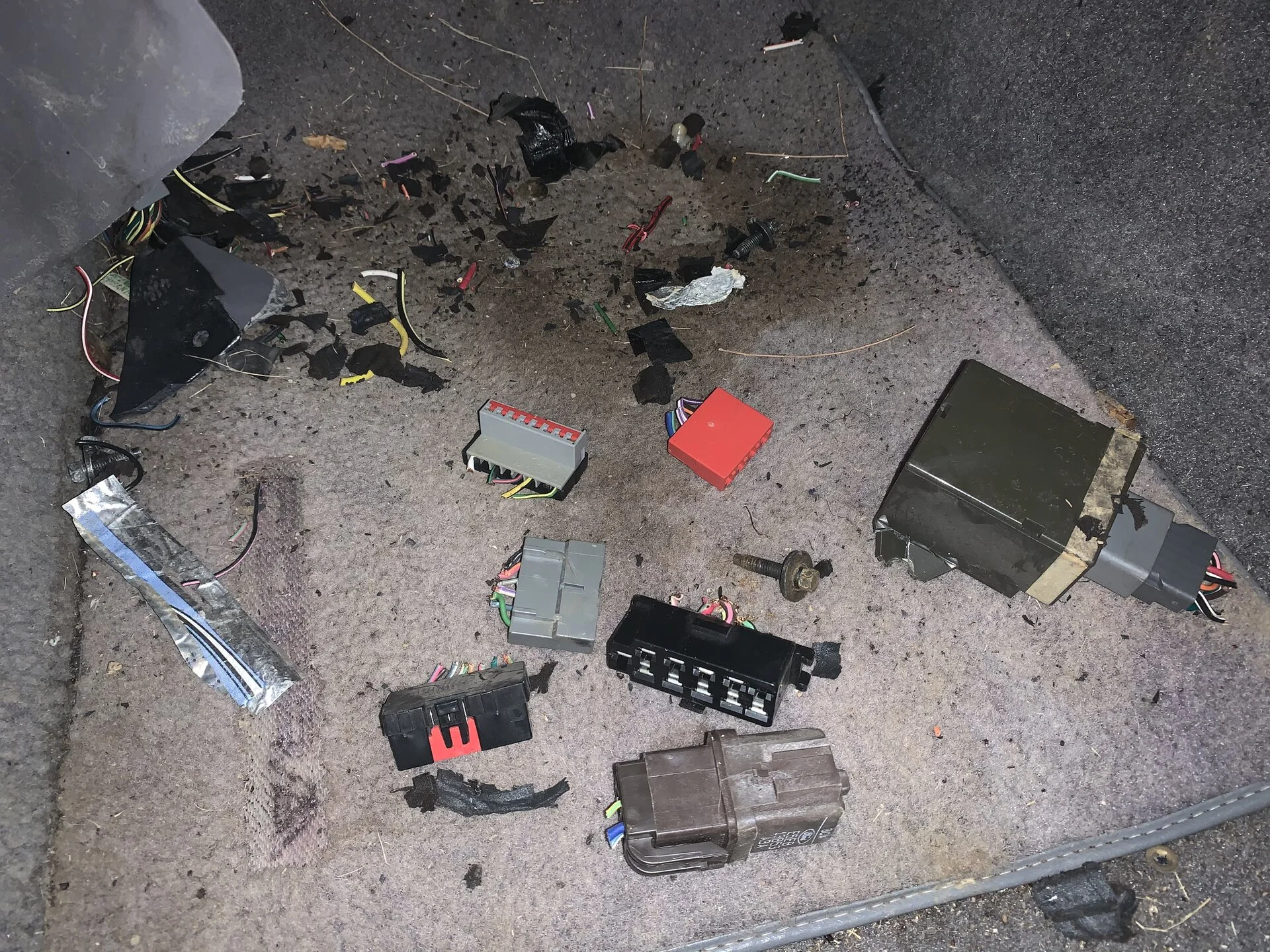

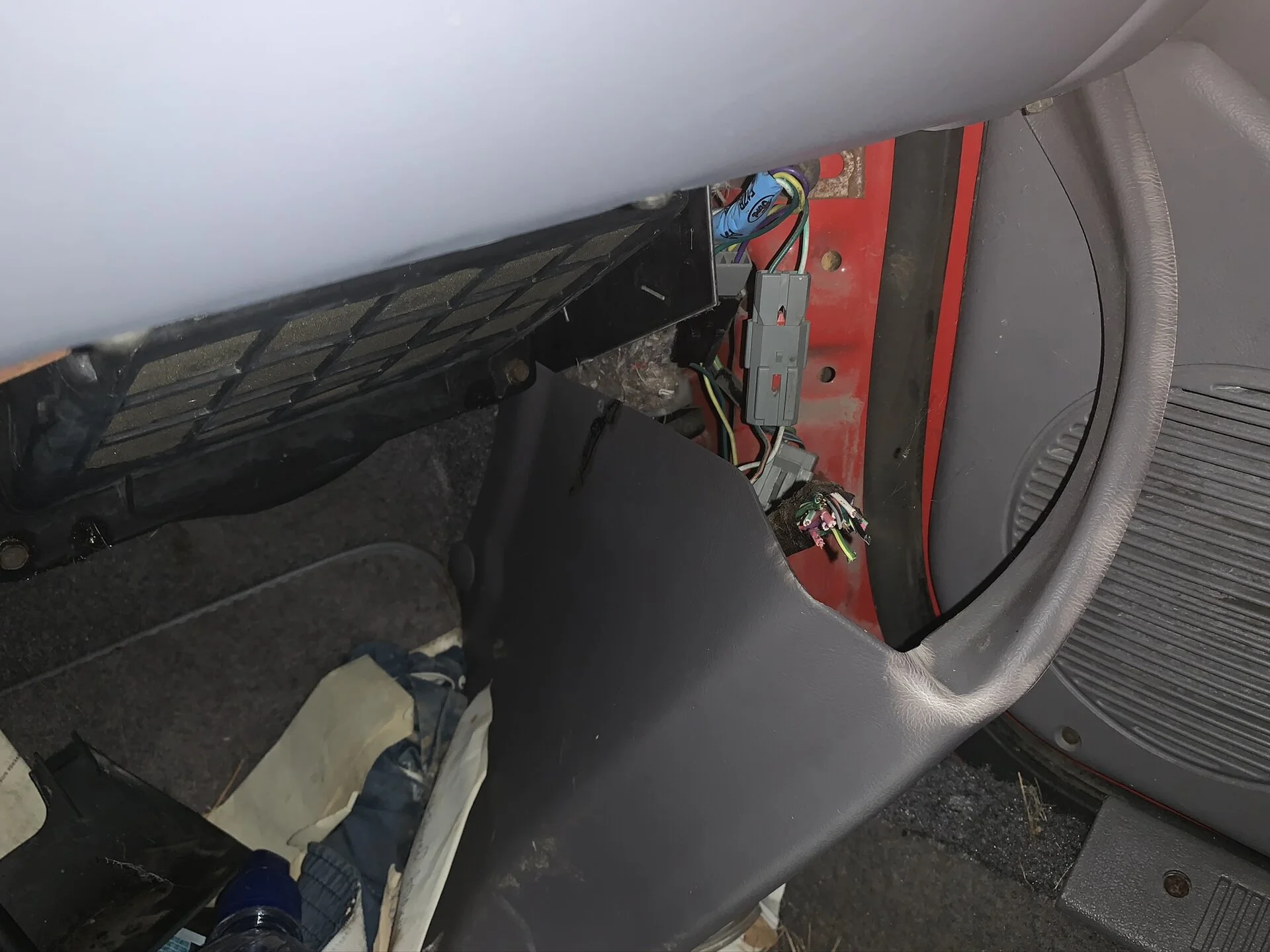

Now for the bad news.....someone has stolen some parts off of it and it looks they tried to steal the whole car because the ignition switch is messed up. When they couldn’t get that done they pulled (ripped) off some panels under the dash and they cut a bunch of wires leaving pluI’m sure there’s stuff missing under there.

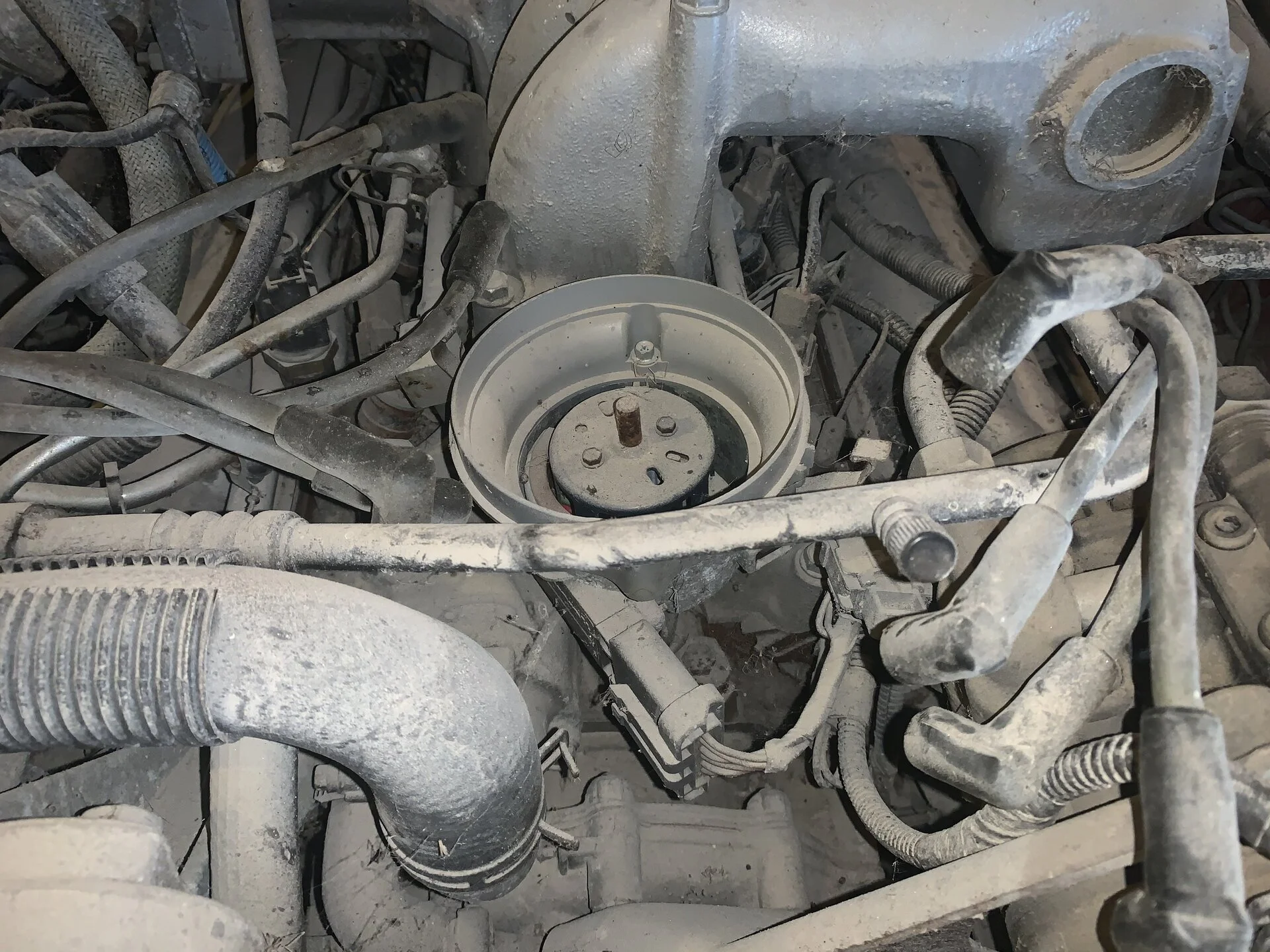

Also stolen was the distributor cap, rotor and the rubber cover. It looks like the starter relay, ignition coil and cover were taken as well.

Looks like a nice project car!
I can't say I understand why people let potentially $20,000 cars sit under trees for 15 years, but his loss can be your gain :)
How much do you know about Fox Bodies in general? There is a lot of information on this site about them, of course, so be sure to post up any questions you have. I can't tell if you will be able to save that right front fender - there are some really good PDR guys out there, but that one looks to be pretty bent up. With that said, if you do have to replace it make sure you get a replacement for a 91-93 model - 79-90 are different and won't work for you.
Also, your ground effects kit is very rare and expensive. The aftermarket ones fit and attach differently, so be careful with them! The same goes for the rear bumper and wing - aftermarkets are available, but they aren't as high of quality as the original Ford pieces and there are visual differences if you know what you are looking at.
Do you have any idea why all the wiring is cut? Some of those bright red, white, and blue pieces look like they go to the HVAC system...

It doesn't look too bad actually. If the clutch is bumping, put a new clutch in it. Probably needs one anyway. The first "wiring" picture is the vacuum lines that go to the HVAC box. You can deal with that later. It needs a fender obviously. The ground effects will probably bend back out. As for the wiring, I'd just buy a whole new harness and be done with it. Soldering that many wires that close to the connectors is not worth the hassle.

Thanks for the replies! I think all that stuff is cut because someone was stealing Parts off of it. And yes I’ve been looking at videos about pulling the dash and replacing the wiring harness, it just seems like the right way to do it. As far as the fender goes if I can get it pulled out a little bit that’ll be fine for now, I just want to get it running for now. I’m thinking about making it an autocross car.
