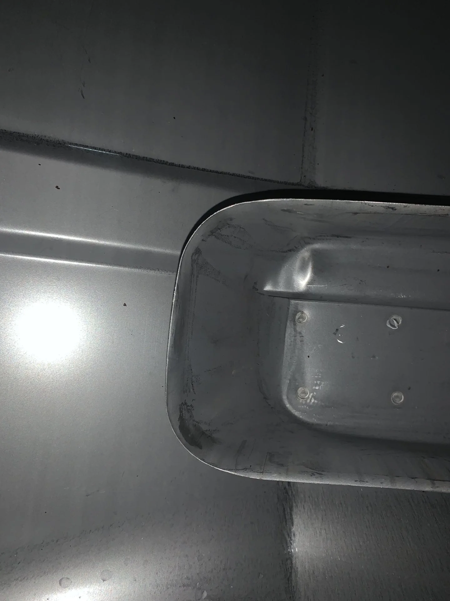

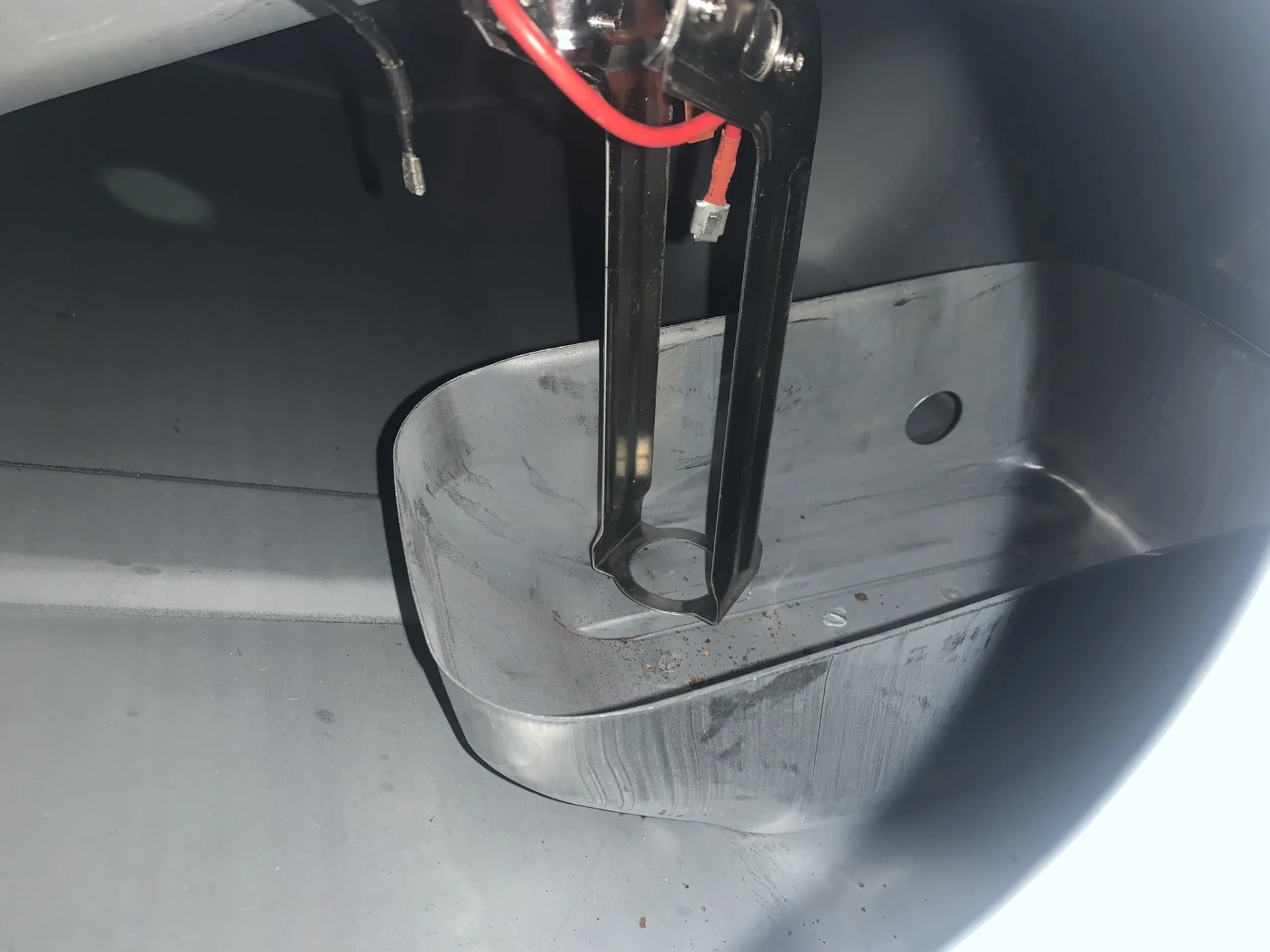

Defective tank. The pump well is not in the correct position.
In this picture you can see the hole in the hanger where the inlet of the pump slips through the hanger. That hole is directly above a ridge in the well that is meant to fit over the raised part of the tank that is a channel on the outside for the tank strap. The well isn’t positioned all the way over to that ridge so the pump doesn’t sit in the deep side of the well.
Picture taken from the fill neck inlet
This picture is straight down from the hole for the pump. It doesn’t look like it’s all the way over to the strap channel to me.
I even tried the old pump to make sure there wasn’t something wrong with the new hanger and it fit the same way.
Thoughts?

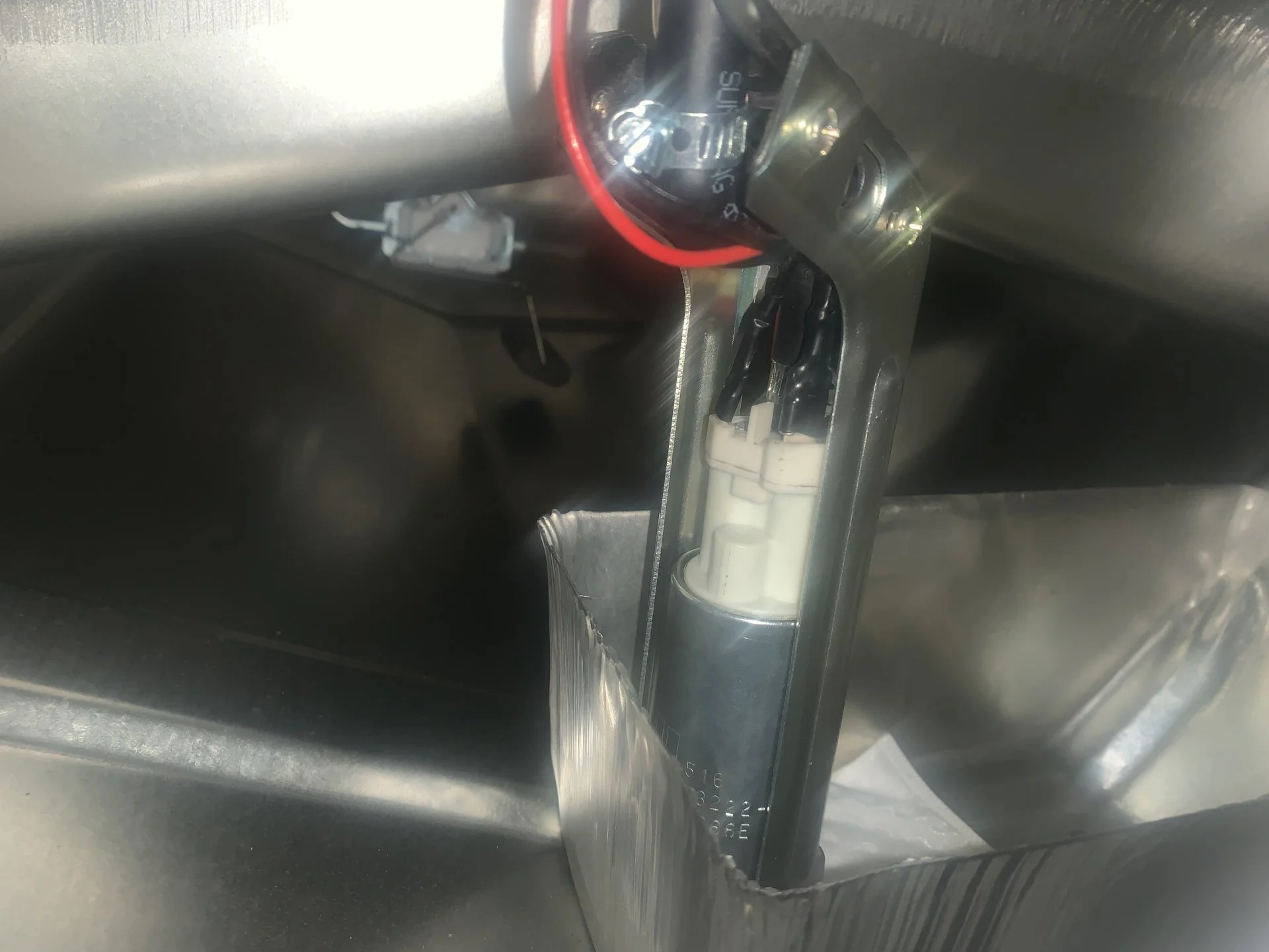

Spectra Premium tank
Walbro pump
Ford Fuel filler grommet
Spectra hanger

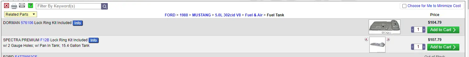

I used a spectra last time for a stock tank it wasn't a coated tank, just bare like some are. I have to check my old email receipts but think I got it from advance when they had a good promo code making it the cheapest lol.. I ran a 320lph pump and stock lines/rails with a kirban regulator. Still working fine, only went with a lager pump because it was getting a spare wet nitrous kit thrown at it. You can get The Dorman 576-106 tank for $82 from Amazon or walmart... Good thing with those is free returns if its screwed up.
Edit yep, was a spectra F12B .for $82 shipped from advanced looks like they jacked prices way up and dropped spectra, they repackage the dorman as a car quest part number now for almost double the price.

That's the tank I used. I got mine on rockauto.com for something like $80, but prices are up
$108 minus 5% code (213614765165367055) so $102 plus $30 to ship. Looks like Amazon is the better deal, plus if it arrives dented (good chance) should be easy to get another one.

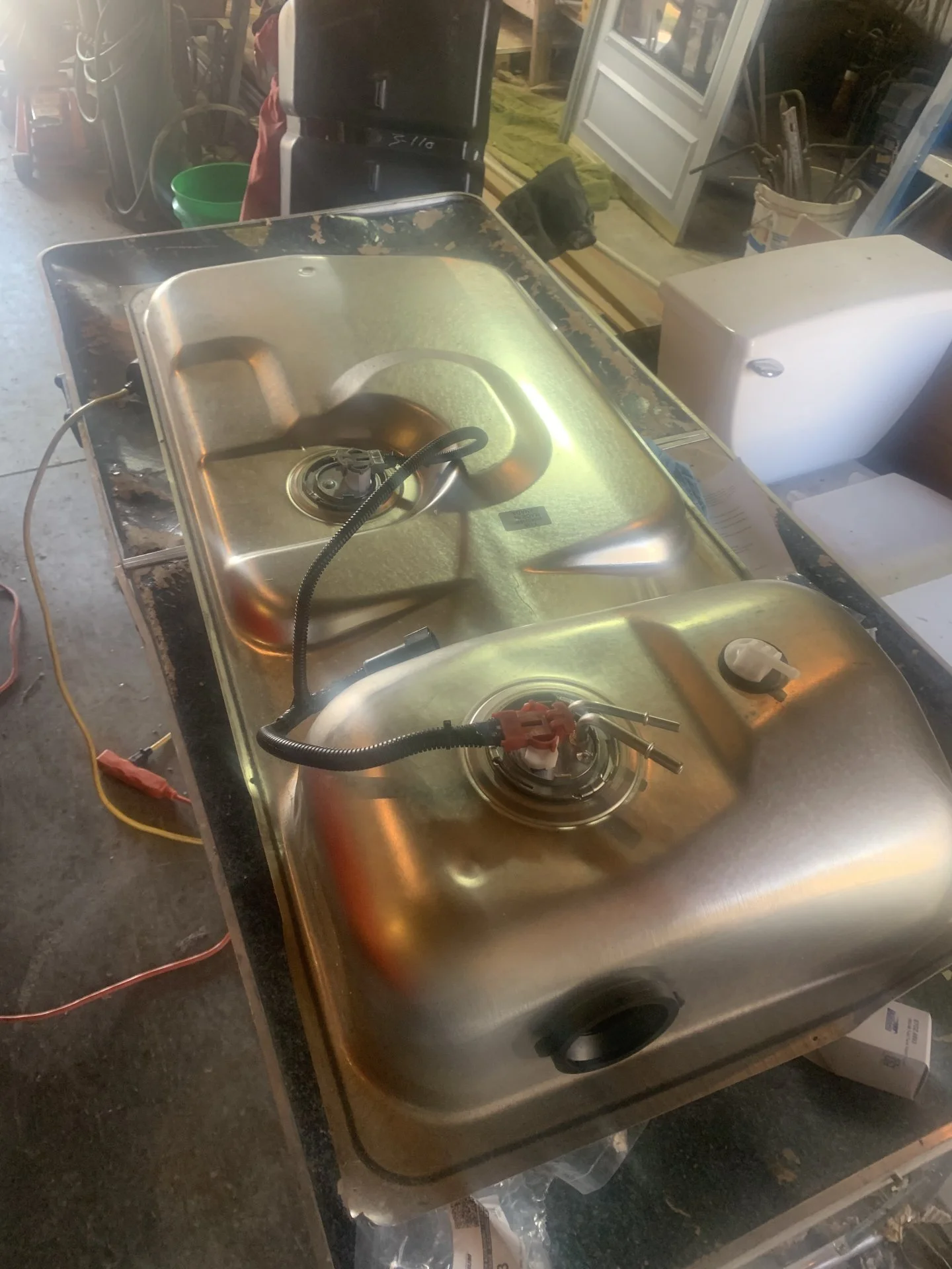

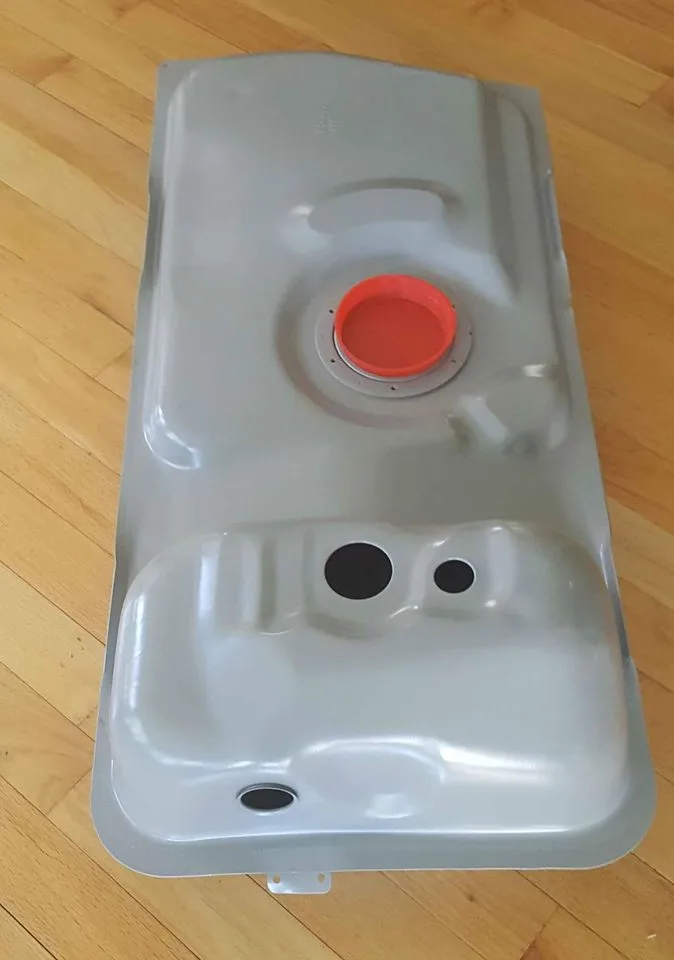

The problem is, there's only like 3 or 4 manufacturers of the aftermarket stock replacement tanks... Then they get rebranded and marked up like everything else in the parts world these days so price doesn't mean quality any more like most think it does.....as long as its not a 3rd party seller I haven't had issues buying parts from Wal-Mart or amazon.. Idk who acp is the same for tanks but they are repackager so it may be the same as other brands, still have a few new parts from them laying around like door handles, actuators and stuff, things I bought dirt cheap like $10 or less from clearance sales over the years..
Spectra and Sherman are the same tank, car quest and Dorman are the same for fox bodies... Wish I could find a cheap source on the 03 cobra tanks but I'm guessing same manufacturer in Taiwan that Dorman uses, there is a couple versions, like on 3, lethal and glenns... This is a lethal performance one, They have the same coating as Dorman tanks which I like over the spectra tanks I've used. The fuel hats for those are expensive enough, but I like having the ability to run three pumps in a non sumped tank if I ever do high hp boosted set up... And the way prices on nitrous keep climbing I probably will end up doing a turbo set up.

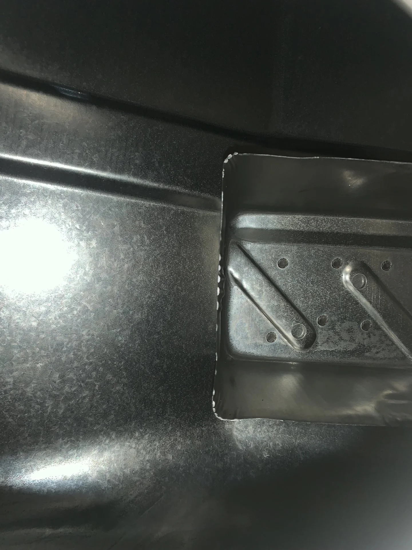

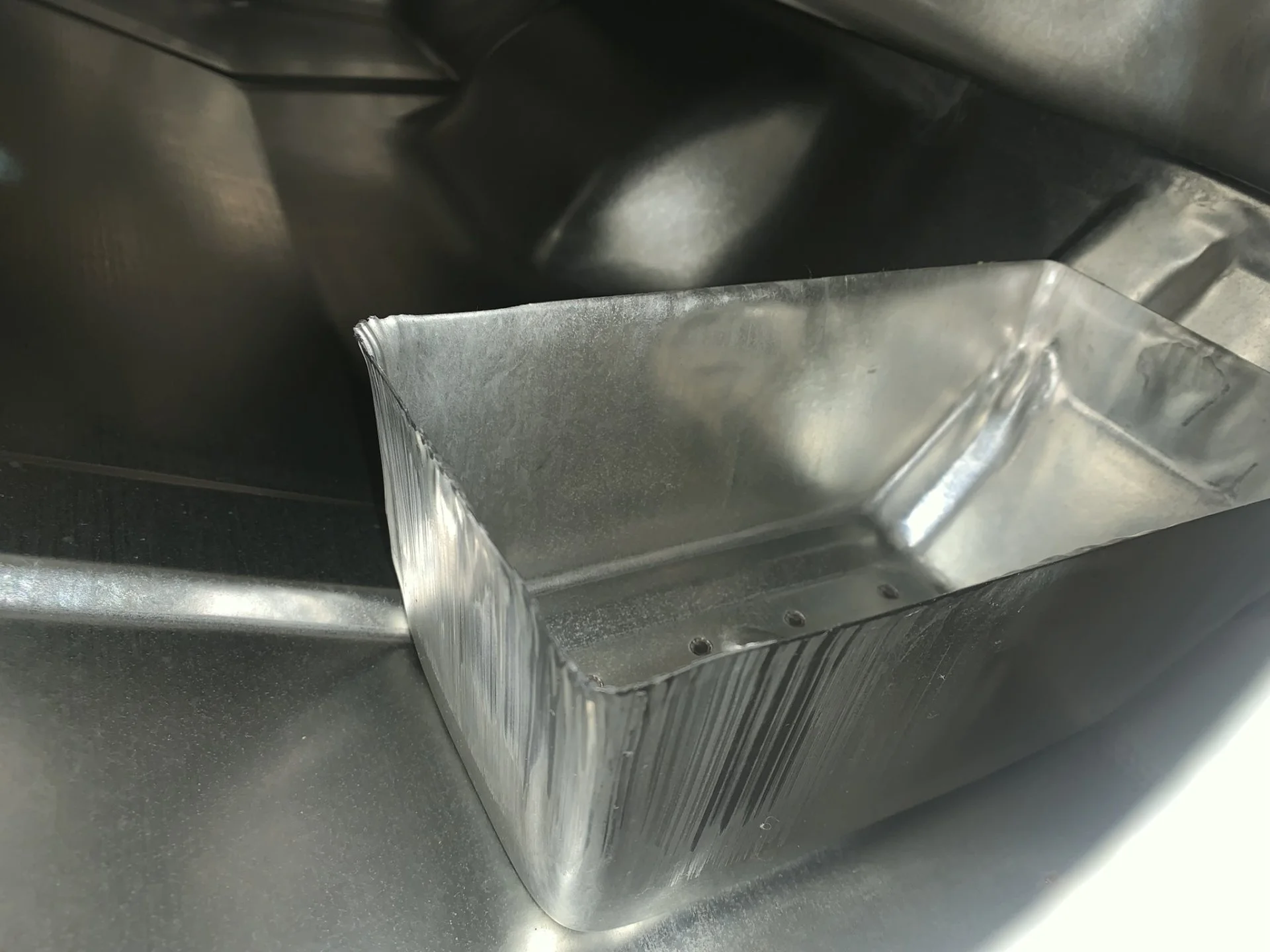

Well I finally got all that crap returned to CJ’s it cost me some money in shipping but it turned out to be worth it. The new tank is definitely better, the slot for the gaskets on the sending unit and hanger actually hold the gasket in place unlike the other one I had. The reservoir (what is that actually called?) appears better to me. I ended up having to get the hanger from advanced auto but the model number was similar to a spectra, fg30acq, so I’m guessing it’s made by spectra. Amazon will be delivering the foam for the top of the tank tomorrow so I’m going to see if I can get the tank installed tomorrow. If I go back out the the garage tonight I’m get the new fill neck replaced and that area cleaned up.

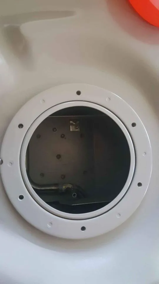

A look inside the new tank reveals a pump reservoir that lets fuel in from a channel in the bottom instead of a hole in the side wall.
