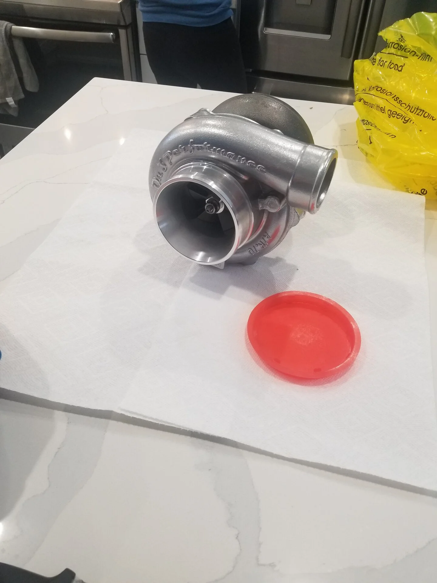

More importantly....
Look what showed up yesterday.

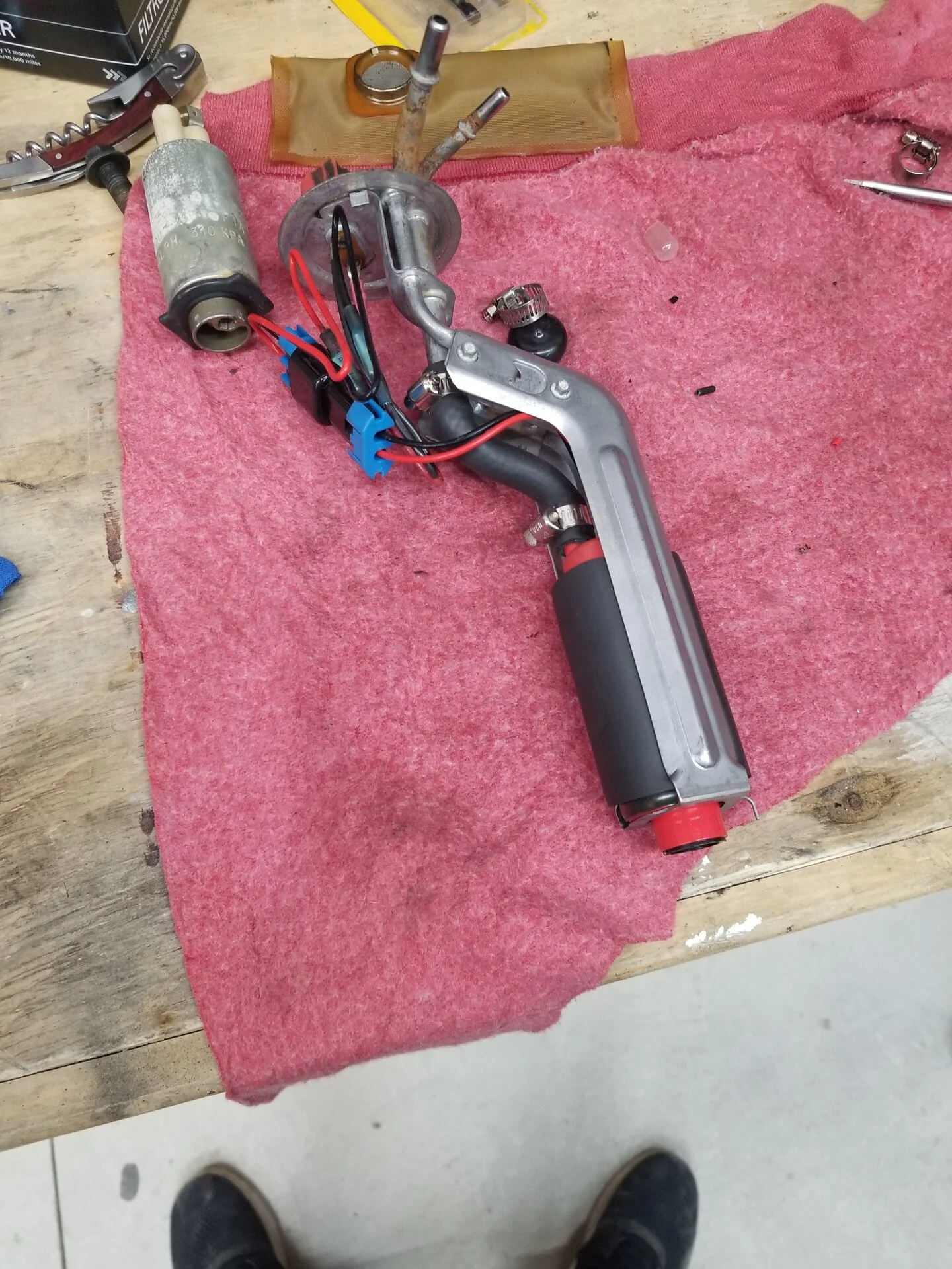

I installed the fuel pump a couple days ago working great and amazingly quiet and the car is under disassembly stage now :nice:
Will be starting on installation this weekend

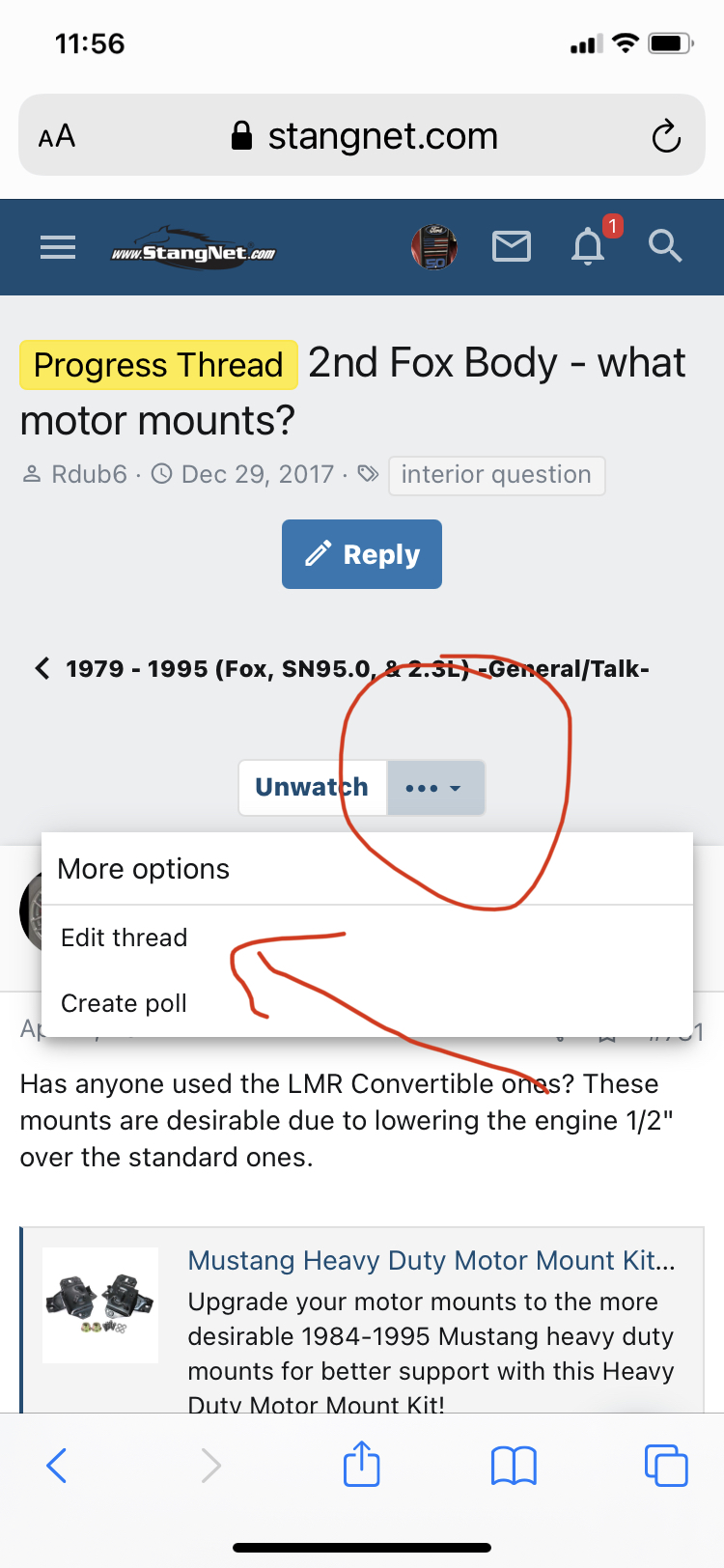

I cant see the 3 dots/edit button. This title is misleading for what is going on now. Any more help?
Your account is not mature enough to have these abilities yet. You will need to get one of the moderators to change it for you. Just let them know what you want it changed to.

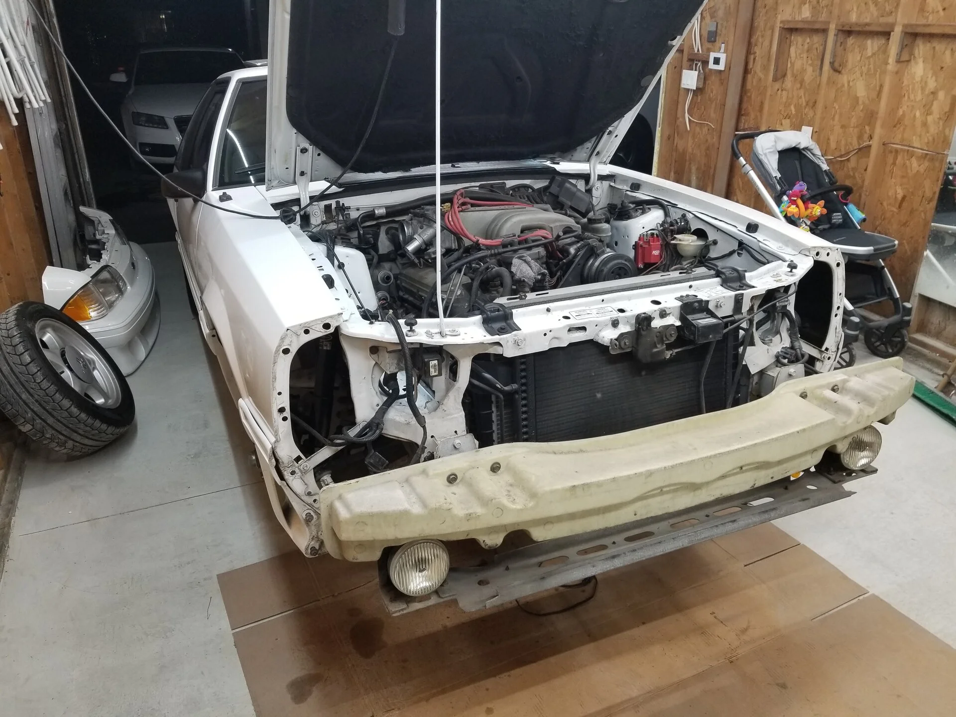

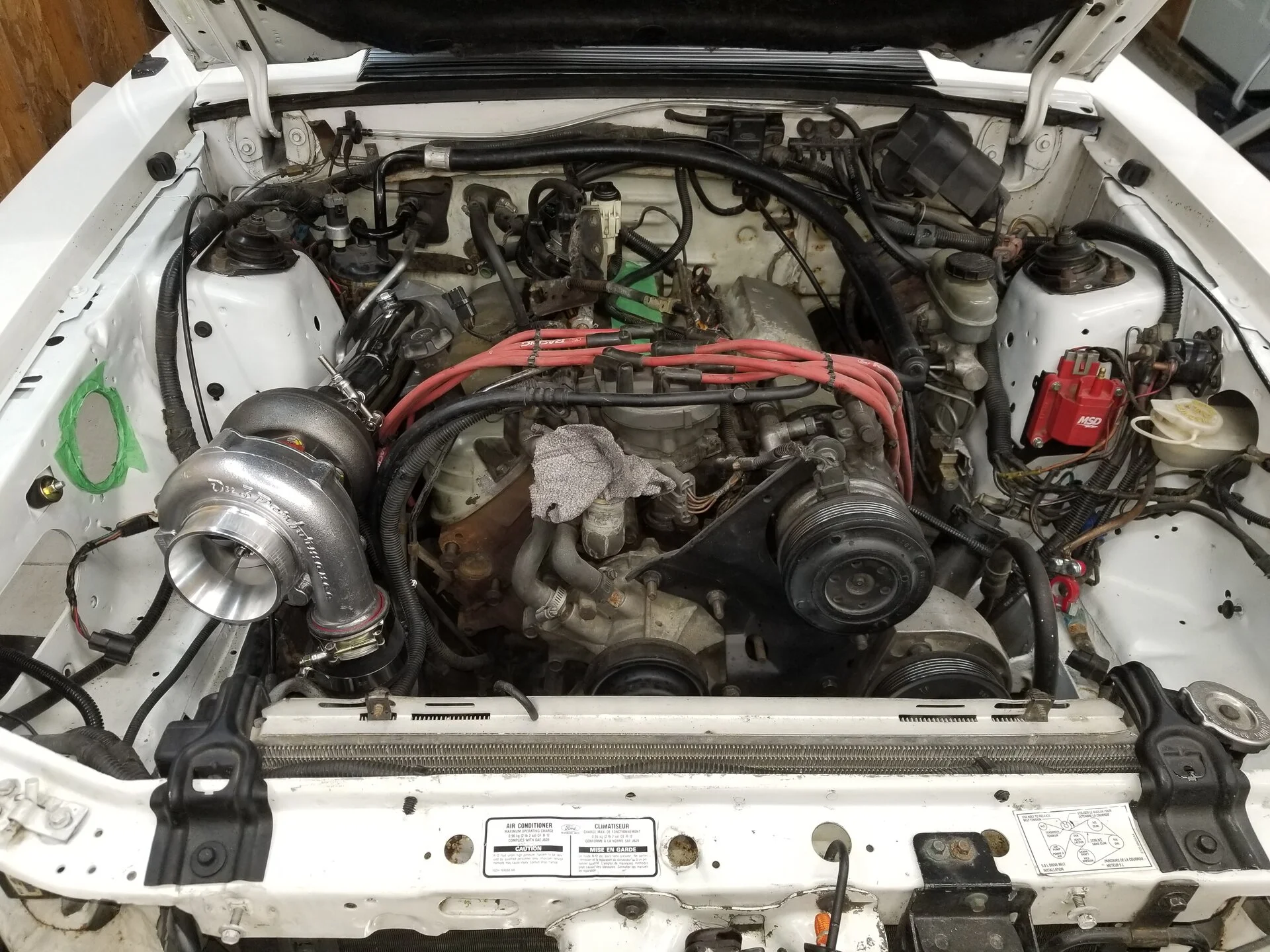

Quick update here
Did the dry mockup less the intake manifold pipe as i am waiting on the injectors still for install. It all fit up i would say 85%. As many have said, there is some massaging that needed to be done to make it work, but overall not terrible.
  • Turbo flange sits extremely close 1/4" or so to the frame rail so i had to shim the pass side motor mount to give it some more space when its under load.
  • The 180 deg pipe going into the intercooler just would not align straight to the turbo output pipe or intercoolor so its a bit cockeyed. Didn't matter where i positioned the intercooler or clocked the turbo, it just would not go straight together. I am hoping the coupler will be sufficient to hold it together regardless.
  • The power steering cooler line needed some finesse to get the intercooler to fit tight enough to the AC condenser.
  • downpipe was a major PITA. AC accumulator bracket has to be removed completely and the pipe still presses up against the accumulator. Crossing my fingers the v-bands hold up.
  • hot side crossover pipe hangs a bit lower than i expected, about in line with the K-member and the joint after the flex isn't straight either. Ball and socket joint eliminates any concern, but thought this should be bang on if anything.

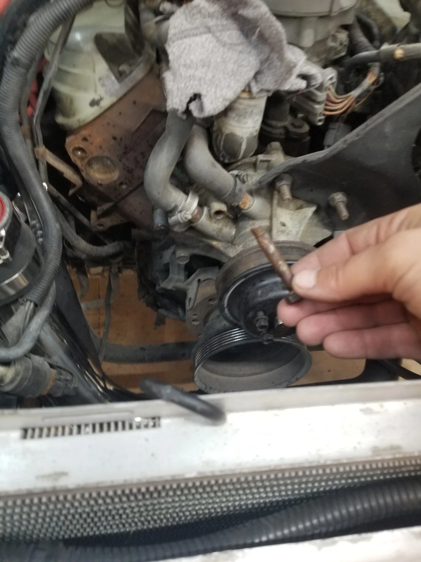

Another fun point, one of my water pump bolts snapped clean in half when trying to remove it for the alternator relocation bracket. I don't have high hopes that a bolt extractor will work well. Not sure what i am going to do here, two bolts on that bracket may not be enough.
Will be starting final install over the weekend

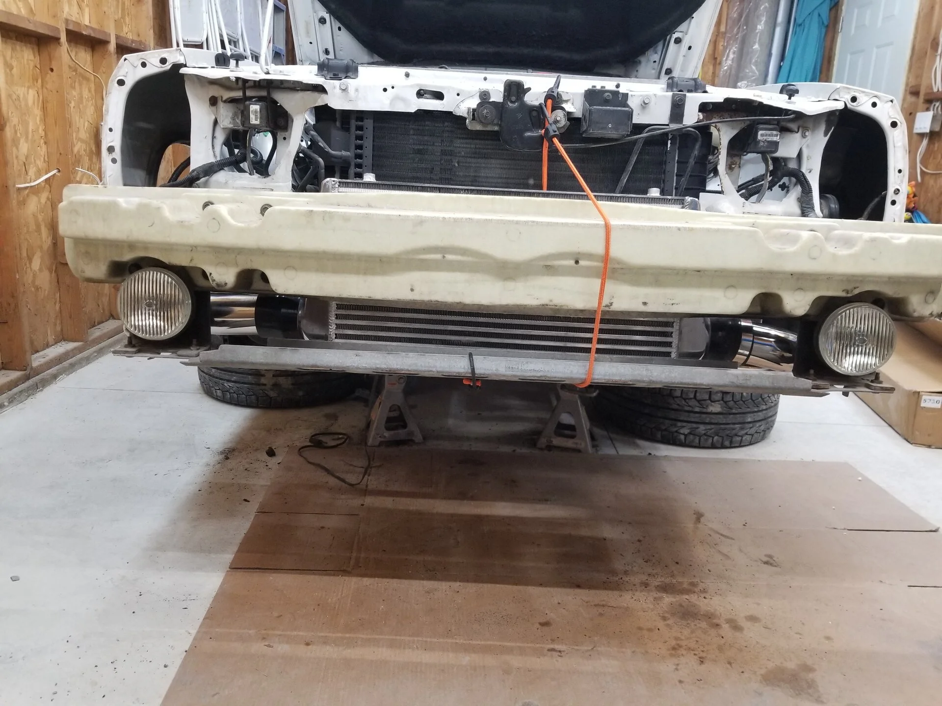

Finished up the final assembly of hot side and started the cold side install again. I'm kinda just taking my time since i have to wait for a few more things to come in over the next week or two.
I have read so many different threads and so much conflicting info on this. Looking to hear back from forced induction guys only.
For PCV system, is one valve cover breather in itself sufficient or does the PCV have to be vented with a breather/manifold line capped as well?
Can i use a breather off the throttle body hose pipe instead of buying a screw on one to replace the oil cap? I don't think the smaller diameter should restrict it enough...thoughts?

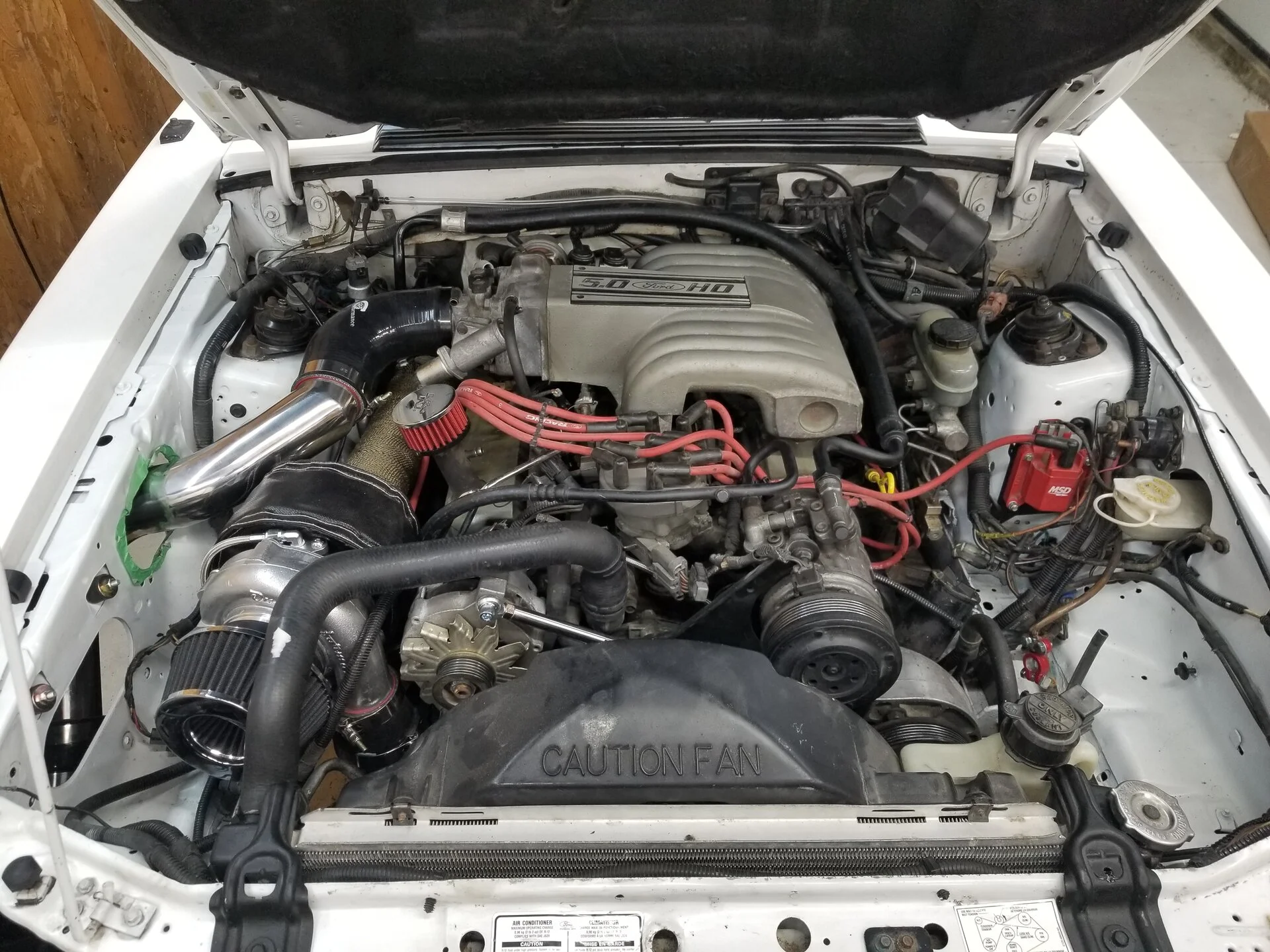

Just an update for anyone.
Car has been sitting for about two weeks WAITING. I had sent in my PiMPx for the sequential upgrade so i avoid having to hack up the harness to run batch fire + small bonus of driveability/economy but it is taking FOREVER to get returned shipped to me. Taken about one month total so far since i sent it out and it has been moving through "USPS network facility to facility" for two weeks on the return trip and its keeping me from running this car....just me venting here..
Overall though, even though it has not been started i'm surprised how easy it was to install this kit. probably about 20-25 hours or so with several dry mockups and beer time and my skill level i would say is about average for a hobbyist.
Final notes on install (assuming it fires up correctly haha)
  • For PCV i ended up getting a screw on oil cap breather along with a small filter for the PCV. Based on what im reading that is the best way to vent on a boosted application without going to a catch can type setup.
  • I fabbed up some smaller brackets for the bottom of the AC condenser as well which allowed me to push it closer to the rad for enough room to keep my fog lamps/brackets intact with zero cutting to the bumper whatsoever. Big bonus for me as i heard many people needed to cut/chop/remove some stuff in the lower bumper area to get all the piping to work.
  • AC accumulator bracket had to come off to give the downpipe enough clearance to pass through.
  • Hole on passenger side of engine bay had to be enlarged slightly for correct orientation of the cold side

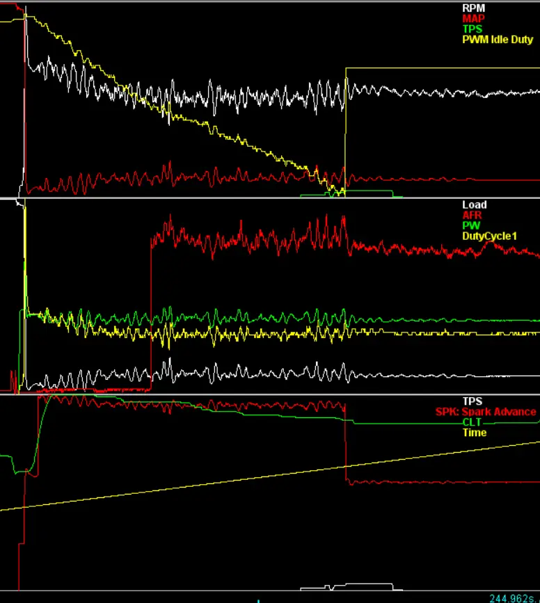

so i played with some stuff tonight, looks like the PWM should have been inverted because it actually stays running now. i have attached a log of two runs.
1. open loop 2. closed loop.
for open loop, rpm surges for about one min before settling around 1k .Once the wideband kicks on, it runs very lean up to ~16-17 and oscillates gradually settling down to about 14.
For closed loop, i didnt change any default settings, but immediately runs a touch better. RPM still hunts but the oscillation range is much less.
One variable that stick out to me is the PWM Idle duty. Looks like once the idle duty gets to 40% in open loop it settles down, and when in closed loop around 60s into the run, it immediately jumps to 40% and everything stabilizes as shown below.
One other question, to get my AFR's down to reasonable levels i had to bump my idle cells to high 60's/low 70s. It seems high compared to other tunes i have seen, makes me think something else is going on?
Thanks

a91what
SendMeUrDataLog
Mod Dude
Apr 6, 2011
10,719
6,949
214
33
Hillsborough county
Dead time values for the injectors.
What you are seeing is the car entering closed loop idle. Look at the pwm and spark advance, notice how they both change together.
Without looking at the datalog I can't tell for sure, I would have to check the status bits to see if you are in closed loop at that point.
