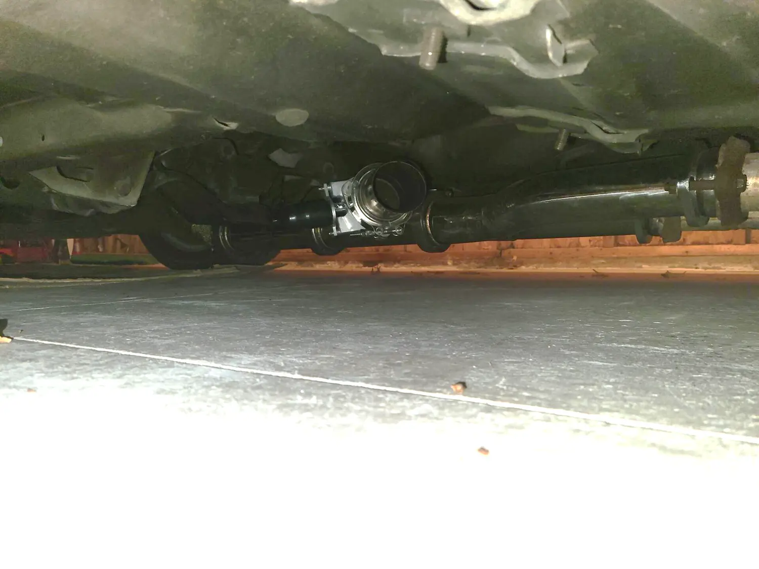

You got any pics of your exhaust setup with the cutout? Curious how that looks and where you put it.

See below. Also a crappy layout in paint.
Turning the cutout to the pass. side with the electronic flapper pushed the exit too low to the ground due to clearance to frame rail. Only option was to point it driverside.

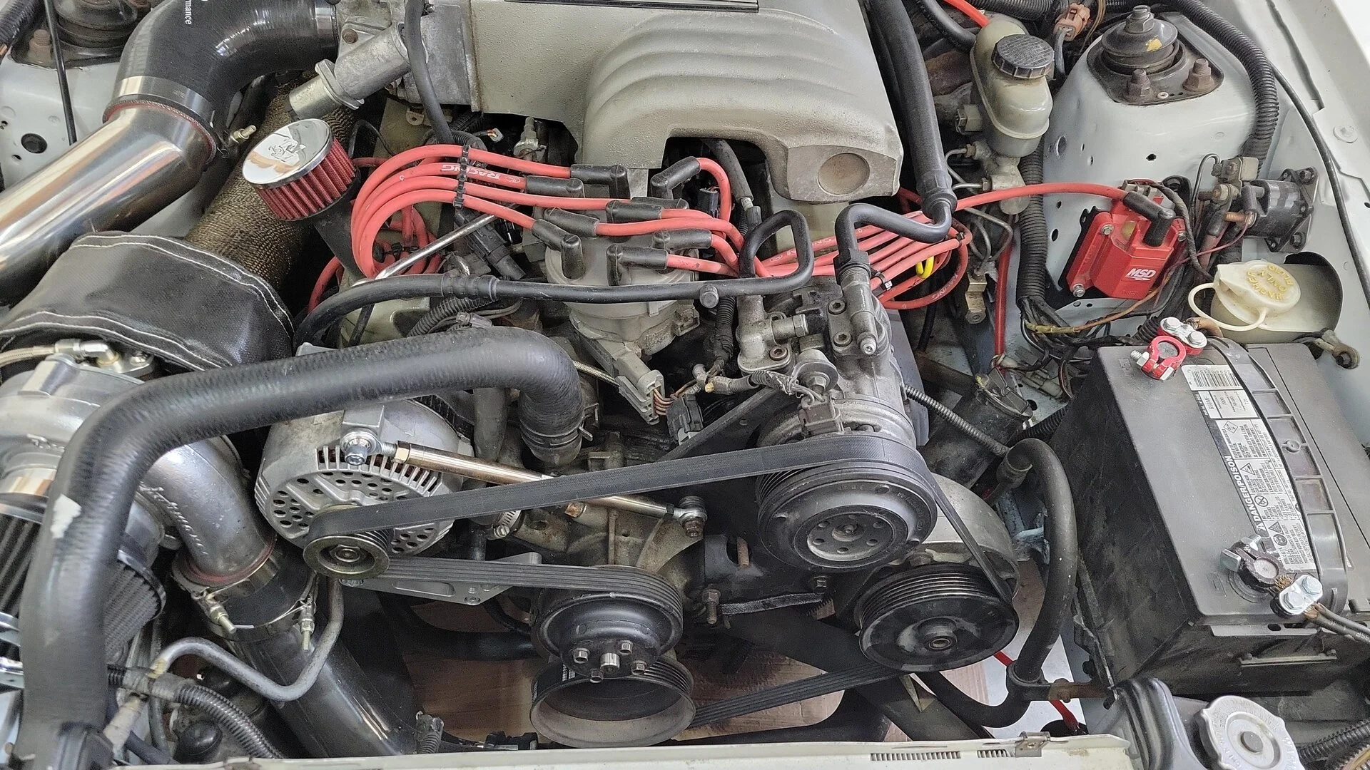

Finally found some time to jump into the garage to install the 3G alternator. All done, it appears to be working fine not really sure how to confirm that. Starts, drives, batt voltage good etc.

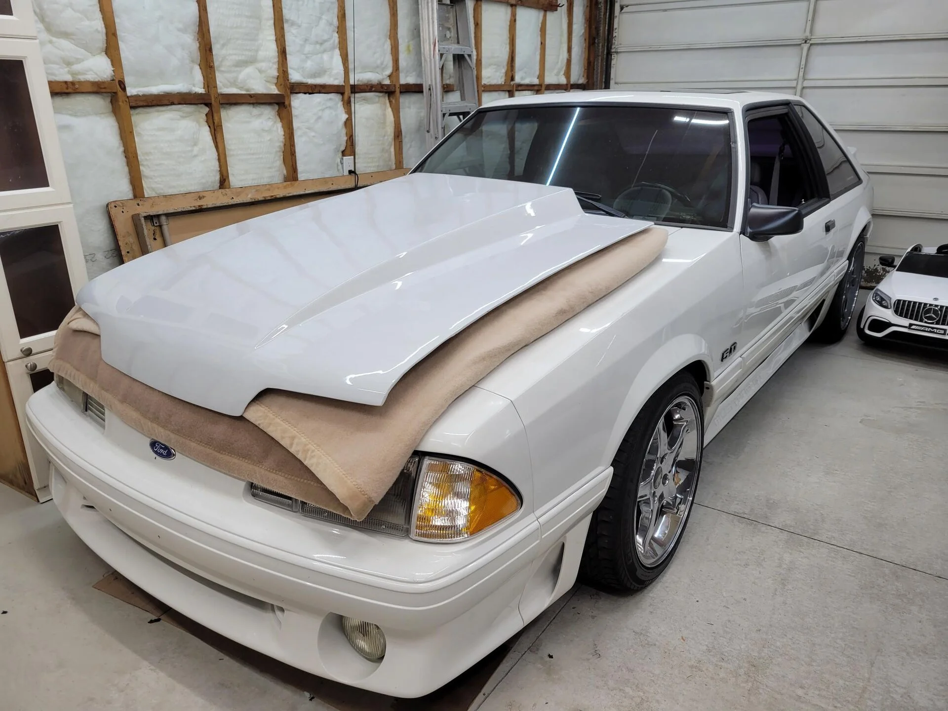

Also, picked up a cervini clone cowl hood freshly painted (oxford white, not vibrant white unfortunately for me, but heavy prep is all done) for cheap so hard to pass up. Hope this will help to get some underhood temps down as well. Heard this should not be run without hood pins though so need to source those before mounting this on.

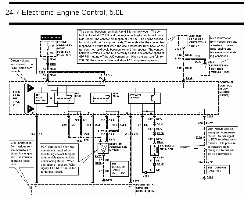

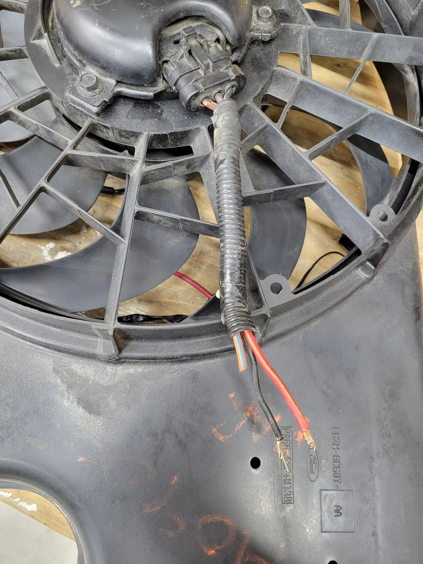

The real question i have is, after doing some digging into the sn95 fan, could someone tell me how the 2 speed actually functions? It looks like there is a CCRM module that regulates power output to the fan. Ive connected both the R/O and O/LB circuits individually and combined and makes no change to fan speed so definetely nothing internal regulating it. At this point i'm just going to wire it in as a single speed on/off with the MS3 and maybe if this fan works better sitting in hot traffic with AC on vs the clutch fan ill look to an actual controller.

Look at the wiring for the V6 fan. I believe they are high speed only, so both wires will only do high.
I have one and pretty sure that’s how it operated. If you want a low speed, you can install a resistor pack from the contour fan
