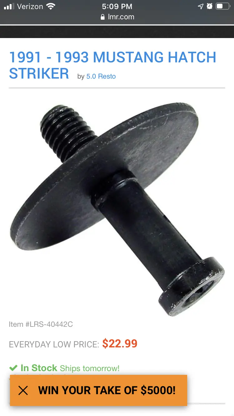

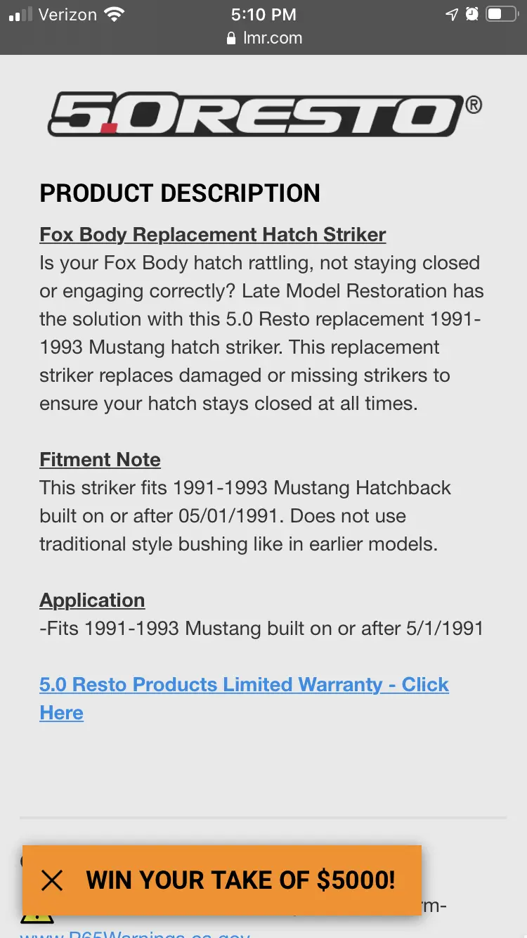

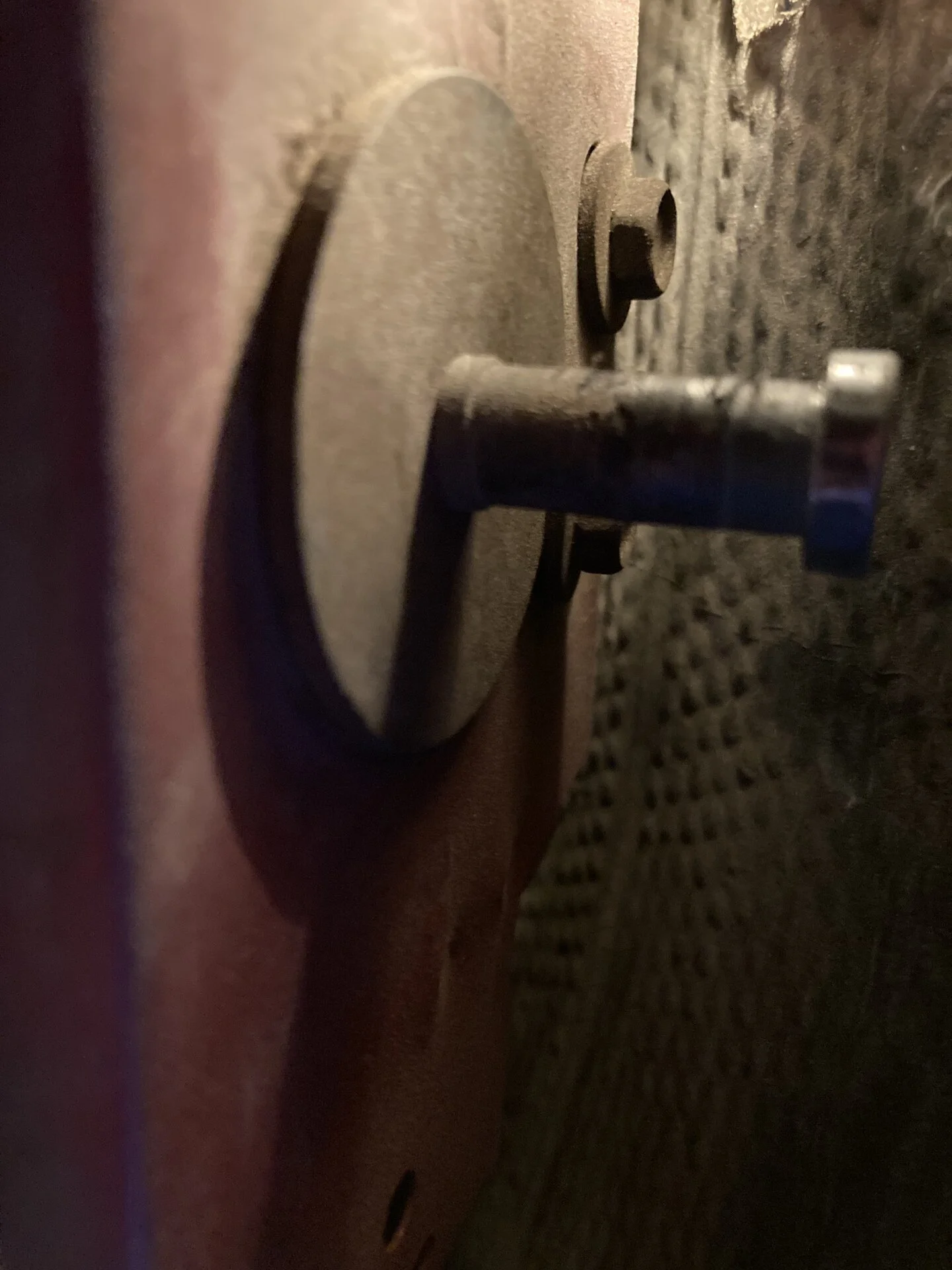

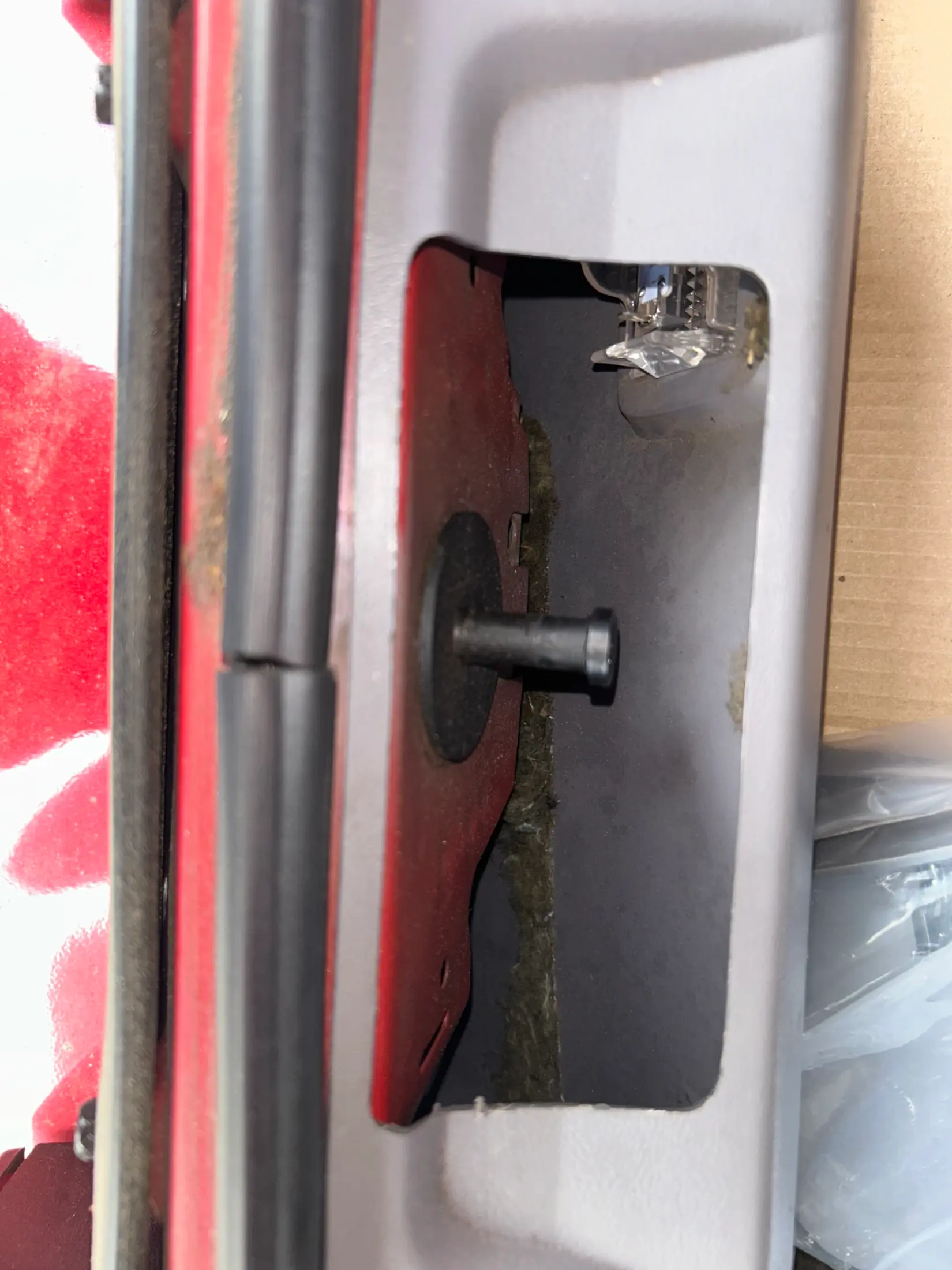

I was just looking back into this. This is the hatch striker on my 1991. Is there supposed to be a plastic bushing over the striker like on the door strikers? I assume so and that I need to order a new striker or get some Delrin out and make a bushing.
They sell the plastic bushings in the "help" section of most parts stores...Advance, O'Riellys, and Autozone.
I should have went to LMR first. This is the right striker for May 1991 through 93. No bushing. It did not seem like I would have replaced the weatherstrip and left the striker wrong.

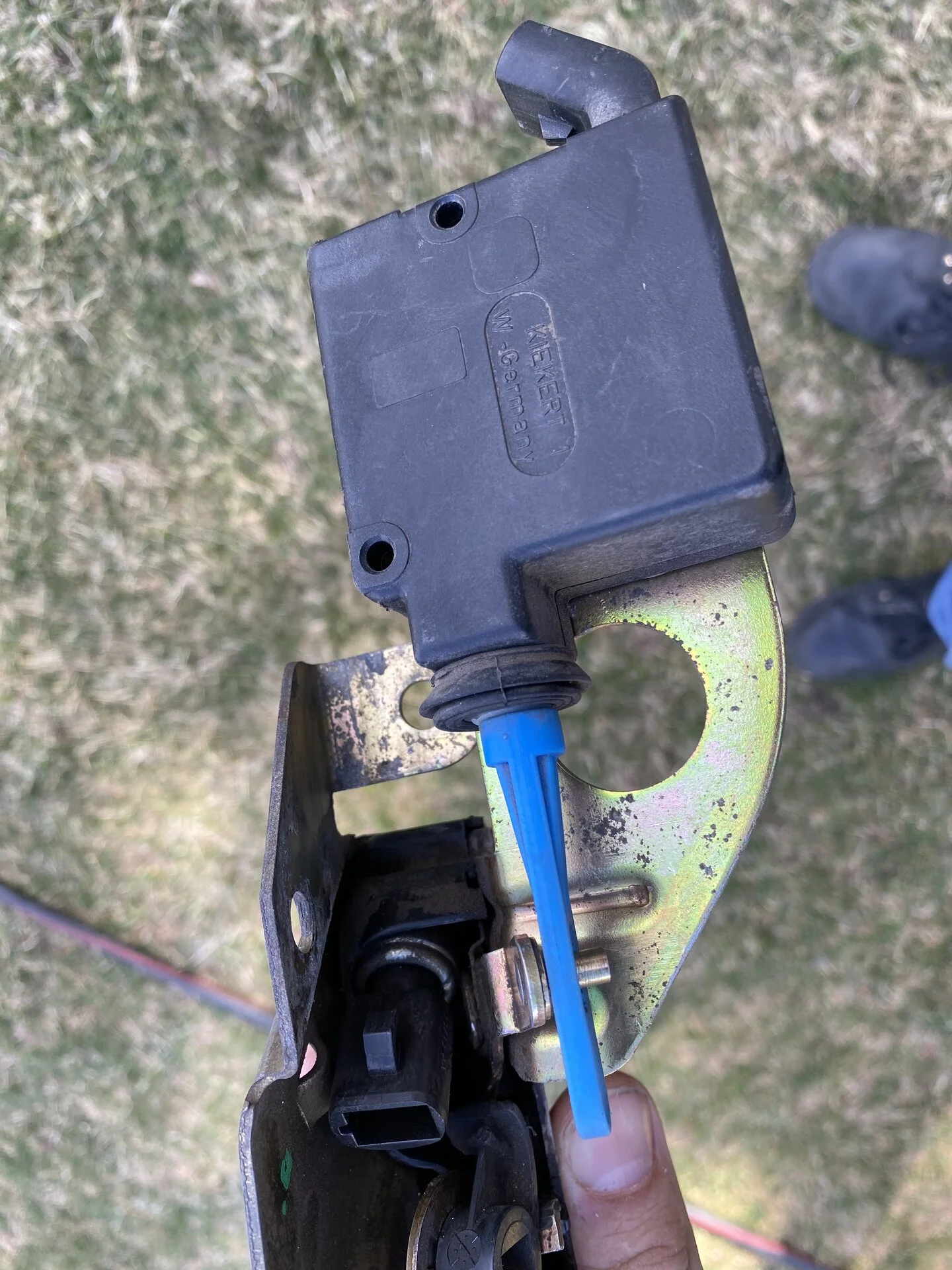

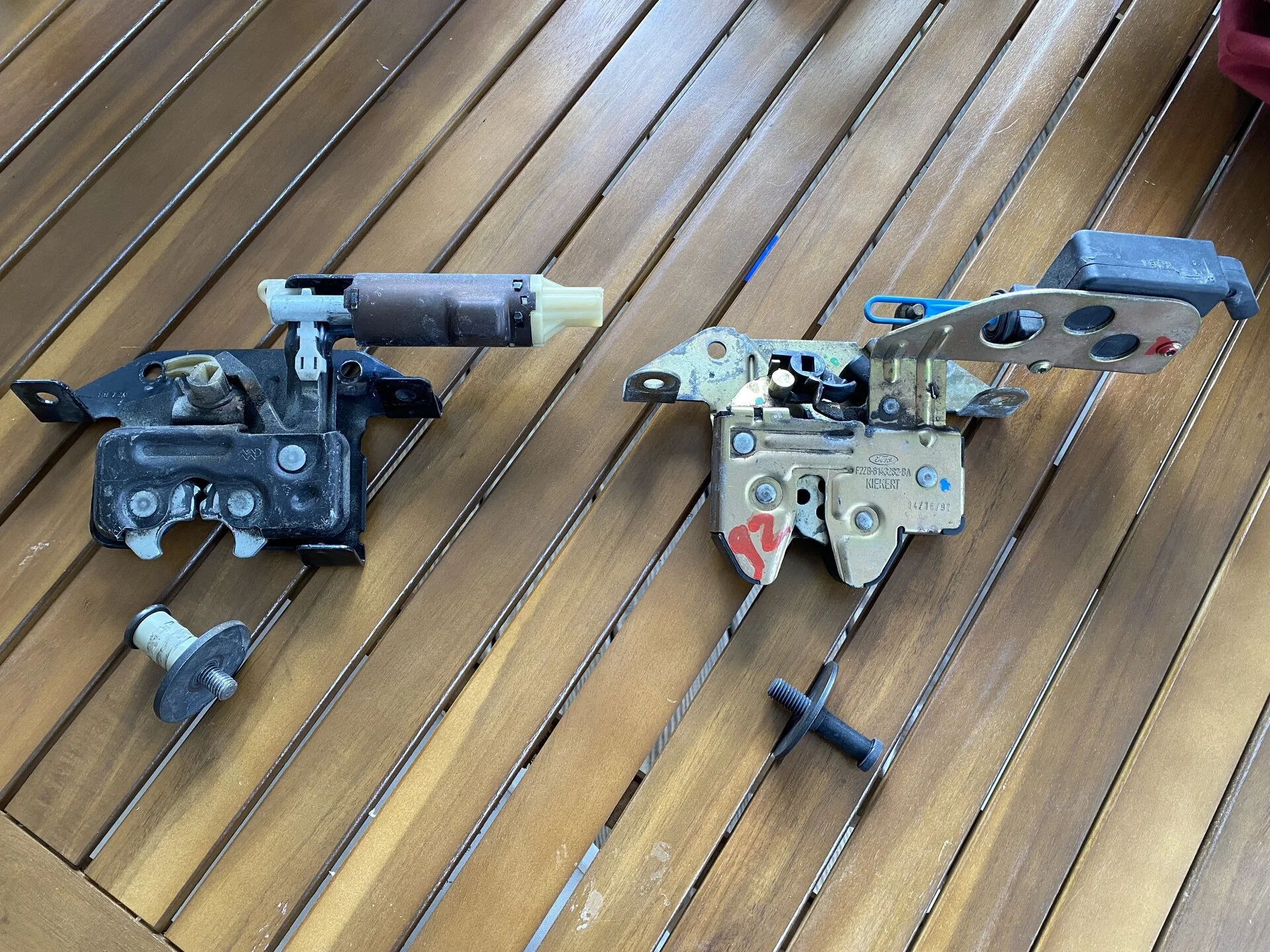

Ford did away with the “plunger” that activates the interior lights and instread put an internal switch on the latch itself. When the latch is open, the switch inside is open and your interior lights come on.
So two plugs on the latch. One for the release solenoid, another for the interior light switch.
So not only do you need to change the solenoid connector, but you need to run 2 wires from the interior light plunger connector up into the hatch. Or just leave the connector for the “plunger” disconnected which means the interior lights won’t come on with the hatch open
You’ll notice no more hatch depressor on the 5/91-later latch (right) vs the older latch on the left.
