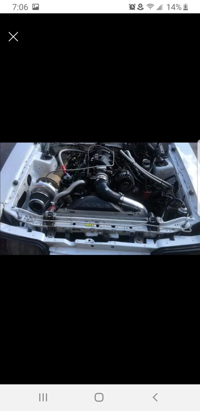

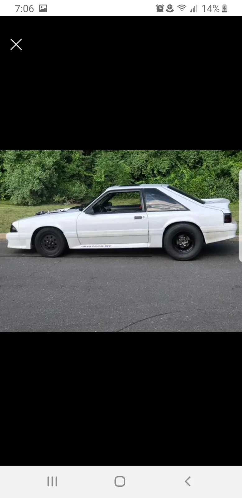

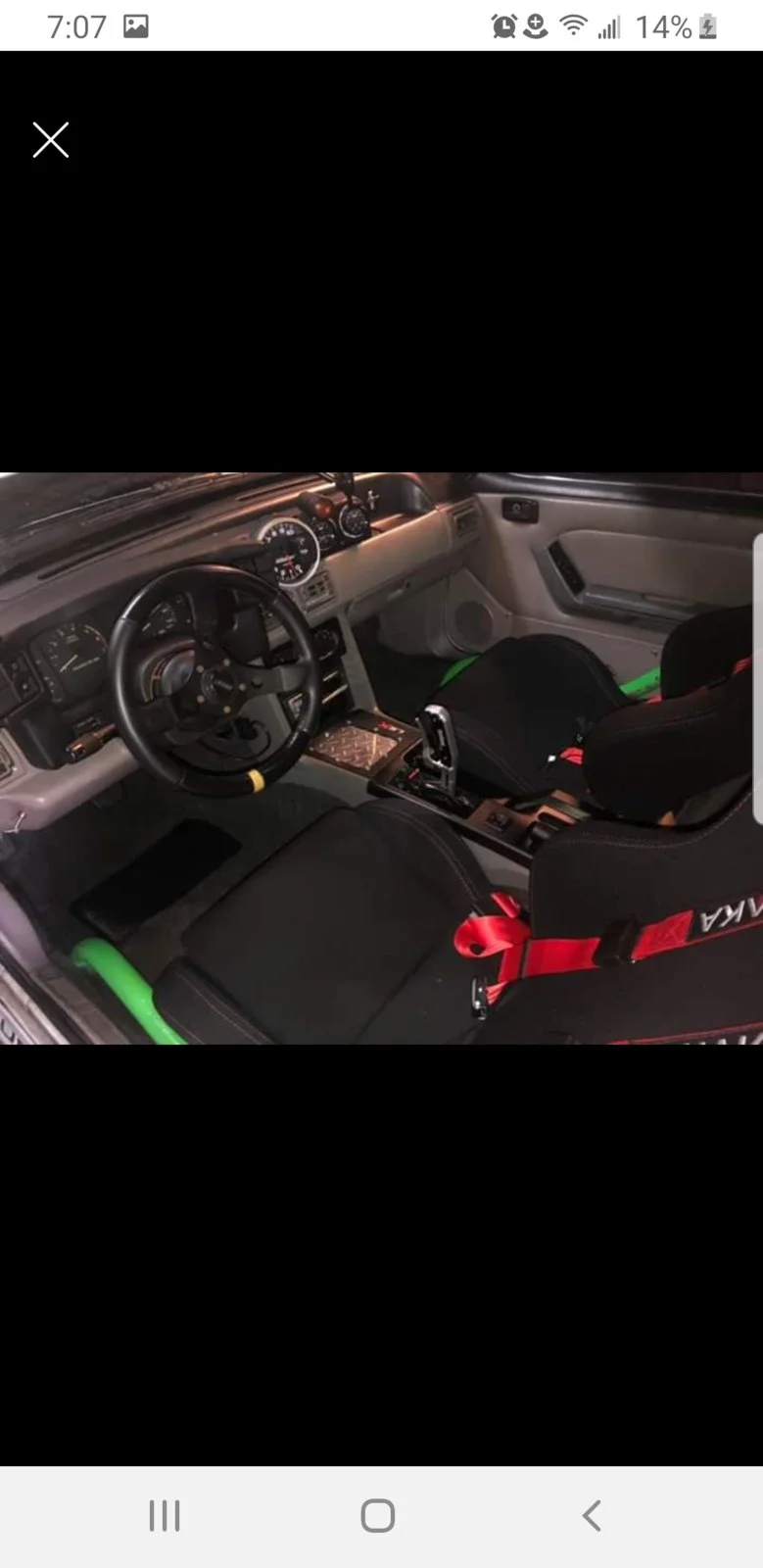

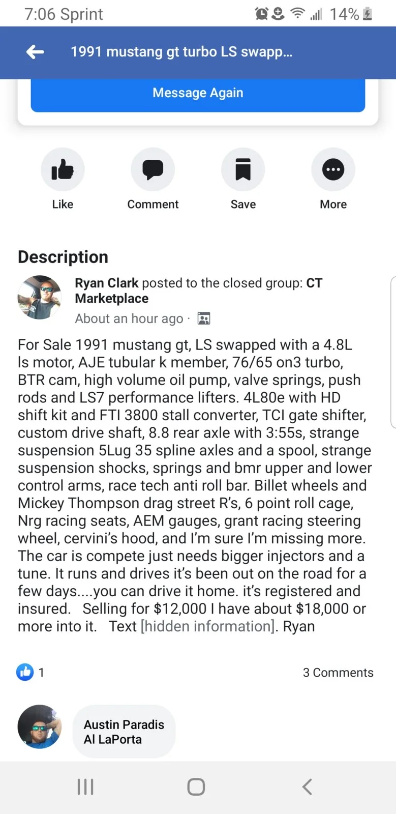

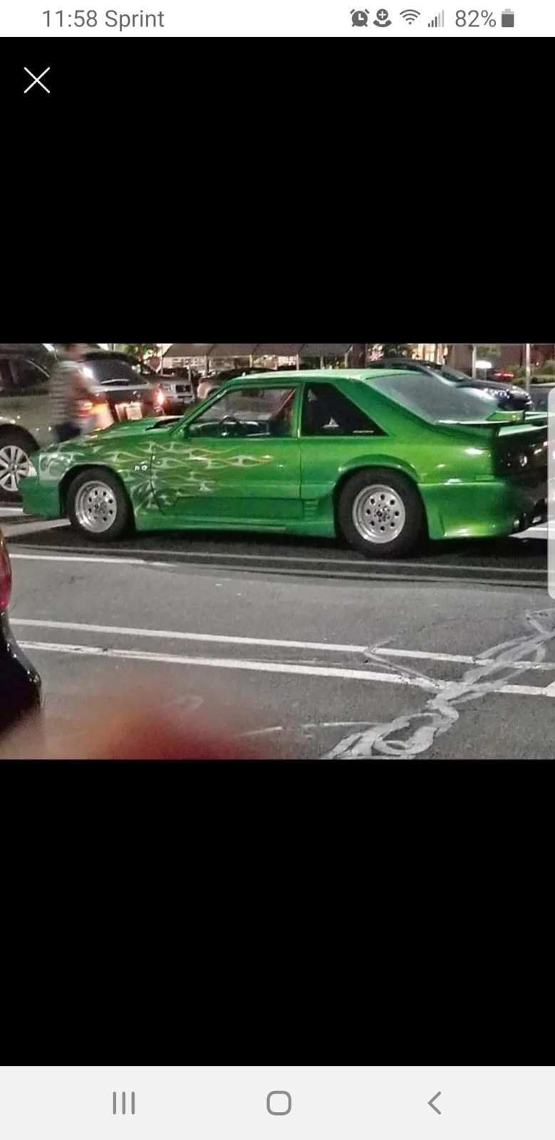

Ok guys, I've been keeping my eye on the marketplace. I love my notch but I think it just needs too much body work to get right. On top of that I see so many foxes on facebook that have near perfect exteriors and a ton of mods that I would be in way more if I bought them for my notch rather than just buying a different fox. But then again I go back and forth debating if I would really trade the notch, I still like the idea of continuing my progress. But what do you guys think of this? Hes asking $12,000
Been on the road a few days? Needs a tune and bigger injectors? Spool (there was an interesting thread about that idea on a street car). $12000 and he’s almost telling you it will not run right until you do some work. What is he NOT telling you?
I’d stay away!
And yeah....... LS swaps are cool....... just not in a Fox!

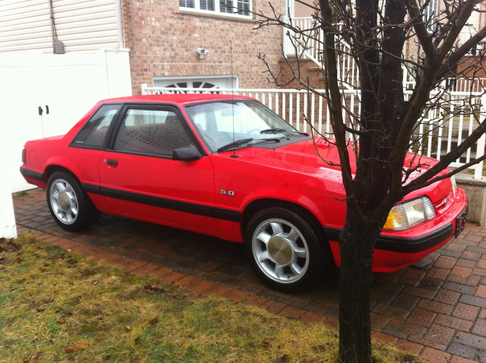

Ok guys I think the vision of what I want is finally coming together. I'm keeping my notch. I'm getting it painted. And now I'm moving forward with an engine build. I saw the top end kits on LMR for a 302 but would I be better off buying a 351 block and building from there? What's the most a 351 can be bored to? And are there pros and cons between a 302 vs a 351?

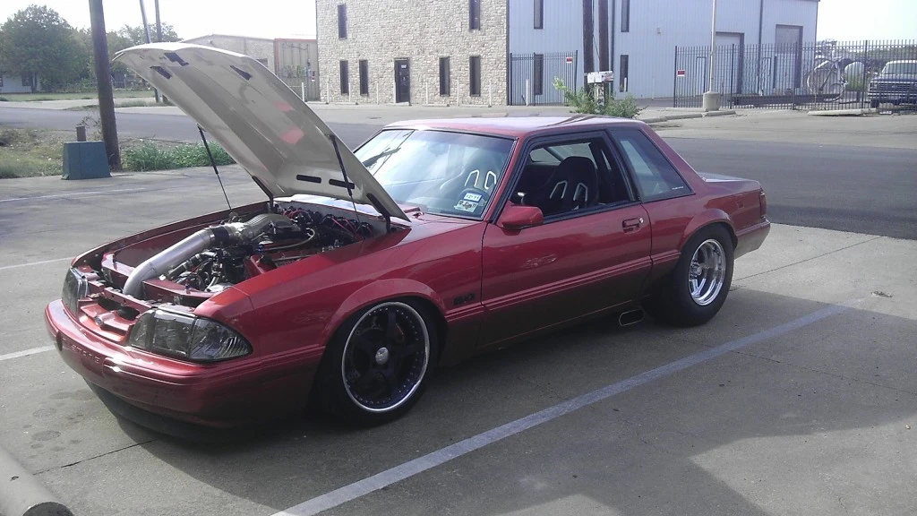

Bud all those cars you posted are pales . Neither are worth the money . That old Paxton was good for it’s time period and then got crushed by the gear driven SCs we have today . Stock ported e7s ? That car is a money pit stay away . Same with that cobbled together LS car . Car been on the road a few days ? Thats a major red flag in itself . Sits like a truck looks like a sloppy mechanics type build . KEEP your car and take your time . Here’s what mine started out as ......

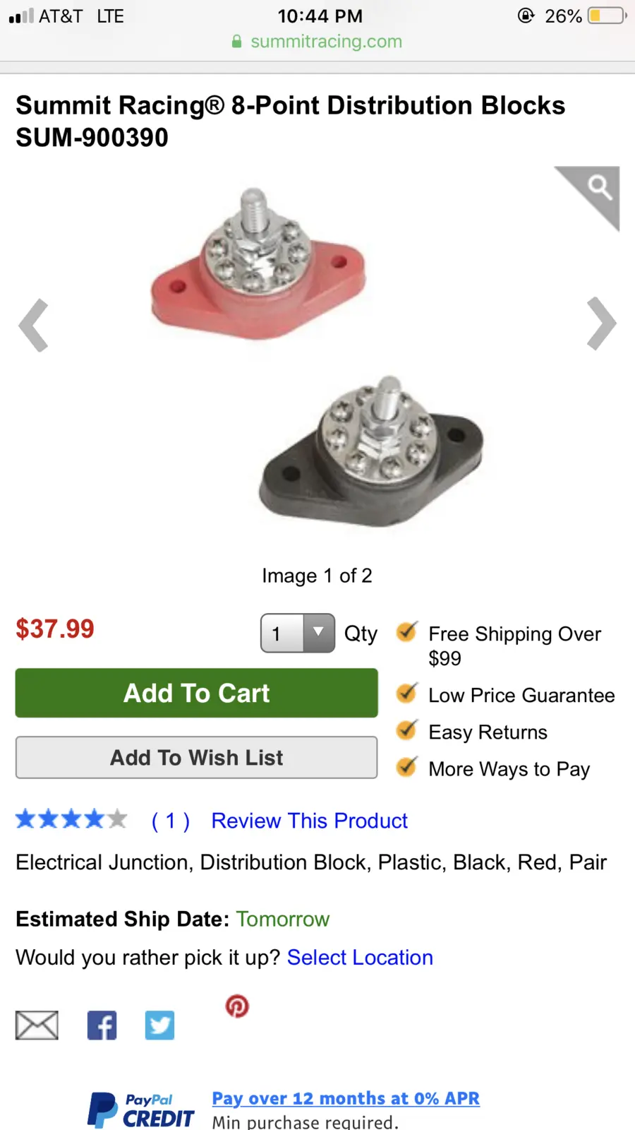

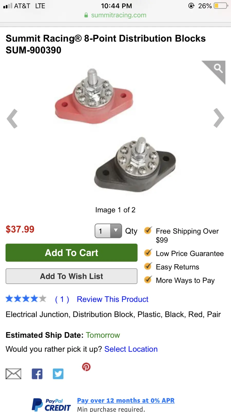

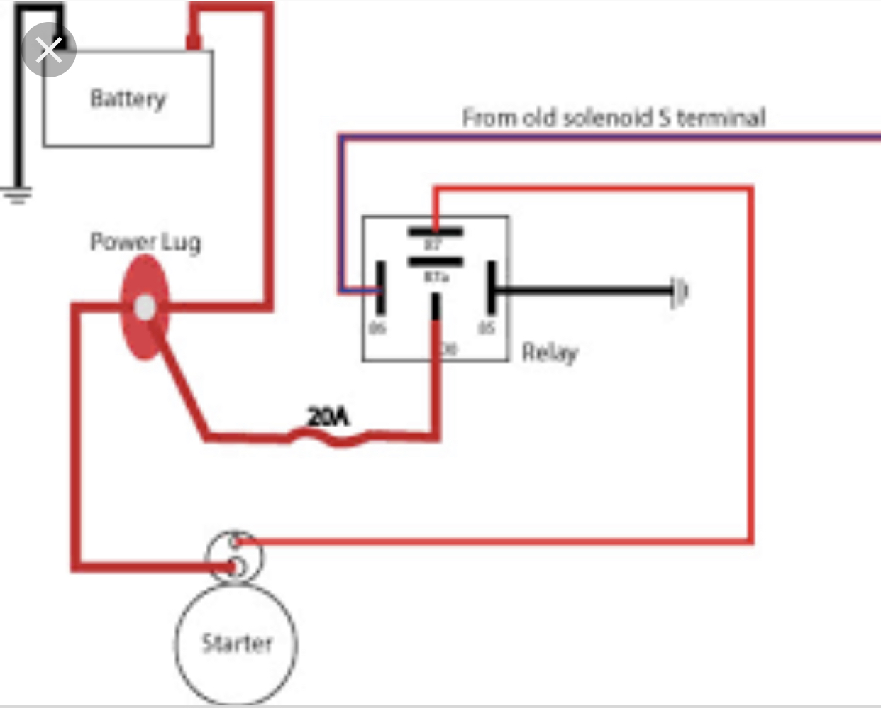

So making life easier on your wire tuck . This will only work with a car that already has a 93 style mini starter. I deleted the ford sol . Went with this which elimates the night mare with the posts being short
Added this and a relay off the key to the starter only thing I did here was 30 off the relay can go right to one of the power outputs on the junction stud above .
