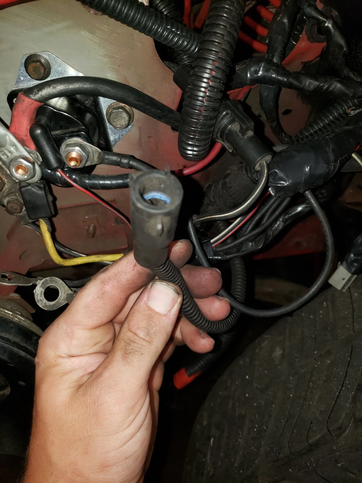

Do yourself a favor and run out to a pick and pull yard. Look for a mid 80s early 90s chevy pickup. They have a 5 post battery positive junction block behind a plastic cover at the top of the firewall. Those 2 wires should be on the battery side of the starter solenoid. Someone decided it was a good idea to make the replacement solenoids posts shorter. Smh

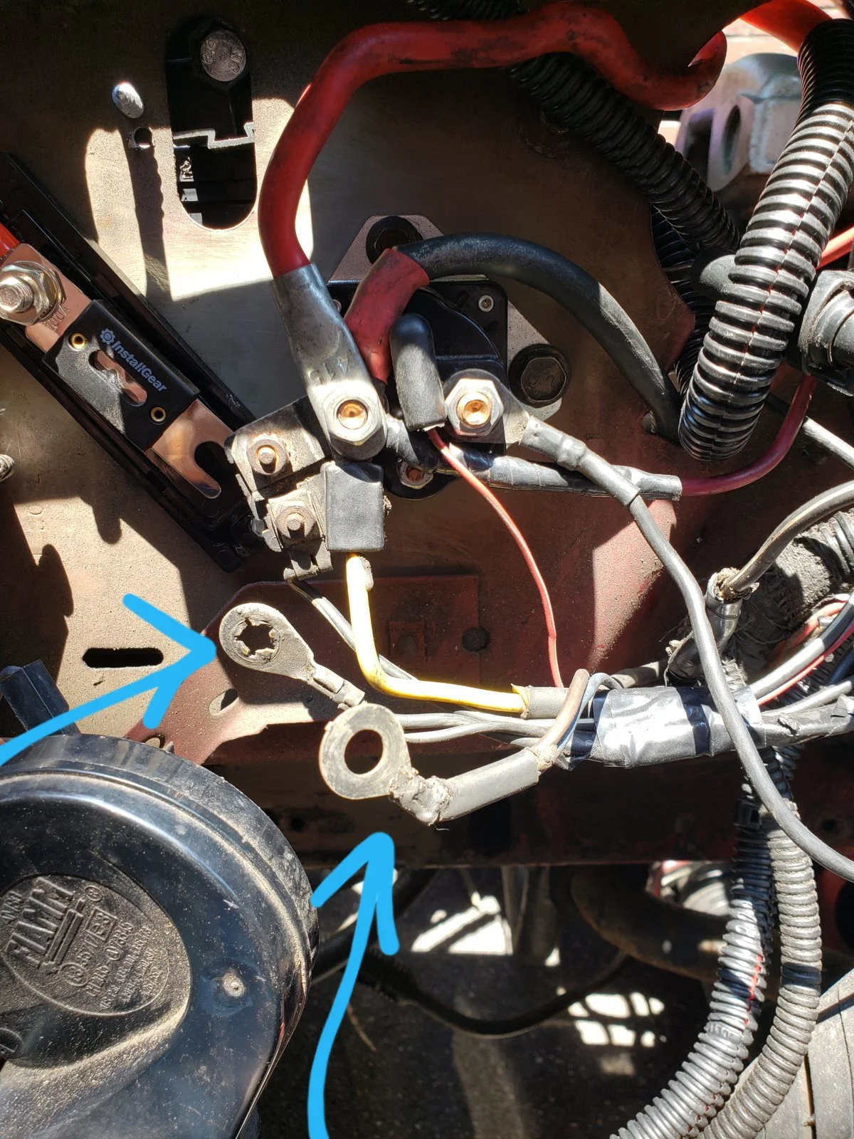

That wire with the star like pattern doesnt seem to fit over the post on the started solenoid, 100% it goes there?

The one with the star pattern in the center looks to be a ground. The other looks to go to the starter solenoid.

Star pattern is likely ground. Trace it back and see if it connects to the neg battery terminal.
If it does a screw bolts it to the inner fender

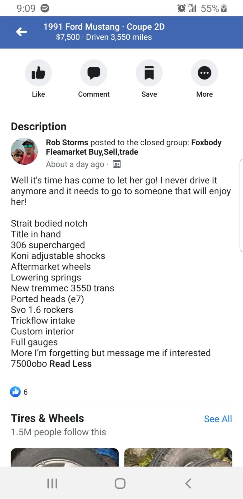

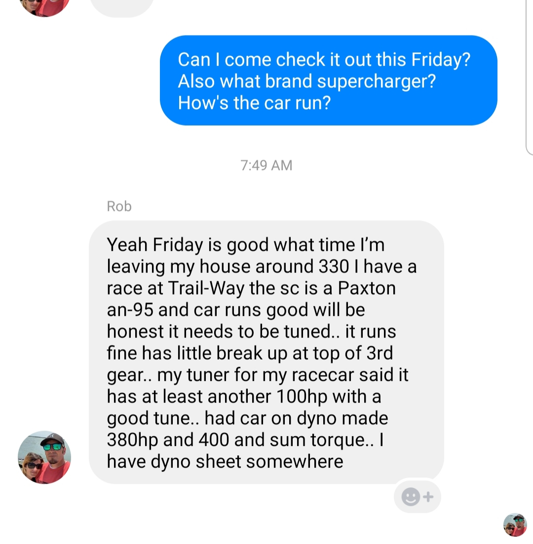

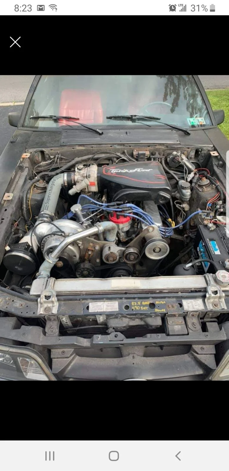

I found someone nearby selling their notch for $7500 obo. I'll attach pics below. The body looks in better shape than mine, it has more power. I have already invested probably $8500 total into mine. Do you think it's a good deal? What does it mean top of 3rd gear breaks up?

I can't advise you on what to do but I can give you an observation, out of 4 cars that I know of with power adders, 3 supercharged and 1 turbo, that have been bought around here I have towed 3 of them due to issues within a few months of ownership. Two head gasket problems and a bottom end that was beat senseless because of worn out bearings, that guy was a total liar. Not that there will be problems with this car, I just don't trust sellers anymore.

Yeah good points. It's hard to trust any seller. He has another car he races and based on the posting it looks like he did other engine work to this notch..

Not a fan of that car for $7500. Seems a bit ratty, but the pics aren't all that great. Plus it has a potential issue with the misfiring at WOT in 3rd. Could be tune, could be something else.
Pull the blower off that and it's a $3.5-4K car. I'd add $1K for the blower

Is it me or does something look weird with the right rear suspension? Curb?
