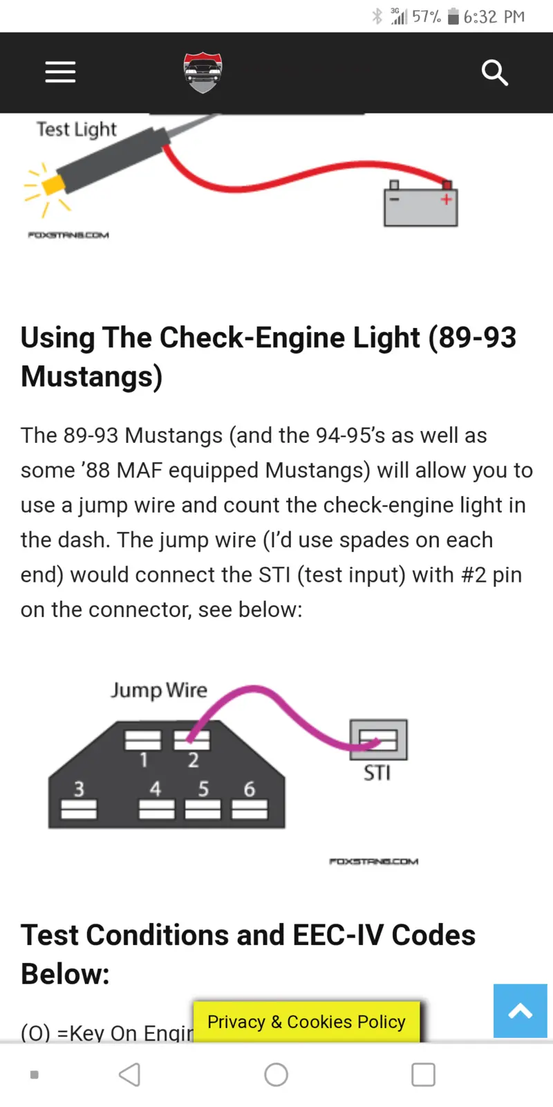

Used a jumper and got codes. 33. 34. 43.
I will post picture of the site i used for how to get codes. I checked codes with KOEO and KOER
