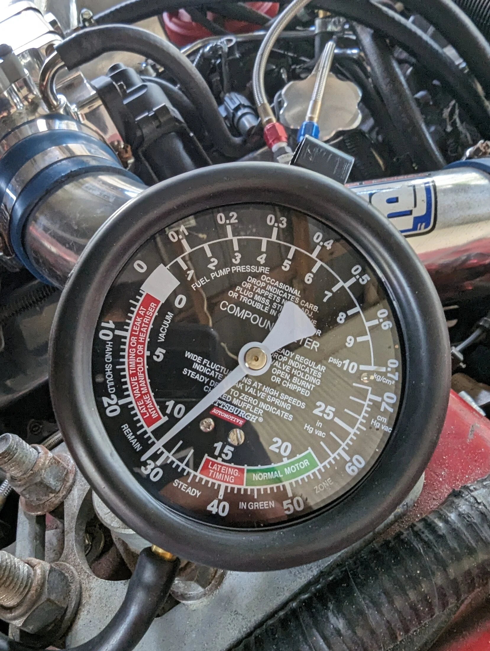

This is how much vacuum at idle also, not sure where it's supposed to be. It's a trick flow stage 1 cam
I’d say it’s a little low. Mild cam is usually somewhere between 12-16. Lots of things can affect it like timing being retarded and/or a vacuum leak(s).
Where did you pull the vacuum at?
From right behind the throttle body, it's a Holley systemax 2 intake so one of the 3 ports back there now after running it for about 20 minutes it went all the way to the green section on the gauge and stayed there. . Timing is at 12° initial

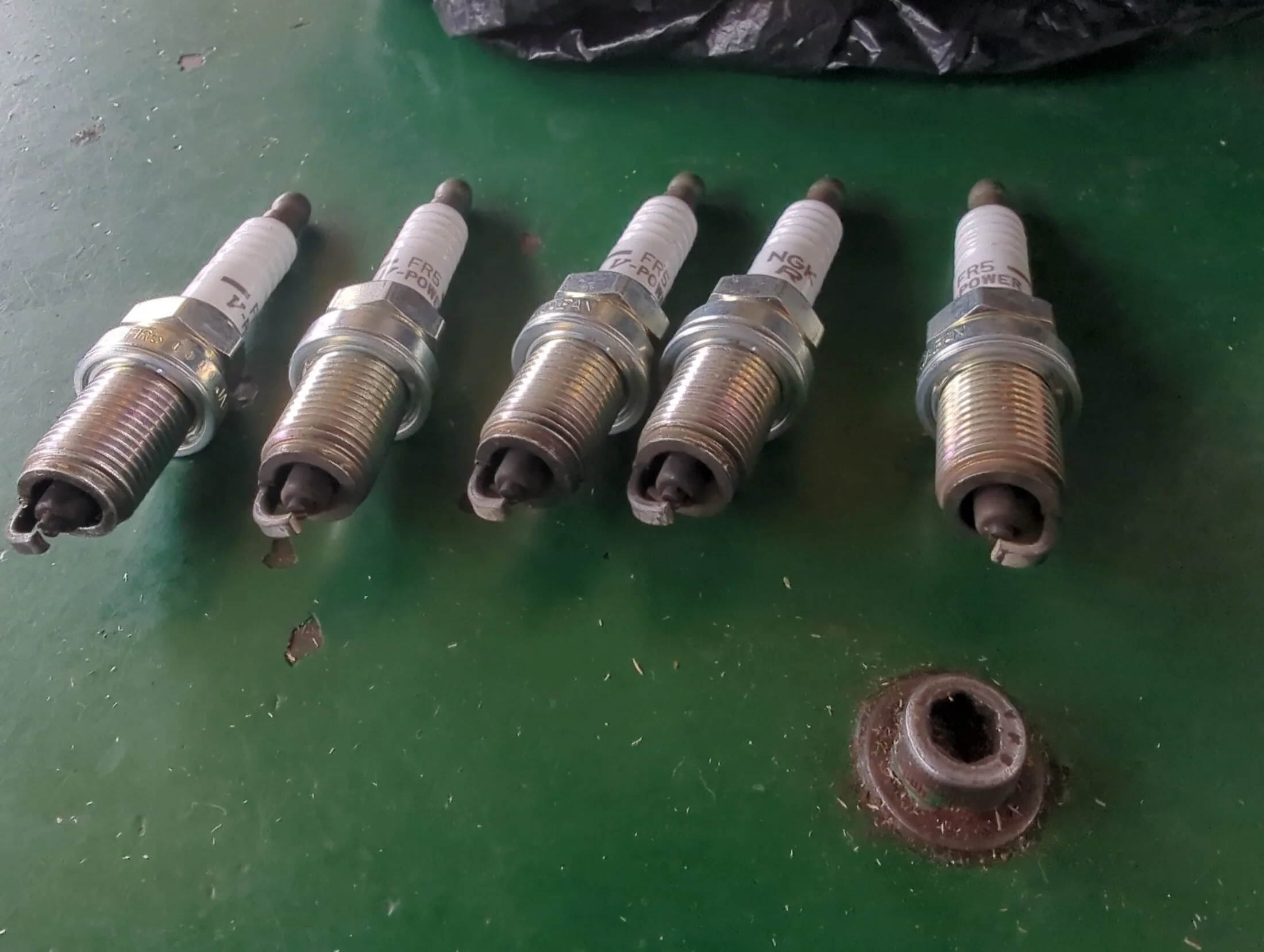

These are the plugs from when the one injector wasn't working. That's why that one plug looks brand new. It's not oil. It's definitely carbon AFR gauge is a Autometer. Before this top end kit the car literally ran perfect. I would have drove it from Florida to California and not thought twice about it. Everything happened after this top end kit
These are the second set

I just do not see how the AFR is reading correctly if the plugs are fuel fouled. Is the Autometer unit a narrow band or wide band? Either way it just sounds like it has issues but regardless that does not solve the problem. Any chance you have another ECU you can try?
It's a wide band. The sensor is on the driver side which is where the bad cylinders coming from, So maybe that's why it's getting funky readings. I don't have an extra computer. I have a complete Holly Terminator x system sitting in the box. I just bought it when I thought they were going away for future turbo stroker motor builds.

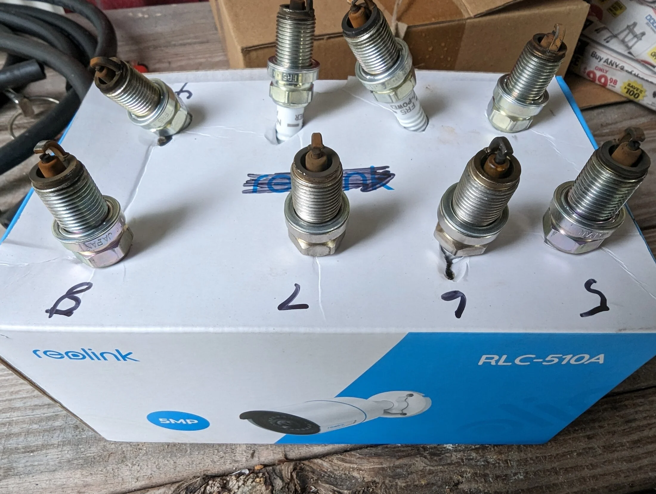

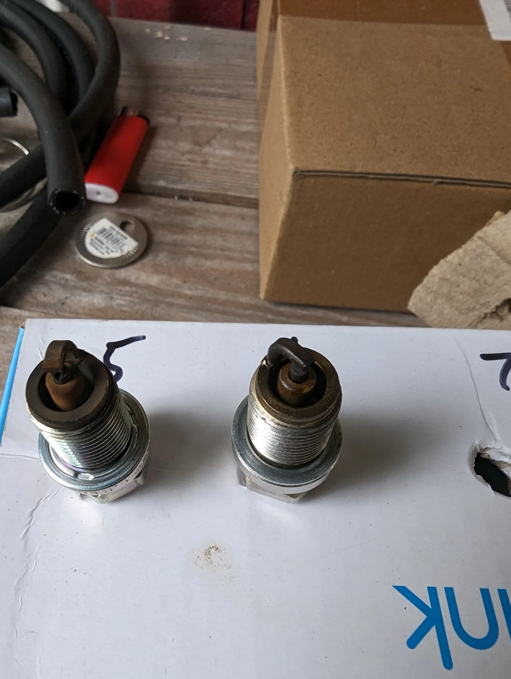

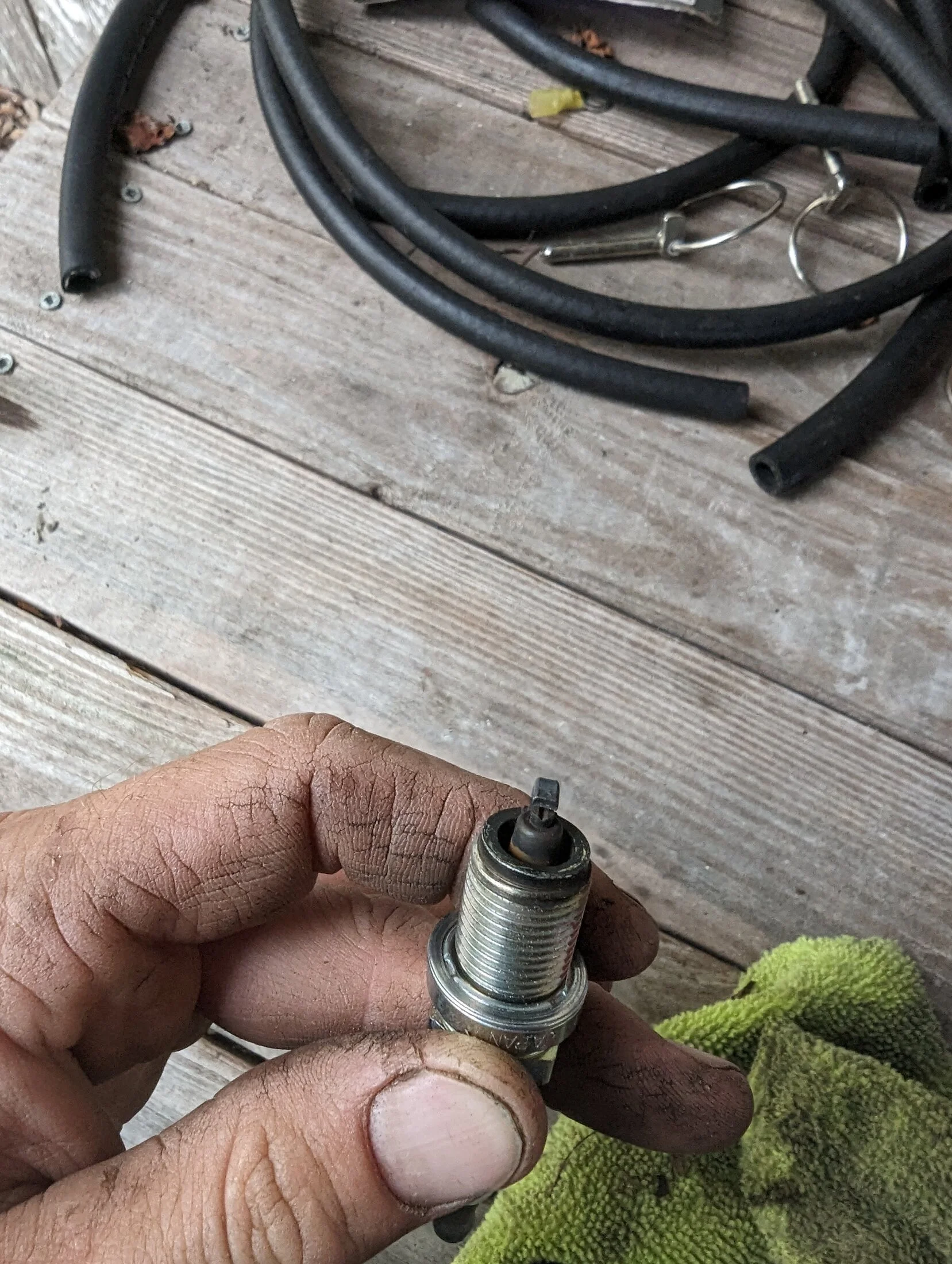

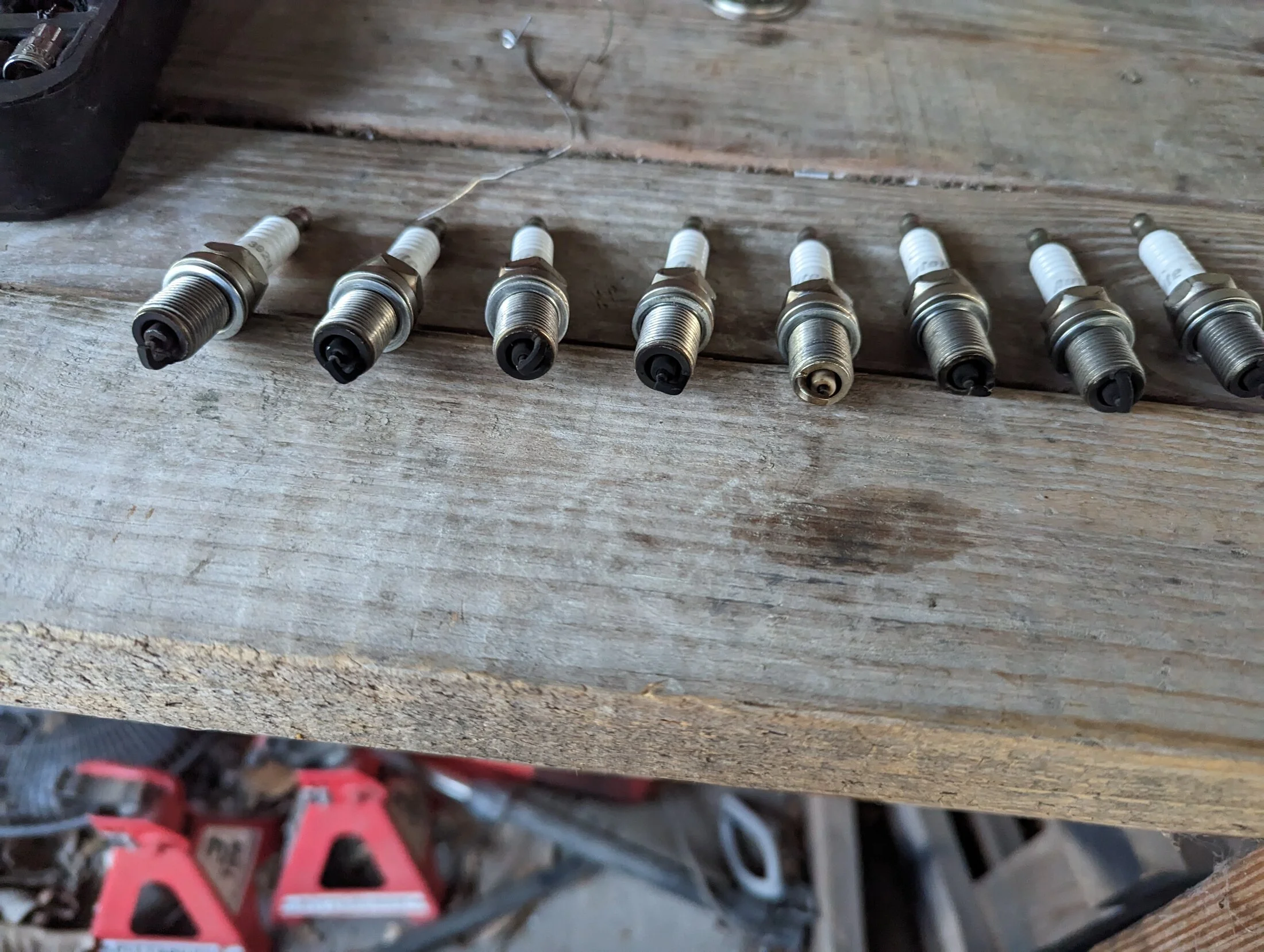

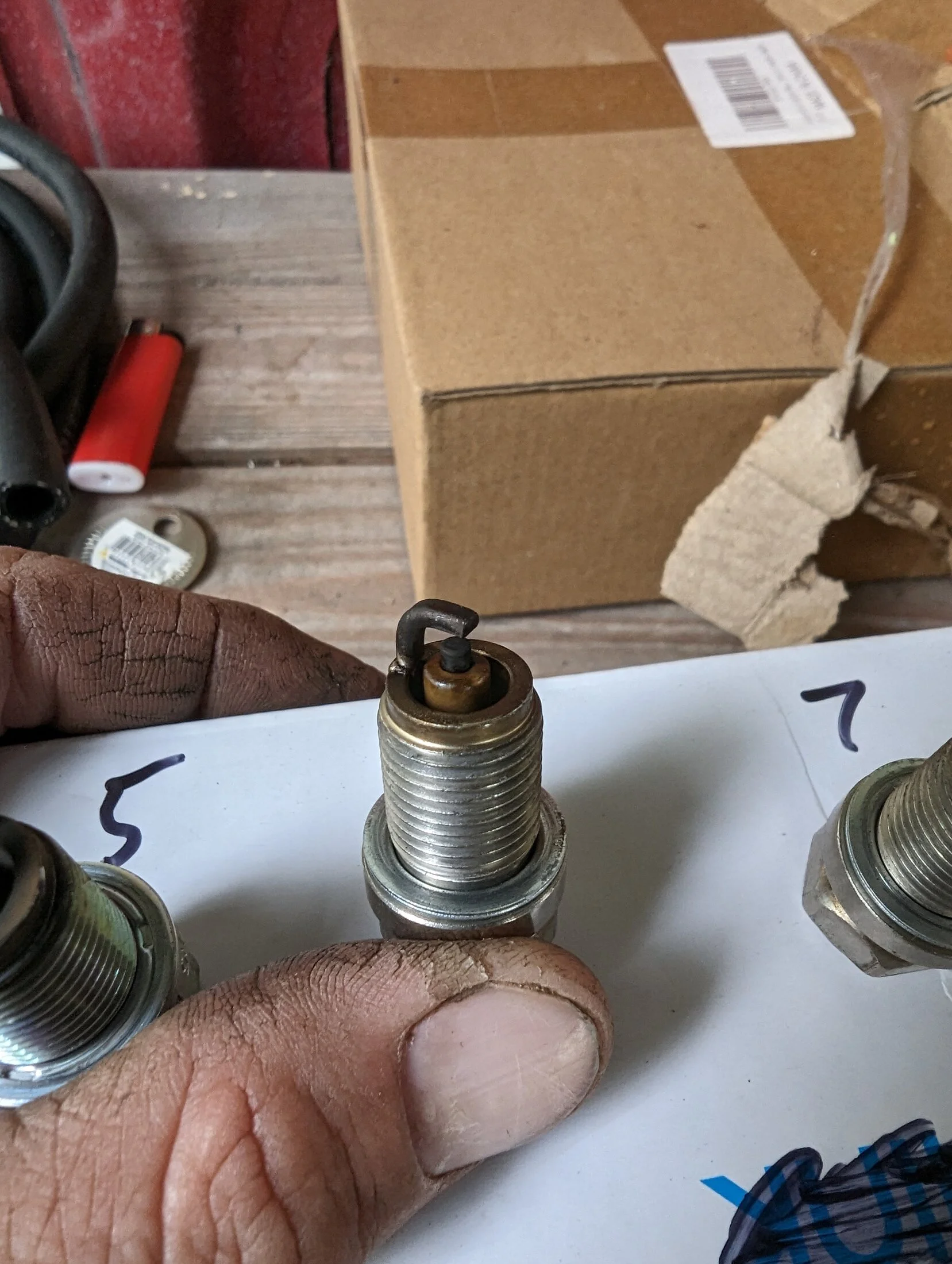

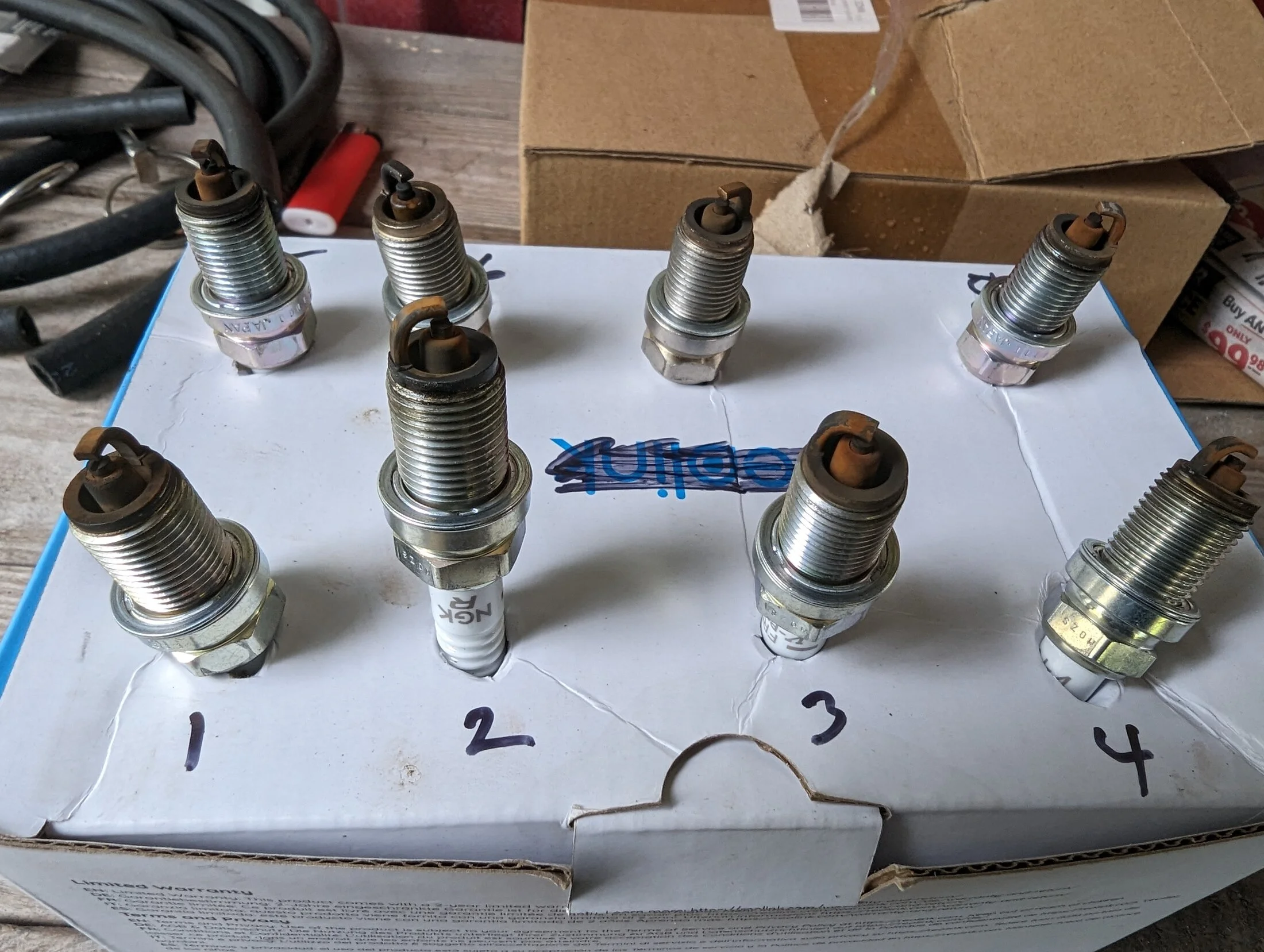

I just pulled these plugs this set don't look fouled at all. Number 6 is definitely soaked in fuel. I'm not sure if the orange is from the left over octane boost in the car or not. My buddy told me about using it with the nitrous but after I looked at the plugs that stuff makes it hard to read so I quit using it. Don't hate on my makeshift plug holder
