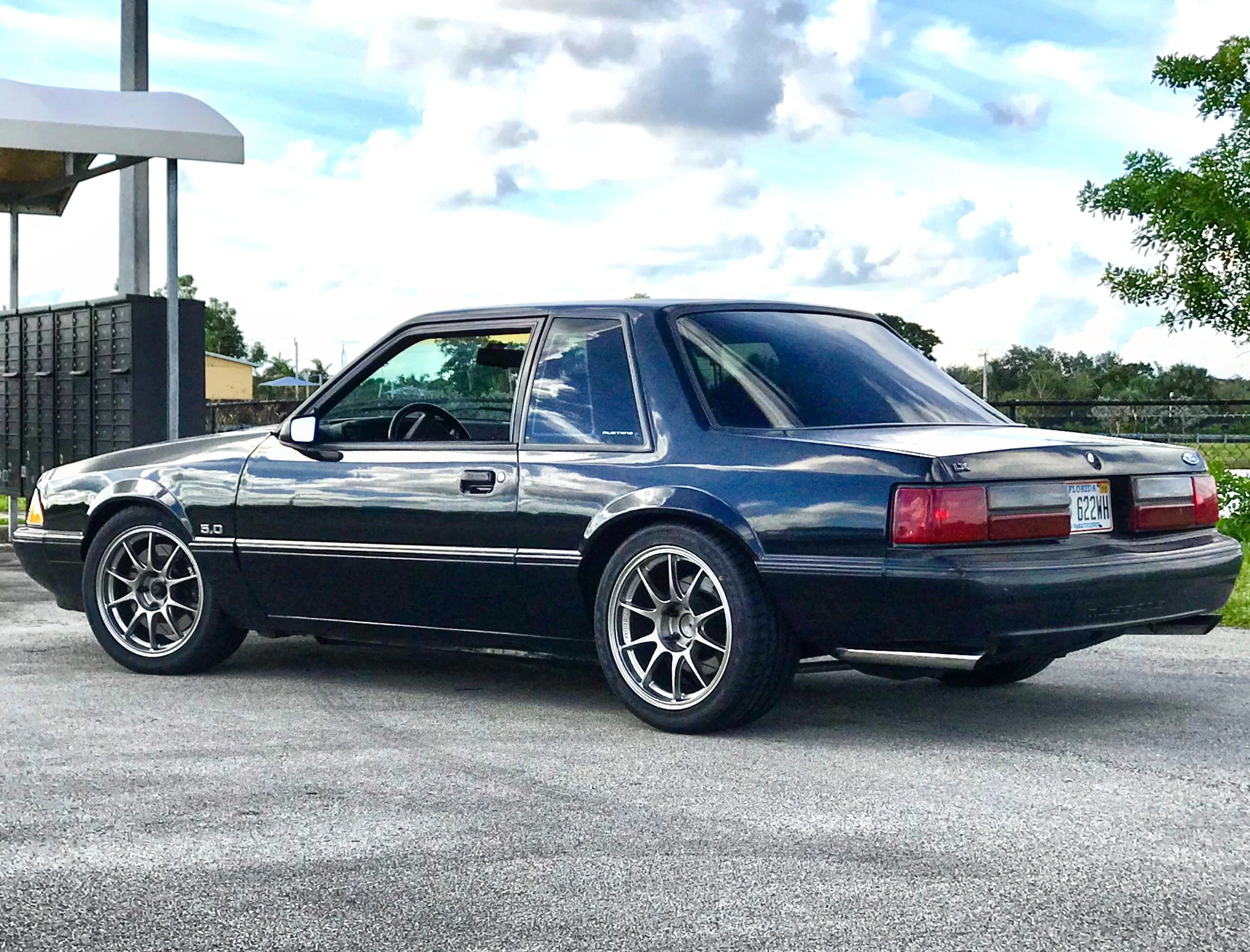

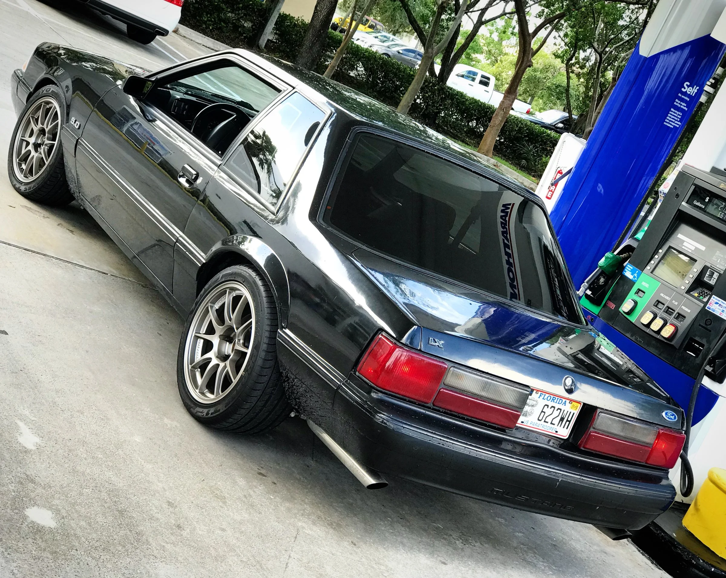

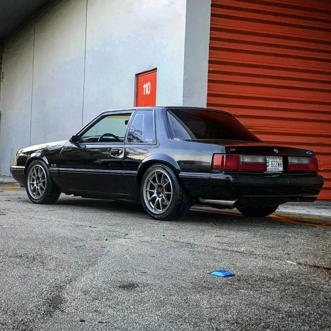

Oh dude! I remember you now. Where ya been? Love that beautiful notch, even though I'm a hatch guy myself, yours really looks amazing!
