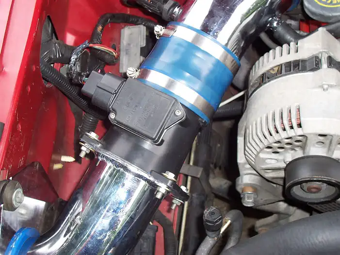

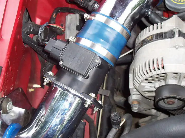

94/95 MAF install completed!

Okay, I just received my Ebay MAF adapter. It does fit but it is very flimsy and you may have trouble getting the gasket that goes between the adapter and the MAF to seal up good. The sealing flange is made of very weak and thin aluminum and bends easily by hand. When you tighten the bolts to attach the adapter to the MAF be gentle or they will warp the adapter. I must say, however, that the weld between the flange and the 3.5" pipe is exceptional. Very nice looking.
If you have the $44.95 to spend you should buy the adapter from the Kustomz website above but if you're on a serious budget then the Ebay adapter will work.
My ebay adapter worked fine. The gasket on my CAI doesnt go all the way to the square part due to the bolts pushing it out a bit but it still seals ok. I didnt think the one I got was flimsy like that.

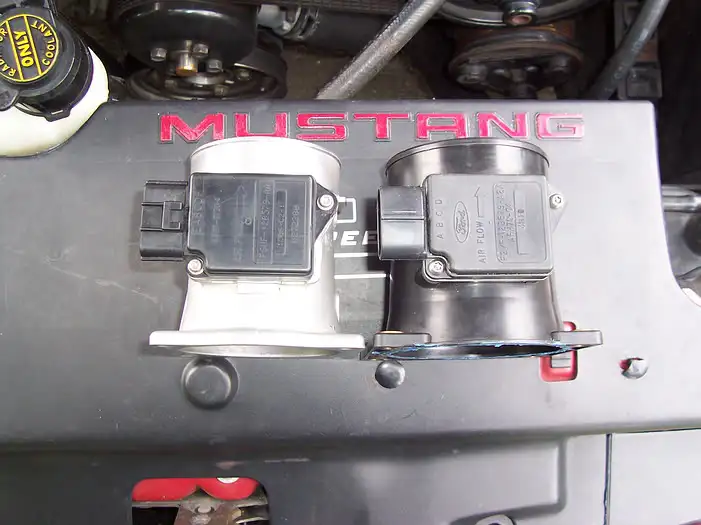

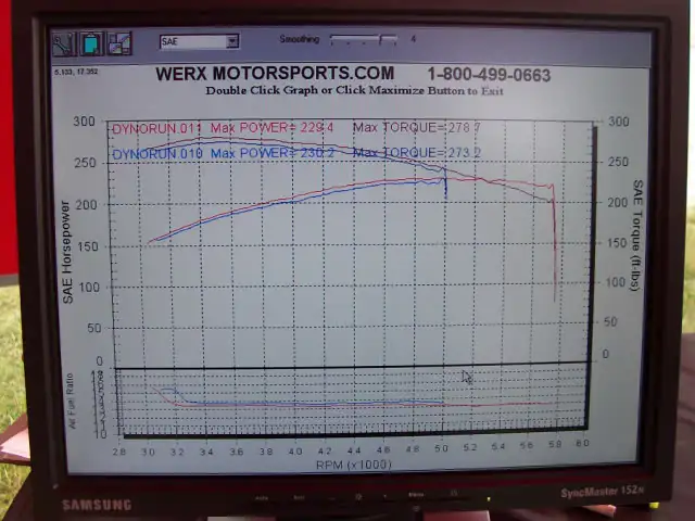

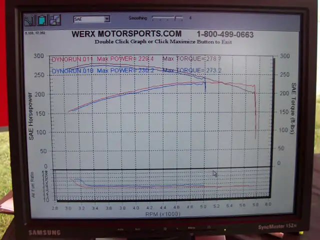

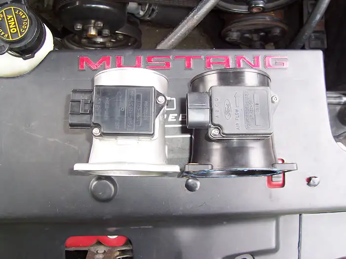

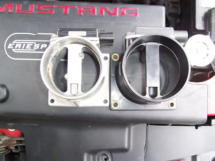

How about 94-95 MASS sensor in 01 Bullit GT housing , i use that for about year , made 230HP/280TQ before h/c

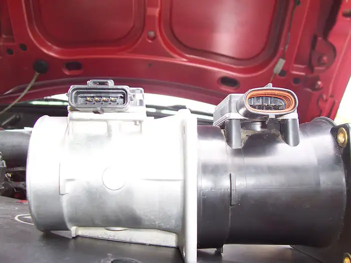

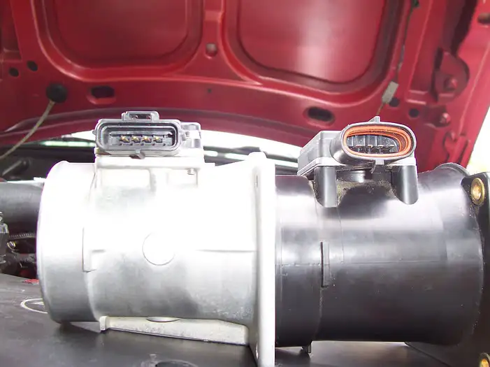

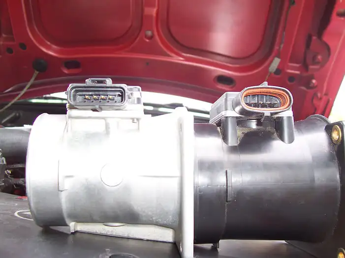

Not to hijack, but when running the SN95 on a Fox, do you have to get the pig tail too? I noticed in one of the pics posted above that the SN95 is rectangle with a ridge on each side. My Fox is a little more oval looking.
The SN-95 MAS is plug and play on the original Fox wiring harness. If it does not fit then someone has either changed the wiring or the sensor in the meter.

Mine is almost identical to this situation. The MAF harness pigtail on my 91 is more oval like the one on the right. The MAF sensor connection on the 94/95 MAF I have is rectangle like the one on the right. Do I just need to clip a pigtail from a 94/95 and solder it on?
The connector on the right is the correct connector. If your MAS has a rectangular connector it is the wrong one. The first 4 digits on the MAS should be F2VF. There were no other MAS meters used on the 94/95. The pigtail on the 94/95 is also oval.
The MAS from the 94/95 is plug and play. If you have to do any electrical modifications then something is wrong. Either someone has changed something or you didn't get what you paid for.
