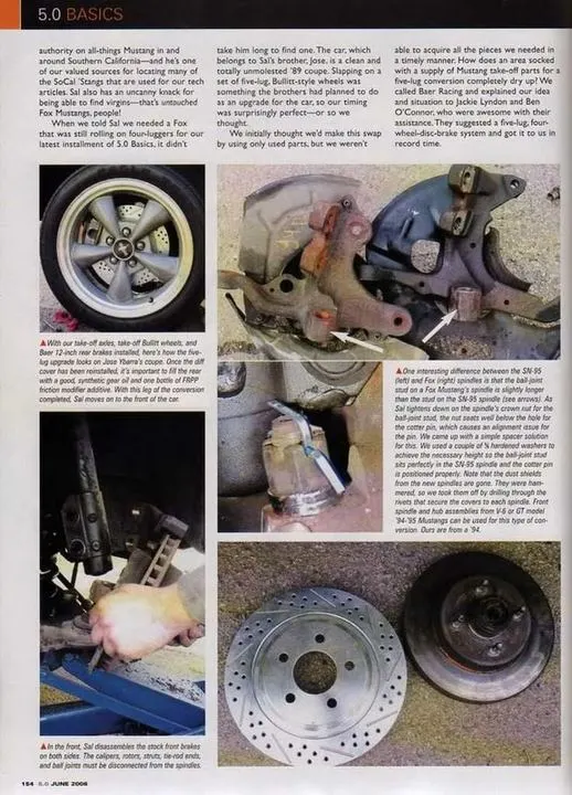

Wrong. 94/95, 96-98, 99-04 are all different (I MIGHT be wrong with the 96-98 & 99-04, but the 94/94 is DEFINITELY different from the 96-04). Here's the quick way to tell the difference:
Hold the spindle so the hub/lug nuts are facing you. Now look at the steering arm. If it has a curve in it (looks like an upward bend) it's a 94/95. If the steering arm is straight (no bend) it's a 96-04.
There are other differences but they are very difficult to realize by just looking at them, this is the easiest way. If you don't really know what your doing or aren't confident with your knowledge on the subject, get the 94/95 spindles with fox length A arms to save yourself headaches.
