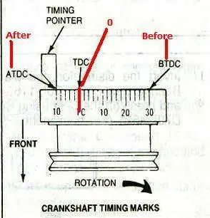

Well I wrote that up all wrong sry guys! Ok car set at 14deg btc. Was going to put it back to 10deg make a 35 shot hit on stock plugs and stock timing just to make sure everything works! Then I was going to put in 2deg colder plugs gaped 30 and 100shot pull timing from there. What boggles me is when talking about pulling timing form these car ppl are tell me to adjust timing toward tdc so im actually advancing timing! Is this right?
No. Wrong. You have to retard timing. Advance it and go boom.
[QUOTE"Boosted92LX, post: 8922143, member: 168157"]No. Wrong. You have to retard timing. Advance it and go boom.[/QUOTE]

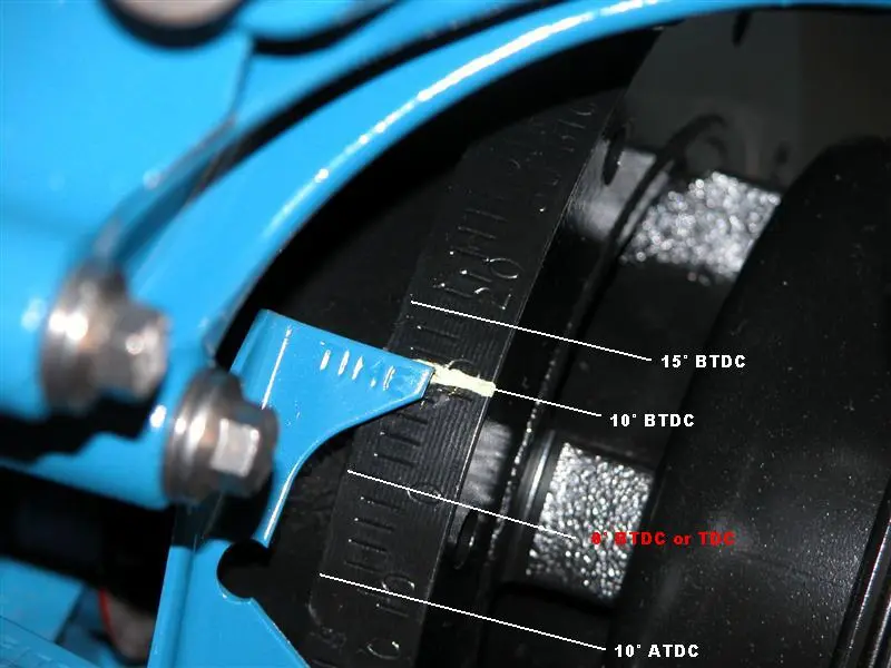

Ok so If im looking at the timing marks it adc10''''0''''10''''20''''30tbc. So Im setting. /\ 14deg tbc on timing right now so from what ur telling me im already pulled timing out for a 100 shot
Told eveyone timing boggles me for some reason lol ok so let take the base timing on a stock 5.0 it set at 10deg btdc with spout connector out and more to 6deg btdc is morning closer to btdc this is where I thinking im getting lost never mind I pulled a blonde moment I forgot whst atdc stood for lol
go back and read my earlier post until it sinks in. Moving closer to 0 from 10 BTDC is retarding the timing. You will hear the rpms drop.
