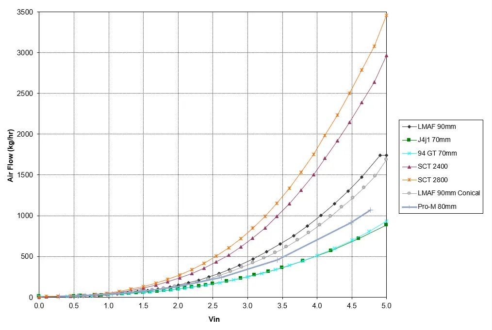

Here is a MAF compare plot I put together a long time ago. This is based on the MAF transfer function data posted on TunerExchange. (I wish that site was still around.) The '94/'95 GT MAF is the same part as the Cobra MAF. The calibrations are nearly identical. There are some small differences in the values and break point selection, which could be from fine tuning changes the calibrators made at the time. I believe Ford calibrated the GT and Roush calibrated the Cobra.
The Pro-M 80mm data is from a friend's part where Pro-M provided the flow data sheet. This meter is calibrated for 24 lb/h injectors with a stock GT ECU expecting 19 pound/hour injectors, so it has a 26% flow shift high to correct for the difference in fuel flow rate. However, the best approach would be to change the calibration itself to match both the air meter and the injector flow rates to minimize issues.
