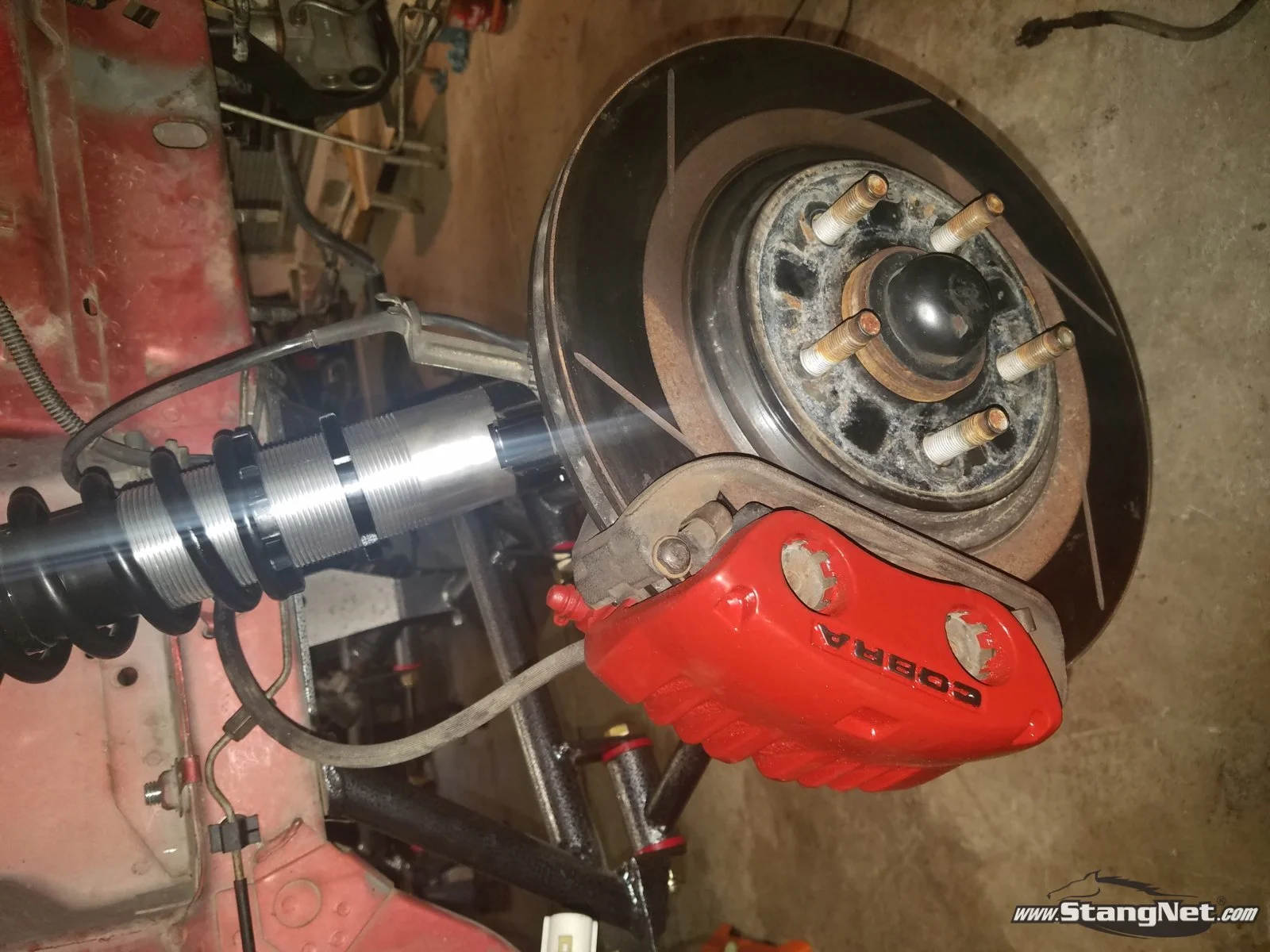

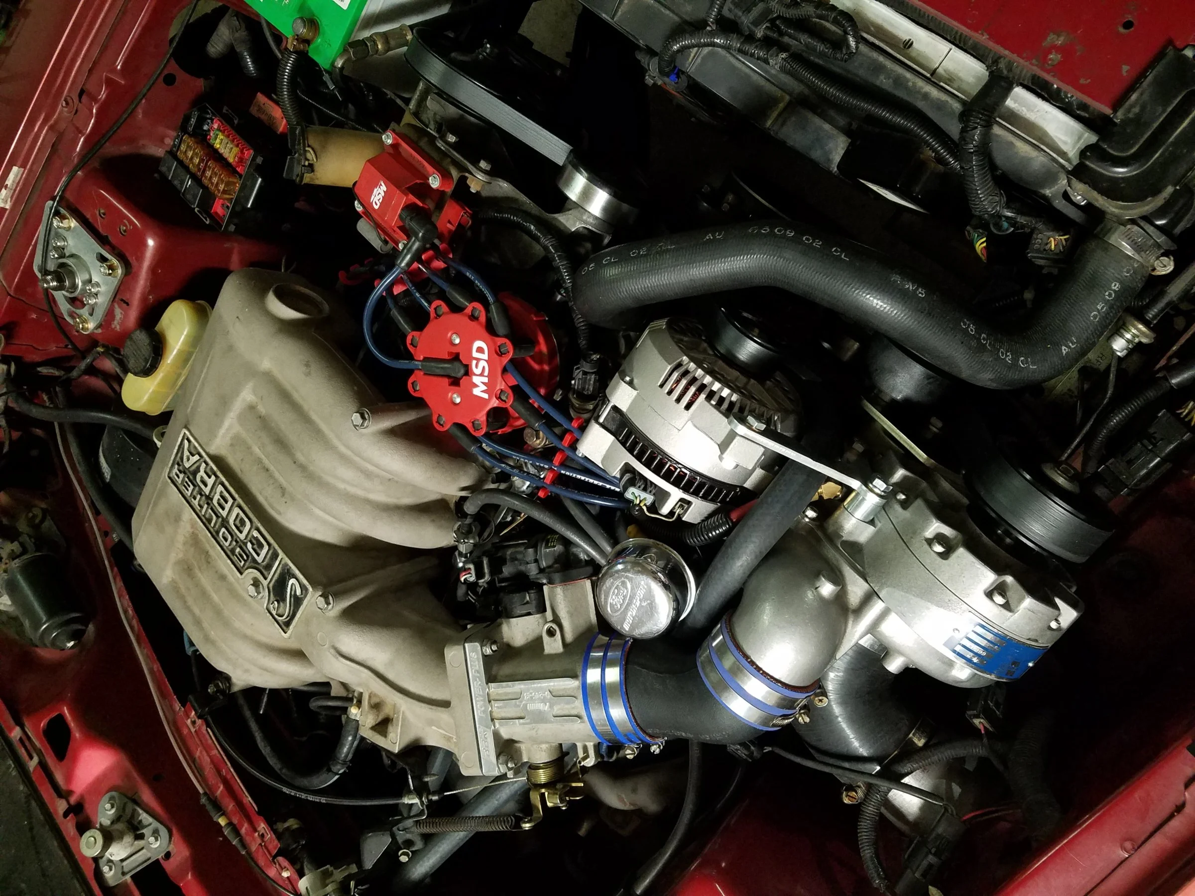

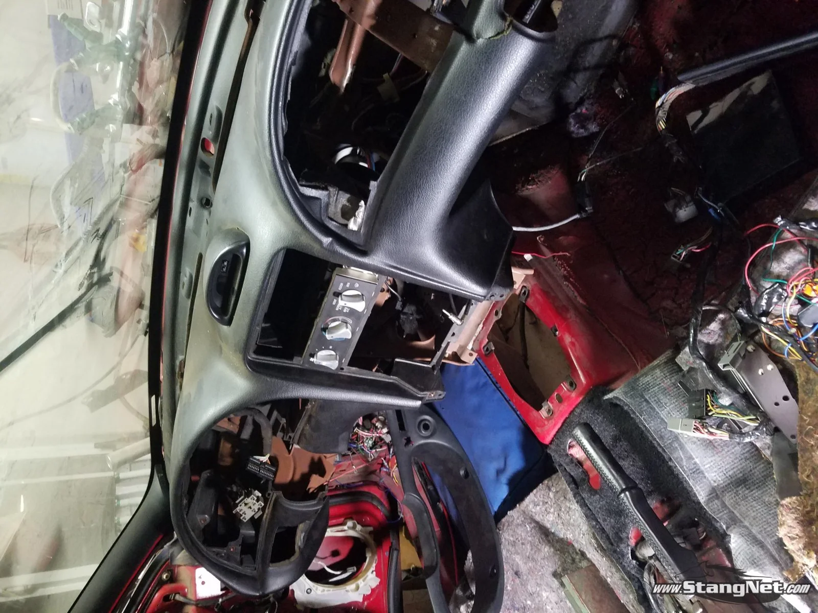

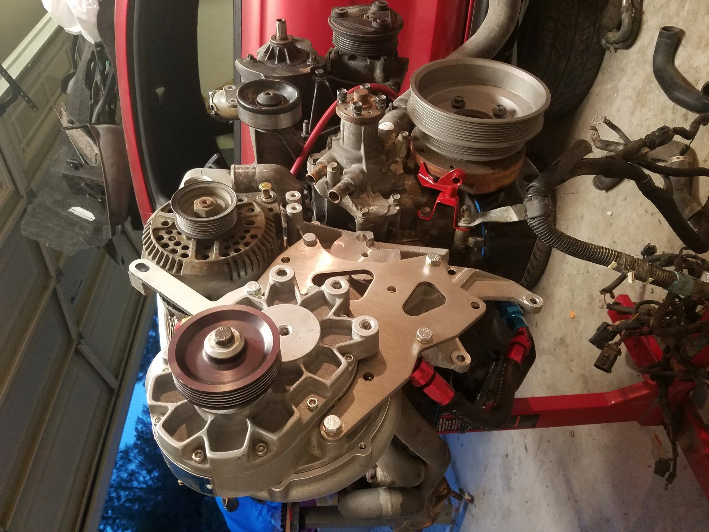

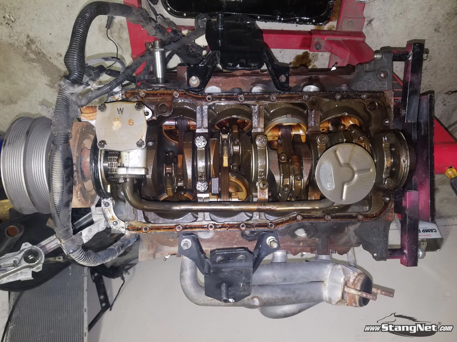

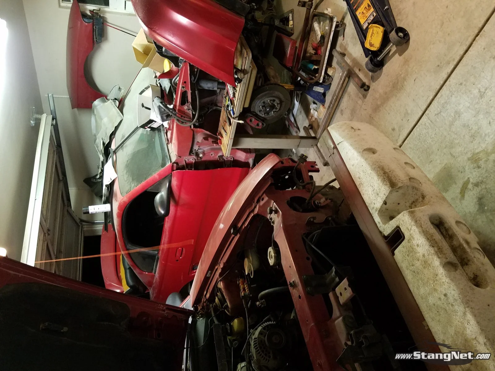

You can use a LOT of v6 stuff for the build.. to give you an idea.. I just took my 95 cobra and ripped both it and a 95 v6 car totally apart about 90%.. I kept all of the cobra specific wiring and such of course, but man.. a LOT of parts i've been borrowing from the v6.. for obvious reasons a lot of the parts are the same.. you def. need GT/Cobra computer and matching harness though.. best best is to go to a junkyard and rip one out of a gt or cobra if they have one.
Good luck.

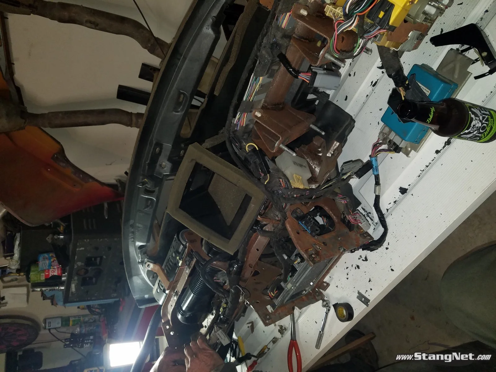

Damn.. ok lemme go through the last 6 or 7 months on my phone haha.. I was gonna do it eventually for a whole thread but 'm sure I can throw a few up here showing progress.. it was a NIGHTMARE.. not so much in terms of being 'hard' just.. time consuming and extremely frustrating and how Ford put :poo: together.. lmfao.. WOW....
Gimme a few mins haha..
You get the idea.... .
I have to click them LOL
Reactions: Davedacarpainter

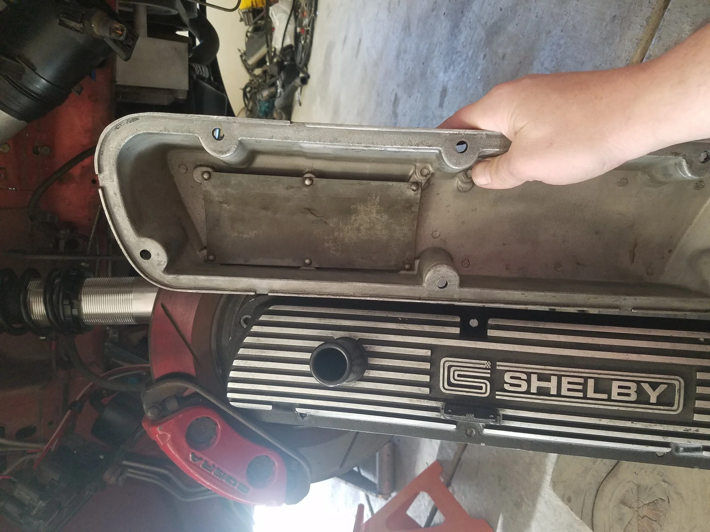

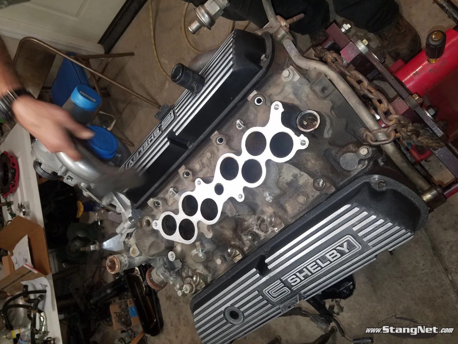

Those Shelby covers are original, 68-70 289. they have the proper cuts/galvanized baffles/etc.. and are NOT the Drake repros.. they don't fit my 1.7 RR's as they tap a bit.. so.. they are for sale. Anyone interested.. i'd take 4 bills lol.

Yep.. It's better to piece it out if you know what you're doing mechanically.. just yank it apart and sell it.. i've probably taken 10 or 12 pieces off the v6 to round out this project.. a lot of the 'new' $50 and $70 parts? All on the v6.. same :poo:. I've saved a small fortune having a v6 donor here.. I'm sort of amazed myself, lol. And I can always go junkyard hunt and replace most of the little stuff.. no worries.
