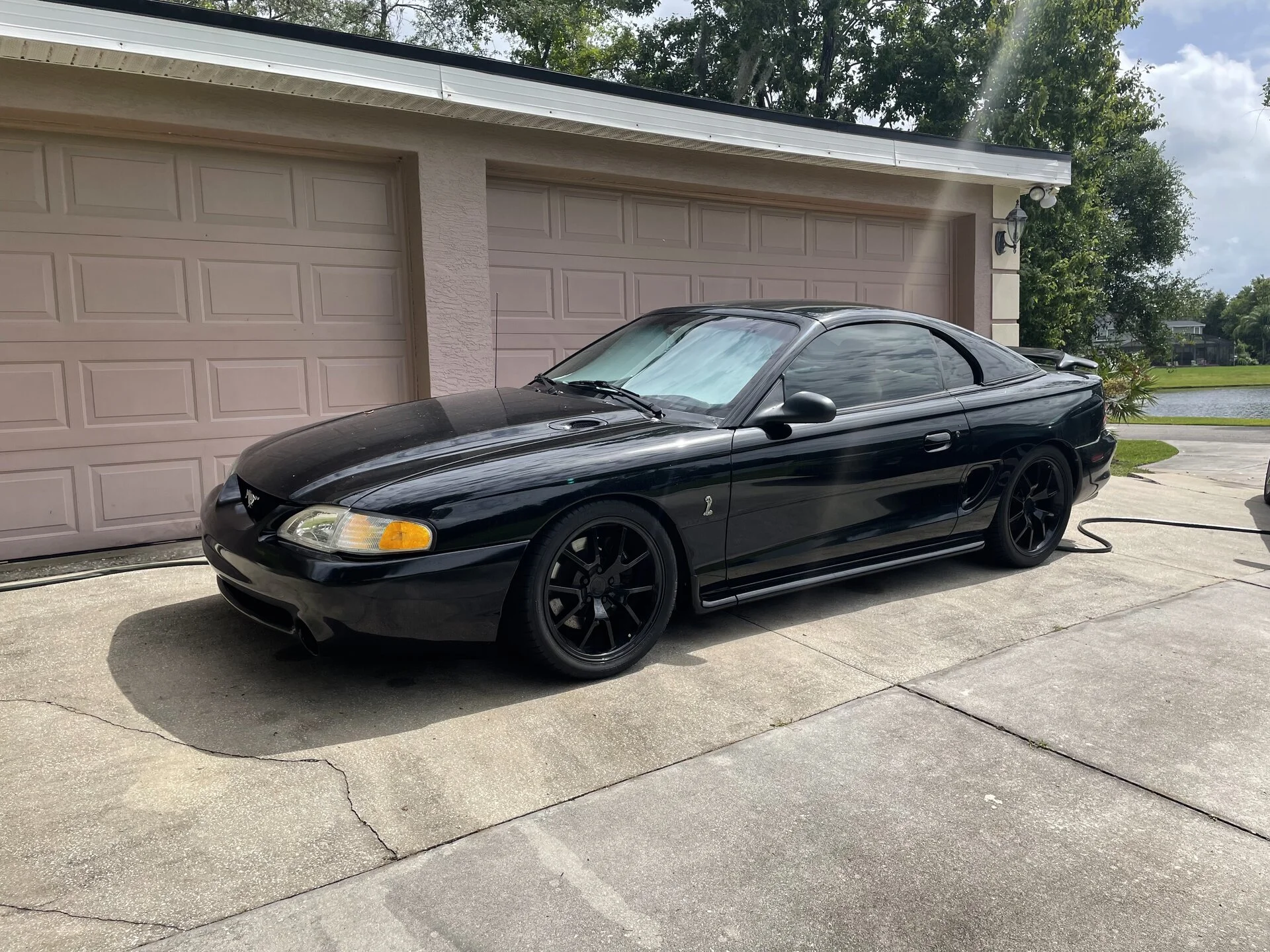

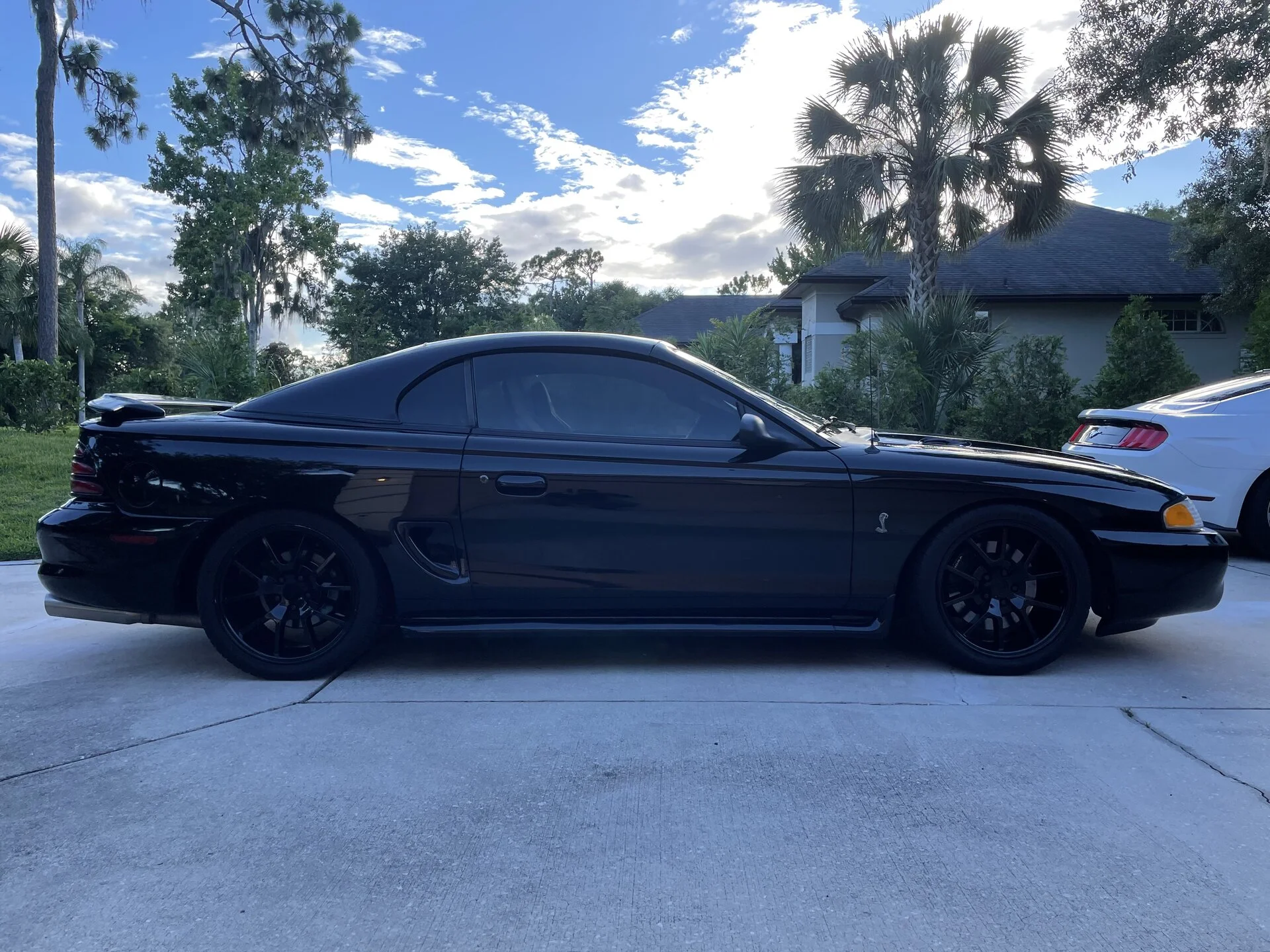

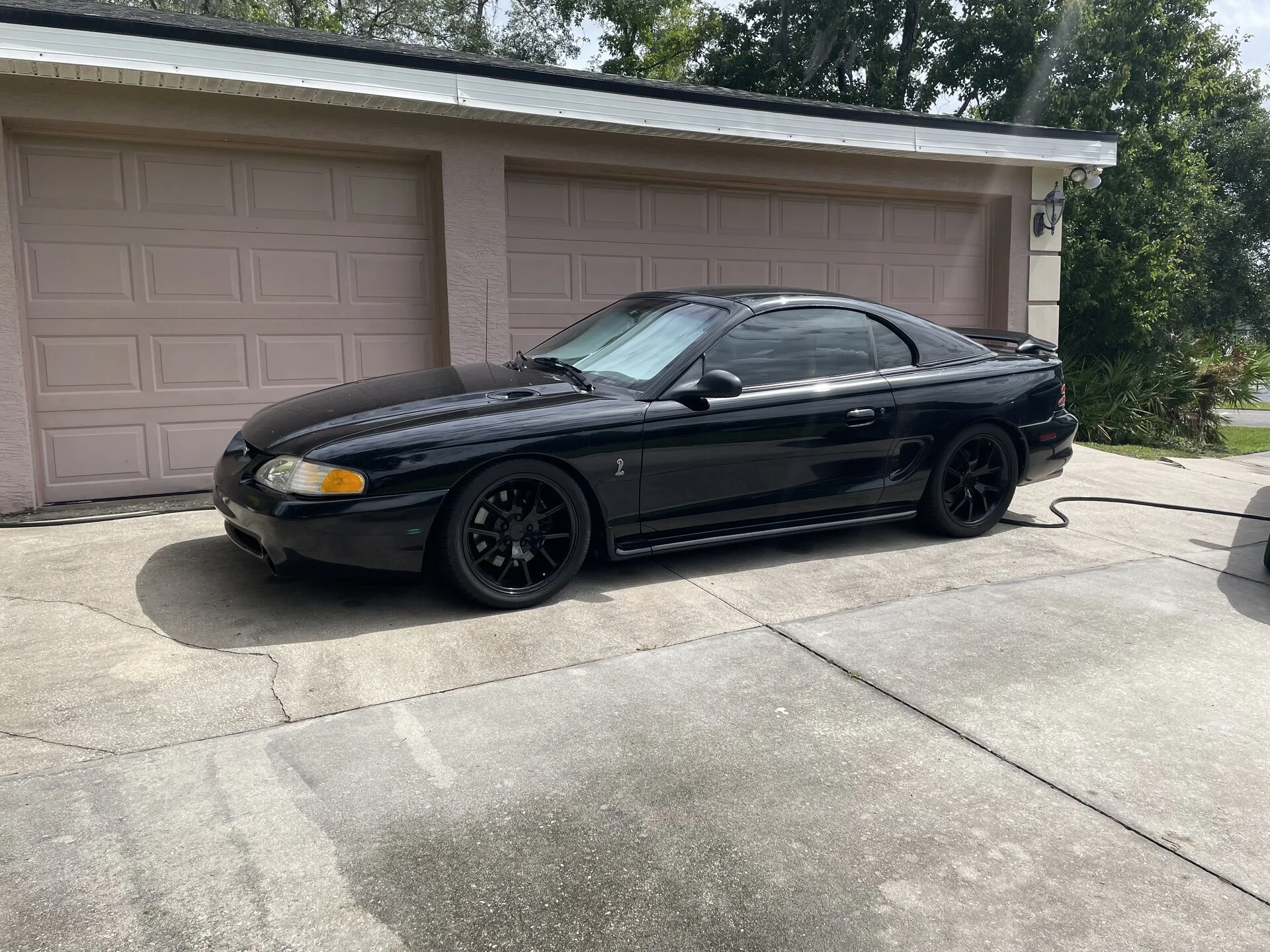

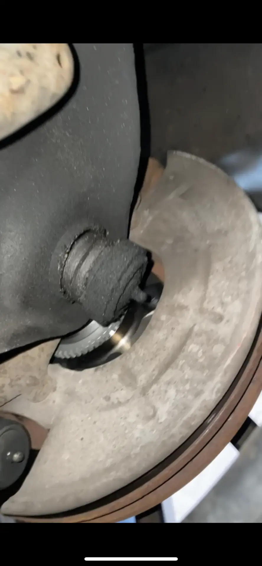

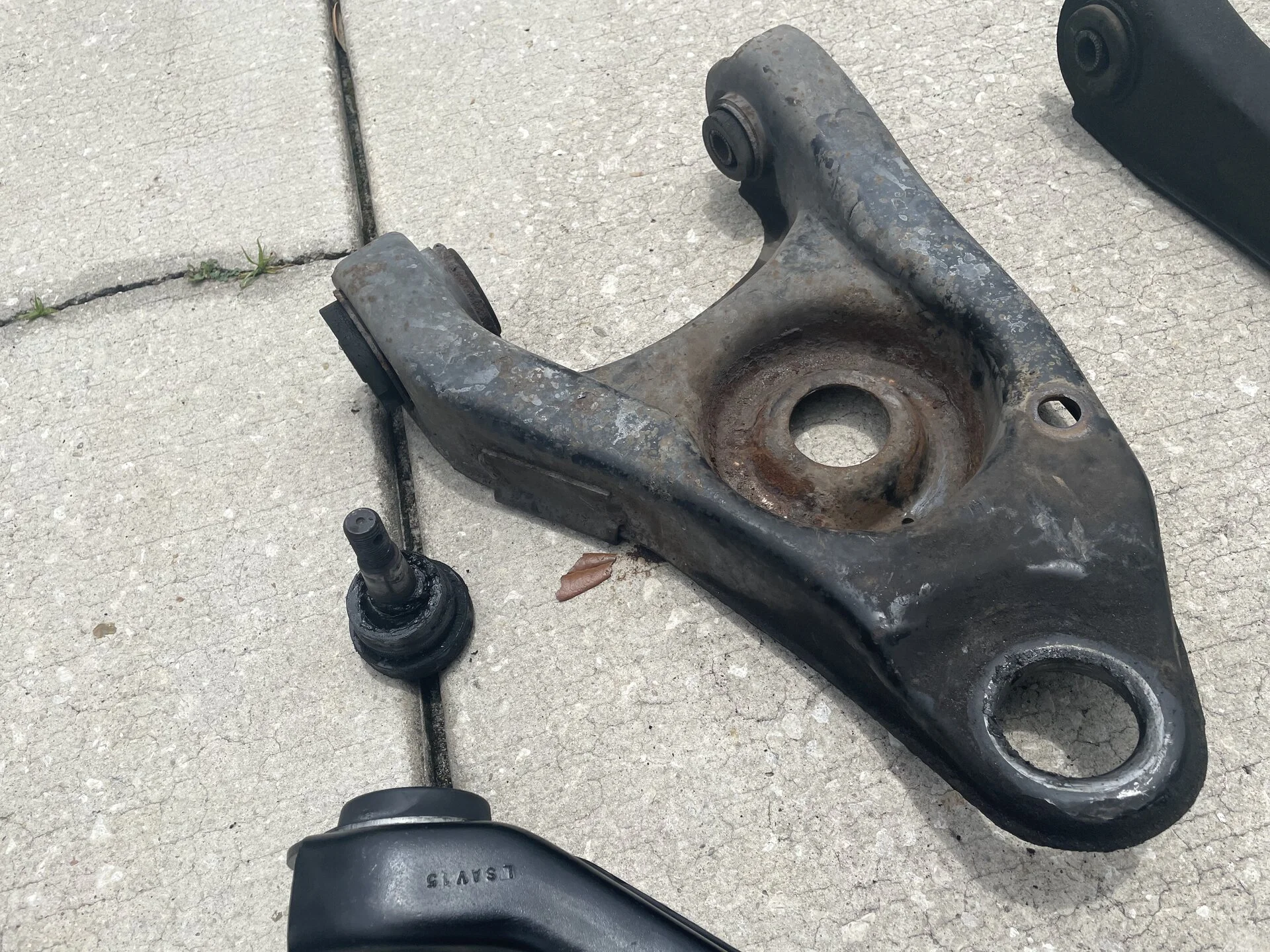

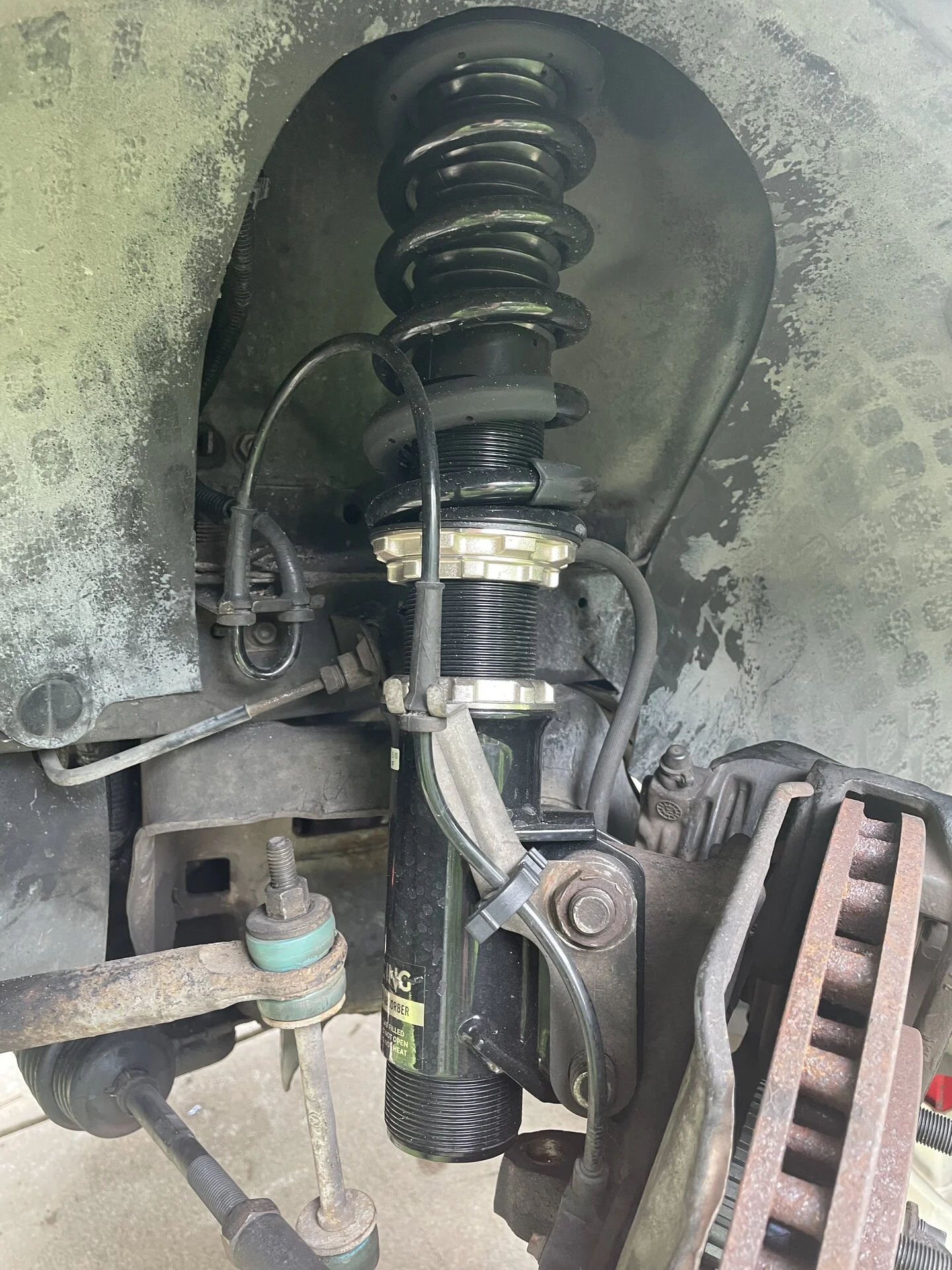

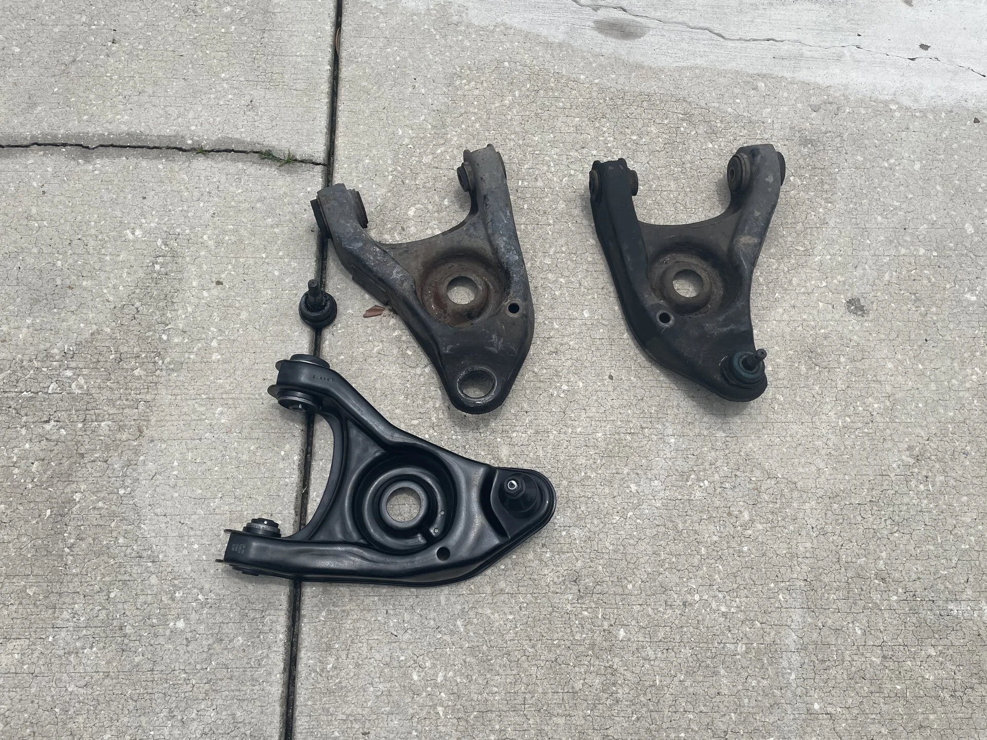

Finally got around to installing the coilovers but ran into a few issues. My 18x9 wheels up front rubbed your against the coilovers so I needed to add a 1/4” spacer to give myself the clearance. At the same time I installed new Moog wheel bearings and energy suspension poly sway bar bushings. On the test drive there was a very loud clunk and the wheel had very weird camber. Come to find this
So took the opportunity to just replace the entire control arm with new bushings. $160 later on Amazon the Dorman units arrived and installed surprisingly seamlessly.
Got the ride height adjusted to my liking and ended up about .5-.75” lower all around then I was on the B springs. Alignment appointment is set for this coming Friday and then she will be back on the road!
Final stance

The top bolt on the strut to spindle is a small slotted hole that has a little adjustability.
Since the tire hits the spring, loosen the top bolt and pull out on the strut and that will make a tiny big more clearance from the tire to spring. Do this to both side and it may eliminate the need for the spacer.
Assuming it’s not done already
Reactions: Essn95
Thanks for the tip, I tried to pull out the strut and then tighten but it was still rubbing unfortunately. With the spacer it gives me just enough clearance. On the bright side it brings the tire flush with fender, I would like to do the same on the rear but the fender lip design back there doesn’t allow it without rolling it pretty aggressively.

More bad news as expected. Just left the alignment shop this morning and they brought me to the line rack to confirm my suspicions. The BC Coilovers caste camber plates did not allow enough adjustability to get rid of all the negative camber. The machine shows that we are maxed out at -3 deg of camber, although it really doesn't appear as bad visually. Naturally my worry with this is tire wear. My tires are directional so I can only rotate front to back to prolong the life of the tires. We got the toe dialed in so that will help the wear. Short of modifying the slots in the strut tower which I will absolutely not be doing, is there anyway to get rid of this camber?

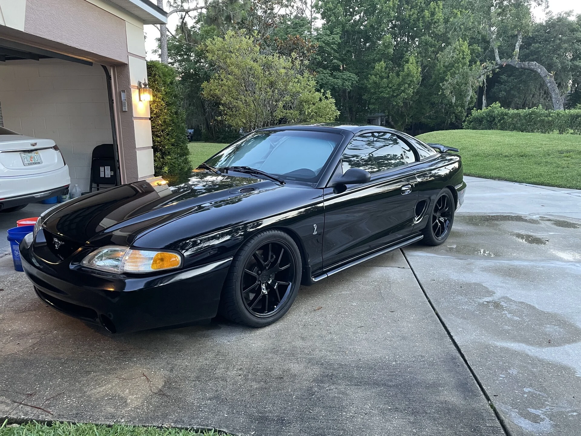

A well overdue wash later

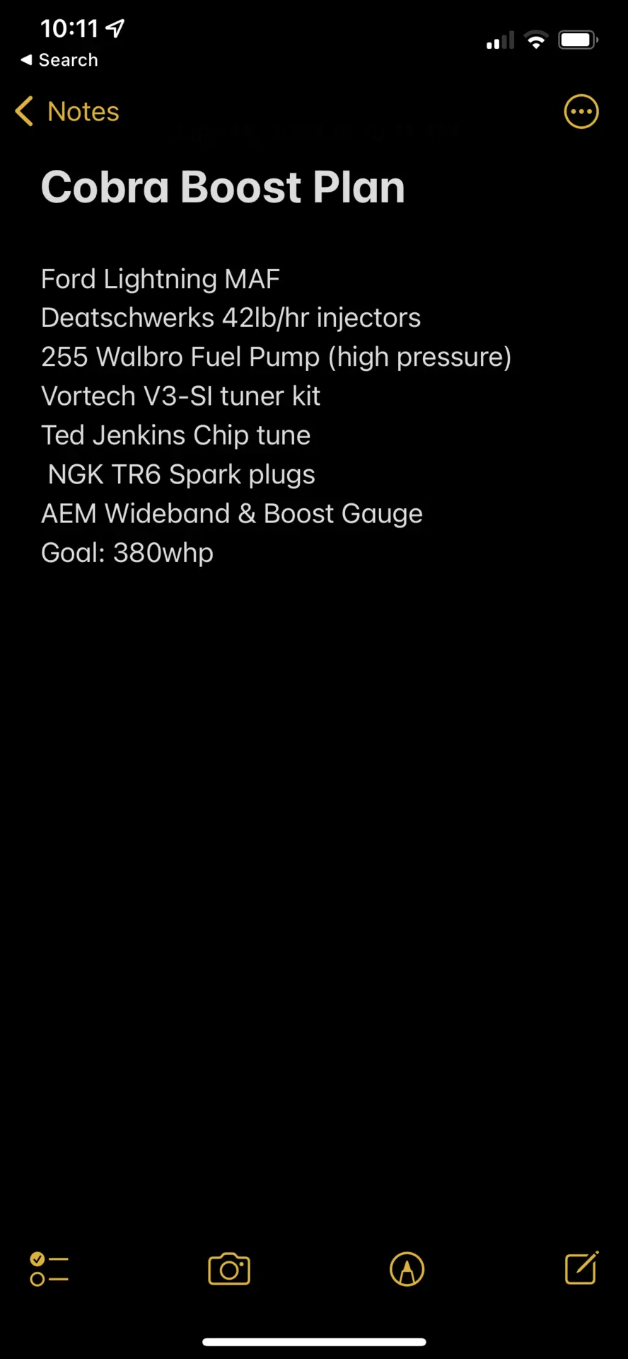

Went back and forth between On3 single turbo and a vortech v3 system. After debating the install and final outcome I desired, I decided on the latter. Now I’m still in college with limited funds so I will start slowly accumulating the parts needed as funds allow. Here is the basic list I have outlined based on my searches, please chime in if you have recommendations to improve this list. My goal is to make the same power my CTS-V does, 380whp

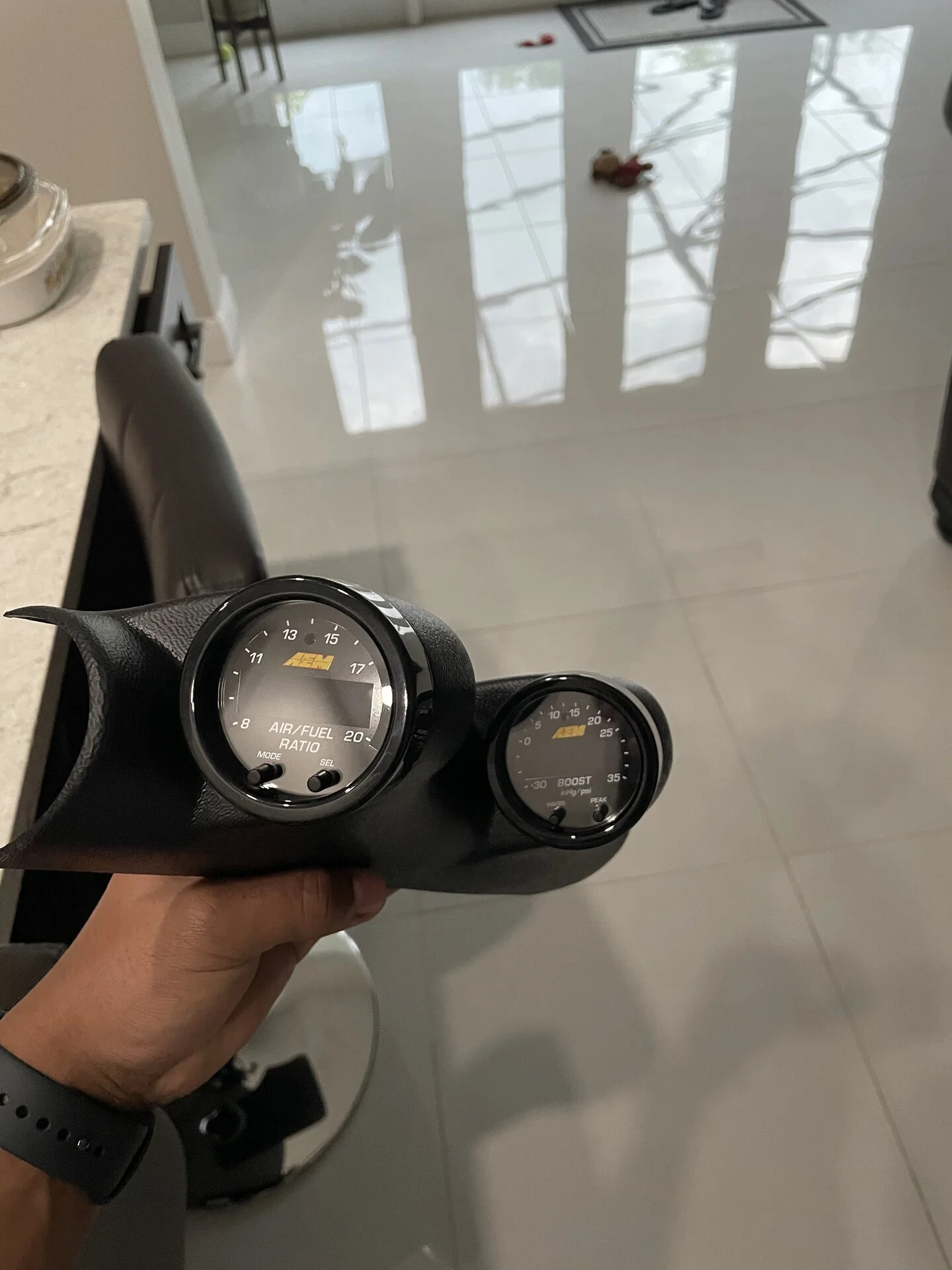

Mounted up in the pillar pod. Planning on using some VHB tape rather than screws.
