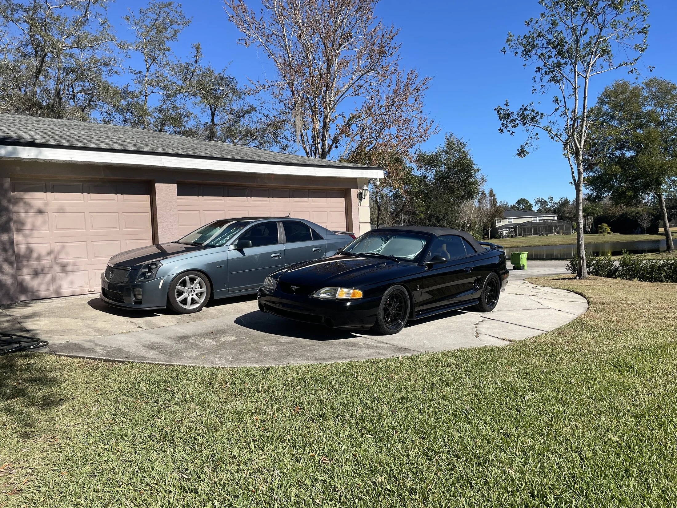

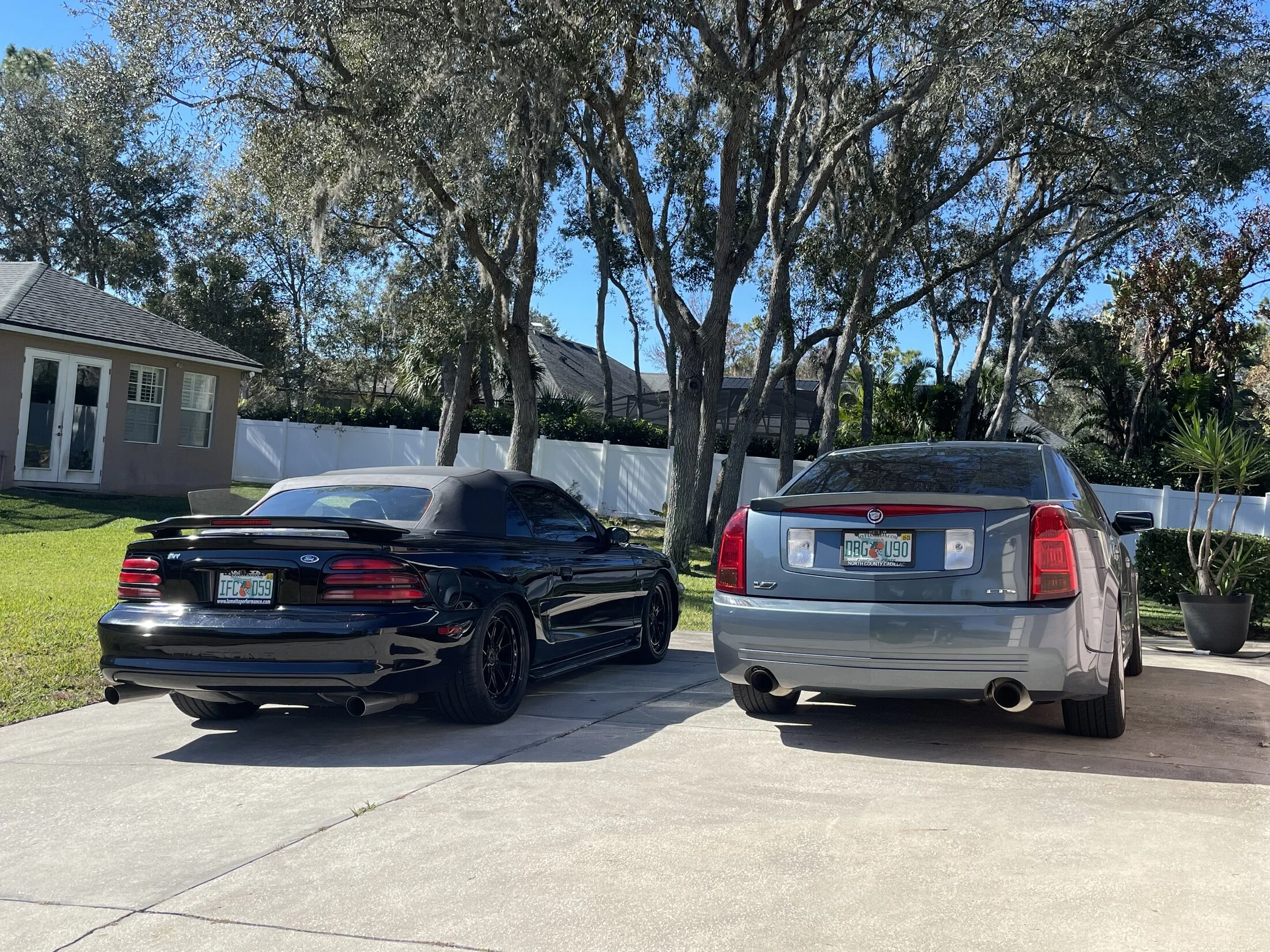

TOOLOW91 said:
I see a cts v-1 in the other picture
manual or Auto? Cool cars......
T56 6 speed car, real joy to drive

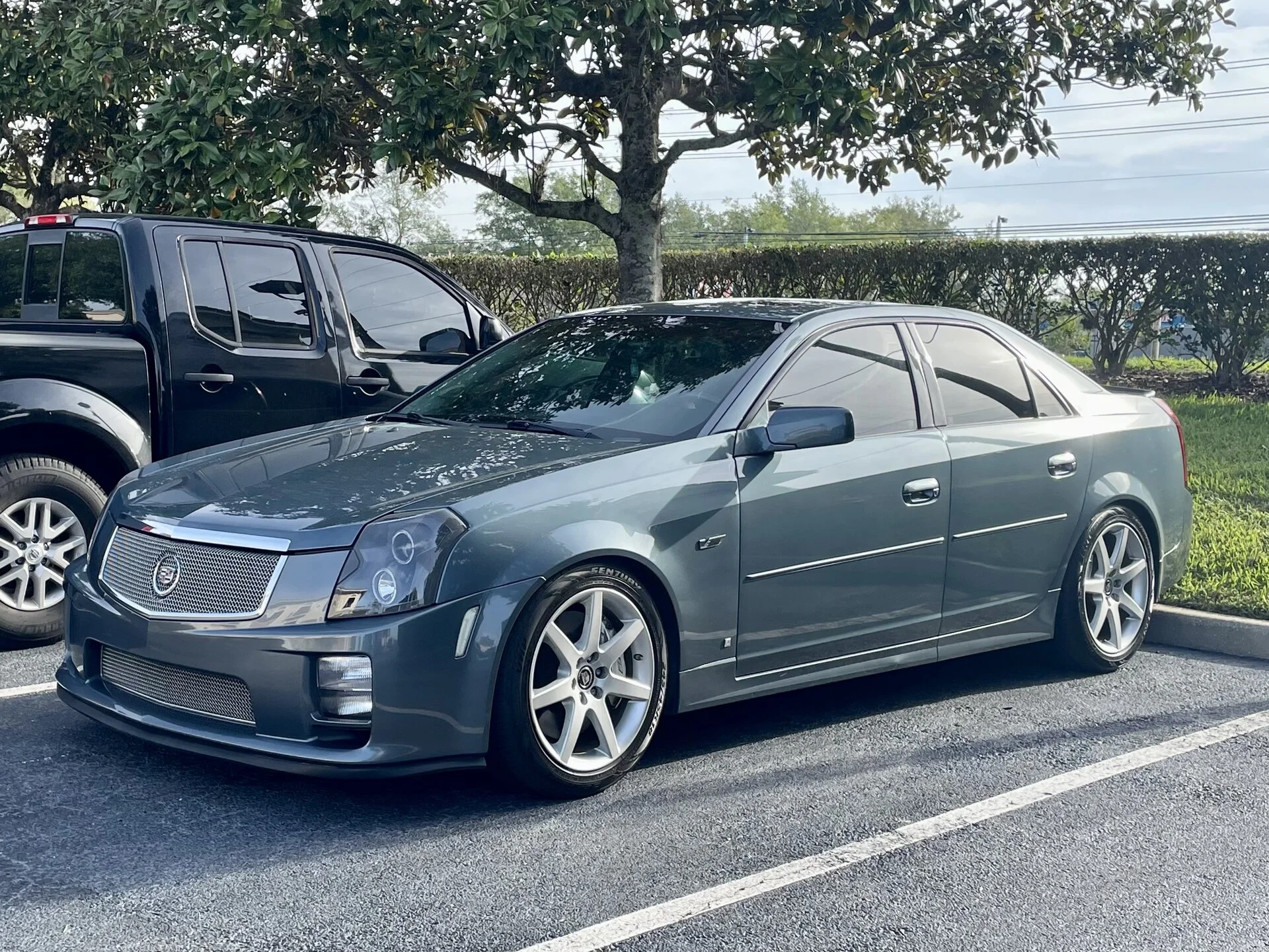

That’s the other baby, it should have some competition now!
Reactions: limp and TOOLOW91

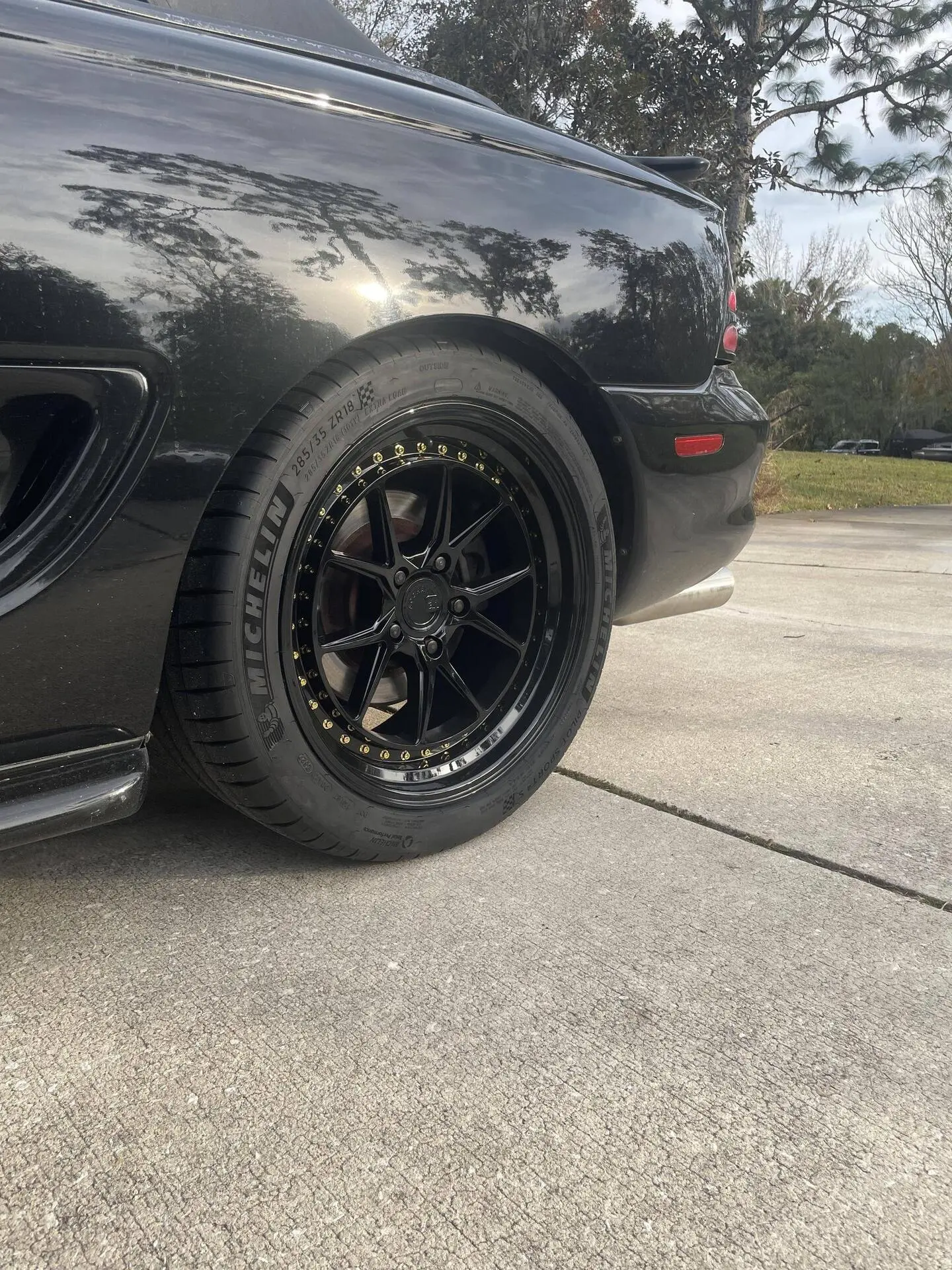

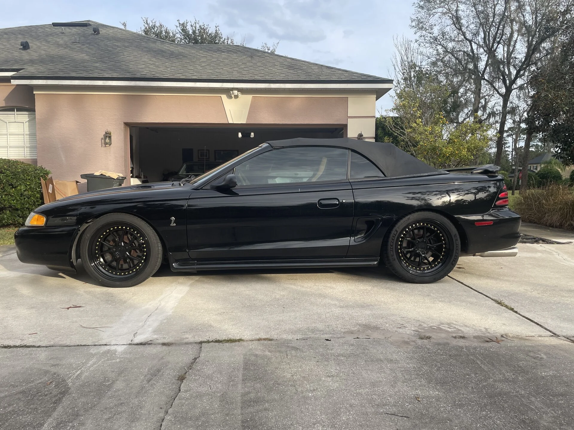

Tightened up my blower belt and threw on the new wheels. Made about 11lbs of boost and HAULS. The Michelins hook up excellent and live up to the hype
Reactions: Flatfoot, 90sickfox, Cheapskate207 and 3 others

Love this pic showing off the meat, bumping up the sidewall profile was a small change but makes the rear look like it means business
Reactions: 90sickfox, General karthief and TOOLOW91

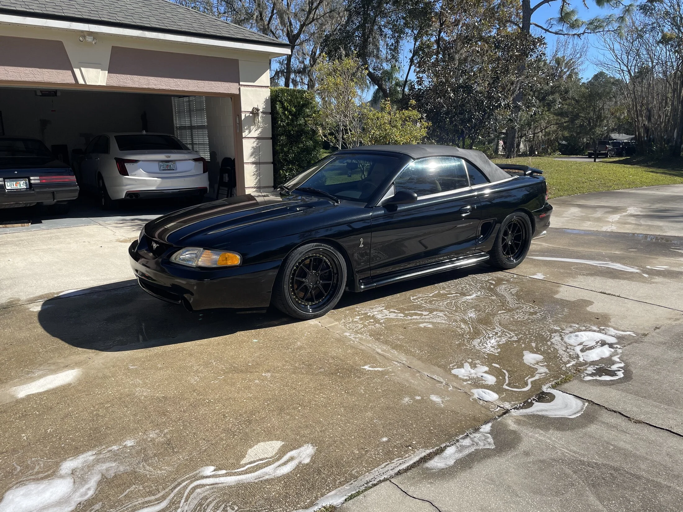

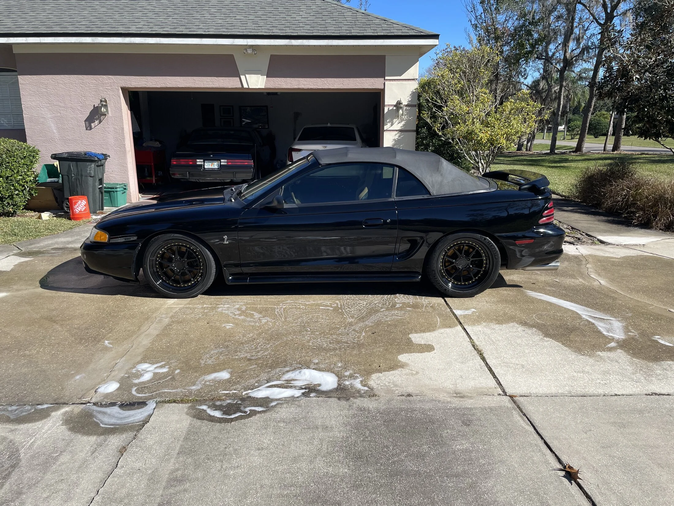

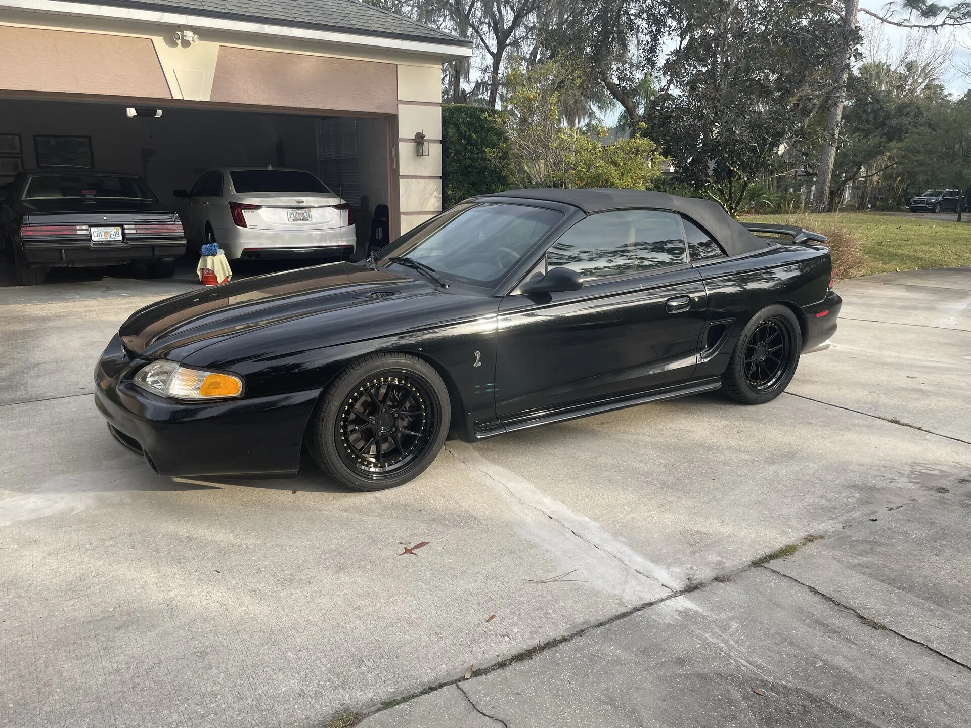

Finally got a wash in after all the work that has been done to the car. Still struggling with the car commanding a high idle and idle hanging after coming to a stop. Working with Willie to fix this
Reactions: 90sickfox, bird_dog0347, Rdub6 and 1 other person
WhiteCobra95
May 2, 2006
641
180
74
Jan 16, 2023
#613
  • Jan 16, 2023
  • #613
Your car looks great! Nice job on the supercharger installation!
How do you like the 285s in the back? Have you had any rubbing issues?
