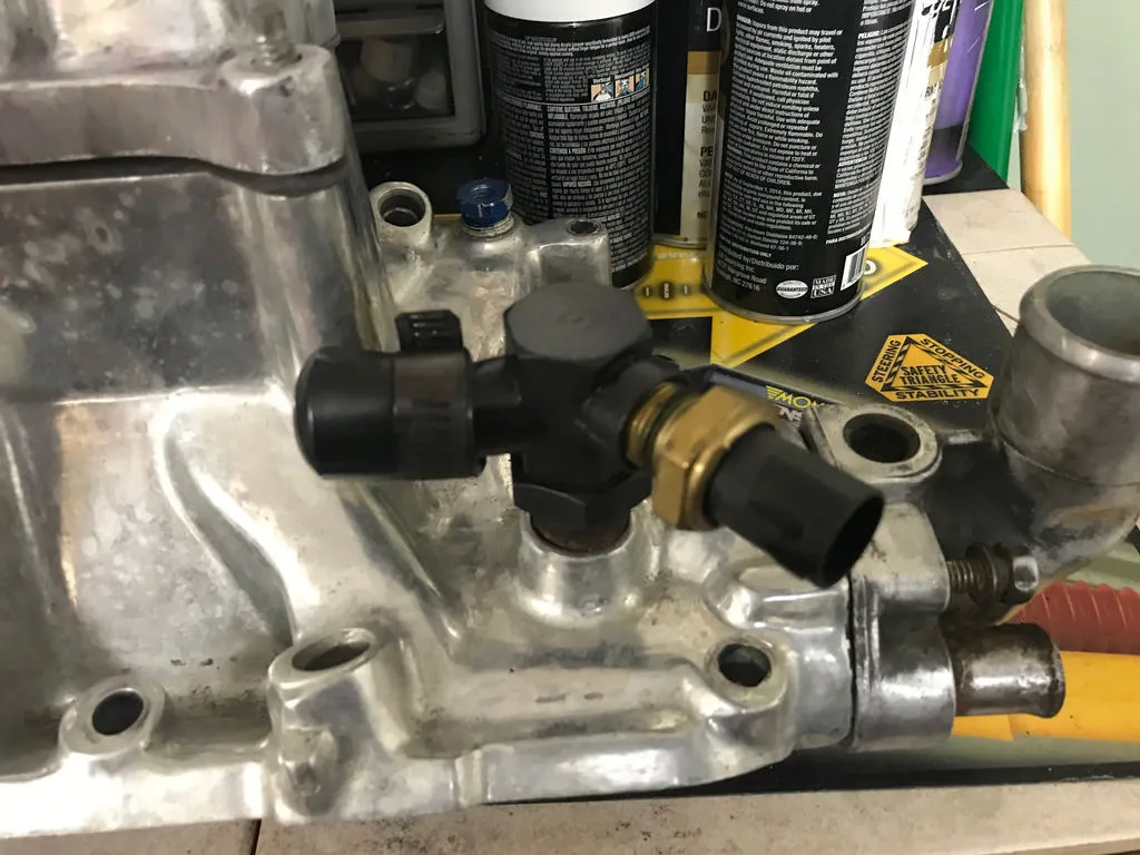

The coolant temperature is above the thermostat housing and on that black heater line going to the firewall.
Here is mine, I cut the heater pipe and capped it off as I don't run heat (in Florida) but that is the sensor to the right (see 1st pic below).

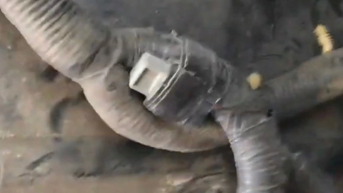

The 212 code usually means the spout connector is not plugged in. When you set timing you have to pull that grey plug then put it back in. If it's missing it usually signals the 212. See second pic of the spout.

so if that SPOUT connector isnt plugged in or missing how do i go about finding it?

If it's missing you'll have to buy a new one. In pic I sent above it's that little grey are on top. You pull that out of the connector to set timing. People always forget to put it back.
Check to see if yours is missing. If it is you can buy them from LMR.
https://lmr.com/item/LRS-14489C/1986-95-Mustang-50L-Spout-Connector
