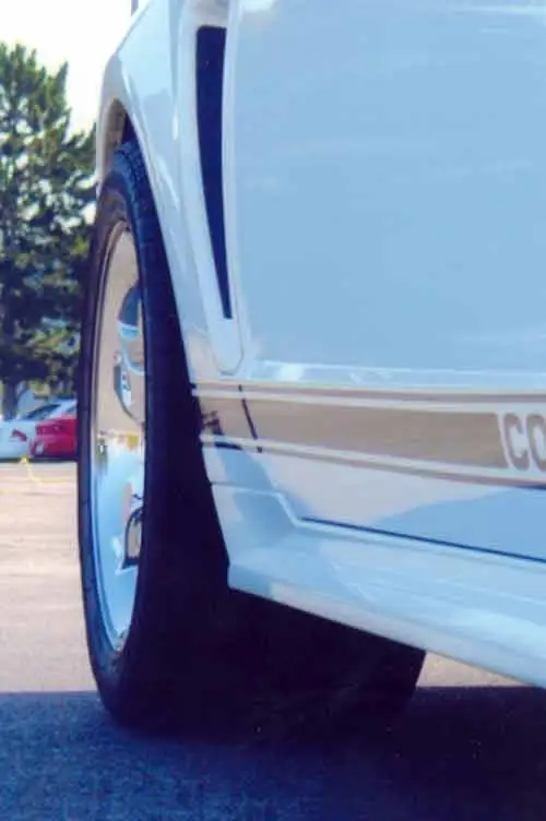

315's on 10.5 rim
I'm running BF Goodrich 315's on the back of mine, with a very small spacer to avoid the IRS bolt (contact with the IRS bolt is only an issue if the car is airborne or on a lift).
My car is dropped about 2 inches (I think) with H&R sport spring package. I'll come down on my wheel well once in a while, but it rubs the tire tread on the bottom edge of the fender causing no damage to either. I'm sure sooner or later I'll rub a little paint off that inside edge, but it hasn't happened yet.
See pic for side view!
