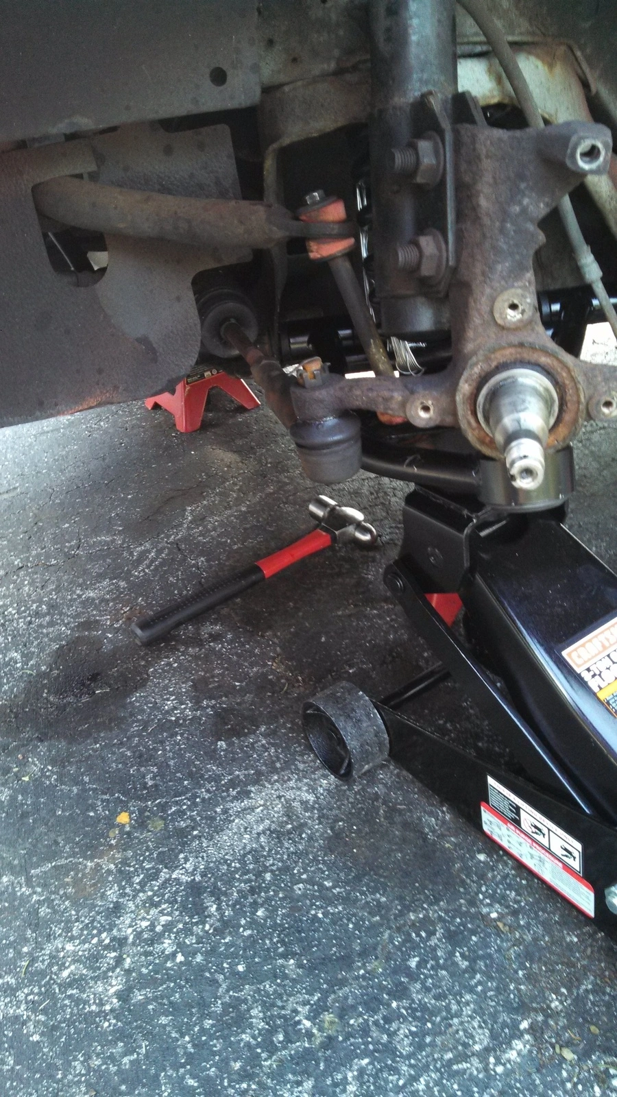

So at this point, my daily driver is sitting in my driveway, with its left front A arm off, hoping I can figure out a way to get it on.
If I had a spring compressor I could get to work, I don't think I would have had much of a problem. I just couldn't figure out a way to get it to not hit the top of the upper spring cup.

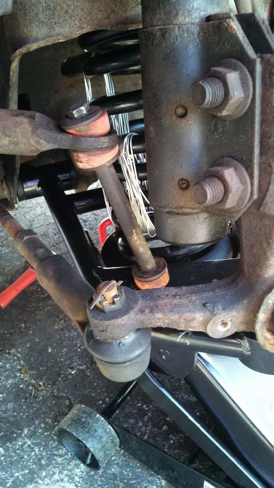

I received the arms that are seen in the third picture from the above link. The pic where the swap bar bolt hole is on the inside of the A arm, not the outside as seen in picture 1.
If I had gotten the arms in picture 1, I believe I wouldn't be asking my next questions.
In the pictures below, the Sway bar bolt is quite "bent". It was a pain in the ass to get it to all fit.
So:
1.) Does that look right?
Whoever owned this car previously had put the sway bar bolts in up side down, as the bolt was dropped down through and not put up through.
I tried to get the bolt out but the sleeve and bolt have rusted together, and I got no where, even with copious amounts of WD40.
2.) Does that bolt orientation really matter?
3.) If the sway bar bolt isn't meant to be that stressed, do I need different arms? New sway bar? Or what are my options?

The bolt is supposed to come down from the top, not up from the bottom. And no, it's not supposed to be angled like that. I'm not sure the other arms locate the hole any differently in relation to the balljoint, but it's worth asking LMR or AJE.

I wouldn't buy sway bars, nor would i mess with the mounting location.
At this point, you may want to start looking in junkyards for control arms if you want spring perches.
Yeah, I'm not gonna mess with the mounting location after doing a bit of research and talking with a couple people. But the sway bar in my car is old any how, and needs new bushings etc etc, so if I am re-doing almost my entire front suspension, I don't see why an extra $200 would hurt if I can swing it. Plus I can't get the sway bar bolts out of my old sway bar. So rather than cutting it, I'd rather put something new in.
