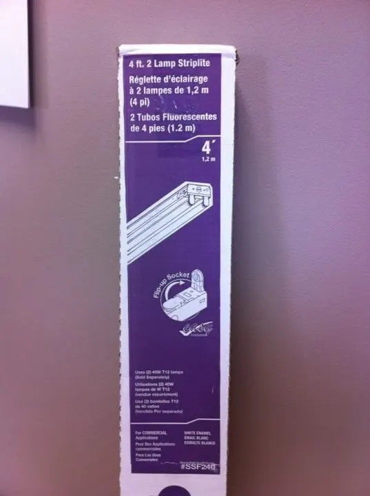

Yeah it's actually cheaper to buy a whole new fixture than piecing a ballast and sockets together on a 2x4 :D
Does the original one 4Jenna posted have the bulb inside a plastic case or anything protective? When these bulbs break they shatter glass everywhere. They make clear protective sleeve tubes to install over them to keep the broken glass contained.
I have a double bulb unit that's out, looks to be the ballast. They want $15.97 just for the ballast. I can buy the entire unit for $20 minus the bulbs which I already have, done deal. I may buy 2. Need to burn some retnas.
My driver just handed me this. The 3rd link I posted earlier. Woot!!
