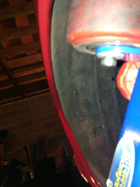

Cutting them is a hack way honestly . Here's what rolling them looks like . I didn't get too extreme but you get the idea .
thanks for the image. Yea I will go ahead and borrow one if i can first and if not, rent one. Or might buy one as the other poster said 50-100 and i think i saw them on ebay for $58 or 62.
With 315s on my car the lip is fine. Inner fenders it's where everything hit. If he was only getting contact on his fender lip no reason a good rolling tool couldn't take care of it.
