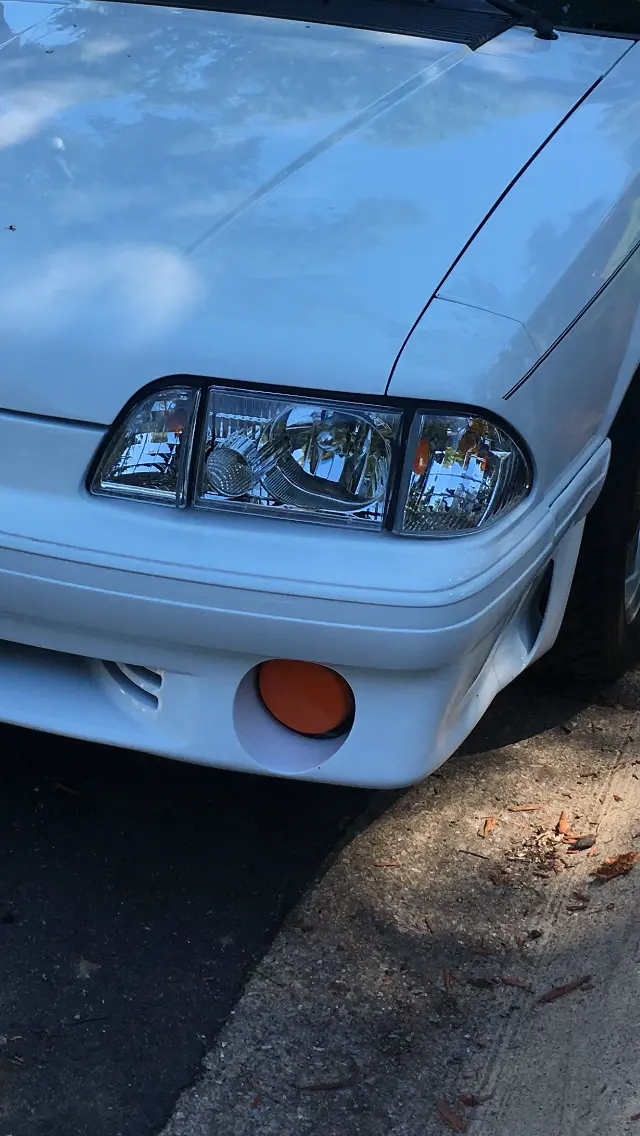

ain't gonna happen, leds do not 'point' a beam in any particular direction, they are just annoying to on coming drivers.to be honest with you i just ordered the headlight adjustment tool cuz they are litterly 10 feet in front of the car, so ill have to get back to you once they are properly adjusted. but im hoping for better than stock.
