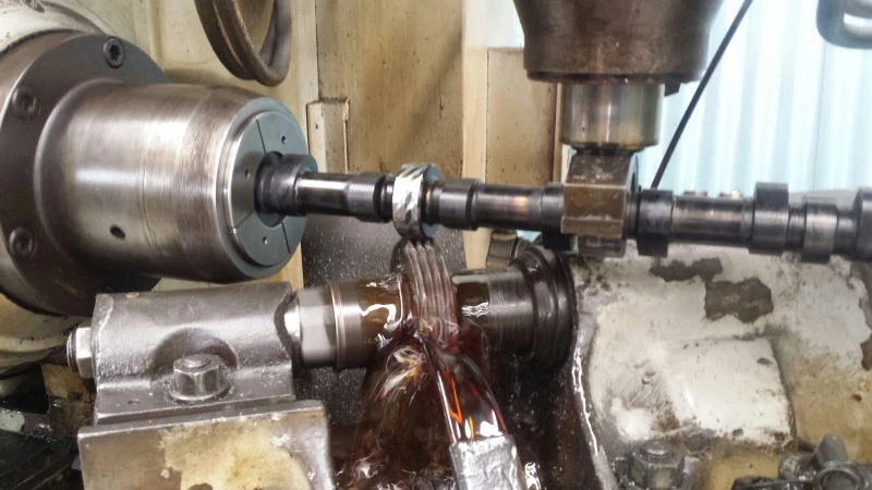

This is my goofy assed solid billet roller getting it's distributor gear hobbed.

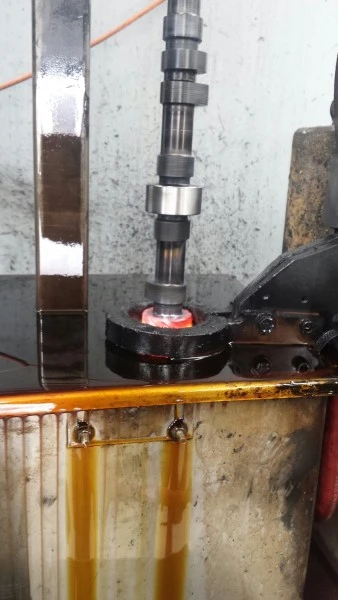

And here it is after getting heat treated.

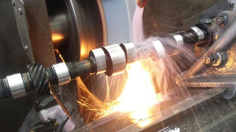

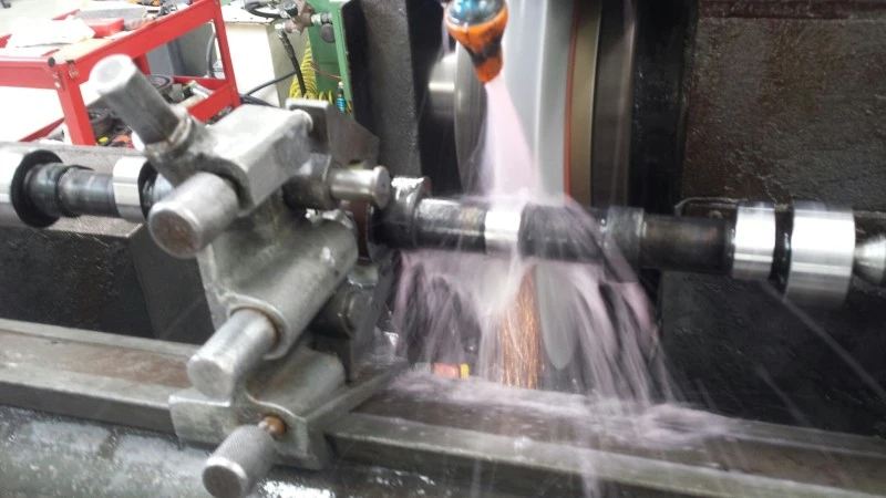

Since my cam is a rarity ( even in Australia) he took a few more pics of the process
He subtitled the above the lobe grinding process.
