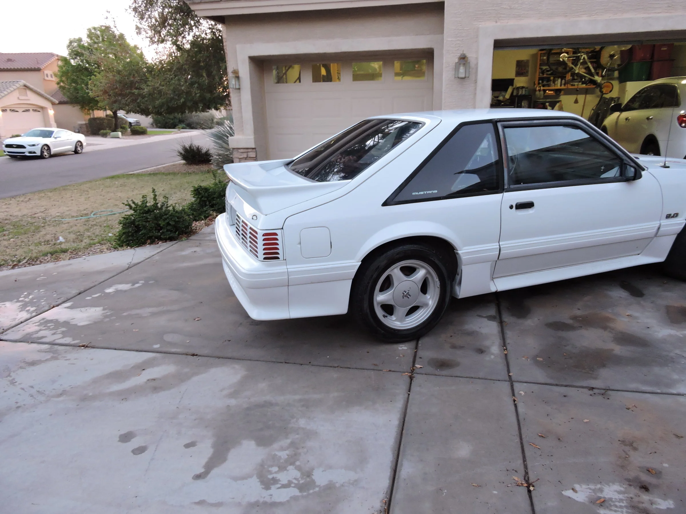

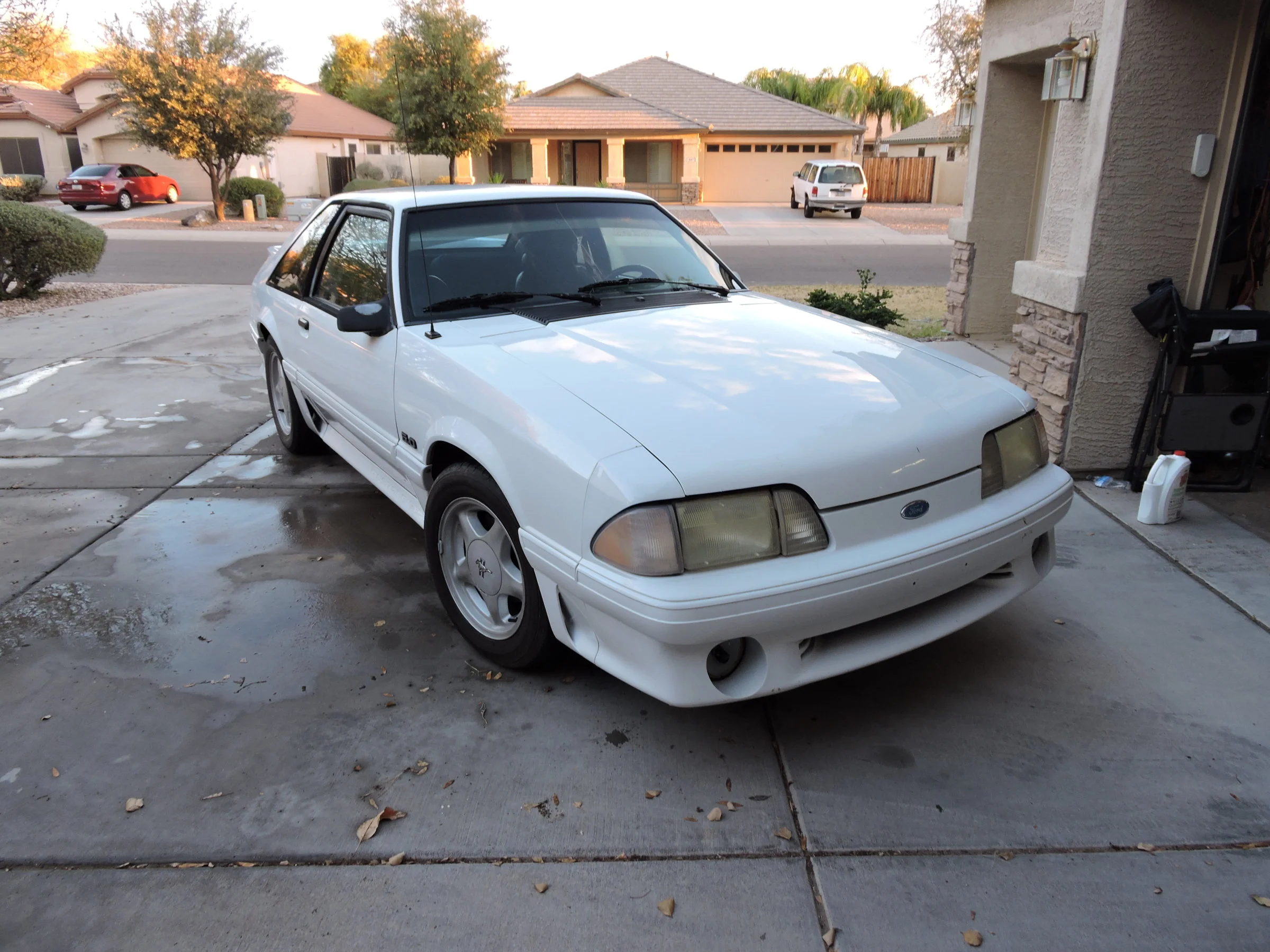

I bought this GT a few weeks ago. It was pretty dirty as far as the exterior goes. Interior needed a good wipe down. I washed it today but it will still need a good buffing to clean it up.

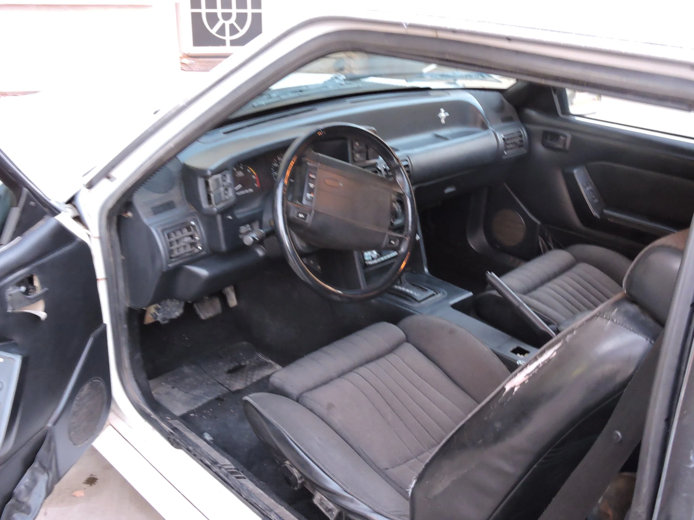

All black interior that needs some love. Overdrive is gone but luckily I have a 4r70w in the garage the I was going to use for another project. I am going to take the guts out of the 4r70w and put them into the AOD. 4r70w has better gearing and a wider OD band. I don't need the VB from the 4r70W because it is electric.
