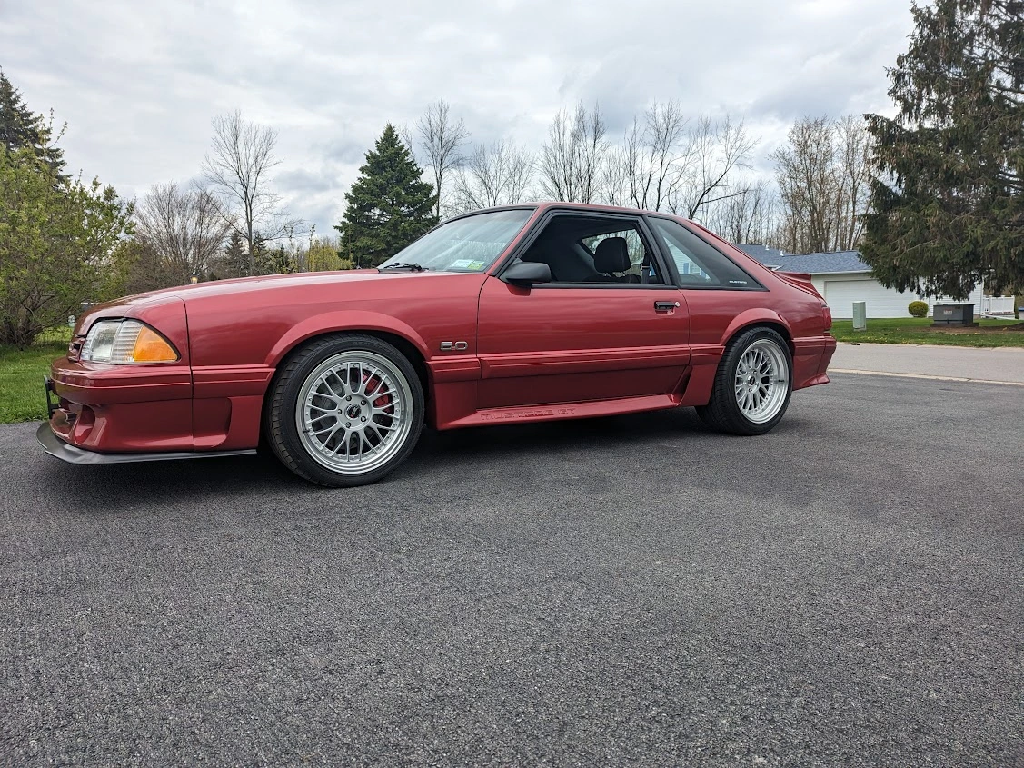

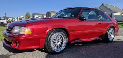

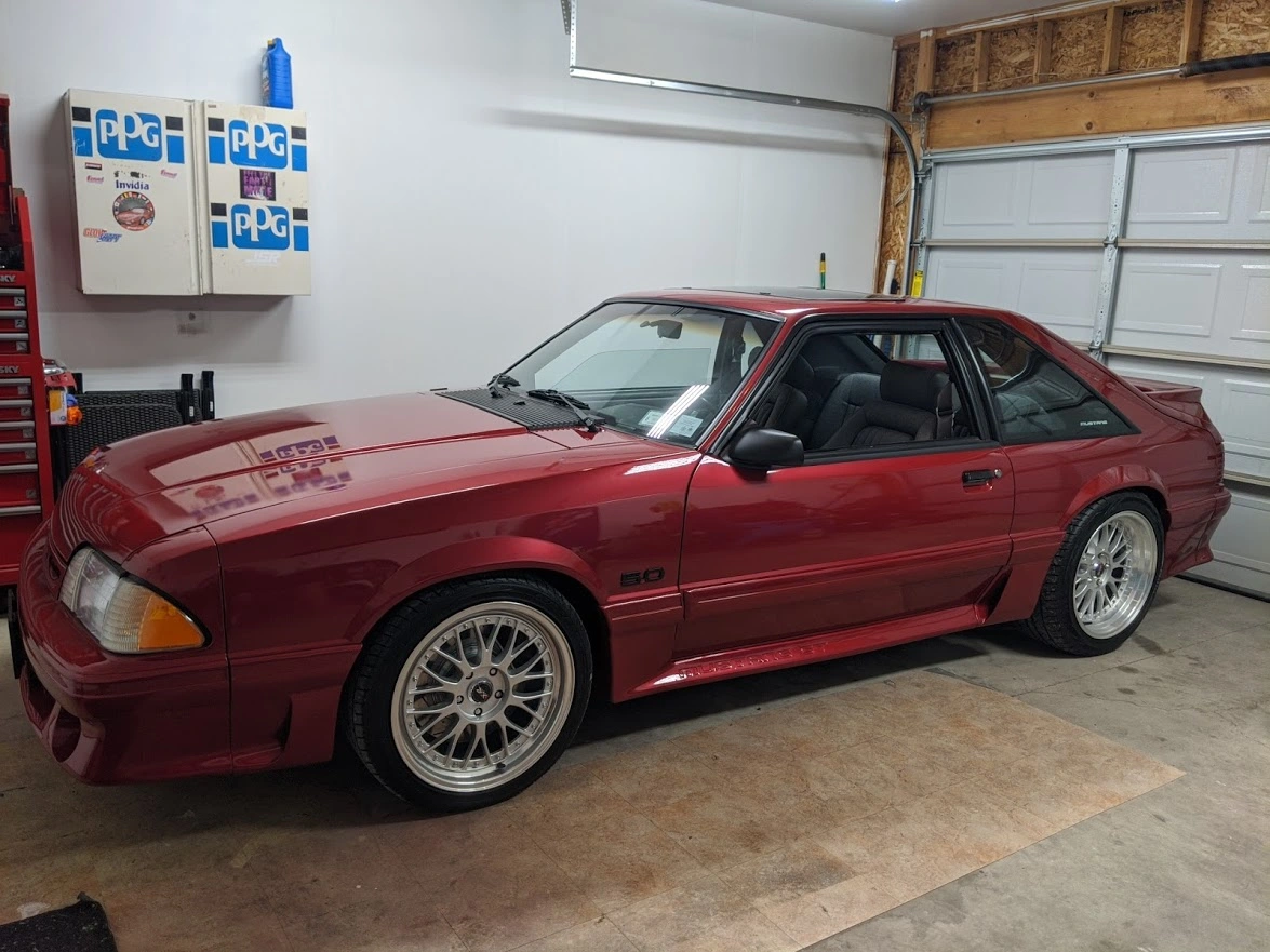

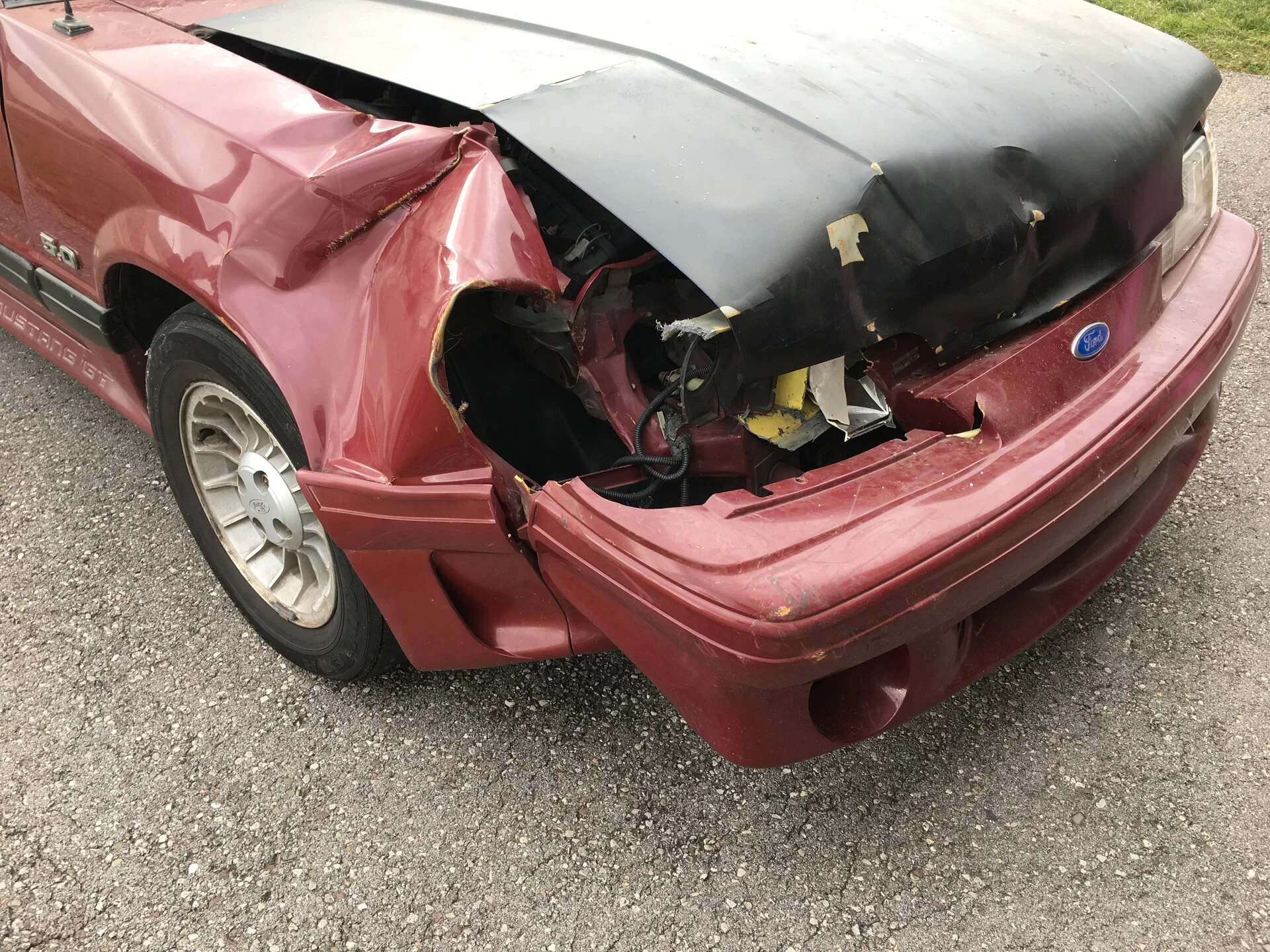

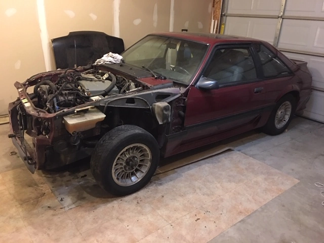

The car has come a long way from January 6th of 2019, here are a few pics

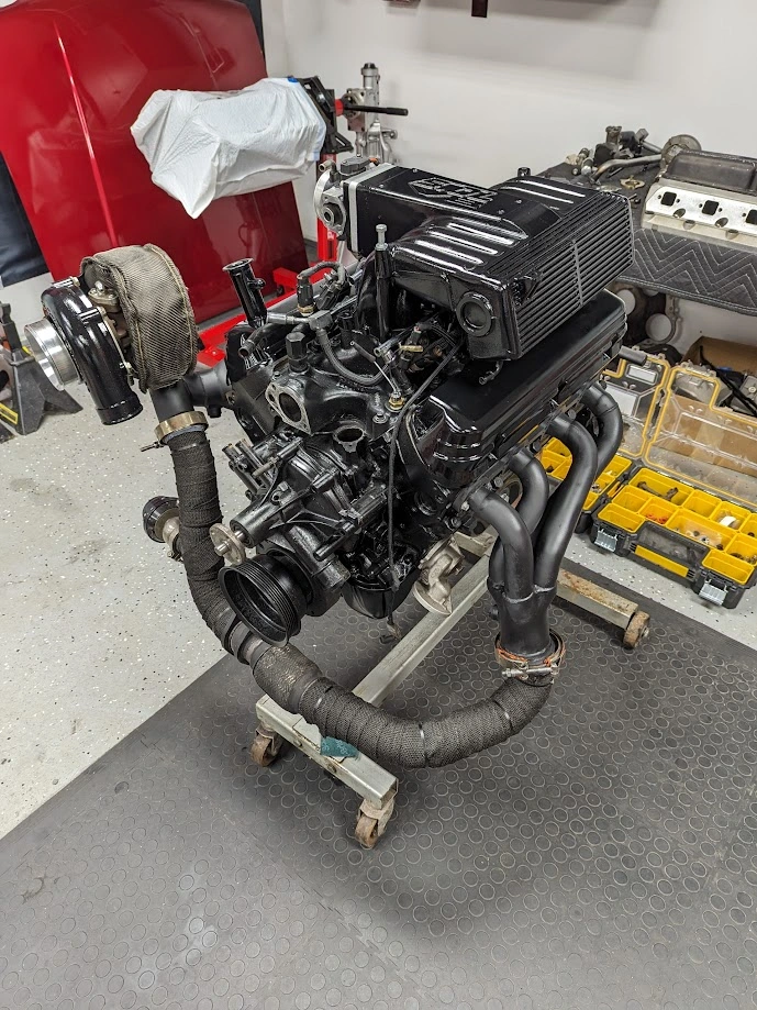

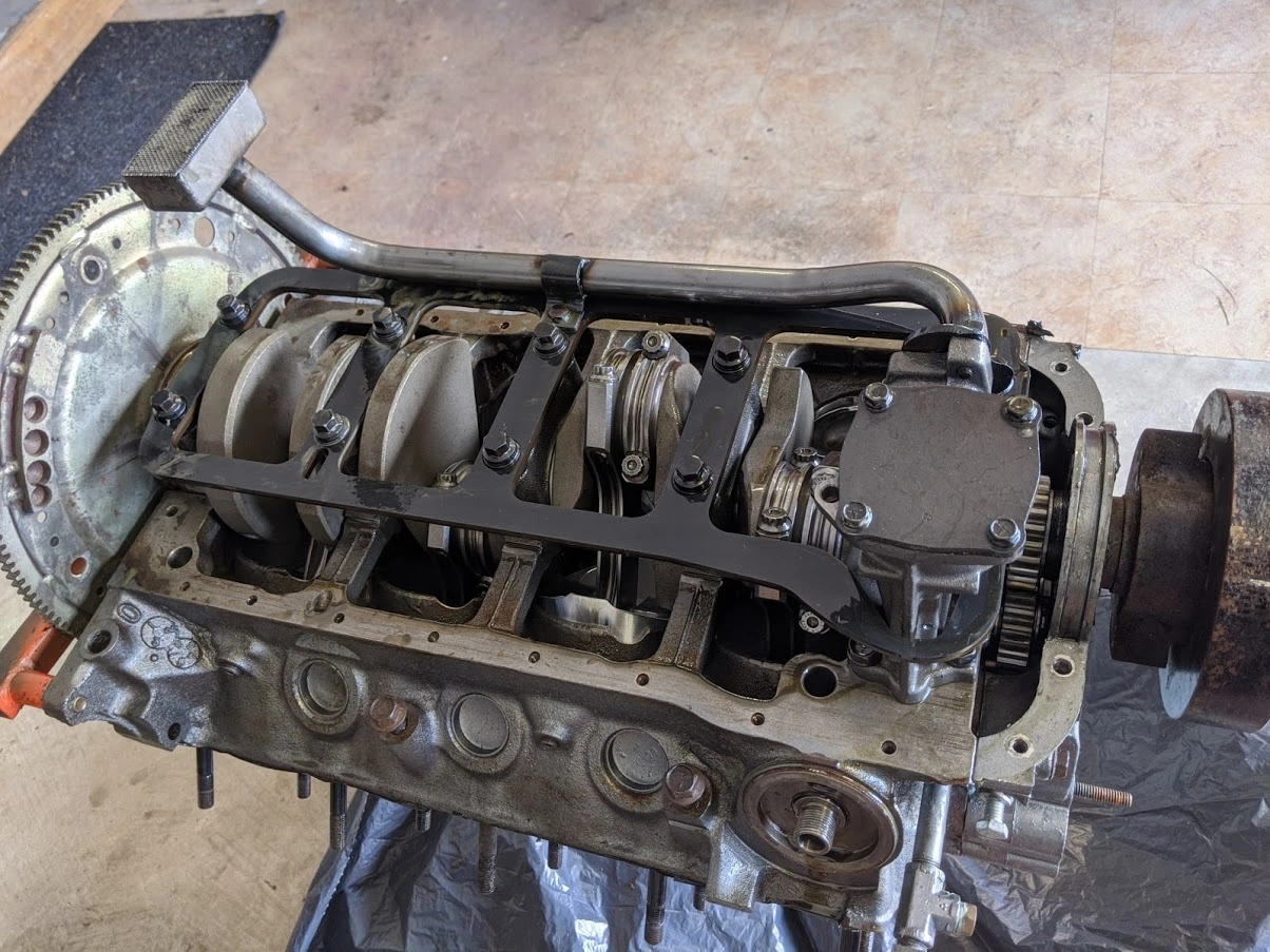

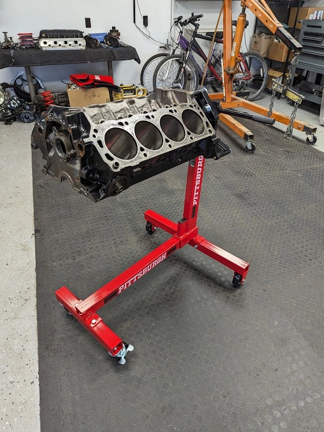

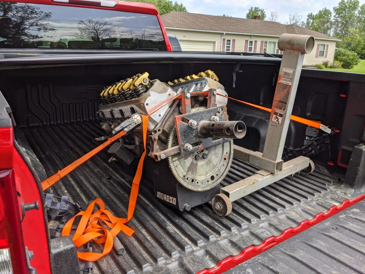

did a thing a couple weeks ago, something to keep me busy/sane this winter.
This is a motor out of my buddies boosted 89GT he sold a few years back less than 10 passes, my plan is to pull it apart completely, rebuild, and upgrade/replace a few things I got the motor for a steal and couldn't pass the deal up.
347 stroker
Eagle crank
Eagle rods
JE Pistons
Edelbrock Victor JR heads
ARP headstuds
Crane 1.7 gold
F303 Cam
Pete jackson gear drive (removing)
Moroso deep sump oil pan
The weakest link in this combo is definitely the stock block, but a conservative tune should keep this thing together. While the motor is out, I'll address a few other issues. I won't be tackling this until the winter the car drives perfect right now and I'm just enjoying it everyday.

Dude...that third pic. Car looks incredible. I feel like there are tons of similar styled wheels that wouldn't look right on a fox but you somehow picked the exception. Well done.

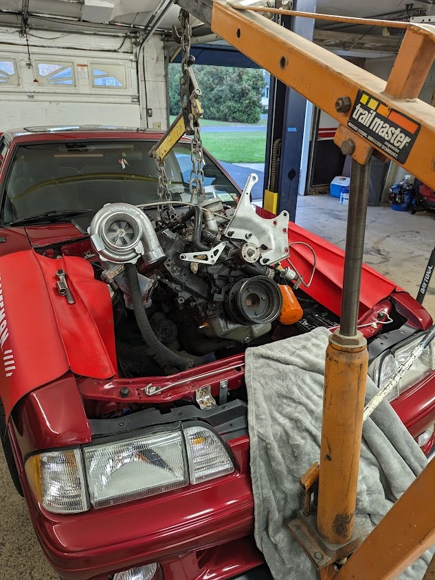

Wow my last update her was in August of 2020, a lot has changed since then, and some new things are coming down the pipeline. Overall I have just been enjoying the car, hopping in an driving without much to worry about.
Last winter I converted the car to rear disc
Taurus 43mm calipers
Cobra booster
SN95 M/C
ATS Brembo swap

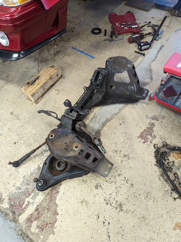

I drove the Car all summer, brought it to a bunch of cruise nights and shows, even took home some awards, then I went to Foxtoberfest and caught the mod bug again When I got home I started tearing the car apart.
My winter plans for the car,
I'm keeping the On3 Kit and upgrading the motor,
347 Stroker ( i've had this motor for about 3 years now, so it's coming apart and being cleaned up)
Eagle crank / Eagle rods
JE Pistons
ARP headstuds
Crane 1.7 gold
F303 Cam
BMR tubular k-member
Strange shocks/struts
subframe connectors
Engine bay shave / wire cleanup / Respray
and probably some misc. stuff here and there, hopefully I can stick to keeping this thread updated throughout this process.

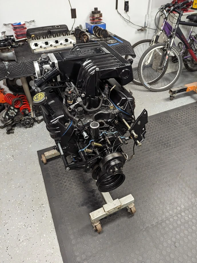

Couple updates, the original 302 was degreased, replaced some stuff, got to do the rear main seal and a couple loose ends and then I can focus on the engine bay.

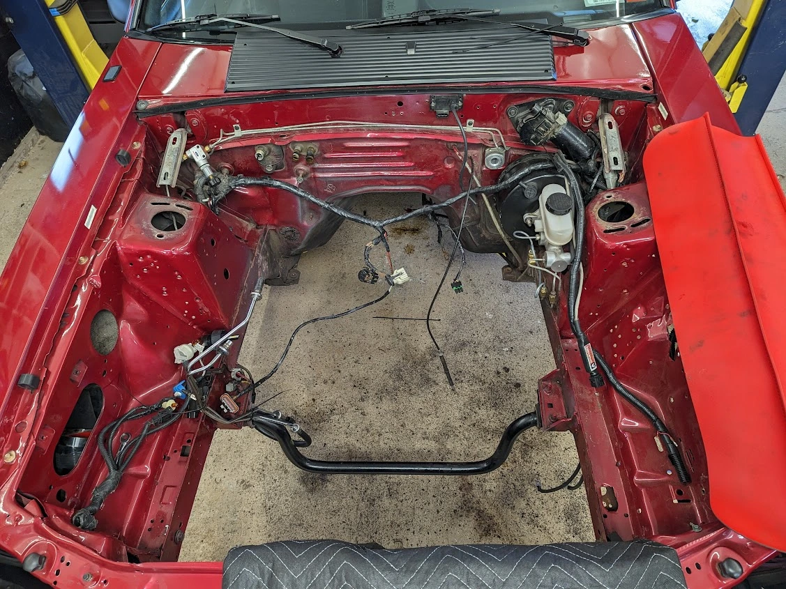

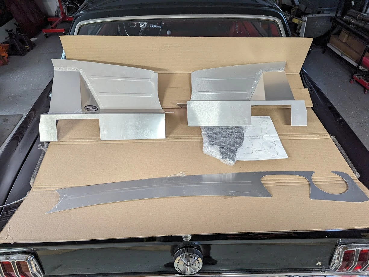

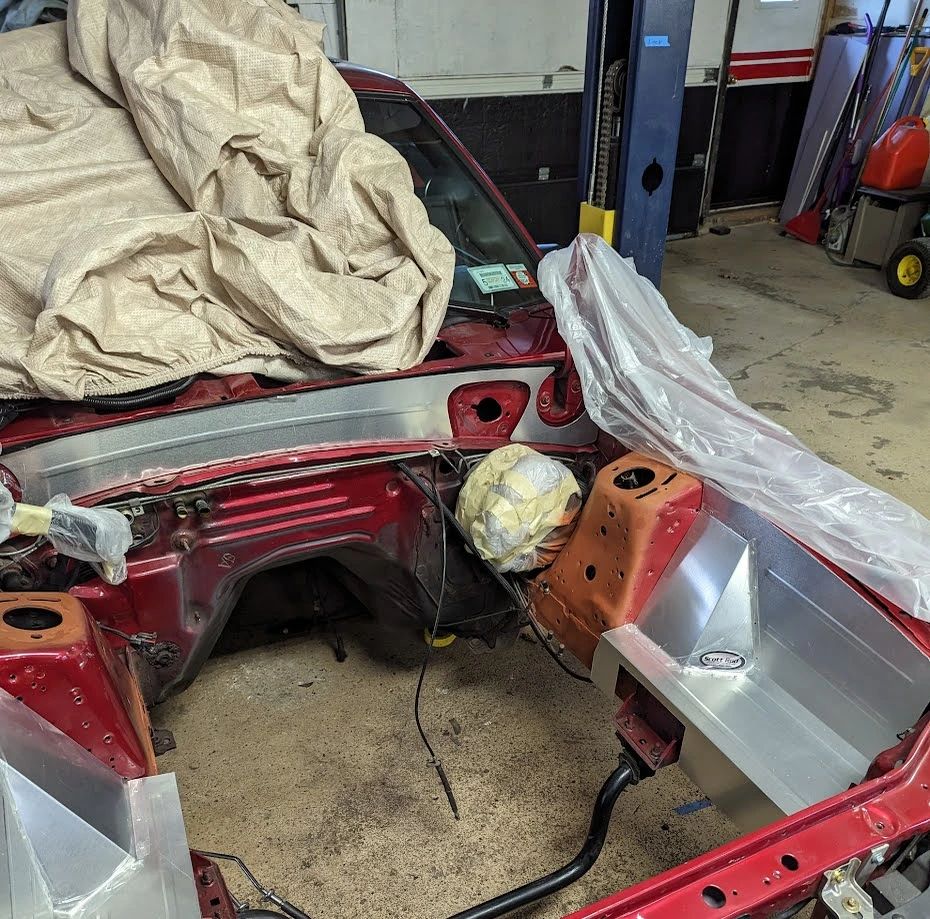

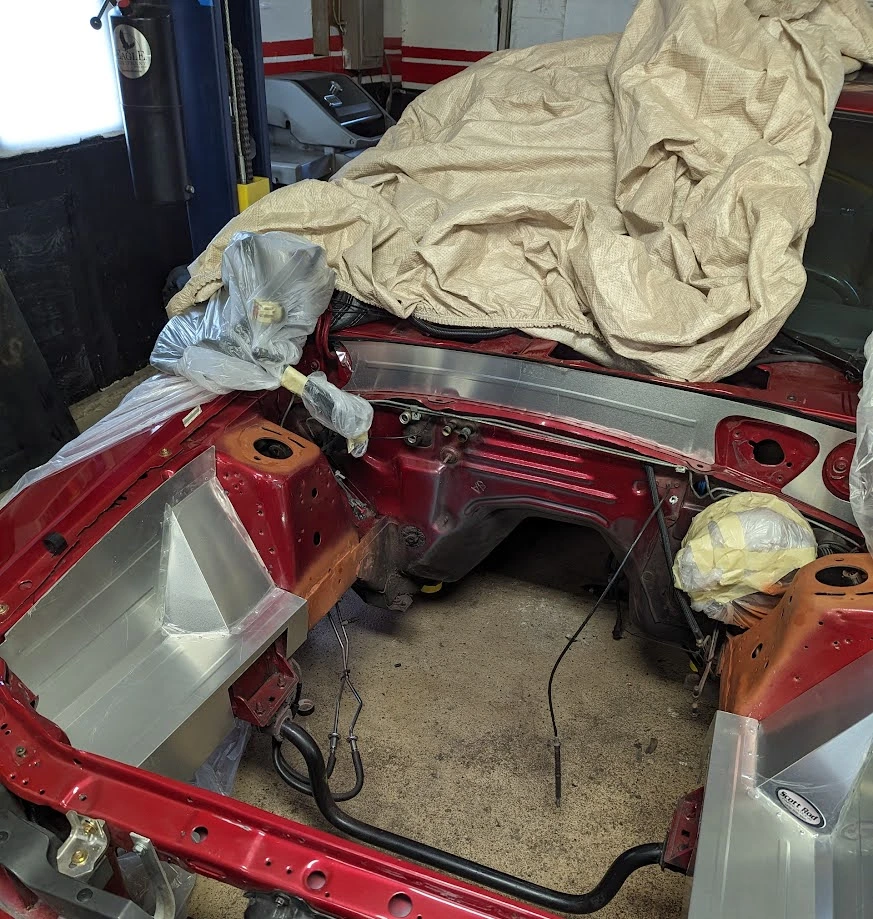

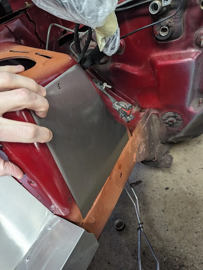

Got some other parts in for the bay, I opted for the Scott Rod rivet panels, tossed them in to just get an idea of how much trimming I'm going to need to do, I had to clean up some slight surface rust forming on the rails and got a little wild with the rust paint. I'm hoping to spend some time here on Christmas break getting these fitted and hoping to get the bay painted in the next month or so.

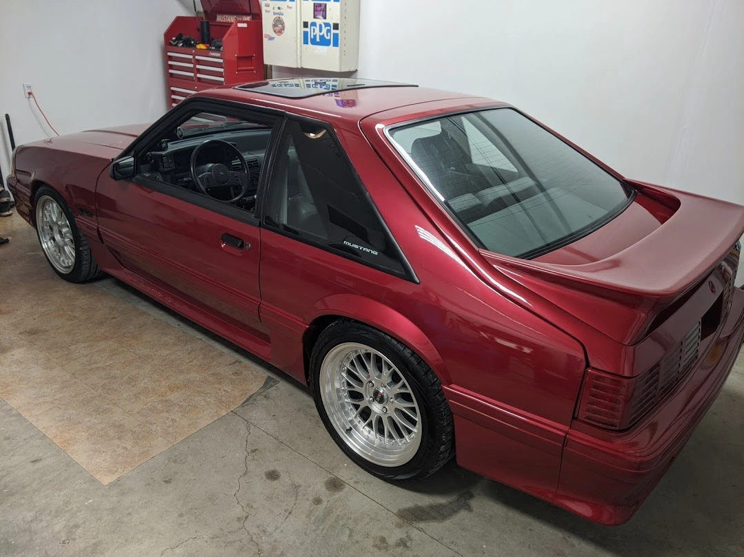

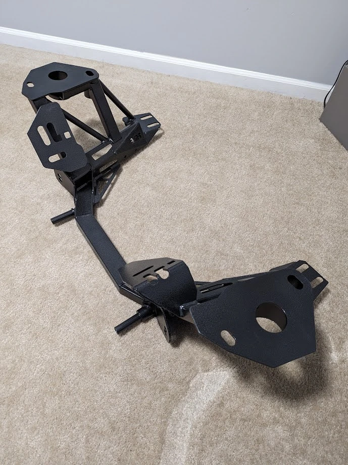

Last update I didn't want throw everything in a single post,

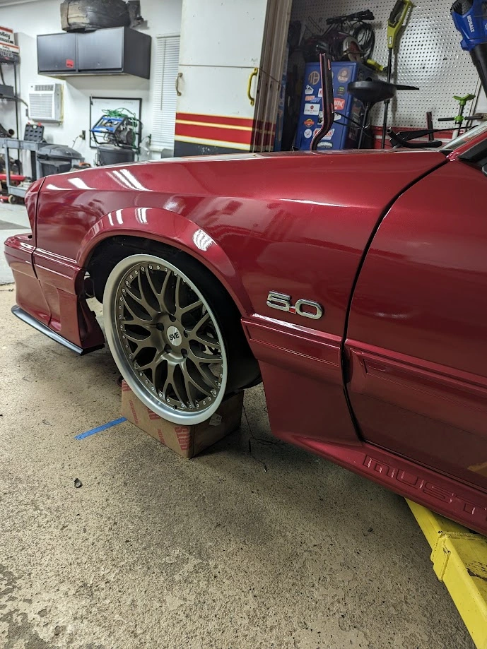

Decided to go with new wheels, my buddy wants the XXR's for his 84, I go through wheels like underwear and i'm surprised i've had these for 4years. I also got my k-member in.
