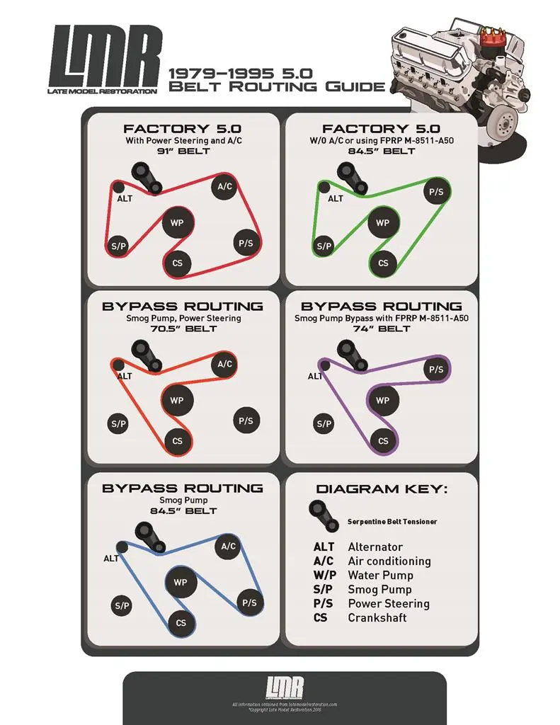

Just short belt it. Belt lenght may differ if you have aftermarket pulleys

No need for a smog pump delete kit unless you have a supercharger that requires the specific belt routing. Just short belt as shown above and unbolt and remove the pump
