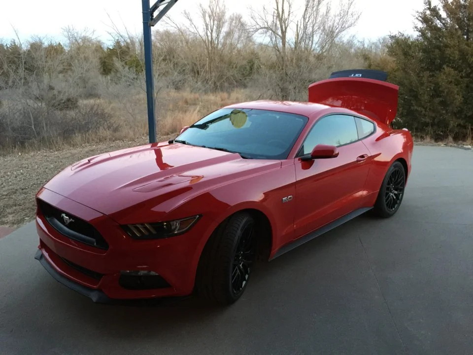

Here she is btw. Sorry, don't have any great pics.
