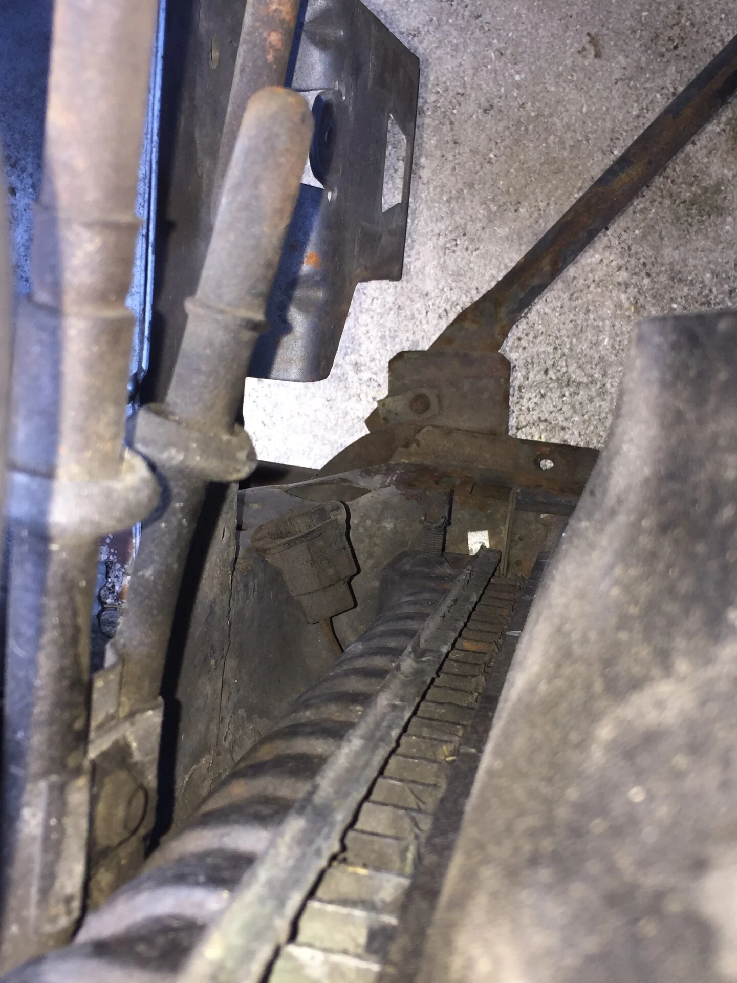

I dont know much about cars and I recently bought this 1986 GT. Ever sense I bought it I have noticed a gas fume smell coming from the engine. I ignored it for a while but it has recently started to annoy me. I have tried to find the cause and I think I have with the help of people on this forum. I was going to test if my charcoal canister is bad and when I was looking for it I found this. I am pretty sure this is where it is supposed to be located (the image is taken right behind the radiator on the right side) and there is a detached cable and a metal line running into a pipe above my radiator into the engine area. Is this where the charcoal canister is supposed to be? If not, where is it? I'm having trouble finding it.
Looks like you have the bracket, but not the canister. This link will show the pieces:

Post 1. The canister is missing.
Post 2. The link is also missing.
Coincidence beyond bad luck?

Looks like they won't let me post the exact link. Instead, go to LMR.com, check on the "Shop 1979-1993" link and search for Mustang charcoal canister. It will show the canister, bracket, solenoid, etc.
