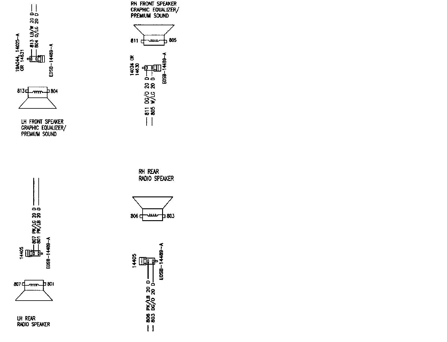

The stock amp is probably located behind the stock radio. The other possible location is under the
front passenger side seat. It is a finned box about 3"x6"x 1 /12" with 2 wiring pigtails. One of the
wiring pigtails is for the speaker wires.
One of the amp plugs has the following wire combinations:
Dk Green/orange stripe = right front speaker negative
White/lt green dash = right front speaker positive
pink/lt blue stripe = right rear speaker positive
Dk green/orange = right rear speaker negative
Lt blue/white = left front speaker negative
Orange/lt green = left front speaker positive
pink/lt green = left rear speaker positive
pink/light blue ring =left rear speaker negative
Cut this plug off the old stock amp and use it to connect to the car’s wiring harness for your new
radio. Using the plug from the old stock amp saves you from cutting the car’s wiring. Cutting the
car’s wiring is a bad idea if you ever change the radio or have to troubleshoot the speakers or
speaker wiring.
Use a flashlight battery and touch it to the pair of wires for each speaker. It should POP if the wires
are correct. If it doesn’t, switch the battery polarity.
Solder and heat shrink the wiring to insure good connections. How to solder like a pro – see http://fordfuelinjection.com/?p=7 .
This is a must read for any automotive wiring job.
Heat shrink tubing is available from Radio Shack.
attachment.php
