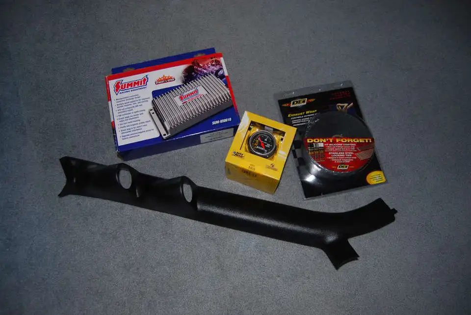

Yesterday I got my first box of parts in the mail. Actual turbo setup should be here mid next week or so. It shipped today.
Summit ignition box, boost gauge, gauge pillar, and exhaust wrap.

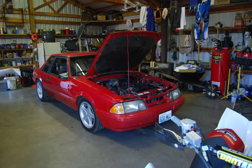

Got the car in the shop last night and work on it for an hour or so.
Pile 'o parts.
