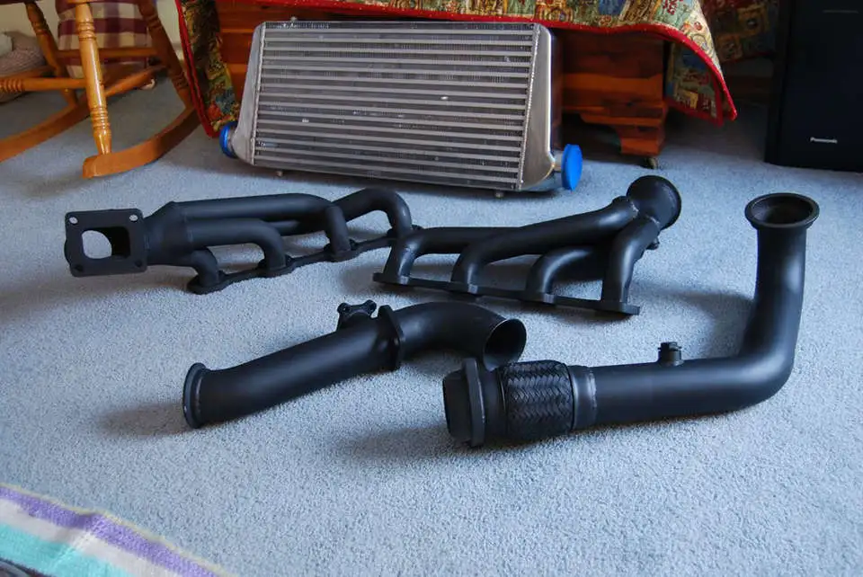

Kit came in today. I've no complaints so far, as far as a first look over goes, other than some of the fins on the intercooler being tweaked from packaging.
Cold side.
Hot side.
Y-pipe and turbo.
I didn't get pictures of all the couplers, v-bands, etc yet. And Chad's still waiting on the PMAS's to come in so he can ship mine out.
