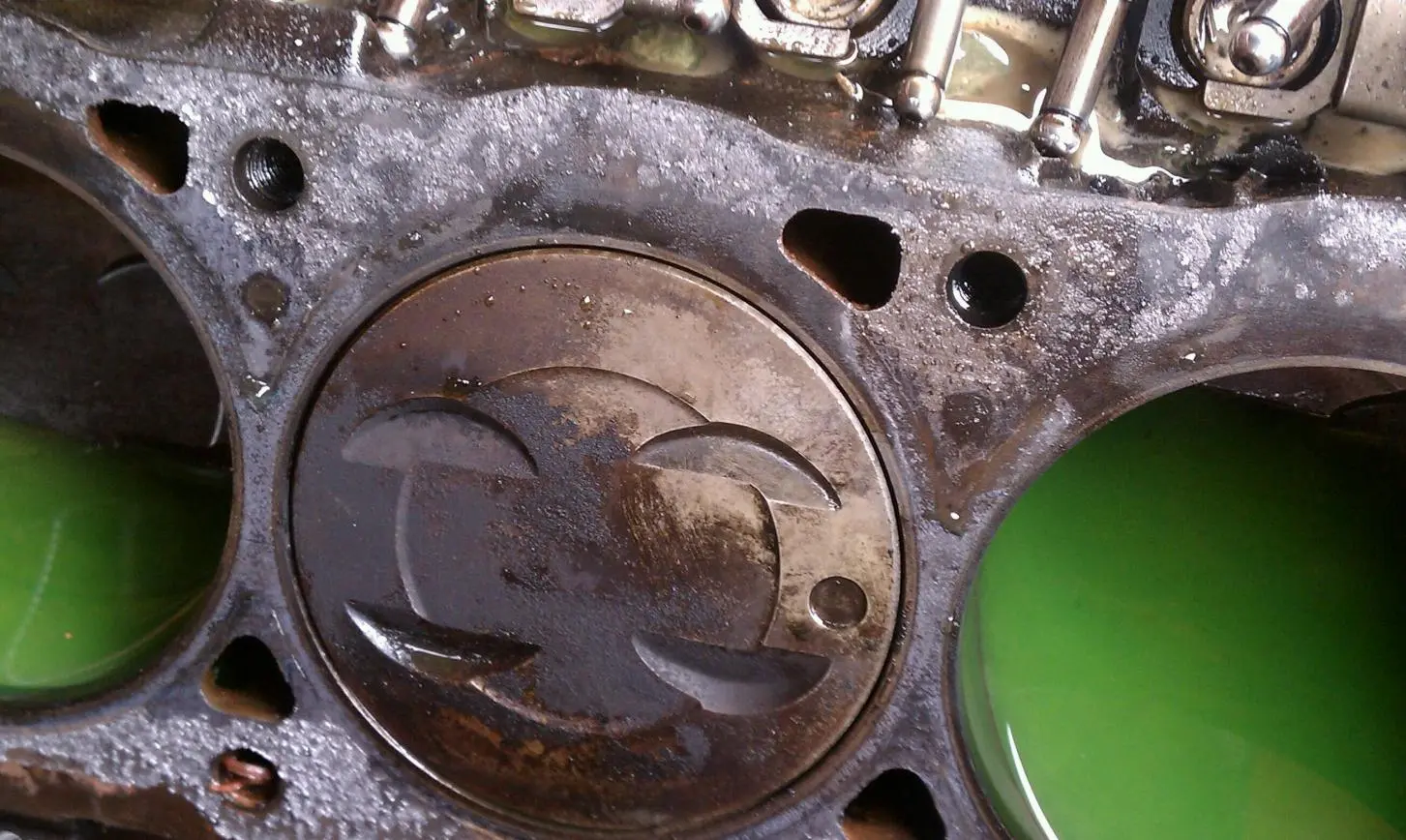

Well, I pulled the dip stick and the oil was nice and milky. So I tore it down this afternoon, I guess I'm not good at diagnosing a blown head gasket.
Does this piston look like it was getting water to it? I see the clean spot in the corner next to the water jacket.

Ouch... hard to tell but it could be getting a little water. Do you have a picture of the gasket? What do the valves look like in that cylinder?
