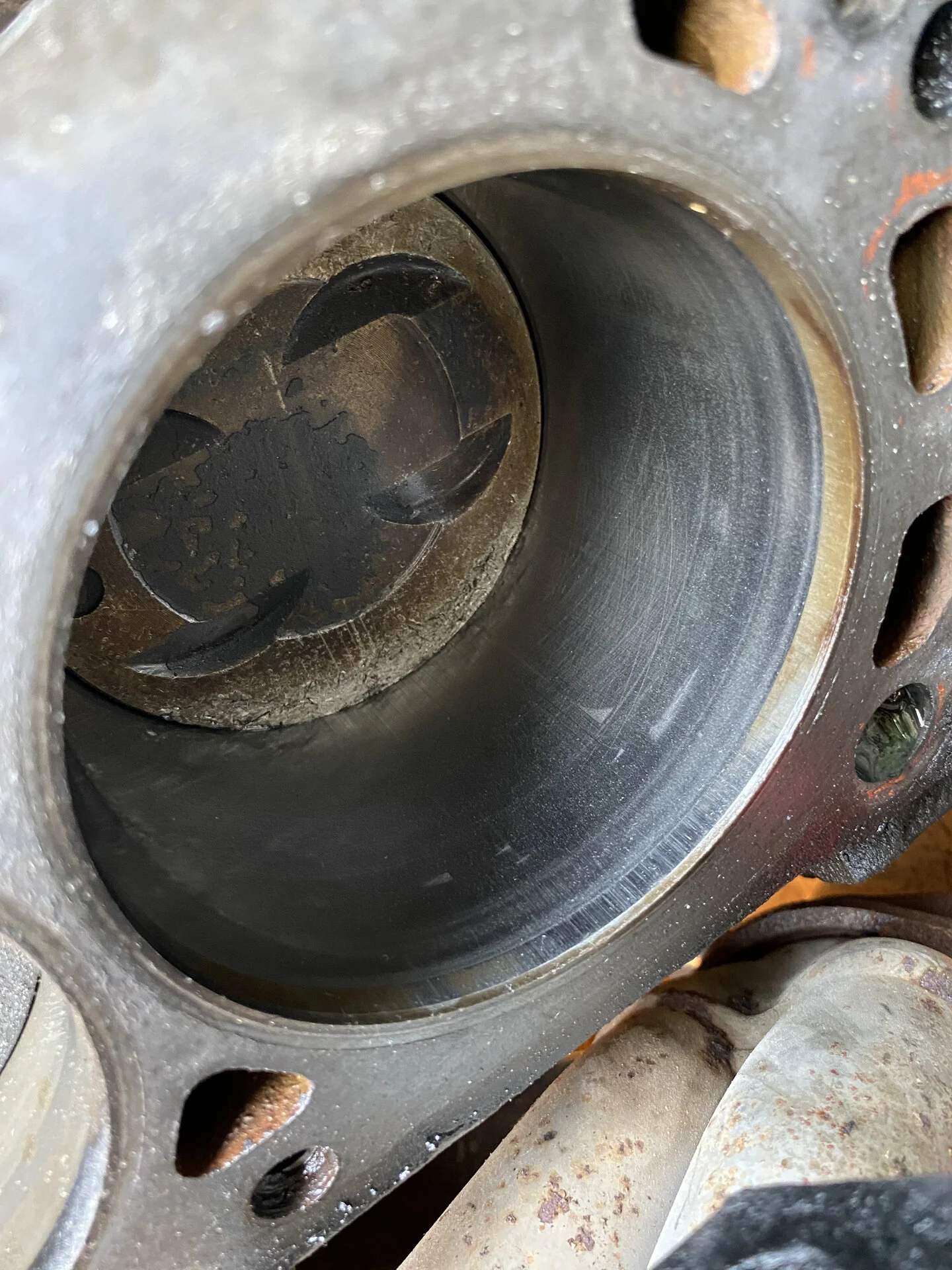

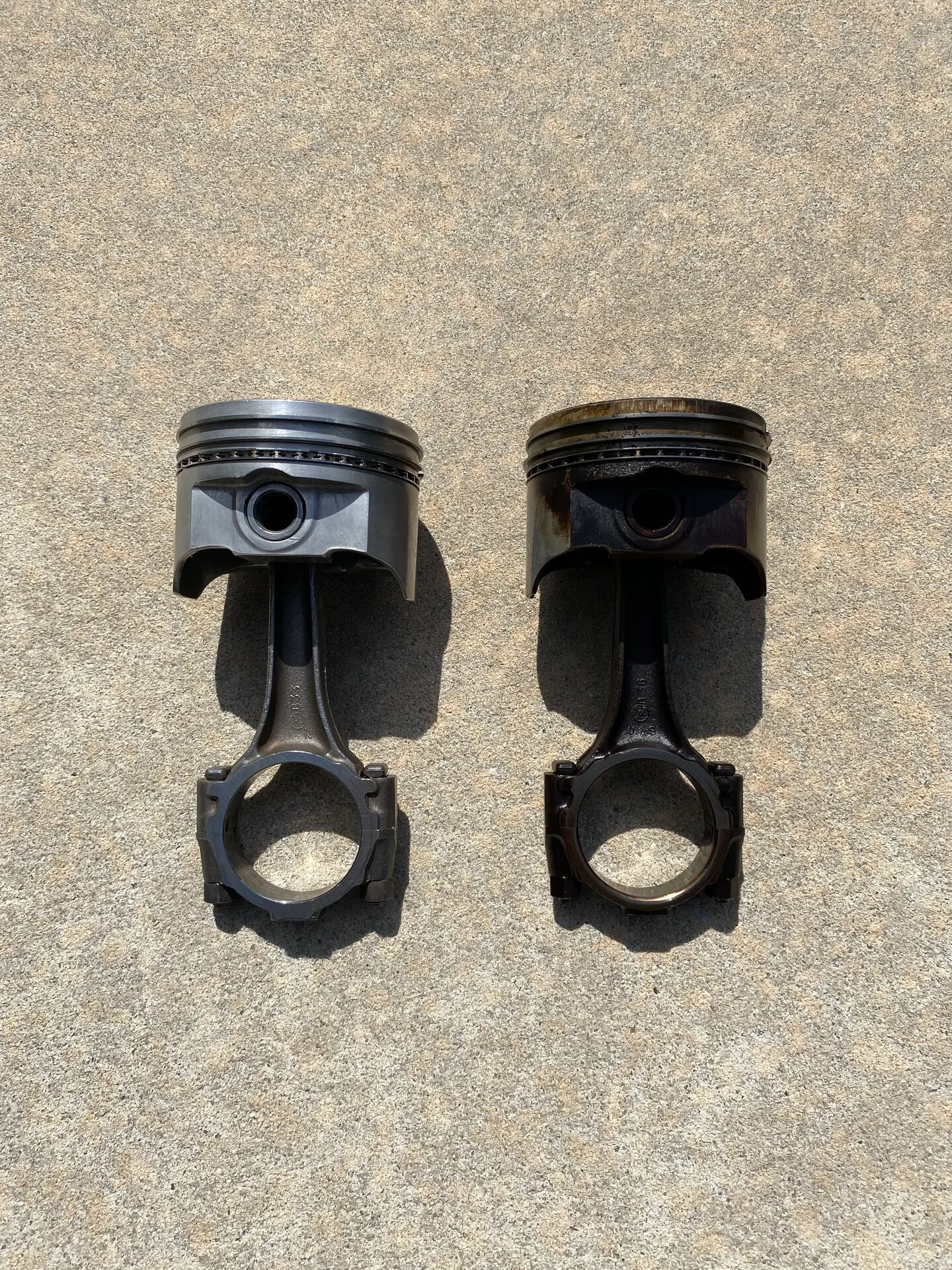

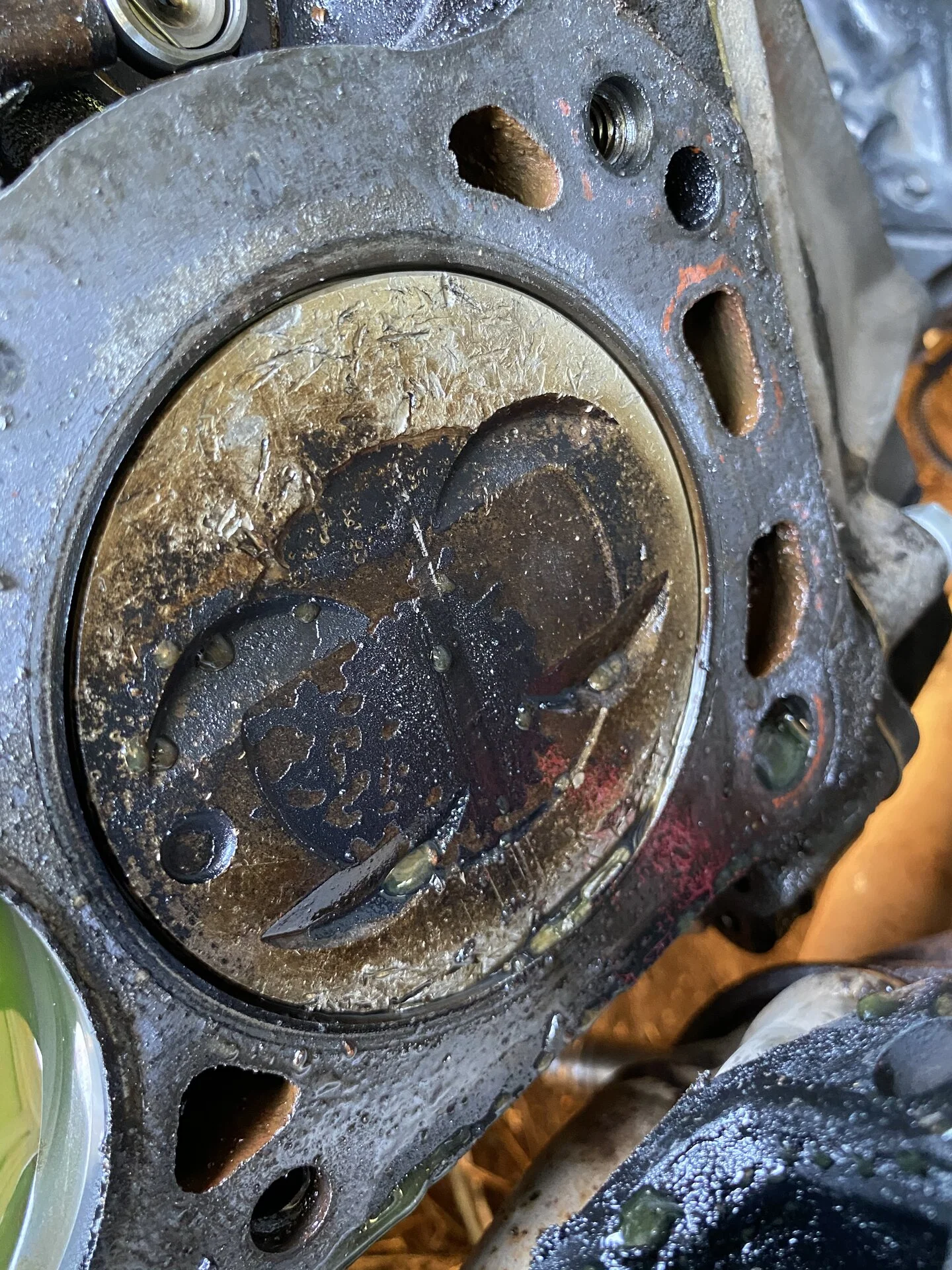

Any thoughts on what caused this?
Only piston that looks like this is #8. Been smoking super bad and burning tons and tons of oil for months. Finally pulled the motor and doing a total rebuild starting with taking the block to a machine shop. What do you guys think caused this in the first place?
Looks like a spark plug non-fouler
It sure does. Probably the Dorman one in the "Help" section of the Autoparts store. Now for the real question, was it the chicken or the egg? Did someone put an anti-fouler in that hole because something had already damaged the cylinder, or did someone put an anti-fouler in there causing damage to the cylinder?

The oil in the cylinder/chamber I would guess is due to oil being sucked up through PCV system. In stock set up, the hose connects to intake right at cylinder 8. If the system is pulling excessive oil vapour or oil, it will pool in the #8 runner of the intake. The engine will then suck it into the combustion chamber, fouling the plug. I had a period of time without the screen in the lower intake (below the PCV valve) and I would oil soak a plug to the point of misfire in 2 hours of driving (I was daily driving at the time).
I agree whatever is in or blocking the plug hole looks strange and there is definitely damage from something bouncing around in the combustion chamber.

The anti fowler is nothing but a spacer to move the plug out, nothing to break off. It was no doubt put in after the damage occurred.
I added the anti fowler because if you drove the car more than a few miles the spark plug become soaked in oil and would cause a misfire in cylinder #8. The anti fowler would make it last a few more miles but the spark plug would still get soaked in oil.

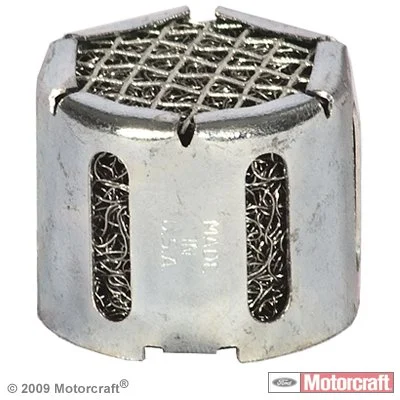

There is a rubber grommet at the back of the intake. The PCV valve fits in. If you pull out the grommet, there should be a mesh insert below it.
This captures some of the oil vapour and lets it drip back into the lifter valley.
If you don't have one, they are pretty cheap. I got mine at rockauto.

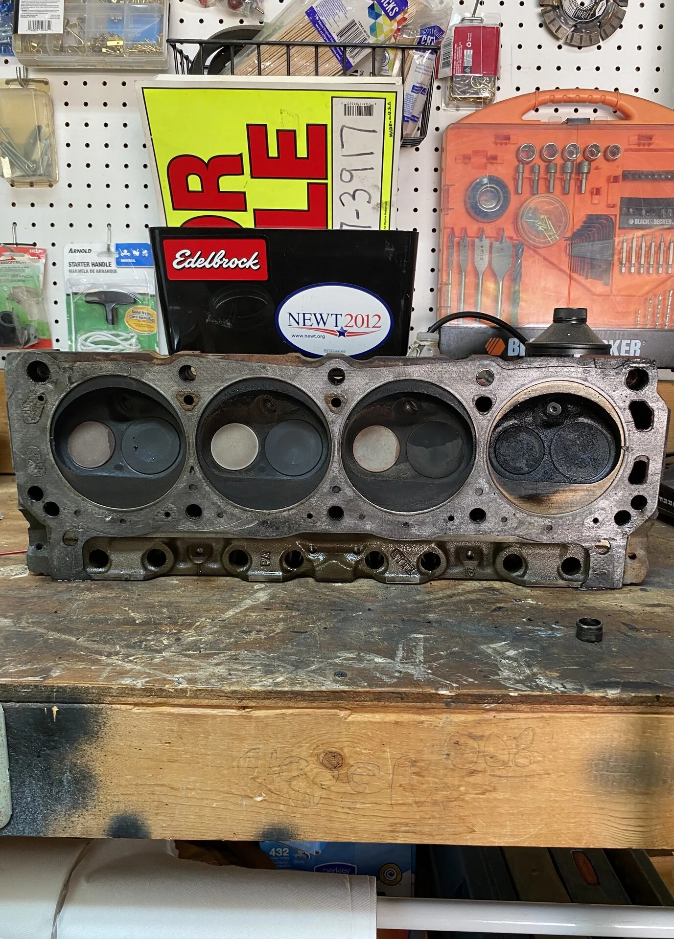

Looking at your pic of the cylinder head, you can see some of the oil residue on the next cylinder/combustion chamber, not as bad, but its there.
I’ve checked that it definitely isn’t that. The smoking was so bad it was probably illegal to drive on public roads. It was burning atleadt a quart a day. Oil was just pouring into the cylinder and making the spark plug literally wet with oil.
Whatever got in there and caused that damage was probably spit out the exhaust valve and could still be trapped somewhere in the exhaust system. If you ever take the exhaust off, maybe you could find it. Could be laying in the pipe somewhere or dancing around in the muffler. Theres always a slim chance it made it all the way out
