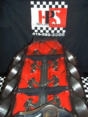

I saw an episode of horsepower tv where they took a stock 5.0 block and added stiffening girdles to the top of it. You have to drill a few holes, but according to the manufactuer, the stock block survived 9000 rpm. I have it on my server somewhere......

yes totally useless, another gimmick aimed at noobs:rolleyes:
Don Fiveolio said:
so, you've tried this before? How do you know that it does not work? I ask because I was seriously considering this once I got into power adding. Please elaborate.
Have I ever used this gimmick? No, being in the small block ford arena for 20+ years racing I can tell you if this valley girdle was of any use other than taking your money, we would have done it decades ago. Take a long hard look at the hardware used and where the girdle is bolted to. It's totally useless, but by all means purchase it and spin your motor to 7500 since thats well below the 9k as advertised, let me know how it goes and how the mains look.:D

funny... but seriously I'll heed your advice. Anyone who has been involved in racing as long as you has to know what he is talking about. But, I have to say, given the layout and placement of the girdle, it looks like it may have a chance.....*pick up phone and dails number to Dart* :D

Better yet, dont listen to me or anyone that gets paid to advertise this product. Just roam the internet and flip through the various magazines and let me know when you find a high hp small block using one, thats not getting paid to advertise it. :D
It has been a while since I looked at the valley girdles, but from what I remember it is a good idea, poorly executed.
For these stiffeners to be any good they would need to be welded in. Some diagonal bracing would help too.
Just my thoughts,
jason
Here's a shot of the valley girdles I've recently come across. They look to be bolted in, as welding to a cast iron block is discouraged. I think theses are made by Valley Pro Girdles if I remember right. Look like they may be effective.
