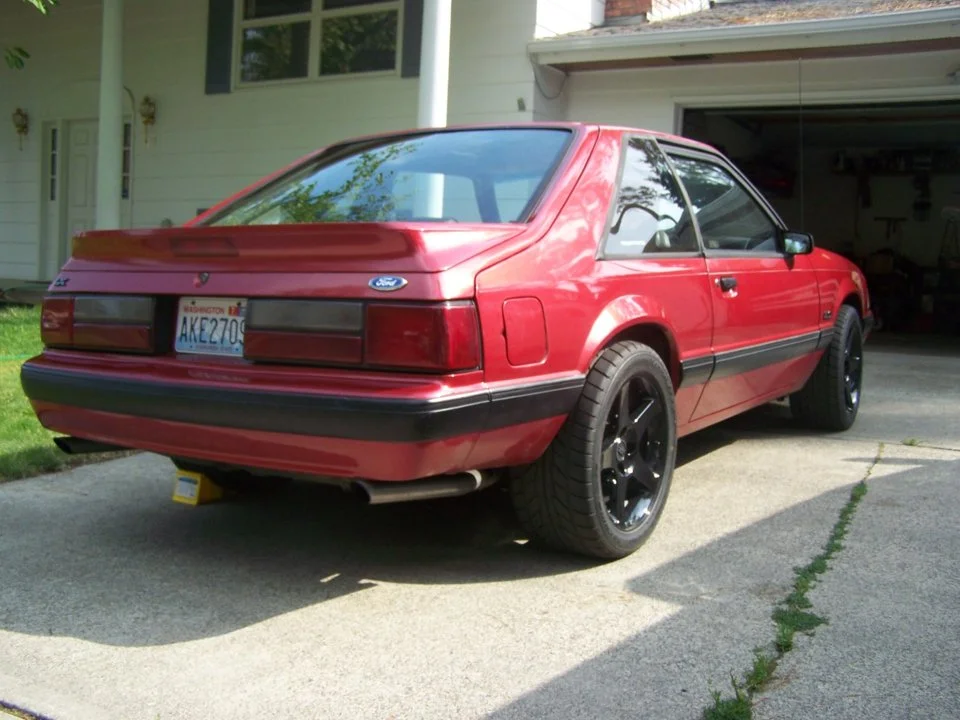

I have 18x9s with 235/40s all the way around. I posted some earlier pics on this that shows my rims protruding more than the Nitto's. Don't really like the way it looks. Maybe a different brand tire would be better or 8" wheels in the front.

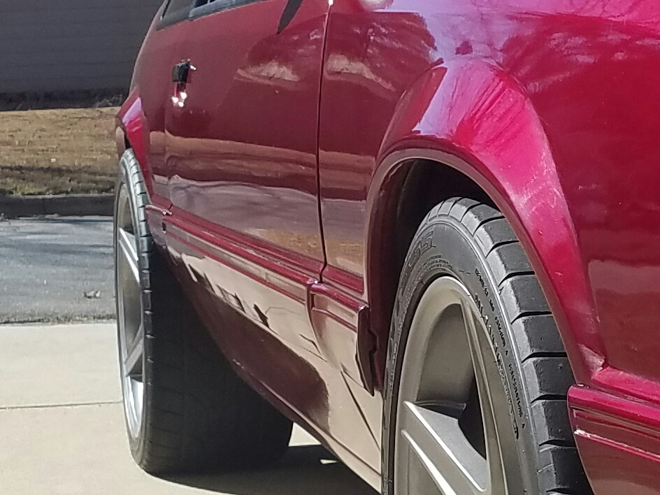

My car has a 2" drop and I'm running 235/40/18. I have room to go a little wider. 245 seem pretty standard with tire/rims combos so I figure 255 is a safe bet and 265 is a maybe, but I could see the tires hitting the quads.
Experiences?
I run 275s on a 17x9 and they fit perfectly. Didn't have to roll the fenders or flip the quads. I don't have much room to spare though. My car is dropped about 1.25" the back, BTW.

I'm also going to measure my offset this weekend. Maybe part of this issue is the wheel sticks out pretty far from the car on the front. I've seen people run 265s and the tire is more tucked in than my 235s. Let me know what you think.
Wow that front wheel does poke out a bit far. To be technically correct, it's a real pain to measure offset on a wheel. What you will be measuring is backspacing, the distance from the mounting face of the hub to the inside edge of the wheel. Offset measures the hub mounting face to the center line of the wheel. I'm only saying this so we are on the same page when you return with a measurement :nice: From looking at that picture your backspace on that wheel is too low but probably typical of a 4 lug fox front wheel.
X2 same on mine. I'm running nittos out back and they do run slightly narrower than some brands. 275's are fairly common on 17x9 setups.
