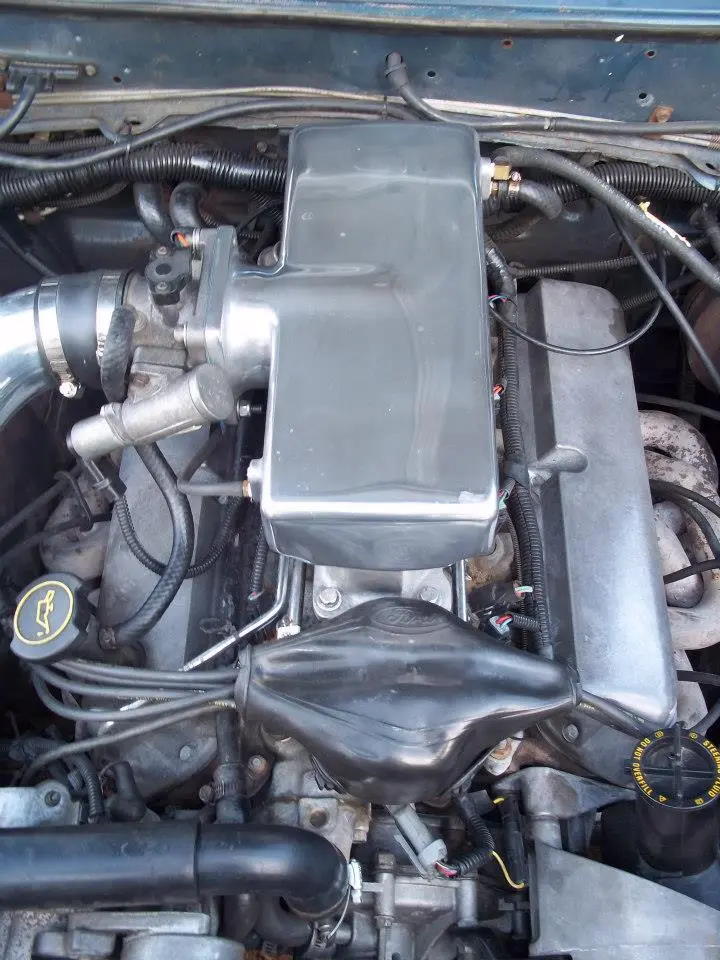

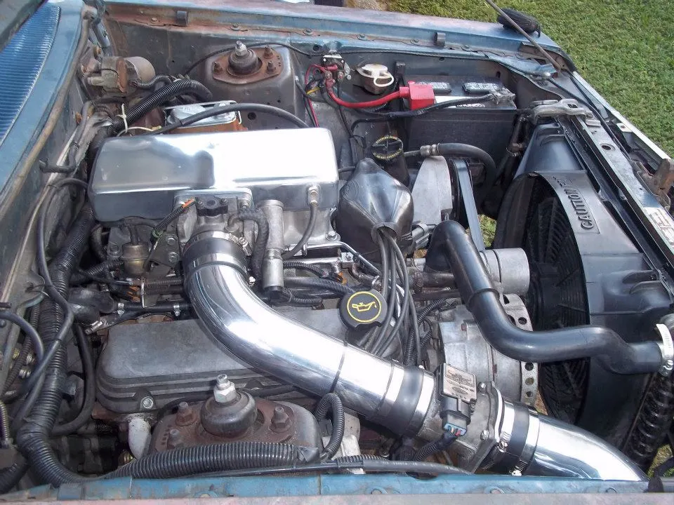

Well, we put the intake on the car today...
:burnout:Holey cow!
LOVE IT!
Off idle is a bit soft, but nothing worth much discussion.
It actually helps because wheel hop in this car was devistating before, and now it is much more manageable.
I bet the car picked up 30 hp...
In gear, at 3k rpm, stab the throttle and it is up to 6k before you can even react.
This thing is SOOOOOOOOOOOO much more responsive at just about any rpm above idle than the Exploder upper.
This is with a bolt on only stock engine, T5, and 4.10 gears.
I can't wait to see what happens when the heads, LT headers, and Z-cam go in.
It's my son's car, but I have a blast helping him with it. I drove it and hit 'valve float' so fast it was crazy. I am more aggressive driver than he is... Valves (totally stock valvetrain/heads) float about 6300 rpm. I told him to get an rpm activated switch so we can set up a shift light. The revs go so high so fast, that a light would be a good addition, and normally I don't care for a shift light.
I know I sound like an excited little girl... but I have owned some fast cars before.
It's just that the whole 5.0 EFI thing is new to me.
I am used to carbs on Fords, and LSx engines for fast EFI.
To see this 5.0 we worked so hard on, and on a teen's budget, react this well to our mods has me giddy. :SN:
Including the aquisition of the car, we have less than $3k in the car as of today, and it is getting close to LSx performance. (Granted the car is quite a bit lighter than most LSx cars.)

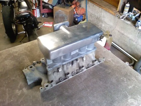

I like the Trick Flow until I see the runners inside. With so many dead end surfaces inside, I don't see how the air can flow smoothly.
The Cartech, and I assume the Downs, have the runner tops blended to the plenum, with no flat surfaces to disrupt flow. Just an observation from a visual perspective. I could be wrong about the multitude of flat surfaces inside the TF. ???
one of the fox's i was looking into getting had one on it but it was a turbo car down south. i didnt go for it since id have to fly down and drive it back from atlanta and it could have turned out to be a piece. but you dont see many of them out there
