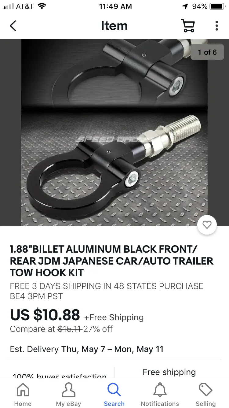

I’ve been wanting to do this as well. @Mustang5L5, Do you have to drill holes in the rear shock towers to mount that? Also, what tether did you use?
Yes, into the rear wheel well area. I just used a cheap eBay tow hook attachment. Was $10 or so
