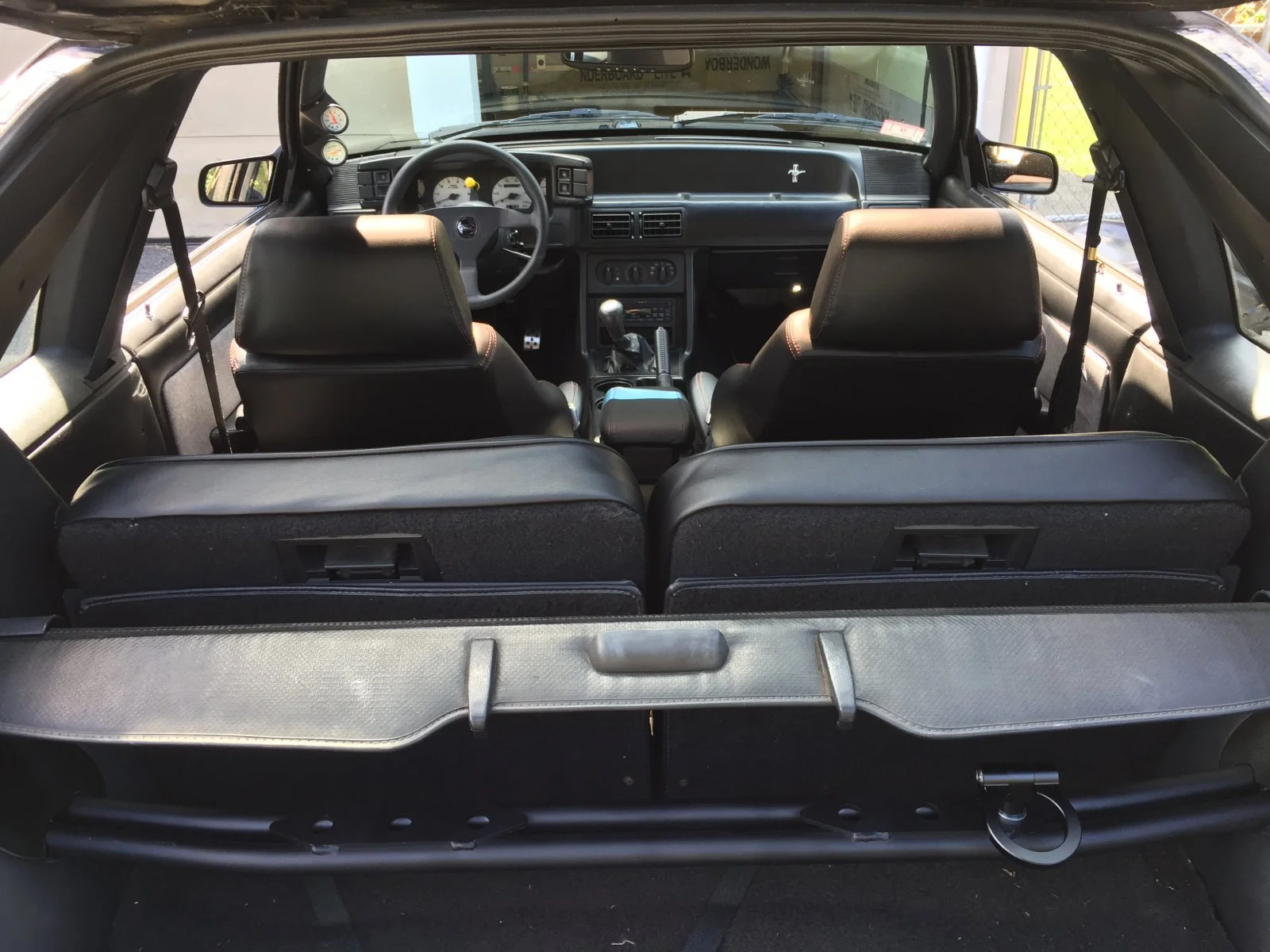

Done it, no problem. I don’t love the retention on 30 year old seat belts, being that there are no hooks to tether the seat to, that’s all you have for safety. I believe @Mustang5L5 had the pretty genius idea to add a rear strut tower brace to tether the seat to.
Thanks guys,
That shock tower brace does sound like a good idea.

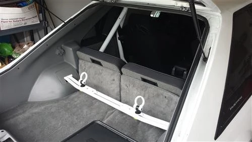

After some searches, lmr has pics of one where someone mounted D ring hooks to one, I'd guess for car seats.
That’s how I did mine.
There's another cheaper option for a anchor point as well. It mounts into the hatch floor where the cargo net tether point typically attaches. (pay attention to the seller's name)
Mike am right to think that you hook the top strap to that ring around some kind of T post?

I kinda liked what that guy did with the D ring.
