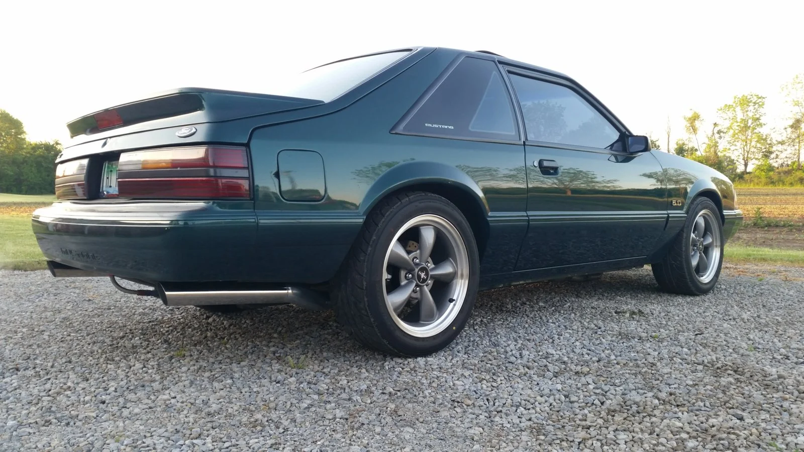

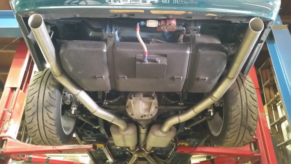

I did custom...know a guy that builds headers and we put it on the hoist and did it at his place. We did under the axle and I personally think that is the only way to go at 3". I have a better shot of it up on the hoist of the routing if your interested in my build thread. BtW I was also sick of the dust and dirt I cut the turn downs off a couple years before going to tails.
Ps this is just a standard 4 link with a anti roll bar. No normal tails were going to clear the anti roll bar.
