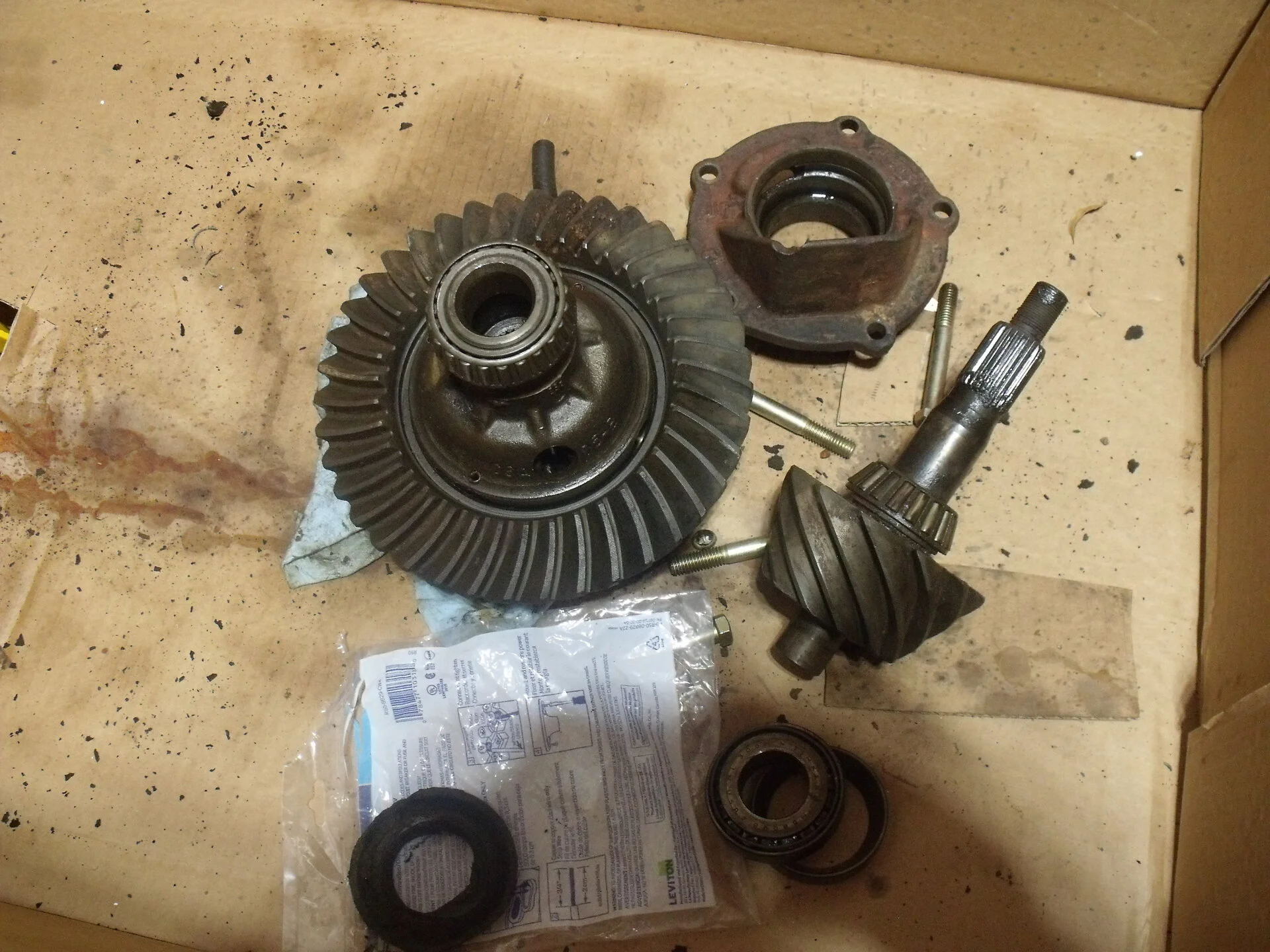

Going to pull the 9 inch "N" third member I have out of the bucket of diesel it has been sitting in for 6 months ( to see what bearings I have) then order a new rear end kit for it, with the Eaton posi and some 350 gears.....

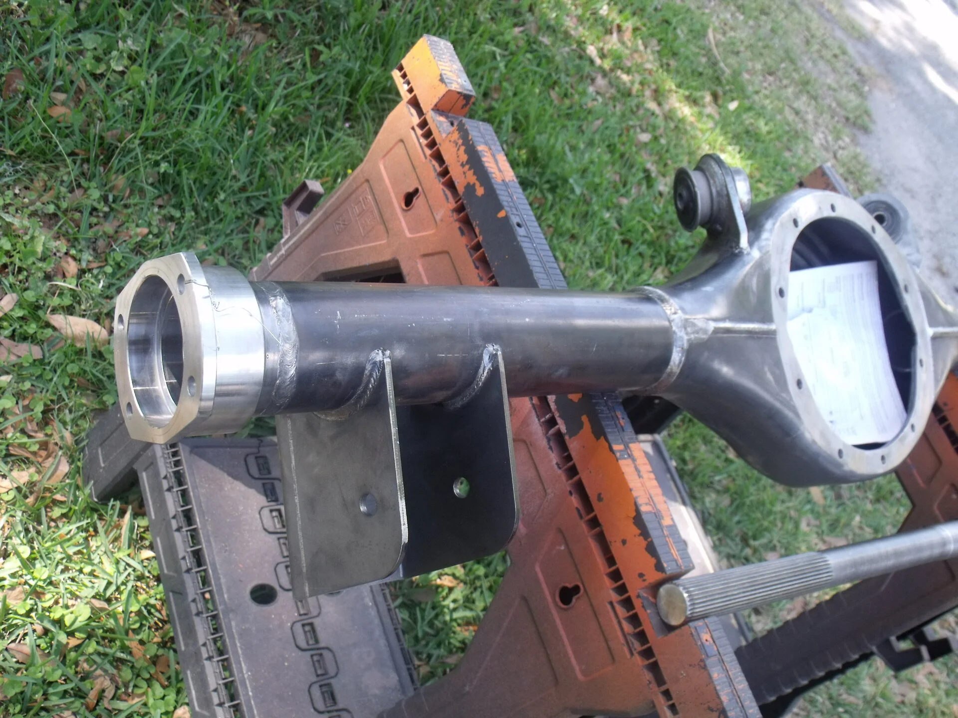

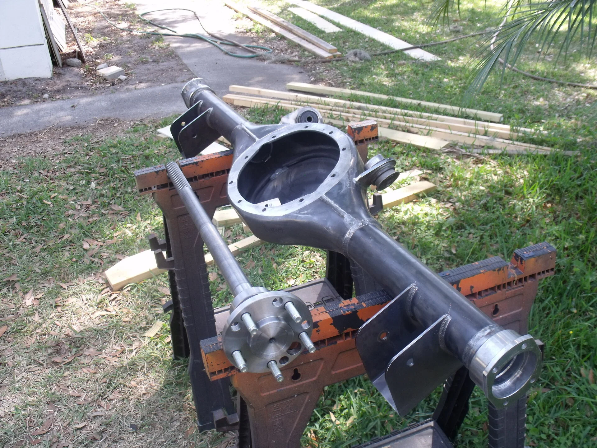

I saw a 9" housing ready to bolt in a fox body all you need to do is have a pumpkin and the brakes for like $ 795? On fleabay.
Quick performance and Speedway both offer a bolt in 9 inch housing and axle package in that price range....

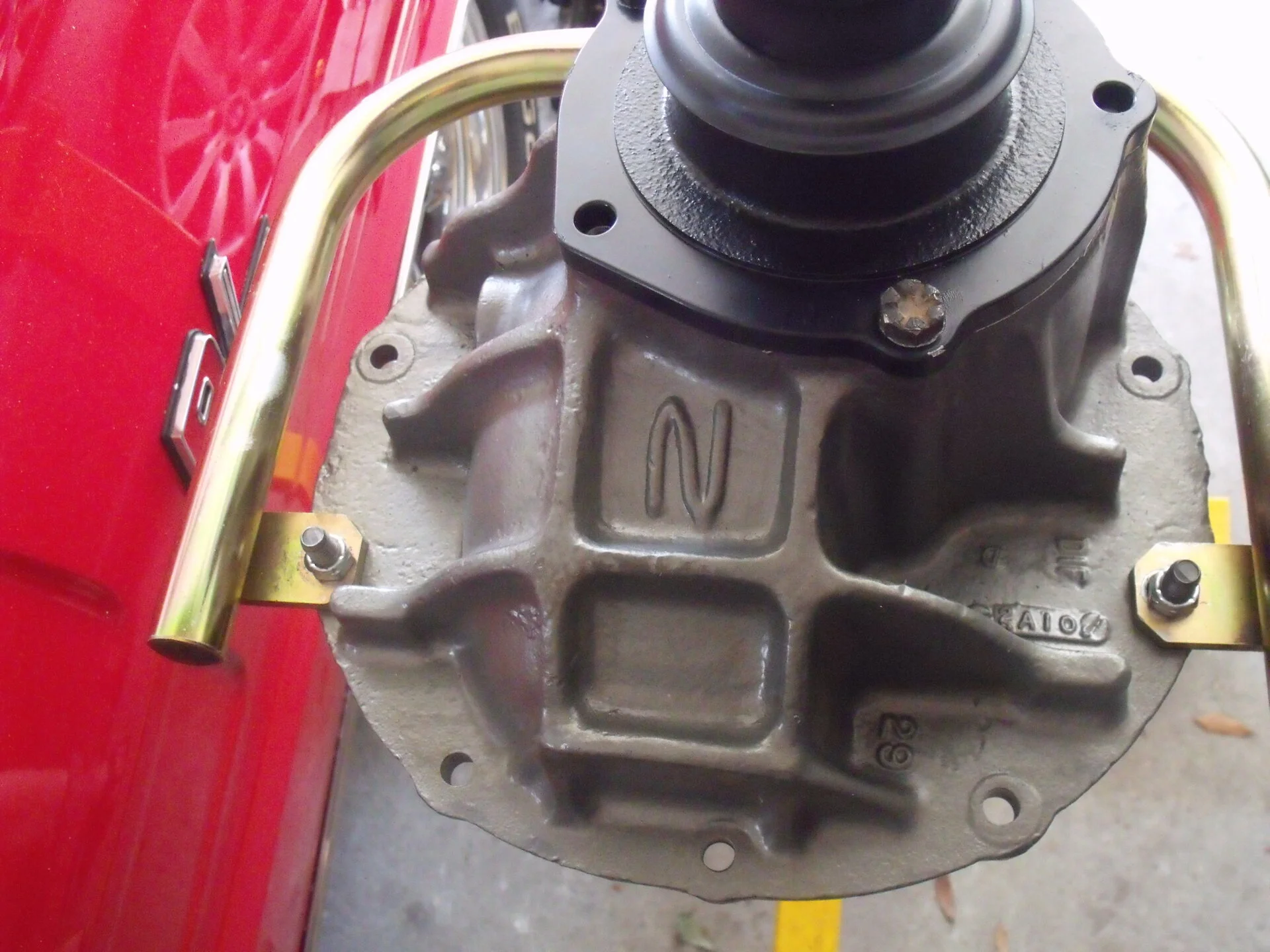

The housing and pumpkin are a little bigger than a 8.8, is how I understand it...

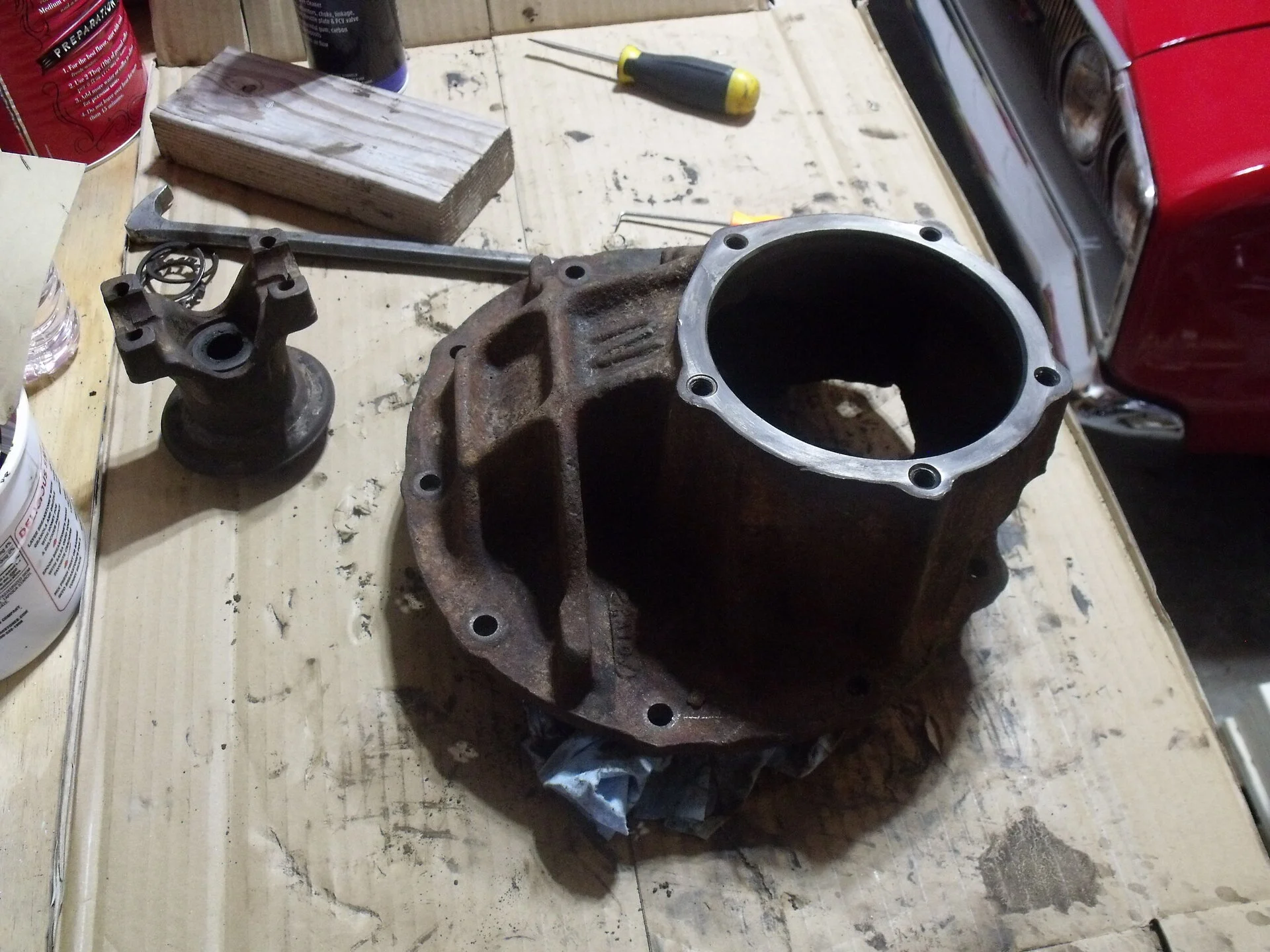

Boy what a mess this thing is.. I was disappointed that it did not have a Daytona Pinion housing, MOST "N" housings did.... AND a small 1310 yoke....
Looks nice man. Your car, build it the way you want and what makes you happy. That's what is most important. Good luck. More pics please, as the install moves along.
